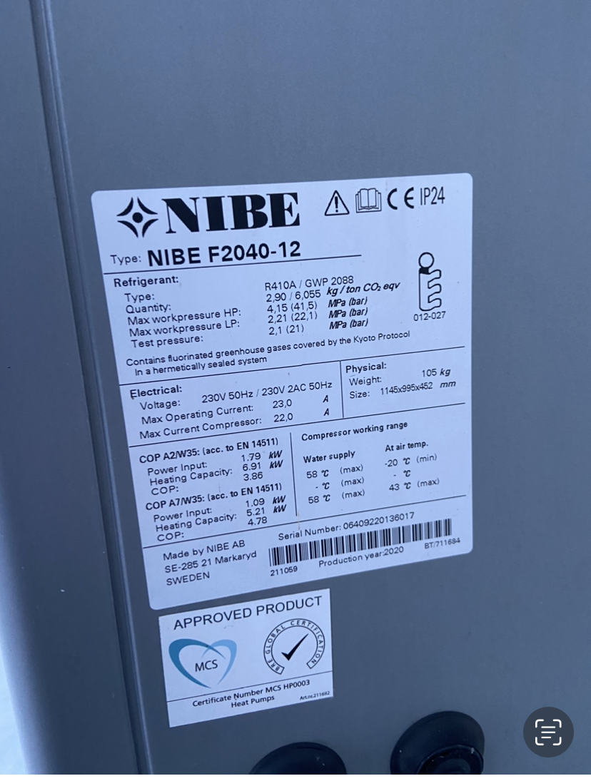

JohnMo Posted December 15, 2022 Share Posted December 15, 2022 A few questions Whatis your UFH flow temp? Are you doing a fixed flow rate or weather comp? What is the ASHP flow and return temps? How big is heat pump? Do you know your heating design kW? Does your system have a buffer? Link to comment Share on other sites More sharing options...

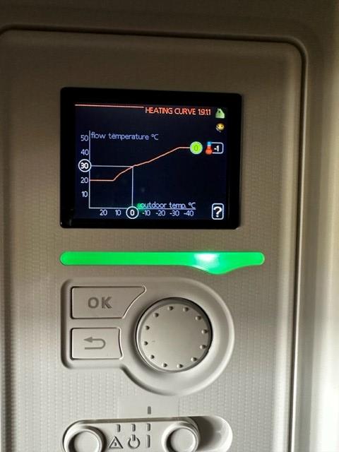

Luke1 Posted December 16, 2022 Share Posted December 16, 2022 I've got a Nibe controller, so if you have any specific controller settings then I can help answer. Unless the curve has been set to flat line the default system should be set up for Weather Compensation. If you could take a look at this and provide a picture or details requested above then that would be a good start to getting some answers. (Do you have Nibe Uplink so that you can monitor / control the system remotely?) 1 Link to comment Share on other sites More sharing options...

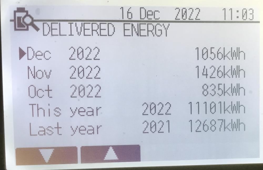

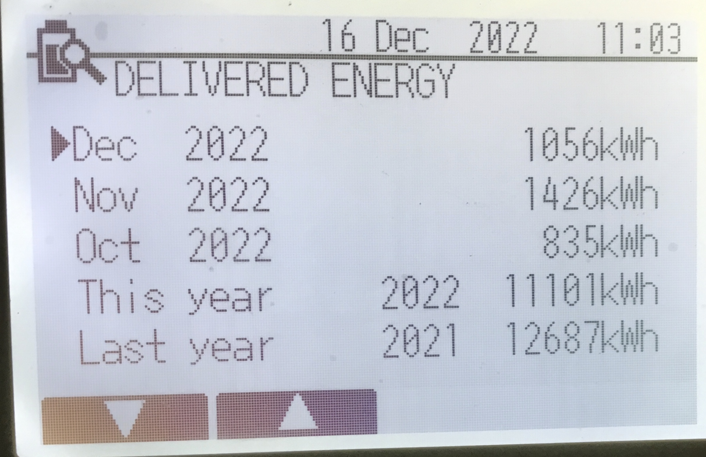

Danwood build Posted December 16, 2022 Author Share Posted December 16, 2022 A lot of technical questions 🤣 I’ve taken some pictures from my controller… the house used 10900kw last year at 13p a kw!!! Link to comment Share on other sites More sharing options...

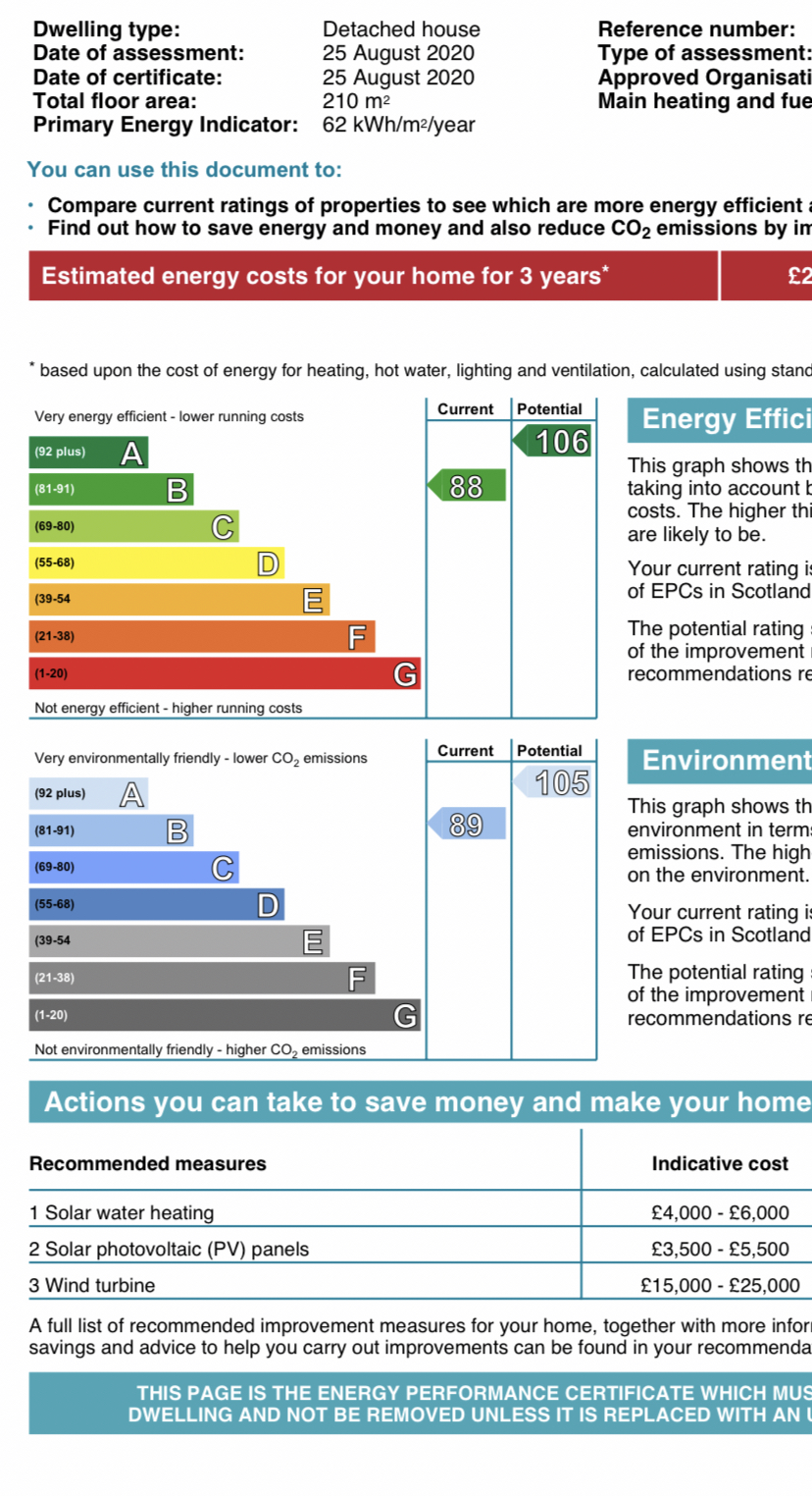

Radian Posted December 16, 2022 Share Posted December 16, 2022 11 minutes ago, Danwood build said: A lot of technical questions 🤣 I’ve taken some pictures from my controller… the house used 10900kw last year at 13p a kw!!! Don't let @SteamyTea catch you dropping your h's I take it your 10900kWh/year was just space heating and hot water? The Primary energy indicator of 62kWh/m2/year seems a bit pessimistic (as usual). Link to comment Share on other sites More sharing options...
Luke1 Posted December 16, 2022 Share Posted December 16, 2022 Can you go into indoor climate -> advanced -> curve and send a picture of the heating curve you have? Link to comment Share on other sites More sharing options...
ProDave Posted December 16, 2022 Share Posted December 16, 2022 You have a pretty good EPC rating there. Fit some solar PV and you would easily be up to an EPC A which is nice to have. Link to comment Share on other sites More sharing options...

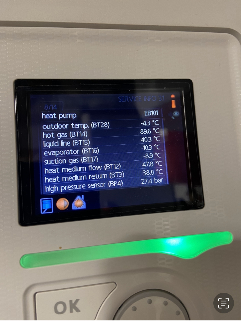

JohnMo Posted December 16, 2022 Share Posted December 16, 2022 (edited) First observation is the flow temp is high at 47.8 from the heat pump. Do you know what your UFH flow temp is, or does your floor heat up quite quickly? If you could reduce that flow temp to about 35 you could gain an additional 1 on your CoP from low 2s to low/mid 3s. That could save 10kWh a day! My flow in the floor is 29 as a reference, it's -7 here, house sitting at 19 inside. Edited December 16, 2022 by JohnMo Saving in electric added Link to comment Share on other sites More sharing options...

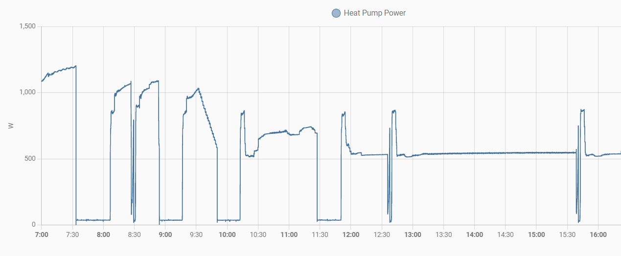

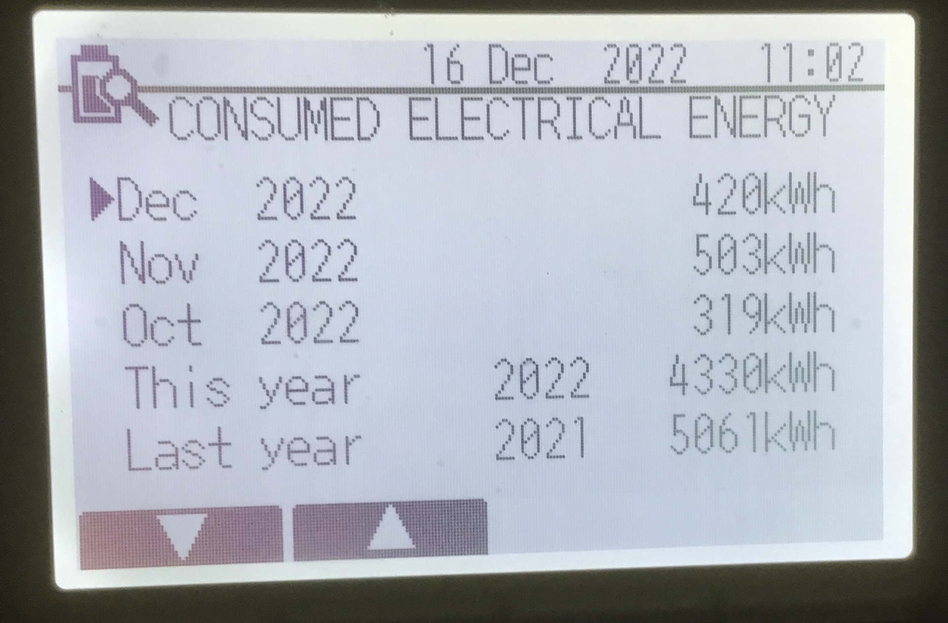

Bozza Posted December 16, 2022 Share Posted December 16, 2022 (edited) So your house size & your EPC are almost identical to mine. And we’re obviously experiencing same outside temperatures being local. I’ve looked at my overall electricity bills, and ASHP stats to help you make comparisons: overall household electricity usage in July 22 - 11 kw per day. Over past three weeks - 41 kw per day. house occupied pretty much 24/7. in terms of ASHP annual useage etc please see below. Hope this helps. Edited December 16, 2022 by Bozza Link to comment Share on other sites More sharing options...

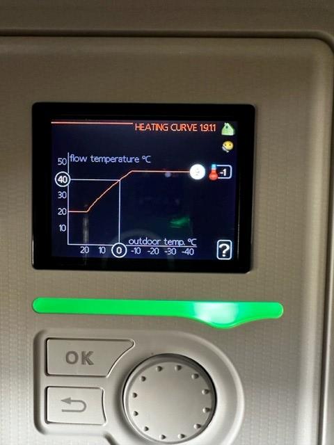

Danwood build Posted December 16, 2022 Author Share Posted December 16, 2022 35 minutes ago, Luke1 said: Can you go into indoor climate -> advanced -> curve and send a picture of the heating curve you have? 10 minutes ago, JohnMo said: First observation is the flow temp is high at 47.8 from the heat pump. Do you know what your UFH flow temp is, or does your floor heat up quite quickly? If you could reduce that flow temp to about 35 you could gain an additional 1 on your CoP from low 2s to low/mid 3s. That could save 10kWh a day! My flow in the floor is 29 as a reference, it's -7 here, house sitting at 19 inside. Link to comment Share on other sites More sharing options...
Danwood build Posted December 16, 2022 Author Share Posted December 16, 2022 That any help? Really appreciate feedback so far. Both radiators and UFH are on constant just now. Link to comment Share on other sites More sharing options...
JohnMo Posted December 16, 2022 Share Posted December 16, 2022 So was your first photo showing the heat pump showing 47 degrees flow temp, on DHW heating, as it does not be match the heating curve? Link to comment Share on other sites More sharing options...
Danwood build Posted December 16, 2022 Author Share Posted December 16, 2022 15 minutes ago, JohnMo said: So was your first photo showing the heat pump showing 47 degrees flow temp, on DHW heating, as it does not be match the heating curve? DHW? Link to comment Share on other sites More sharing options...

Redbeard Posted December 16, 2022 Share Posted December 16, 2022 Danwood build said: 'DHW?' Domestic Hot Water Link to comment Share on other sites More sharing options...
JohnMo Posted December 16, 2022 Share Posted December 16, 2022 DHW, Domestic hot water - Heating your cylinder. Link to comment Share on other sites More sharing options...

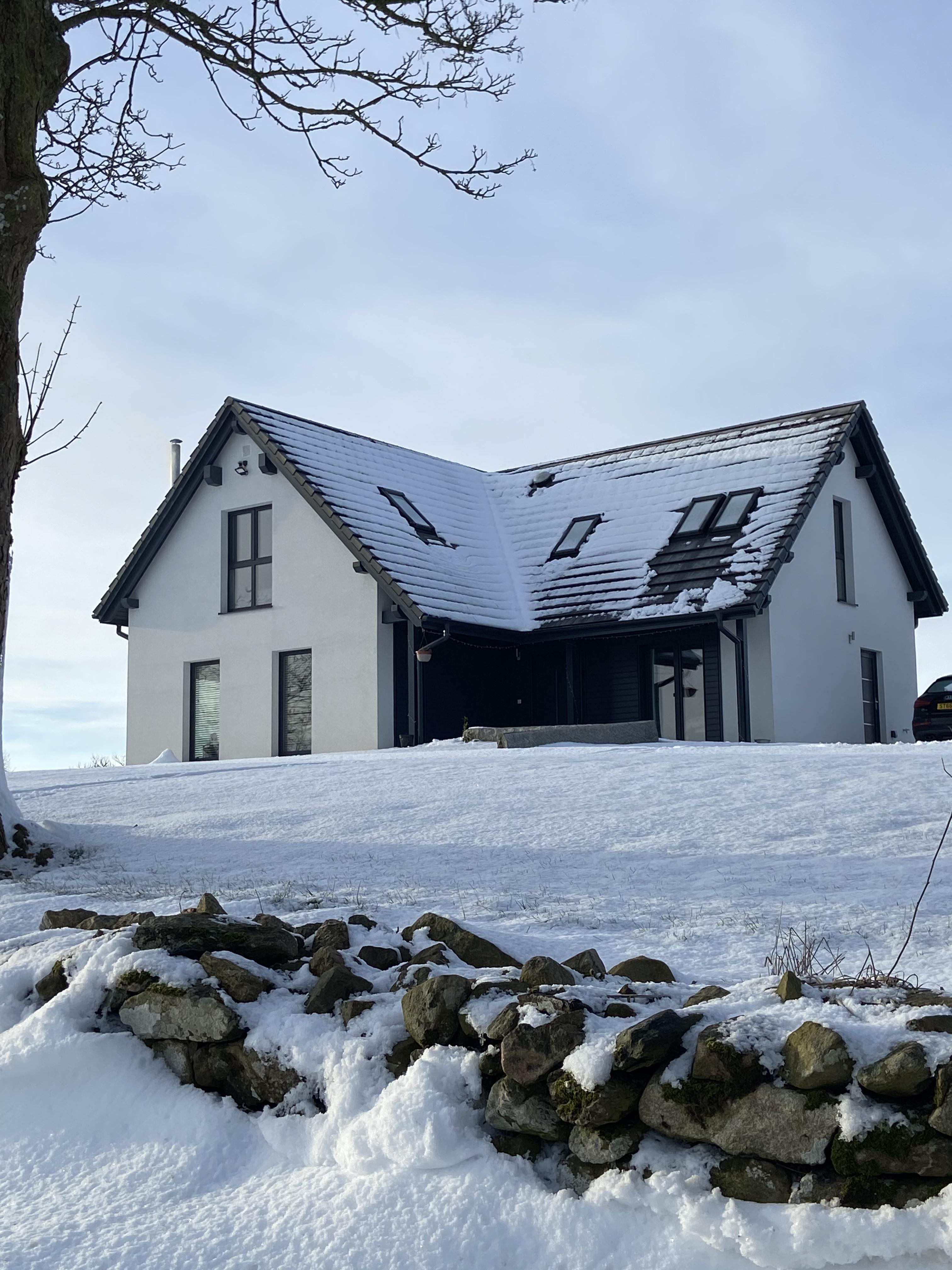

Radian Posted December 16, 2022 Share Posted December 16, 2022 Looking at that photo (nice house BTW) what's going on with the lack of snow below the paired roof windows? It seems to have fallen into the gutter rather than being melted off by a thermal bridge in that area, but you never know. Link to comment Share on other sites More sharing options...

Danwood build Posted December 16, 2022 Author Share Posted December 16, 2022 1 hour ago, JohnMo said: So was your first photo showing the heat pump showing 47 degrees flow temp, on DHW heating, as it does not be match the heating curve? The photos were at different times. I’m in for next 30 mins if I can supply some more photos. Link to comment Share on other sites More sharing options...
Luke1 Posted December 16, 2022 Share Posted December 16, 2022 45 minutes ago, Danwood build said: The photos were at different times. I’m in for next 30 mins if I can supply some more photos. It was probably for heating. The Nibe system works on 'degree minutes' therefore whilst the curve may say flow at 0C of 32C the heat pump will run until any deficit of degree minutes is brought back to 0. My heat pump is set to start running at -60DM and in the first few minutes whilst flow temp is lower than the curve it will increase to say -80DM, and then it will lose these for every minute it spends above the curve temp. So if the heat pump is providing water at 42C compared to a curve of 32C it will lose 10DM every minute. Then when it hits 0 it will turn off. This whole situation gets worse when it has to defrost or carry out DHW heating. Frustratingly whilst the heat pump can modulate down, it doesn't seem to get close to the curve and modulate down so that the DM stays stable. My compressor in auto mode appears to run much higher, but for a shorter duration then cut out for a while. I have manually adjusted my compressor curve (in installer settings) to modulate down so it takes longer to catch up the degree minutes, but runs for a much longer duration. I don't have any evidence yet as to which way is more efficient. I suspect the latter may be more efficient as the system doesn't appear to frost up as quickly. The first graph shows the system running with the auto curve in an on / off fashion. The second graph shows the heat pump running at half the power but over a much longer duration. Link to comment Share on other sites More sharing options...

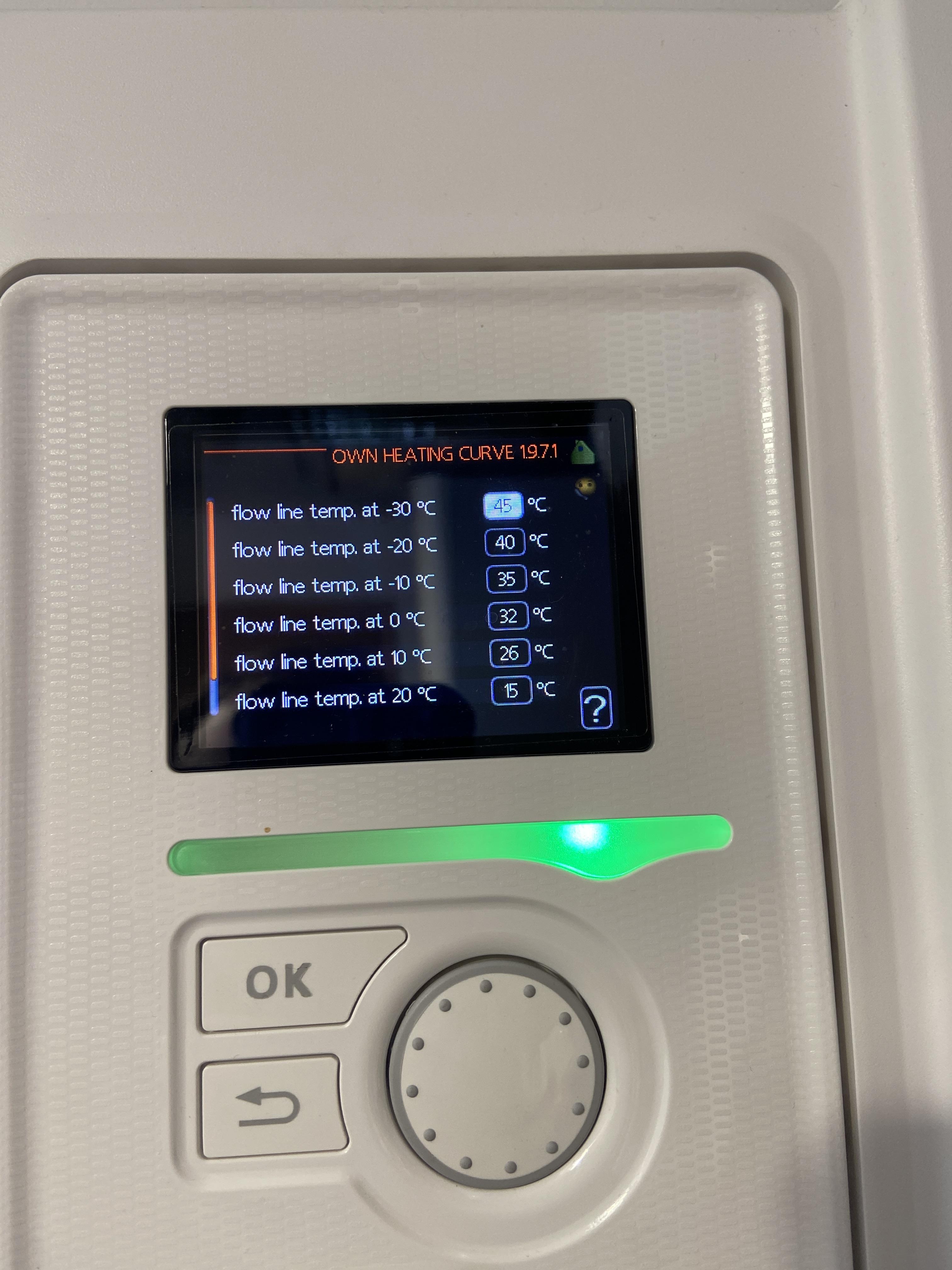

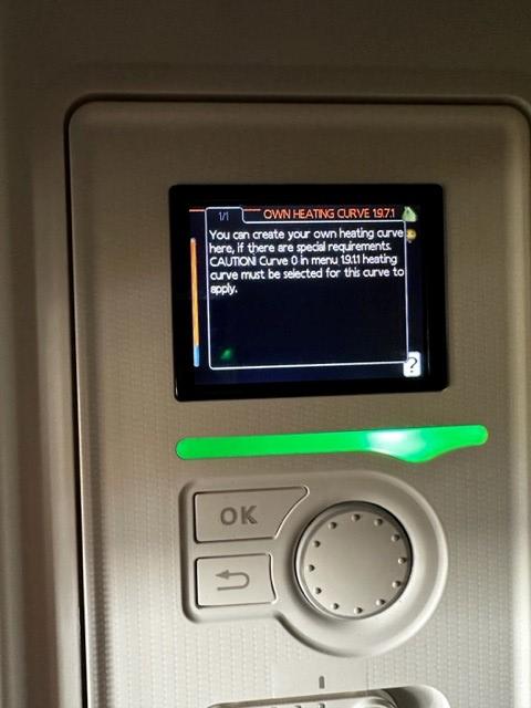

Luke1 Posted December 16, 2022 Share Posted December 16, 2022 (edited) 2 hours ago, Danwood build said: Which controller do you have? Is this an SMO 020? Its odd that you have it running in 'own curve' setting (checking mine it appears these are the exact same defaults that I have) I however use the actual graphical curve instead. If you go to heating -> advanced -> curve can you see if you're actually using the own heating curve or the actual curve. This is my current curve: It tells you to set the curve to 0 to use the own curve setting This is what the standard default 'own curve' looks like when you select 0 next to the little thermometer icon. Edited December 16, 2022 by Luke1 Link to comment Share on other sites More sharing options...
