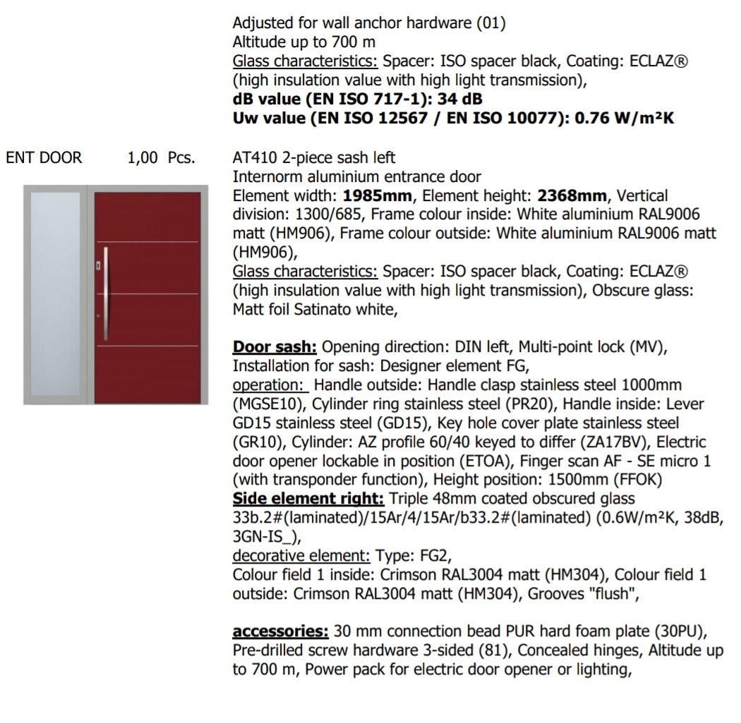

We hadn't planned to, but we ended up with a flashy, flush aluminium front door from Internorm. I think it's 0.6 or something. It's weird having a front door that's stone cold and condenses / frosts up on the outside but is warm and dry on the inside. Think it was £4k on the schedule including the side light glazing.
Edit. Door element is 0.78, sidelight glazing is 0.6.
Edited by Conor

When I looked at Internorm they were 0.76.

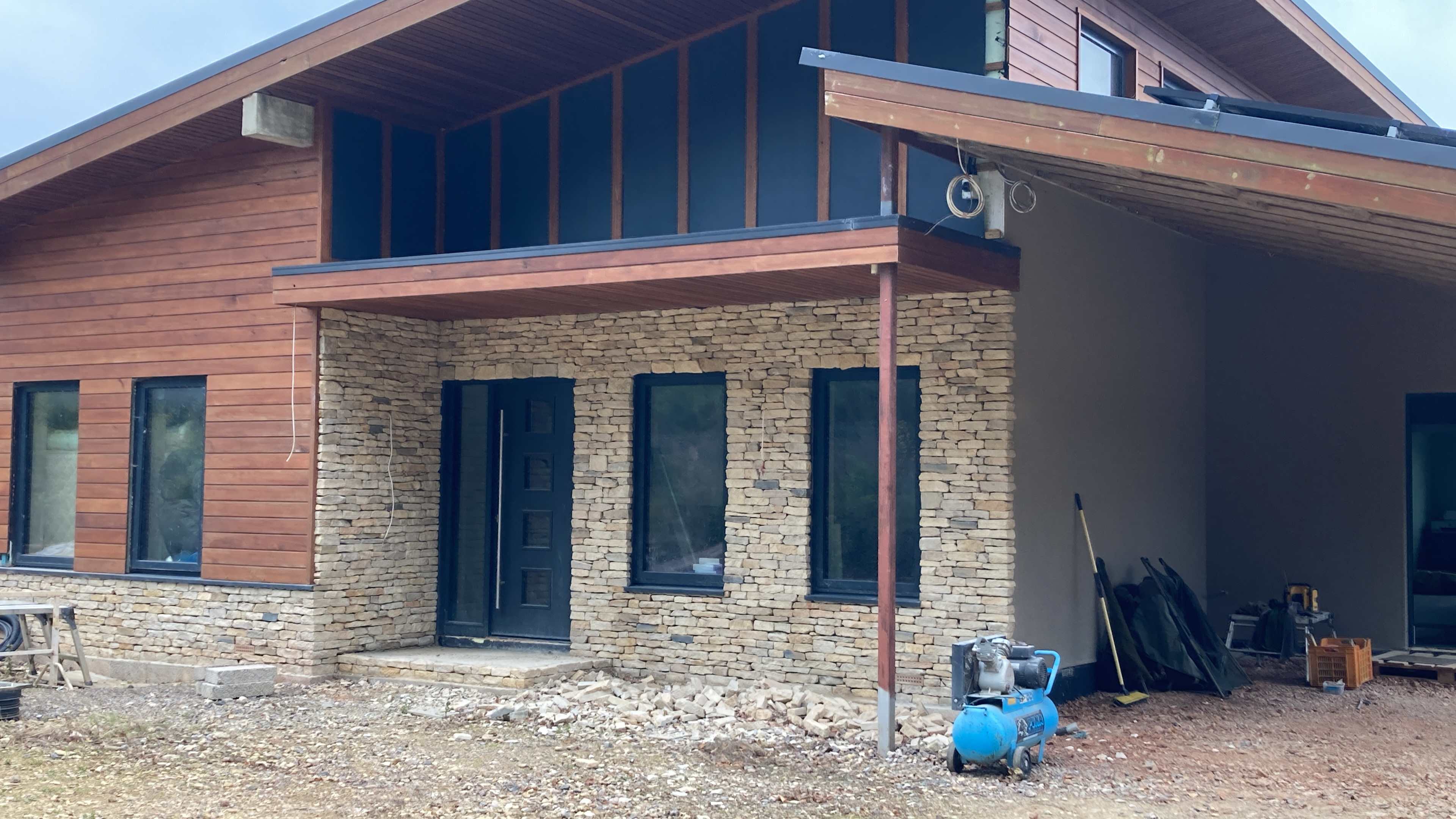

we used a timber door from norrsken that came in under £2000. 610306FC-7129-47C2-974B-0CFA67D2A17E.thumb.jpeg.146f67291eb8be0d685984df5c7ed7dd.jpeg

Thanks, i will try to get a quote from them as well.
Unfortunately, no luck with norrsken i enquired for an Alu-clad door that has U value of 0.7, however they said due to current volume of orders they are unable to quote anything below 10k.
Also my opening size is taller than their tallest door. (opening - W2717mm - H2563mm)
