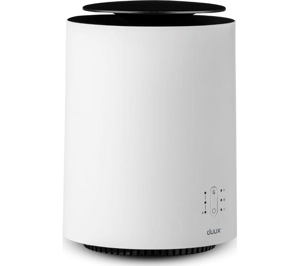

December 7, 20223 yr I bought a one of these fan heaters so we could have a quick blast of heat on cold evenings (stove going in next year). It's quite a gentle fan but really makes a difference. I fell asleep for an hour with it going last night, about 5 meters from me and it felt like my eyes had been sandpapered and my throat was very dry.
December 7, 20223 yr 50 minutes ago, Ralph said: I bought a one of these Looks like a tin of white paint, with a drip covering the L in the name.
