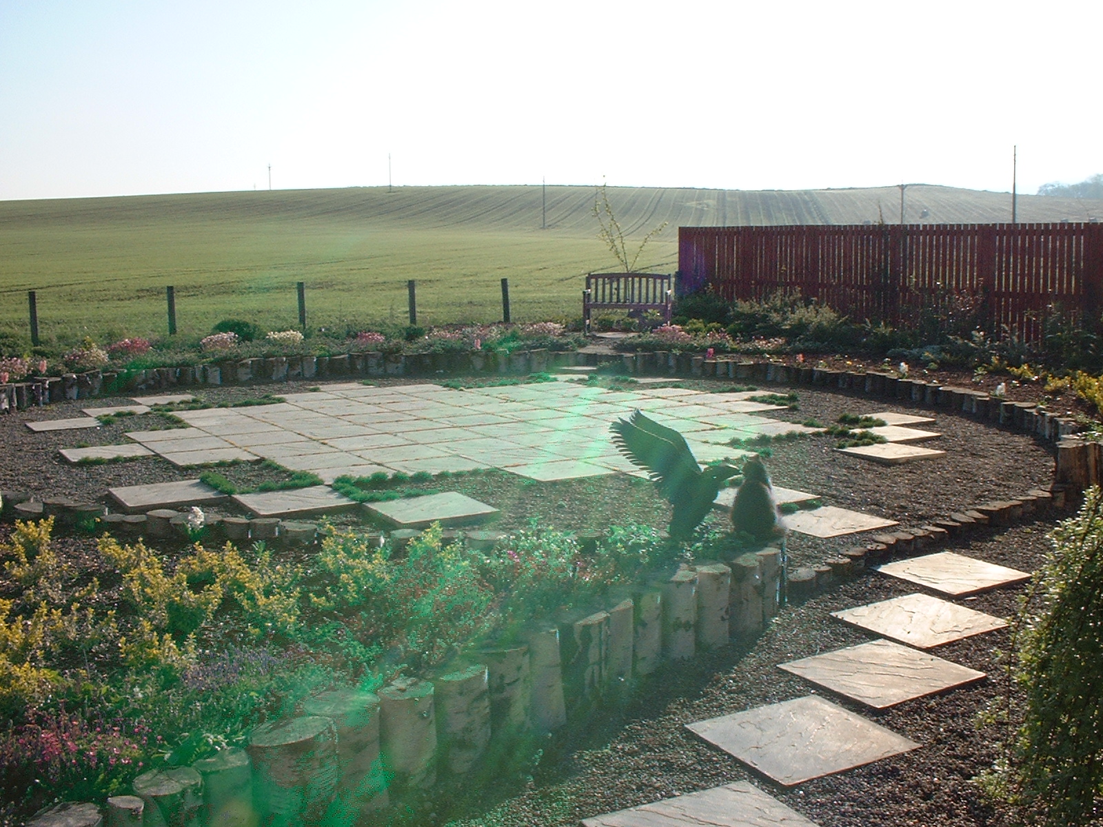

Stones Posted July 4, 2017 Share Posted July 4, 2017 Having built quite a few houses, I've by default ended up having to create several gardens. Not being a horticulturalist, all I've really been interested in is something that's easily maintained and having somewhere to sit out and enjoy the great outdoors. Apologies, can't recall, do you have young children? That often dictates what type of garden you need. If the answer is no, then increasing the amount of hard landscaping - slabs/gravel/cobbles etc may be a viable option. Small areas of grass really are nothing more than a pain / burden, and you can create a pretty nice looking garden without any grass at all: Getting some lads in to do the heavy lifting is a really good idea. You can also do a heck of a lot of work yourself with a minidigger. 1 Link to comment Share on other sites More sharing options...

daiking Posted July 5, 2017 Author Share Posted July 5, 2017 34 minutes ago, Ferdinand said: I would say to have a look at astroturf for an area - very good in a small garden or play area. I inherited some and I have been surprised. I was reacting slightly to the relatively open piccie posted by @Stones - which to be fair will look very different in a few years. Round here we still have various old hedges on our lane from when it was fields, and it is interesting how 6ft hedges are fairly denuded of small birds in the evenings, but the occasional 10ft bush may have a score of sparrows roosting in it. Then the Council trims its hedges and takes the bush down to 6-7ft and the sparrows all move down the road to the next one. For muckaway have you got to pile all your muck at the front, or can they reverse onto where your drive/garage are, and use their telescopic grab to save you all that barrowing? On your landscaping, I wonder whether using either some of your hardcore, rubble or subsoil to be a firm base for your garden buildup (and keep it out of the skip) would let you use a less extensive retaining structure. One other possibility is to use landscaping / soil retaining fabric - eg Geocell - on the surface or deeper down than usual to provide a matrix. Around here they sometimes used that type of layering to construct those pregnant-looking hills over old coalmines). I think a very early Grand Designs did that - the one built just off the traffic island with the water tower. They used it to retain a grass bank. (In case the Youtube time index does not work below, Kevin Mcloud being introduced to Terram and things in 1999 is at 37:28. Link: https://www.youtube.com/watch?v=K6zRMY0Lmqc&t=37:28 ) Ferdinand We're intending to use a small area of astroturf on the side return at the back of the extension. This area is relatively dark and wet and the children have access to it from their play room but I don't want to use much, it would be a shame to use it other than when genuinely practical in such a green looking space. In time I think some sort of hedging type plant would be useful against the chain link fence, in part to stabilise the bank but we'd be looking at under 4 foot tall as we enjoy the feeling of space you get looking through/over the fence as you get the extra few metres of the stream. The birds already piss us off, so I don't want to encourage them wth 10 foot hedges Muck away will be off the drive, dumper hire is an extra £50 a day on top of the digger and driver hire to save borrowing. Everything just needs to go. Spent to long now trying to think about saving this or saving that. I've just skipped an entire skip load of bits of wood and building related tat as its too hard to work around stuff in the garden. I still need to take down the shed and move it into the very corner of the garden and bring the playhouse up to the front of the house before work can begin. Its been mentioned to use the sections of concrete garage to form the short retainer I need but I can't handle them between 2 people let alone by myself. I've been looking at the Tobermore and AG block retainer systems and one of the Tobermore methods for taller walls is to put a layer of membrane with each course to stabilise the ground. Ultimately my proper wall will need a patio on top and handrails so I'm not sure that those blocks are suitable. Link to comment Share on other sites More sharing options...

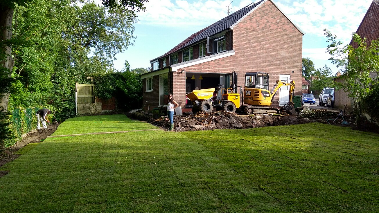

daiking Posted July 16, 2017 Author Share Posted July 16, 2017 I go away for cub camp and wtf? 2 Link to comment Share on other sites More sharing options...
PeterW Posted July 16, 2017 Share Posted July 16, 2017 She's done well ..!! Link to comment Share on other sites More sharing options...
Onoff Posted July 16, 2017 Share Posted July 16, 2017 Fair play to her. You should go away more often! Maybe if I fecked off for a bit the bathroom would get done... 2 Link to comment Share on other sites More sharing options...
daiking Posted July 17, 2017 Author Share Posted July 17, 2017 6 hours ago, PeterW said: She's done well ..!! Don't go there. She always leaves more questions than she answers. Anyways must go water the thing for an hour before work. Did you hear the joke about the Welshman who knew the secret of guaranteeing nice weather? His wife got a lawn laid at the worst time of year. I'm calling a summer hotter than 1976. 1 Link to comment Share on other sites More sharing options...
jack Posted July 17, 2017 Share Posted July 17, 2017 Oh dear. Are you on metered water? We were going to bite the bullet and plant our back garden in early summer, knowing it was a bad time of year and accepting that there'd be a lot of watering. But then it just didn't rain for week after week, then we had that really hot spell. In the end we decided we can look at the weeds for the rest of summer and plant when it's cooler. Link to comment Share on other sites More sharing options...
ProDave Posted July 17, 2017 Share Posted July 17, 2017 That's looking good. Get yourself a sumbirsible pump and water it from the water in the stream. Link to comment Share on other sites More sharing options...
PeterW Posted July 17, 2017 Share Posted July 17, 2017 8 minutes ago, ProDave said: That's looking good. Get yourself a sumbirsible pump and water it from the water in the stream. I was half way through typing the same post @ProDave..!! Get a bucket and drill some small holes in it all round and submerse that into the stream - pump goes into the bucket and keeps all the big crud out of the water. You may want a strainer on the output too if it's going to a sprinkler. Link to comment Share on other sites More sharing options...
Onoff Posted July 17, 2017 Share Posted July 17, 2017 Get yourself a BFO trampoline (with net) and set it on bark / landscaping fabric. That'll keep the kids occupied whilst the grass establishes itself. And stepping stones too as required. Link to comment Share on other sites More sharing options...
daiking Posted July 17, 2017 Author Share Posted July 17, 2017 We are metered, will just have to take the hit, think it's about £4/cu metre. Don't think there enough water in the brook to run a pump. I'll have a look tonight. Biggest problem is having to move the sprinkler round so I'm going to buy 3 more and just swap the tap connections to rotate them. We have a bfo trampoline that I had to take down and a playhouse. Kids only have 8 days to wait till the go on their hols so theyll be ok. Overcooked it on the turf, got 25 rolls spare Link to comment Share on other sites More sharing options...
PeterW Posted July 17, 2017 Share Posted July 17, 2017 4 hours ago, daiking said: Don't think there enough water in the brook to run a pump. I'll have a look tonight. As long as there isn't anything below the level of the bank for a good way up stream you can always build a temporary dam with some blocks and some plastic sheeting - cover the bottom of it with some gravel and it will stay fairly watertight for you. Just raise it by 8-10" at most. Link to comment Share on other sites More sharing options...
