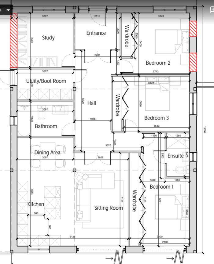

Your drawings show the portal frame to be aligned with the external surface of the external walls of the original building. Under Class Q it would be best to leave these entirely outside the thermal envelope and avoid any thermal bridge. Since the uprights connect to the primary roof structure, I'd also leave the roof beams and purlins outside the thermal envelope, as steel has exceptionally good thermal conductivity.

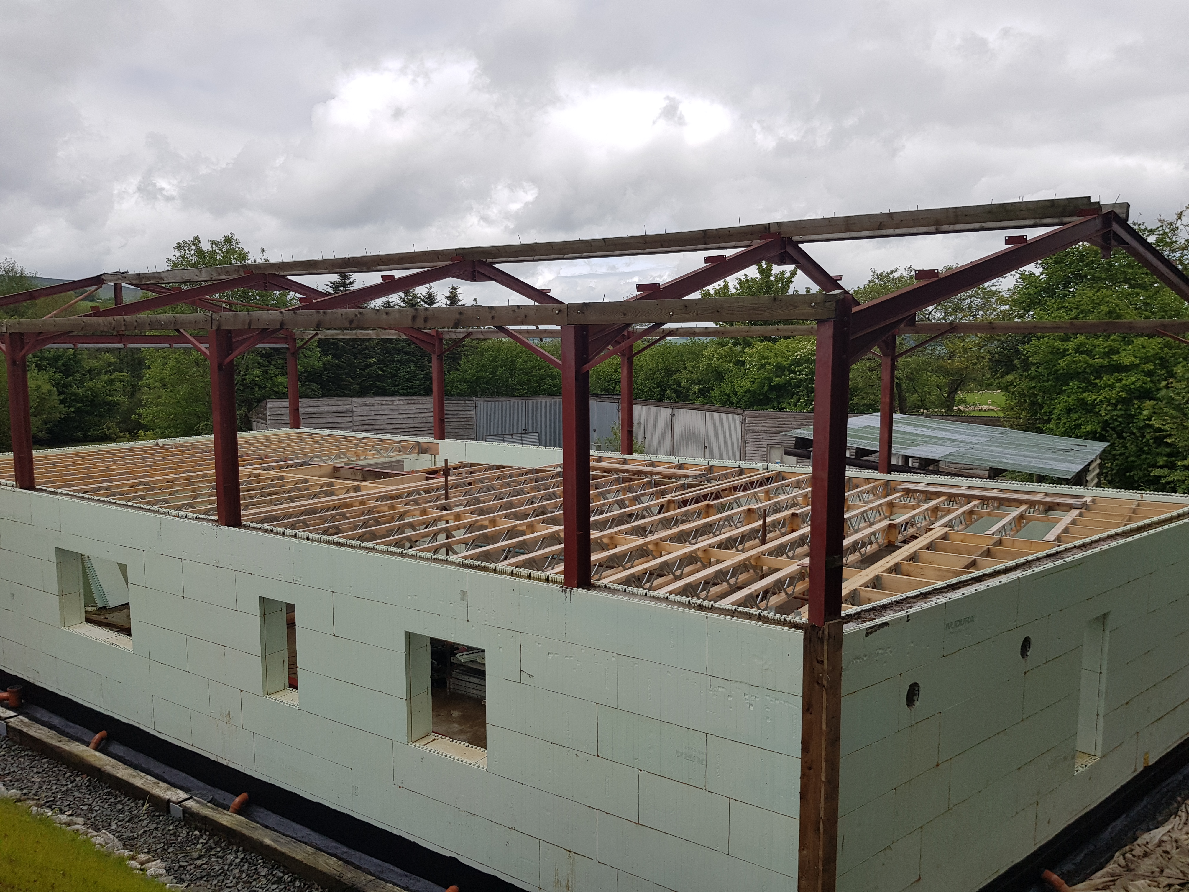

In order to not have the building performance compromised by the steel portal frame, I built an I-Joist timber structure (walls & roof) within the portal frame, dovetailing the timber structure around the steel structure, but not letting them touch. The Steel portal frame is still in place, including the roof portals and Z Purlins, which continue to hold up the light weight rains screen, which in my case is a standing seam metal roof. The timber structure supports the 300mm - 350mm blown cellulose fibre insulation in the walls and roof, as well as the mezzanine.
The internal columns of the portal frame took some careful detailing to keep those outside the thermal envelope.

I'm going by the drawing provided that shows the outside surface of the Portal frame level with outside surface of the wall. I had assumed the profile sheeting is just in the upper areas, a short distance down from the eaves, as is typical with agricultural portal frames.
Even if the profile sheeting went from eaves to floor, the 40mm that gives you, outside the portal frame is insufficient to stop a thermal bridge. You still need a rain screen on the outside of any insulation.

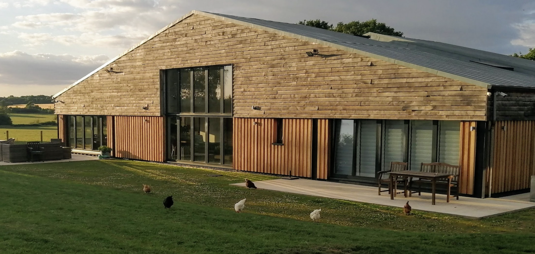

How I dealt with that was to have an upper cladding outside of the portal frame, in the same way the original profile sheeting was, but have the lower cladding inset, level with the portal frame, in the same position the original walls were, which means the portal frame is still visible externally at the lower level, as it was on the original building.

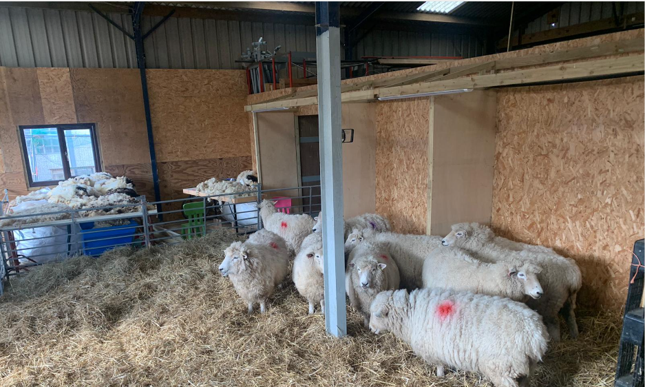

On 03/12/2022 at 21:16, Tosh said:
@Tosh This is EXACTLY what i was thinking, haven't been able to find any examples of this but what you've done matches my thought process. I'm guessing you've had to apply for full planning approval for this rather than a class Q?  How di you finish the insides and outside of the ICF, it looks like a sensible construction method to be as you gain the thermal mass, structure and insulation without losing too much floor space which is critical in my build. Are you able to provide anymore photos. Happy to private message me if that helps. Great build!!!
