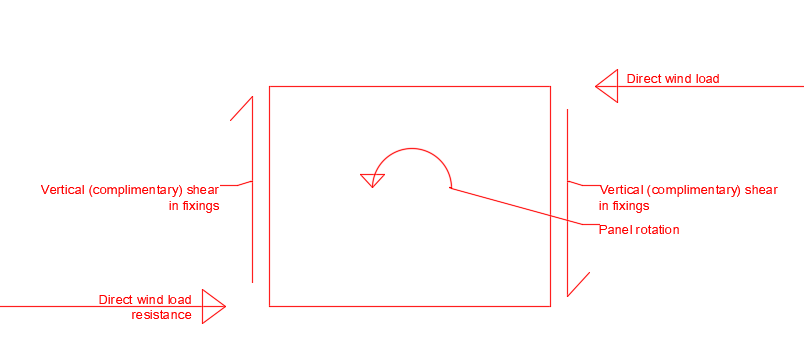

ruggers Posted November 22, 2022 Author Posted November 22, 2022 On 22/11/2022 at 22:17, ProDave said: The two bits in bold seem to contradict each other. either these are load bearing or they are not. Expand They don't, lateral support isn't vertical loading. They are stud walls are to be faced with ply to help prevent the upper elevation walls from falling inwards under high winds over time, they are required because my ground floor load bearing walls don't continue up into the first floor. The Joists are supported on the ground floor load bearing walls and the roof trusses support themselves over the span.
Gus Potter Posted November 23, 2022 Posted November 23, 2022 (edited) On 22/11/2022 at 23:10, ruggers said: They don't, lateral support isn't vertical loading. Expand Unfortunately it often partly ends up that way, a non load bearing racking wall can catch you out. Advise you stick with your SE's specification. In written form you have a timber frame panel that carries no vertical load but it needs to stop things moving sideways. Say the top of the panel is loaded horizontally. This horizontal force gets transferred to say the floor below that resists the horizontal force. Now you have two forces acting in equal an opposite directions but they are separated vertically. This introduces an overturning effect into the panel. We call this a complimentary shear force. The static laws of physics say that for a body to remain still every force has to have an equal an opposite force. Thus even though your panel is not carrying a vertical load.. only a wind load the vertical fixings at on side will be subject to uplift and at the other side a downwards force. That is why you may wonder why your SE has come up with what may seem an onerous spec. On 22/11/2022 at 21:53, ruggers said: Chemical anchors seems a bit over the top and m10 rawls. Expand Edited November 23, 2022 by Gus Potter 1
ruggers Posted November 25, 2022 Author Posted November 25, 2022 On 23/11/2022 at 00:51, Gus Potter said: Expand So the Chemical anchors are also for shear strength in vertical loads where as normal masonry screws or screws and plugs could loosen or bend essentially? There would need to be a lot of direct win load and wall movement to move the block work and timber frame though to band screws? The posi webbed joists under each stud wall are designed with noggins so look like a ladder under the 22mm floor decking. On 23/11/2022 at 00:51, Gus Potter said: Expand
