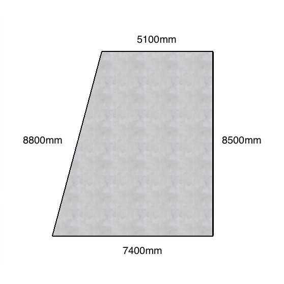

Russdl Posted November 16, 2022 Share Posted November 16, 2022 The future garage/workshop so far... I've decided on: Geocell foundation and a reinforced concrete raft. Flat roof supported by UB steels. External render finish to match the house. Next on my list of decisions is the walls. Plan A: Stick build on site (I can probably do the vast majority of that). Plan B: Block work walls (I can probably do about none of that). The garage will be irregular in shape to get the most out of the space available (trapezoidal is a word I've not used in decades that doesn't exactly spring to mind?) dimensions below. It will be within 1m of the boundary on three sides. Questions, questions, but I'll start with: Are there good reasons why I should choose stick build over blockwork or blockwork over stick build? Link to comment Share on other sites More sharing options...

PeterW Posted November 16, 2022 Share Posted November 16, 2022 You’ll need BRegs for that anyway so I would be going the route of what the BCO wants. By supporting the roof with UBs, do you mean steel span and infill or something else..? If you’re using steel for joists you may well use it for uprights then just drop blockwork in the gaps too. Timber is easier to insulate as you don’t need a dual skin although I would consider EWI as the carrier for the render and get best of both worlds. Not sure why you would need Geocel for the foundations ..? And just use fibre in the raft for reinforcement at 150mm as its going nowhere. 1 Link to comment Share on other sites More sharing options...
Russdl Posted November 16, 2022 Author Share Posted November 16, 2022 51 minutes ago, joe90 said: My workshop is block because I wanted to hang lots of stuff on walls and didn’t want to have to find studs That's a plus for block for sure. 55 minutes ago, joe90 said: Render on blockwork has got to be easier/cheaper than on a stick frame Indeed, but I want the garage insulated so if I went block then I'd go EWI and render that adding complexity/costs. 56 minutes ago, joe90 said: with a stick frame and what would you would use to clad the frame to render on? On the house its batten/counter batten, render board, silicone render. No issues so far but added complexity and costs, apart from the render I can do all the rest. 45 minutes ago, PeterW said: You’ll need BRegs for that anyway so I would be going the route of what the BCO wants. I will need building regs but I reckon I can choose my method. Blockwork would easily please them but they're au-fait with timber frame as well, they oversaw the house construction. The timber frame house has an elevation 1m from a field so we had several modifications to that elevation to satisfy the fire regs. 44 minutes ago, PeterW said: By supporting the roof with UBs, do you mean steel span and infill or something else..? Yes, steels spanning, timber joists, warm roof. 50 minutes ago, PeterW said: If you’re using steel for joists you may well use it for uprights then just drop blockwork in the gaps too Now that's a good point. I presume then I wouldn't need piers along the the two >8m walls? piers would be getting in the way of the side opening sectional door. 55 minutes ago, PeterW said: Not sure why you would need Geocel for the foundations ..? Insulation and ease of use. 56 minutes ago, PeterW said: And just use fibre in the raft for reinforcement at 150mm as its going nowhere. By that you mean no re-bar? 1 Link to comment Share on other sites More sharing options...

Russdl Posted November 16, 2022 Author Share Posted November 16, 2022 So, if I find a retired bricky who's up for it I can labour for him whilst he builds me a fantastic block wall which will be external insulated and rendered and probably just painted on the inside. But what blocks should I use? There seems to be quite a choice. Link to comment Share on other sites More sharing options...
BenP Posted November 16, 2022 Share Posted November 16, 2022 Timber Frame - would have to be OSB sheathed anyway - put this on the inside layer for hanging things etc. Would also be easier to get a decent level of insulation too. 140mm flexible batt between 600 c/c studs. Simple. I think this is the route I'm going. Unless I decide to teach myself some brickwork. Generally prefer dry trades though!!! 1 Link to comment Share on other sites More sharing options...
PeterW Posted November 16, 2022 Share Posted November 16, 2022 15 minutes ago, BenP said: Timber Frame - would have to be OSB sheathed anyway - put this on the inside layer for hanging things etc. Would also be easier to get a decent level of insulation too. 140mm flexible batt between 600 c/c studs. Simple. But within 1m of the boundary needs significant fireproofing which negates all the benefits. That’s the problem with this sort of project. 1 hour ago, Russdl said: So, if I find a retired bricky who's up for it I can labour for him whilst he builds me a fantastic block wall which will be external insulated and rendered and probably just painted on the inside. But what blocks should I use? There seems to be quite a choice. Standard 100mm medium weight blocks - cheapest you can find - and infill between steel frame (ie inside the webs) and then insulate the lot externally. You could use paint grade blocks but tbh they aren’t worth it. 1 1 Link to comment Share on other sites More sharing options...

Russdl Posted November 16, 2022 Author Share Posted November 16, 2022 @BenP stick build was always top of my list, mainly because I think I could do it all. The concerns were the fire regs affecting three elevations. The >8m walls without any partition walls adding strength. If I pushed hard enough would they fall over? (I don't know if that is a real or imaginary worry?) 1 hour ago, PeterW said: Standard 100mm medium weight blocks - cheapest you can find - and infill between steel frame So the block option looks like I get a couple of 'goal post' steels made up, medium weight blocks between them (and no piers on the two long walls), EWI on the outside and I'm home and dry. @Adrian Walker yep, just garage/workshop etc. No plans to annex it later. Link to comment Share on other sites More sharing options...
markc Posted November 16, 2022 Share Posted November 16, 2022 (edited) 8m walls are no problem with staggered joints on top and Sill plates. Temporary prop if it’s really windy until you get a central truss or joist in to brace against. Edited November 16, 2022 by markc Link to comment Share on other sites More sharing options...

markc Posted November 16, 2022 Share Posted November 16, 2022 8 minutes ago, Russdl said: Thanks for that - so it was an imaginary worry. 👍 Not really, if you were framing it all with 3x2 then it would be incredibly flimsy and fragile, but a decent framed wall with tight joints is surprisingly stiff and once you have some plan bracing in they will stand up to knocks are high winds 1 Link to comment Share on other sites More sharing options...

Russell griffiths Posted January 30, 2023 Share Posted January 30, 2023 Reading all this it looks like a project for icf blocks. Can be self built, no additional help needed. One concrete pour so reasonable pump costs. Render outside, no problem. Clad the inside in 18mm osb and paint. Link to comment Share on other sites More sharing options...
saveasteading Posted January 30, 2023 Share Posted January 30, 2023 On 16/11/2022 at 15:04, PeterW said: within 1m of the boundary needs significant fireproofing Noticed this late. It depends in the field. If 'unlikely to be developed' then it doesn't need protection. Might need justification such as green belt / aonb. My favourite, for what it is worth, esp if you can DIY it, is timber...it always fits. Unless having a heavy roof, when use masonry. Link to comment Share on other sites More sharing options...
Russdl Posted January 30, 2023 Author Share Posted January 30, 2023 6 hours ago, rich1899 said: Do you have planning permission in place? I see that you proposed build is over 53m2 No. I plan on doing it under Permitted Development. Have I missed something vital? From all I’ve read I don’t see that I need planning for the proposed garage. Link to comment Share on other sites More sharing options...
Russdl Posted January 30, 2023 Author Share Posted January 30, 2023 4 hours ago, Russell griffiths said: Reading all this it looks like a project for icf blocks. That would probably work but was never on my radar so has not been considered. The plan is now block built, with rendered EWI outside. Link to comment Share on other sites More sharing options...
