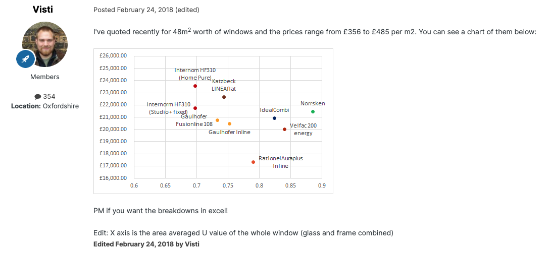

DavidG Posted November 11, 2022 Share Posted November 11, 2022 Hello all, New here, so be gentle! 🙂 I'm trying to set up for an EnerPHit project on our house here and am really struggling with the windows. Having found this site through searching for this type of issue I found a fantastic chart by @Visti to compare the prices vs Uw values for a multitude of suppliers. It's really interesting to see, however as it's now nearly 5 years old I wondered if anyone has created an updated version at all? After many months of wrestling I have a quote for some Rationel windows and it's alarming to say the least and I can't think that it's simply gone up by that much in 4-5 years. I have had a scout through more recent posts, but could find anything. 1 Link to comment Share on other sites More sharing options...

craig Posted November 11, 2022 Share Posted November 11, 2022 You may find this useful? 1 Link to comment Share on other sites More sharing options...
