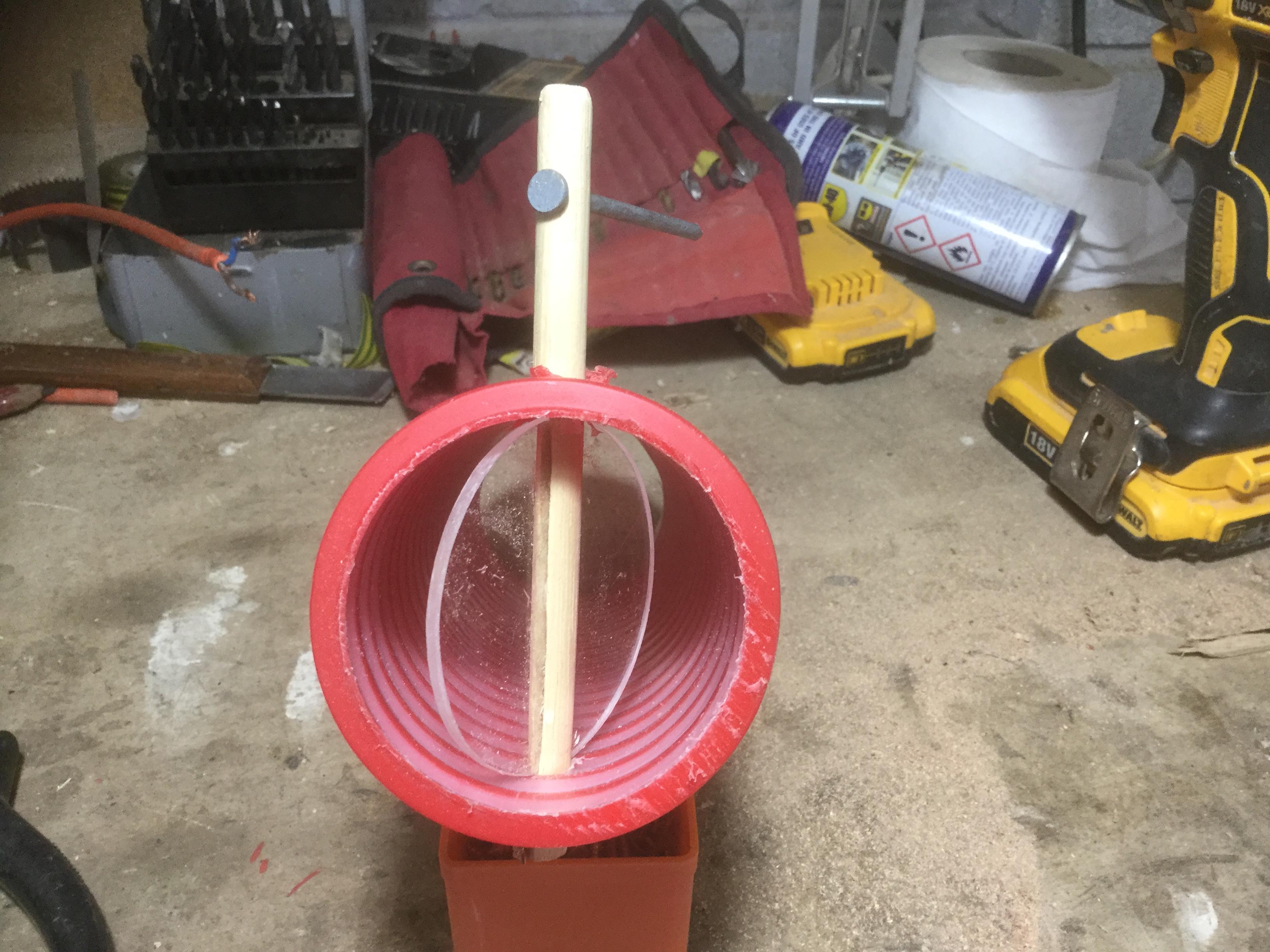

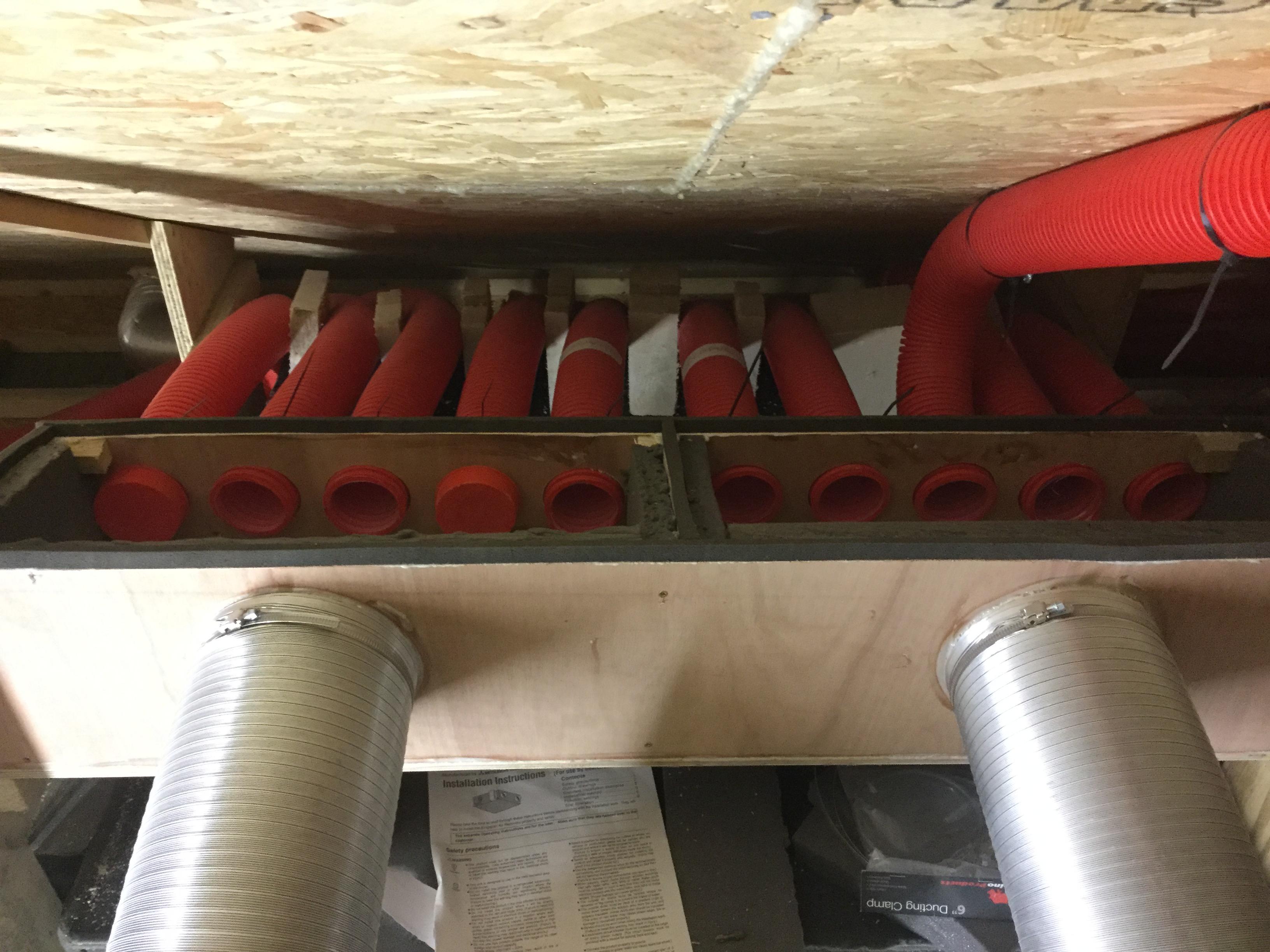

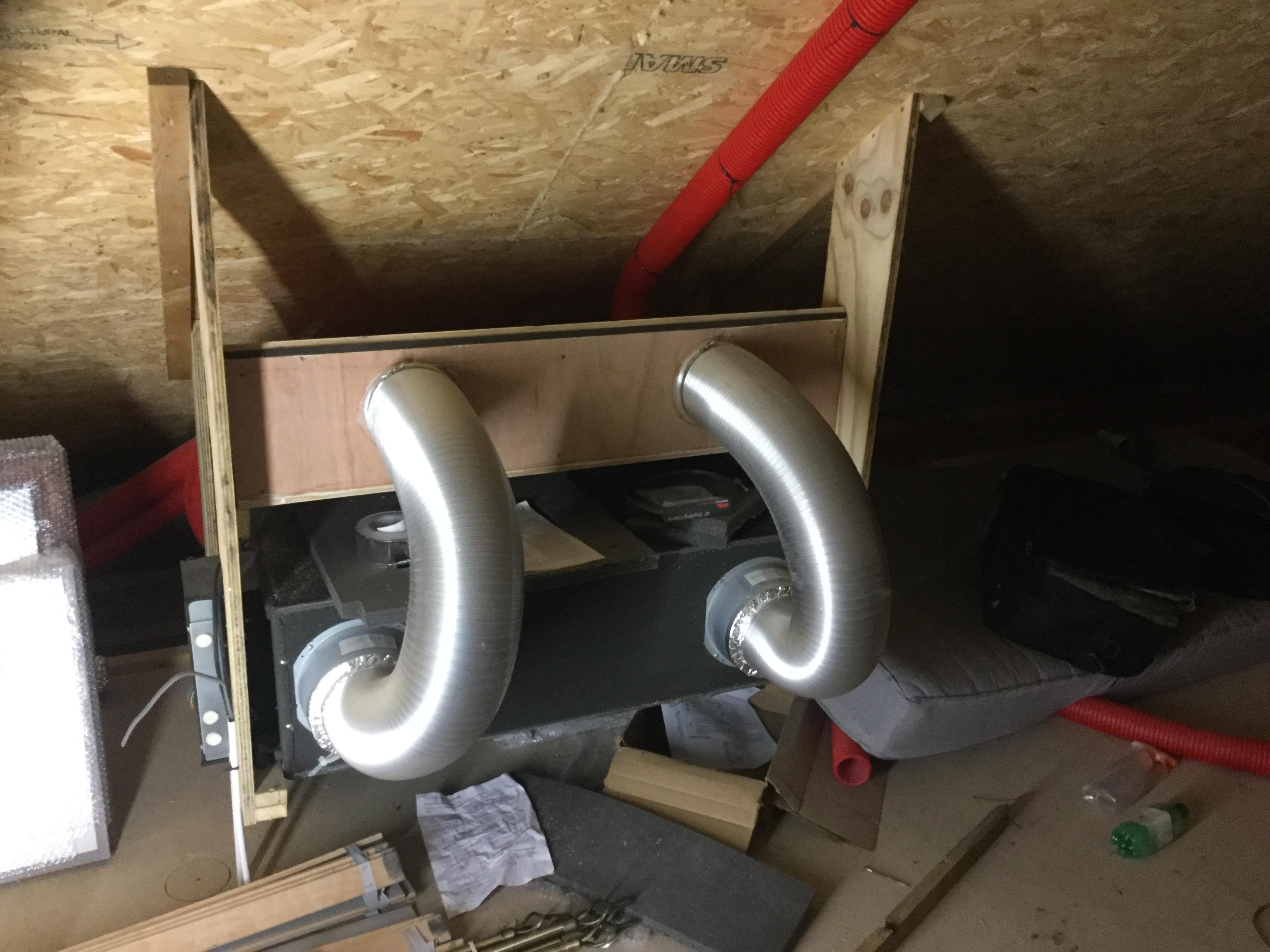

joe90 Posted November 10, 2022 Posted November 10, 2022 7 hours ago, SteamyTea said: Ask @joe90 I think he had this problem. Nope, sorry mate, mine is virtually silent (you have to listen hard to hear slight air movement noise unless on boost) 7 hours ago, Nickfromwales said: Radial will get you as close to silent as possible. +1, and I made my own manifold and lined it with acoustic foam to act as a silencer as well, also the flow adjusters are at the manifold not the outlet into the room (these can create noise as they are throttling the air in the room) 2
Jenki Posted November 10, 2022 Posted November 10, 2022 3 hours ago, joe90 said: I made my own manifold and lined it with acoustic foam to act as a silencer as well, also the flow adjusters are at the manifold not the outlet into the room (these can create noise as they are throttling the air in the room) any photos / details of your DIY manifold and flow adjusters? please
joe90 Posted November 11, 2022 Posted November 11, 2022 Flow adjusters are real Heath Robinson but they work,
Jenki Posted November 11, 2022 Posted November 11, 2022 (edited) thanks for the picture @joe90👍. Love it, Heath Robinson or not, if it works and saves some money I'm in... @joe90 - hanging from the roof do you get any resonance? Edited November 11, 2022 by Jenki

joe90 Posted November 11, 2022 Posted November 11, 2022 11 hours ago, Jenki said: @joe90 - hanging from the roof do you get any resonance? None, hung from roof so not connected to ceiling joists, also on rubber feet. 11 hours ago, SteamyTea said: You may have noticed that his loft is a warm roof, and I think he sucks some of the warmth out of it, as well as the rooms. Yes, I had a spare extract so ran it up to the ridge within the warm roof. 11 hours ago, crispy_wafer said: Like placing an extract vent (like bathroom & kitchen) to capture the warmer air? Yes 11 hours ago, SteamyTea said: can answer that, having been imprisoned in @joe90's attic. Don’t read anything into that 😱, he was installing his monitoring kit , honest 😇
Dave Jones Posted November 15, 2022 Posted November 15, 2022 On 11/11/2022 at 07:52, joe90 said: must be great breathing in all those particles of perished rubber around the lid. Crazy to bodge and skimp on a couple hundred quid manifold ... 1
