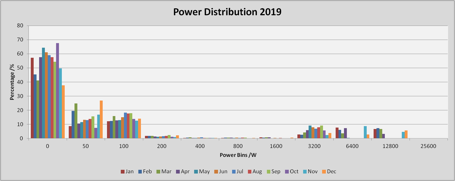

SteamyTea Posted November 7, 2022 Share Posted November 7, 2022 1 hour ago, jack said: Yes, exactly. There's no point me saying my baseload is 300 W if we don't all understand whether that includes intermittent devices like fridges (intermittent but pretty regular) and cookers (intermittent and less predictable/regular than a fridge). Where you need to use a distribution. Here is mine for 2019. Just be careful with the x-axis as it doubles in value for each bin. You can see when the DHW is on (3200 bin) DHW and 1 storage heater (6400 bin) and DHW, both storage heater and the washing machine (12800 bin). Really hard to tell if base load should be 0 W (0 bin), greater than 0 W and up to 50 W (50 bin). The means are 0W 54%, >0 <=50 15.2%. At nearly 15.2% below 50W, over a year, that is a maximum of 66 kWh, or 0.2 kWh/day, which is not far off what my fridge uses (bit more in the summer, bit less in the winter). My fridge is the only think that can come on when it wants to. Link to comment Share on other sites More sharing options...

SteamyTea Posted November 7, 2022 Share Posted November 7, 2022 7 minutes ago, Alan Ambrose said: For those that have 'zero energy' periods - how do you do that !?! You don't have a fridge Not a contiguous period, just the sampling averages (around every 8 seconds). A fridge, if working properly and not installed next to something hot i.e. radiator, oven, over UFH, will consume very little. Especially if it is full of stuff. Most food is water, so lots of energy transfer is needed to change the temp by 1⁰C. Thinking about it a bit more, a period of zero draw cannot be considered base load. It could be included in the under 100 W range (or 50 W, or 300 W). My fridge has a mean power draw of about 8 W. 1 Link to comment Share on other sites More sharing options...
jack Posted November 7, 2022 Share Posted November 7, 2022 1 hour ago, SteamyTea said: Where you need to use a distribution. But yours will look very different to mine, in a way that probably can't be distilled into a single meaningful number. Perhaps "baseload" is not actually that useful a term. Link to comment Share on other sites More sharing options...
SteamyTea Posted November 7, 2022 Share Posted November 7, 2022 7 minutes ago, jack said: But yours will look very different to mine, in a way that probably can't be distilled into a single meaningful number. Perhaps "baseload" is not actually that useful a term. Skew may be useful. Link to comment Share on other sites More sharing options...

Radian Posted November 7, 2022 Share Posted November 7, 2022 8 hours ago, jack said: Is there a formal definition of "base load"? If it means the absolute minimum, then we're somewhere around 300 W. This is what, I think, is the most useful take-home about baseload - when it represents the minimum power draw from a house. Dynamic loads like fridges, lights and central heating pumps are all very dependant on occupancy and time of year and are best represented by averages. But the minimum power draw is a figure that we can use to spot problems that are costing us unnecessary expense. Having read how @jack had a UFH pump running unnoticed I've now implemented a node-red function that monitors daily minimum and sends me a notification if it's exceeded by more than a threshold value over a 24H period. Going to be a bit of fine-tuning to get it to the point where it's useful but I haven't seen any obvious problems yet. 1 Link to comment Share on other sites More sharing options...

SteamyTea Posted November 8, 2022 Share Posted November 8, 2022 13 hours ago, Adsibob said: calculated how much power they consume I eat about 2.5 kWh/day and my house uses just a bit more. If I 'worry' and hour away on here, this 0.25 kWh. 9 hours ago, Radian said: minimum power draw is a figure that we can use to spot problems It is how I spotted my fridge had gone wonky. Link to comment Share on other sites More sharing options...
jack Posted November 8, 2022 Share Posted November 8, 2022 10 hours ago, Radian said: But the minimum power draw is a figure that we can use to spot problems that are costing us unnecessary expense. Having read how @jack had a UFH pump running unnoticed A more important one, which I mentioned in another thread, was a fan heater that my son left running full bore overnight in the garage gym. The gym sometimes isn't used for a few days at a time, so that could have been an expensive one. I only noticed it because the display screen for our smart meter is in my office, and it was showing high and persistent energy consumption despite the fact I knew nothing significant should be on. Link to comment Share on other sites More sharing options...
