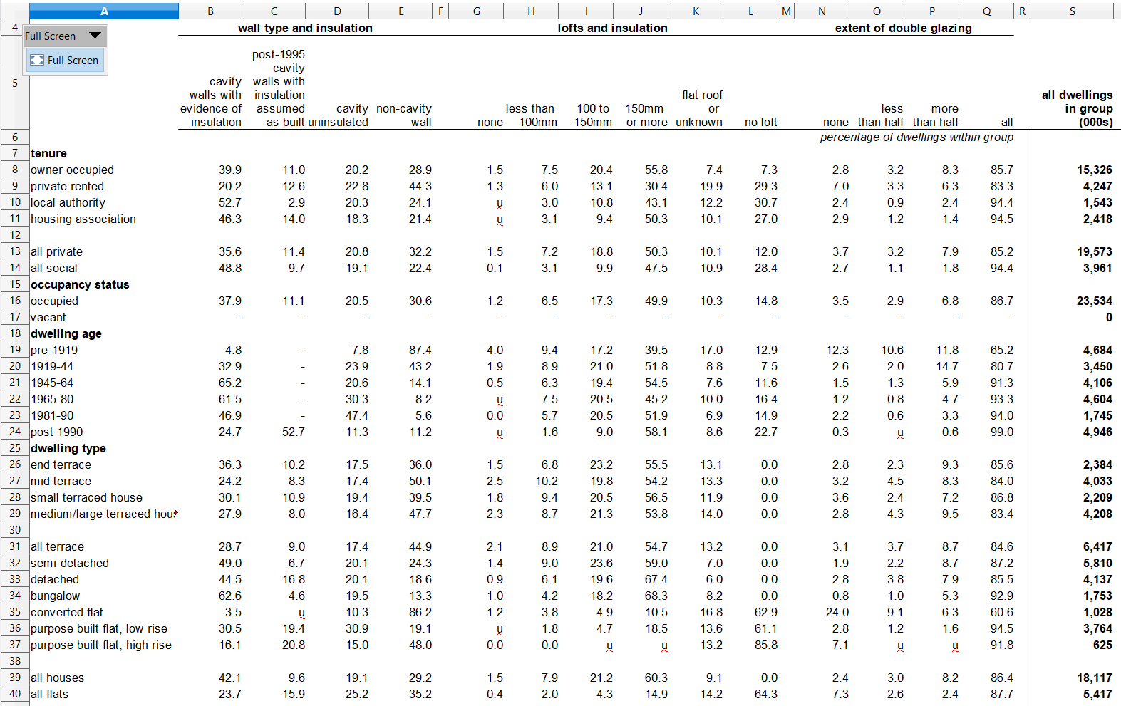

I think those claims are somewhat overegging it, and perhaps overstating the potential.
But I think it depends what you are talking about reducing - presumably the heating cost on a totally uninsulated house?
You won't achieve that when the traditional model for a trad house (eg as used by Energy Saving Trust) has 25% of heat losses via air leakage, and some more (10%?) via doors and windows which can't be insulated.
If working on overall society-wide numbers we also need to remember that the average EPC number is already up at around 68, so we already have a big chunk of the low hanging fruit.
This is the shift from 2010 to 2020. It becomes more difficult and far less cost-effective once your trad house gets to a C, and we will need to rely more on decarbonised energy supplies there.
F
On insulation, these are levels by house type etc from the 2022 English Housing Survey.
Again there is still much opportunity, but we have a lot of the low hanging fruit already. This table really rewards detailed study - for houses with trad lofts we are down to 10-15% only having less than 100mm .
The tough ones are the hard-to-insulates. Solid walls, no loft, flats etc.
