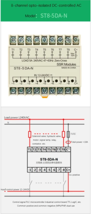

2 minutes ago, Thorfun said:
I'm wondering if the constant draw from the blind is too much for a single dimmer channel on the Whitewing
Why on earth are you using a dimmer channel to drive a blind? Why not just a relay or a straight SSR controlled from a Loxone output.
because @joth said so! 🤣 (obviously a joke and I apportion no blame at all on anyone on this forum who gives advice)
how would I control the SSR if not from the DMX 24V dimmer?
the whole journey down the SSR route being triggered via the DMX dimmer was because I didn't want to fork out for another Loxone relay extension which wouldn't even have enough outputs for all my blinds! I have 8 blinds so need 16 relays.
I have been on many journeys of discovery during our build and this was another one. some work and some don't but that is the beauty of the journeys.
The output of the dimmer driving the SSR sounds like a problem as the dimmer won't be plain on/off it will be a series of pulses / a shaped waveform unless you can set it to be just on/off - it might get upset being turned on / off at 1000 times a second. It won't draw any /much current either. Is the SSR OK to get a 24v signal?
it's a good point. it could the PWM causing the issue. I hadn't considered that. but my test tomorrow of wiring one blind directly to the Loxone relay will let me know if it is the issue.
The SSRs have 24V signal on one side and switched 230V on the other.
so the DMX 24V dimmer GND output for a channel connect to the 24V side to trigger the SSR.
it worked perfectly when I wired the blind up to a Loxone relay output. I think I'm just going to bite the bullet and buy another relay extension. it's expensive but if it just works it saves me time and hassle which you can't really put a price on, right?

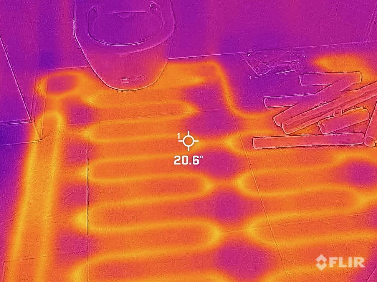

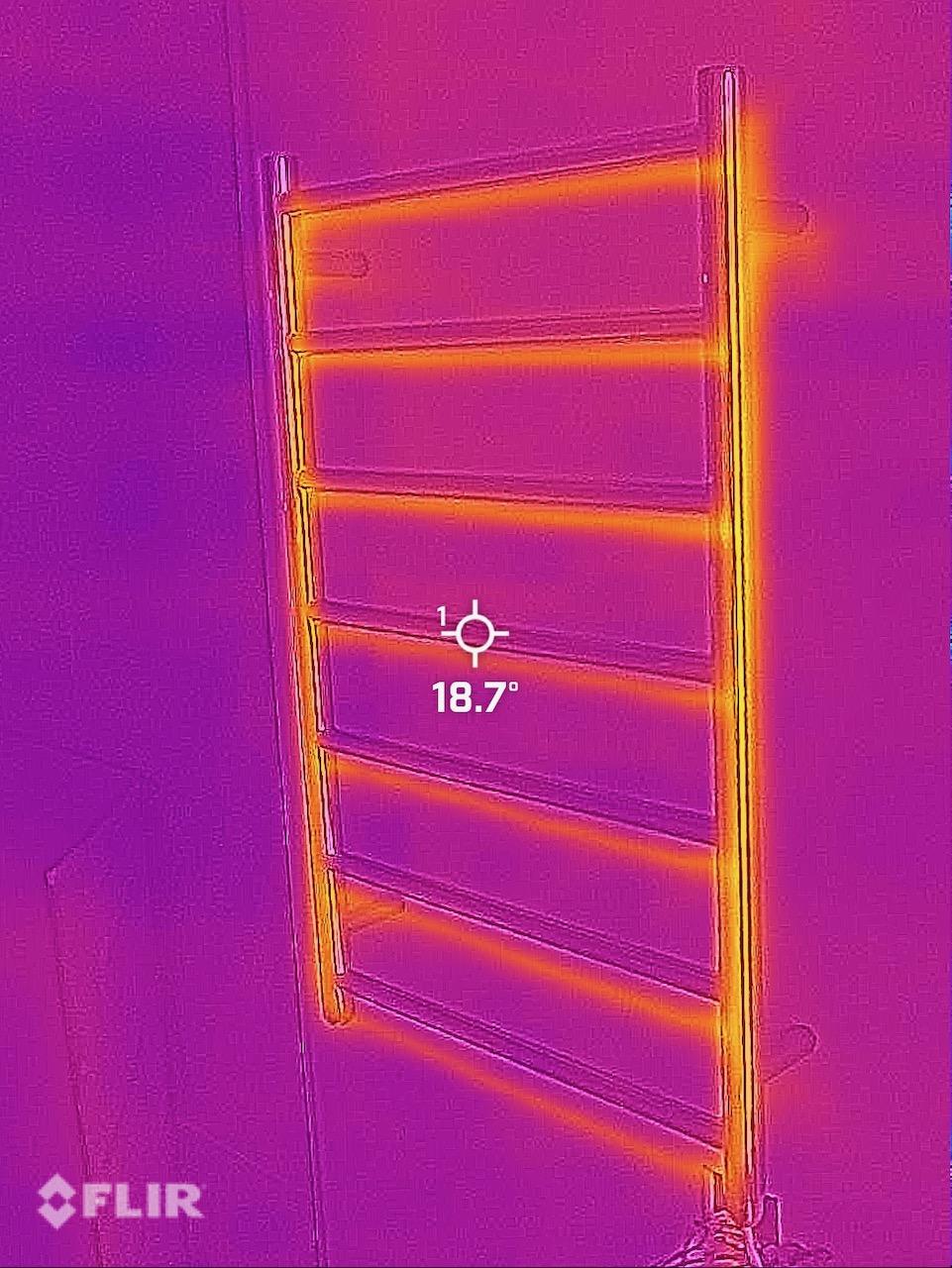

also today I got the 1-wire extension wired up and my UFH temp probes from the bathrooms connected and the electric UFH and towel radiators are now working nicely. 🙂

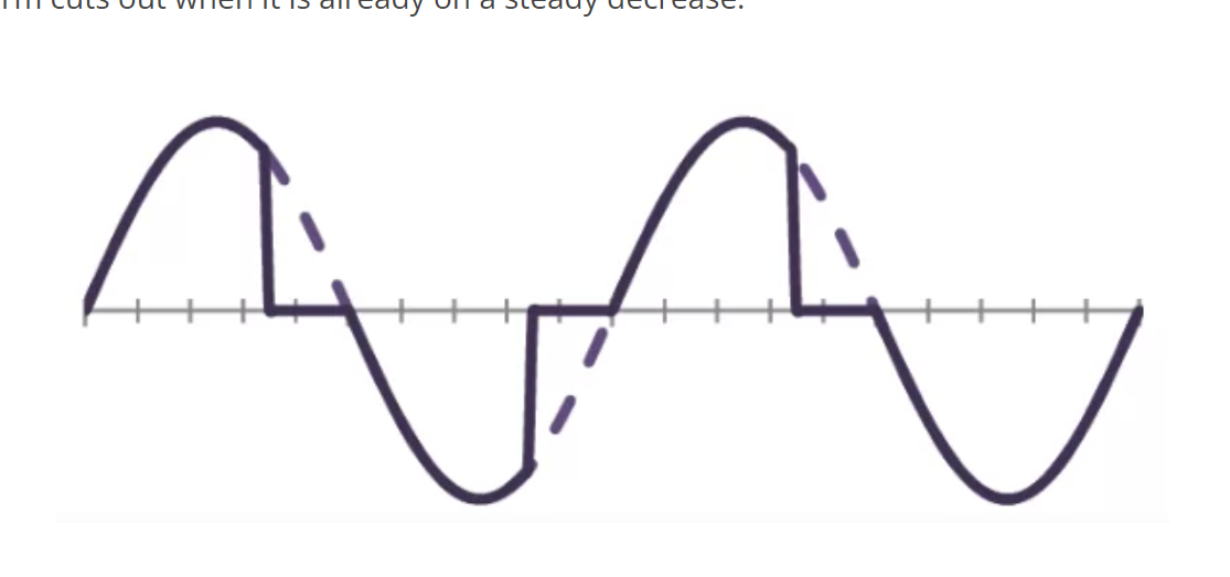

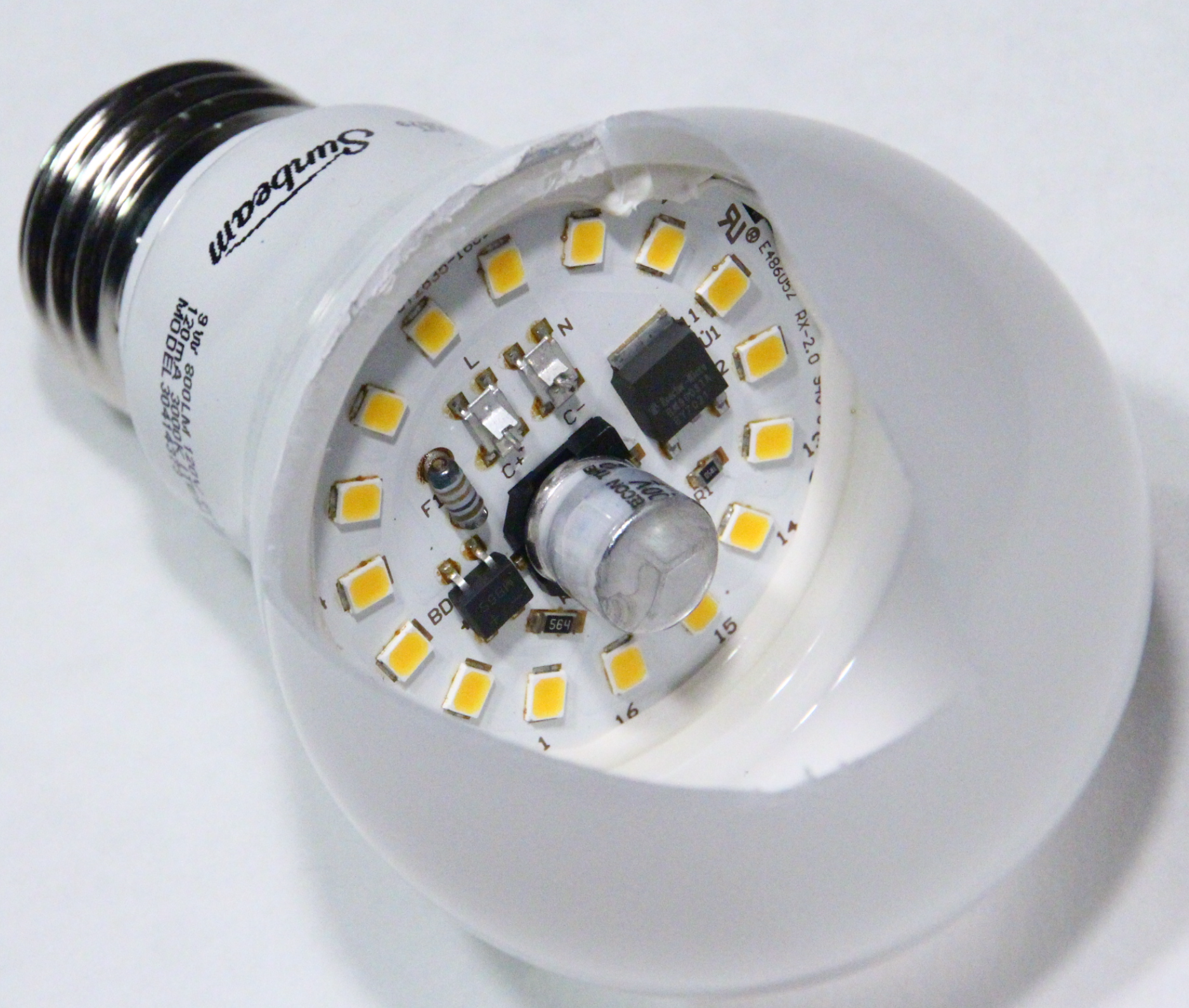

I have 230v Loxone dimmer configured for "trailing edge" driving some bollard lights on the front drive.  They dim down to 8% before they turn off or start to behave weirdly.  Don't know if it's the fittings that are good though, or the Loxone dimmer.
Most of the LED drivers (downlights, low-level lighting and LED strips) support 0.1% dimming, others 1% and some track lights at 5% (which is a shame).  Results at such low level of dimming with LED tape and been dissapointing though in my case https://forum.buildhub.org.uk/topic/33333-led-tape-varying-brightness-from-different-modules/.
The challenge with mains dimming LEDs is the forward voltage of the LEDs themselves, the circuit configuration of the LEDs, the rise across the rectifier, the passive current limiting, and the dimming strategy used. In mains driven off the shelf LED bulbs the best we can expect it a floor in the dimming level for smooth operation.
Each LED in the bulb will need a voltage across it, known as the forward voltage, before it will turn on and if they are wired, in the lamp, in series - which is the preferred choice because parallel needs very closely matched LEDs, then those voltages  add up so you need at least that voltage to turn them on. Given that the forward voltage of an LED varies by colour - because the band gaps needed varies by colour and manufacturer so the turn on voltage varies. White LEDs have the highest forward voltage of most LEDs (UV LEDs are higher) at over 4.5V if driven hard (which you will when used in lighting) so if you have 16 of them all in series then you are going to need 72V to turn them on.
(Image Source Wikipedia)
When you rectify - turn it from AC to DC you get approximately 1.4 x the AC voltage out so 240V AC in becomes approximately 330V DC out (in a perfect world) - its a thing so don't worry about it.  So we have 330V to play with, carefully, but we also have a lower limit of 72V if we want the LEDs on at all. So this gives us 72V as a percentage of 330V which is approximately 22% (Where I got my expectation of the 20% in the above post) but it is not as simple as that.
Trailing edge dimmers, the ones most admired in this application, cut the AC cycle off to a varying degree so for most of the cycle the peak, although truncated, is still above that required to provide 72V after rectification but as it gets towards the end of the wave form the peak remaining is not enough to generate the 72V after the rectifier and the whole thing falls to bits.
Image source: www.ledsupply.com/blog/dimming-leds-guide-how-to-tell-if-your-lights-are-dimmable/
The fact that the lamps get a bit jiggy when you approach this point is down to a combination of a heap of factors which I won't go into but include the fact that the forward voltage required to turn the led drops as the available current drops, as it must when the voltage drops across a fixed current limiting resistor and the ability of the smoothing capacitor to bridge across the tops of the spikes given the now very limited charge voltage and charge times.
Current limit driving of the LEDs is, as @jack says, perhaps the best way forward as you can keep the voltage well above the forward voltage lower limit and just control how much current the LEDs receive and therefore drive them right down to off. Sadly it requires more infrastructure to manage it. Perhaps the best way is to get intelligent bulbs as they rectify the AC and then current control the LEDs so can go down to off but require communications, Wifi, Zigbee, Z-wave, Bluetooth ... to control the brightness, and often colour. Alternatively you could stick with mains dimming and: have fewer lamps on at all if you want lower light, get lower output bulbs so they are not bright at full power or live with the lower limit.
