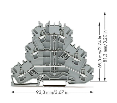

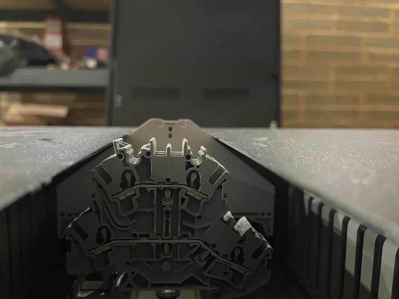

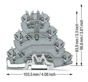

11 hours ago, Rob99 said:
The triple height Wago 2002-3201 that I use will fit in a standard depth FA enclosure if you mount the DIN rail directly on the back with no spacers. The last LXN5 I built was fine with these Wago's and there should be clearance of about 10mm behind the front cover. Also, you can gain another 7.5mm of depth by swapping the standard 15mm deep DIN rail for a 7.5mm deep one if necessary
My triple height Wago's are 70mm.
thanks for pointing this out! that'll teach me to just read the product specs rather than look at the diagram.
the 81.3mm measurement must include the label holder.
I'll just drop the second rail down to the back as well then and be done with it. The Weidmuller ones are only 5mm shallower.
@Dan F, out of interest, which triple decks from Weidmuller are you using that are 50mm? might be that for the few I'm using I could get away without dropping that rail if I switch to Weidmuller TBs for the triple height ones
Looks like the Weidmuller depths include the DIN rail though, whereas the Wago specs exclude it.

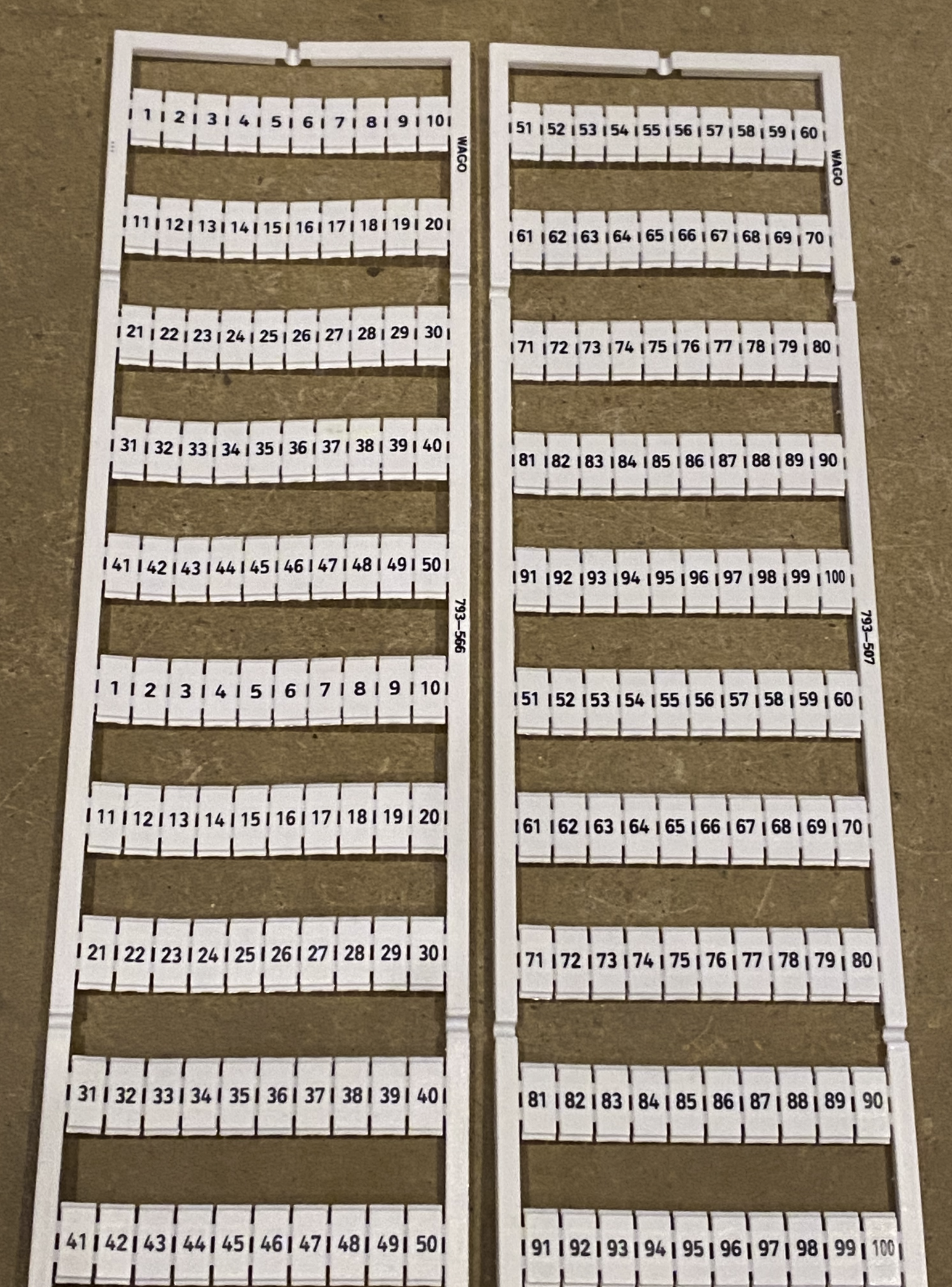

I've honestly not looked in to labelling the terminal blocks yet. most of my Wago blocks didn't come with the label holder as they're more expensive, I obviously made a mistake on those blind terminal blocks though as they came with the label holder.
I've never used the label holders. I just use the standard individual pre-printed number tiles which click into the top of each block. I seem to remember it was a pain to identify the correct wago product reference as there are several different types and most online stores also get confused about which ones fit the 2002 series. I'll have a dig around in my panel build box and check which ones I used.

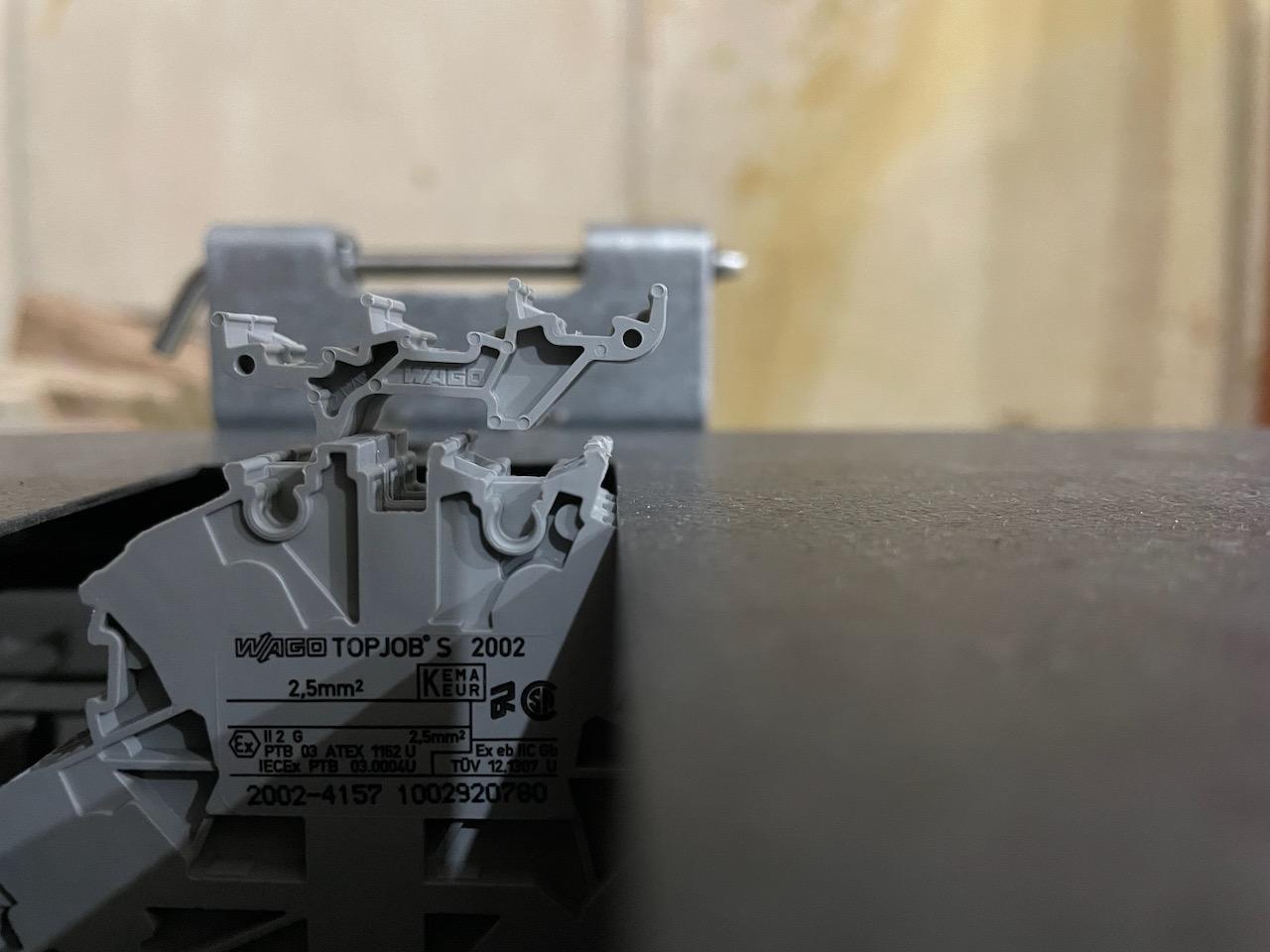

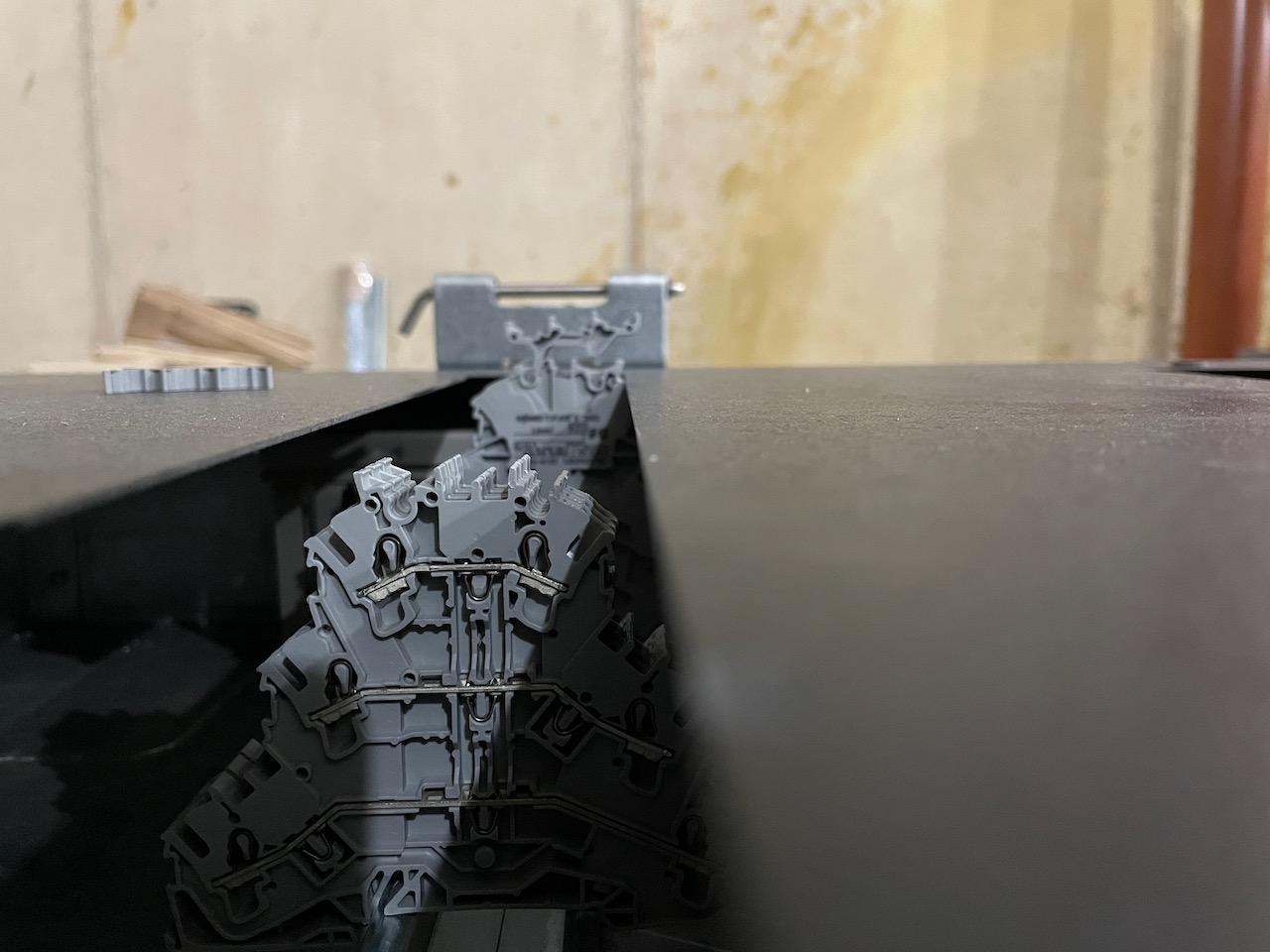

I didn't have much time to play today but I did lower the top rail and the triple deck blocks do definitely fit.
the ones for the blinds though are still proud but I think going to a thinner rail will give enough room.
also, the double deckers don't really fit with the spacer on the din rail so I would either have to get a thinner rail for the second rail or lower it anyway for the triple decks.

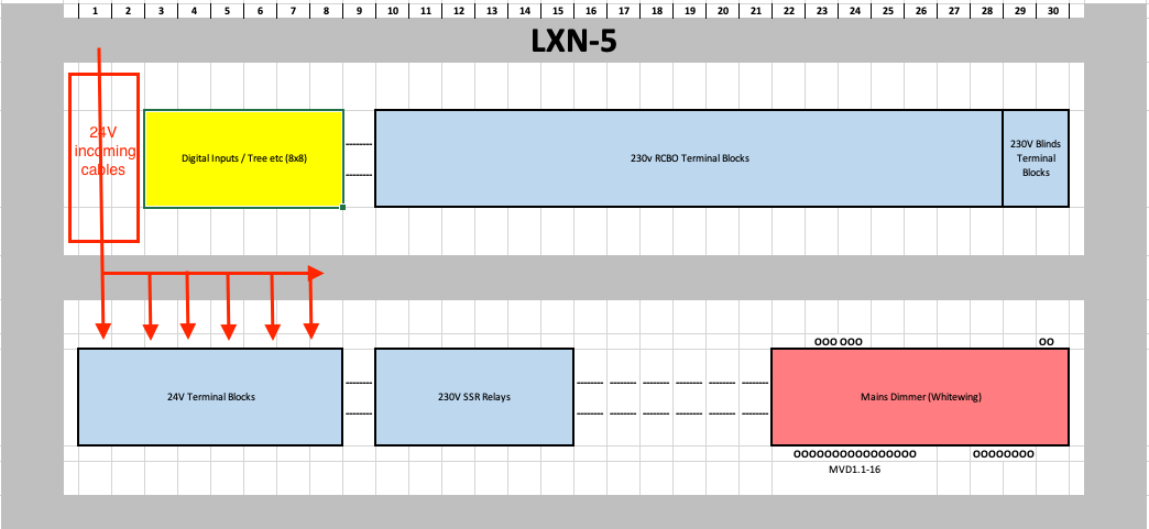

is there anything in the regulations to stop me from cutting a din rail and making new holes in the cabinet to make a bespoke double decker rail like in the LXN deep cabinets? that way I can have a raised rail (or no rail at all) at the far left of the top rail to allow the 24V light cables to be routed to the second din rail and can also drop the second rail as far as the Whitewing RGBW dimmer so that dimmer isn't dropped to the lower rail.
something like this?
so cut the din rail short where the 24V incoming cables is labelled? leaves room to route solid copper T&E cables to the second row. I could also do something similar at the other end to put the blinds terminal blocks on the second row which will make room for the basement 230V terminal blocks.

Right, but if you manage to make things more compect by using these, could you potentially squeeze this onto top rail?
You can do whaever you need with the DIN rails.  In fact, you coul have 30% of the second rail setback fo terminal blocks, and the other 60% set-forward.  I did this on my bottom rail, where I wanted RCBO's raised, but my power distirbution blocks set-back.
ahh....good point and I didn't think of that. will do some calculations.
good to know. I might do something like that then and drop part of the second row as well. it'll be the cheapest option for me at the moment I think and then when I come to fit out the basement I'll hopefully have some money again and can revisit this whole subject and purchase a cabinet extension or something else.
the Wago terminal block I got for the blinds they are actually shallower than the Weidmuller ones at 83.9mm!
No, because the Weidmuller depth includes the 7mm of rail.  So it's actually 83.9mm vs. 81mm and Weidmuller wins by 2.9mm. 🙂.   Oops, now I sound like a Weidmuller fan-boy!
In terms of labelling, do the blocks not support small clip in lables like these?
I used this kind of thing, along with a lablel-holder per-block of terminals that clips into the top of the (shallower) end brackets to write "Blinds" or "5A lighting" etc.

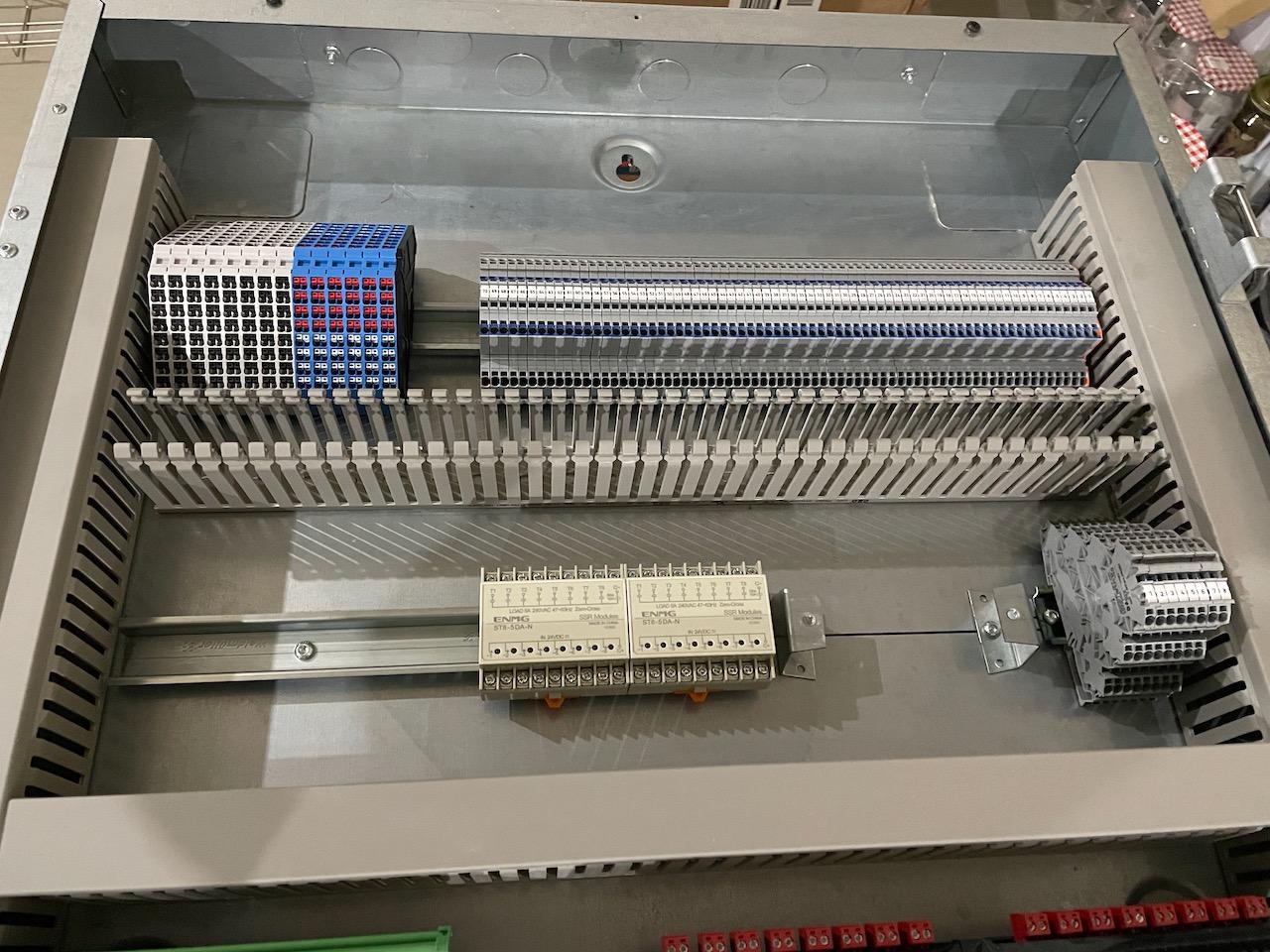

started to finally put all the terminal blocks in. had to move the blind terminal blocks to the 2nd din rail in the end as there just wasn't the room for them on the first rail to also allow for the basement terminal blocks. I'm sure it'll be fine as they're flex rather than rigid cable. and I can run most of the Loxone relay cable up and under the raised din rail that is between the SSRs and blind TBs to save room up the right hand side trunking.
I've numbered the 230V terminal blocks from right to left which looks a bit weird but it leaves room for expansion for them or the 8-ways if required and can then keep the numbers contiguous.
bit frustrated that I now have to buy Weidmuller numbers for those 14 x 8-way blocks. I might just use my label printer though!
