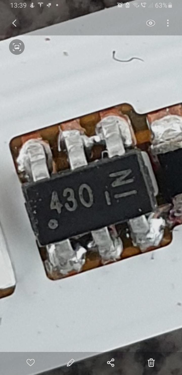

But I can't work out what the on-tape IC is to find a datasheet.  Any ideas?
No active components that I can see surrounding the IC so probably an integrated back-to-back transistor pair configured as a constant current source.

The "Stabilized current design" means that each LED module (10cm with 7 LEDs) has its own driver IC which ensures constant current.
The dimming is via PWM from LinearDrive.  The on-tape IC output, in theory, also switches on/off based on PWM input.
Looks like it's explained in the IC "application notes":  https://www.diodes.com/assets/App-Note-Files/BCR430UW6-App-Note.pdf

Here's where it gets slightly more interesting.   I happen to have a 5m length of the previous generation of this tape which uses the 420 (https://www.diodes.com/assets/Datasheets/BCR420UFD-BCR421UFD2.pdf) instead of the 430, and this appears to work fine.  If you look at the 420 datasheet it talks about dimming down to 0.5% with 25kHz PWM which implies it deals with highs down to 0.2uS.  On the other hand, the 430 datasheet seems to recommend reducing the frequency to achieve dimming.
Meanwell + 420  OK
Meanwell + 430  OK
EldoLED   + 420  OK
EldoLED   + 430  BAD

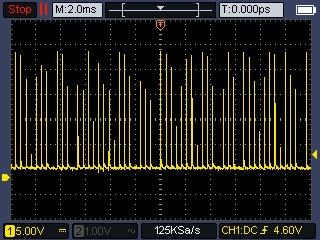

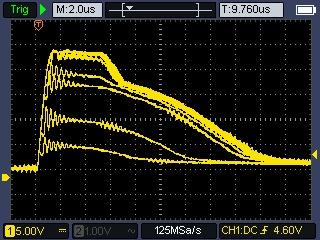

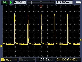

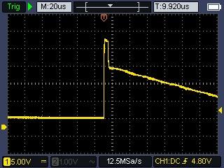

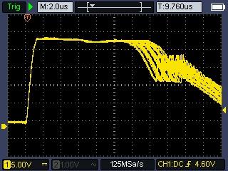

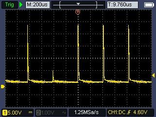

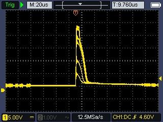

EldoLED @ 1% output (34% perceived)
IMAGE1.jpg.49d3ed83b7537ffaf1718030c9aa8ab8.jpgIMAGE2.jpg.262f69e99e4da0ffca8b67de5726521e.jpgIMAGE3.jpg.68a6c19a108a1177def768c1e5daf62f.jpgIMAGE4.jpg.ff3fe90cc77b741f14f46728e0264bf4.jpg

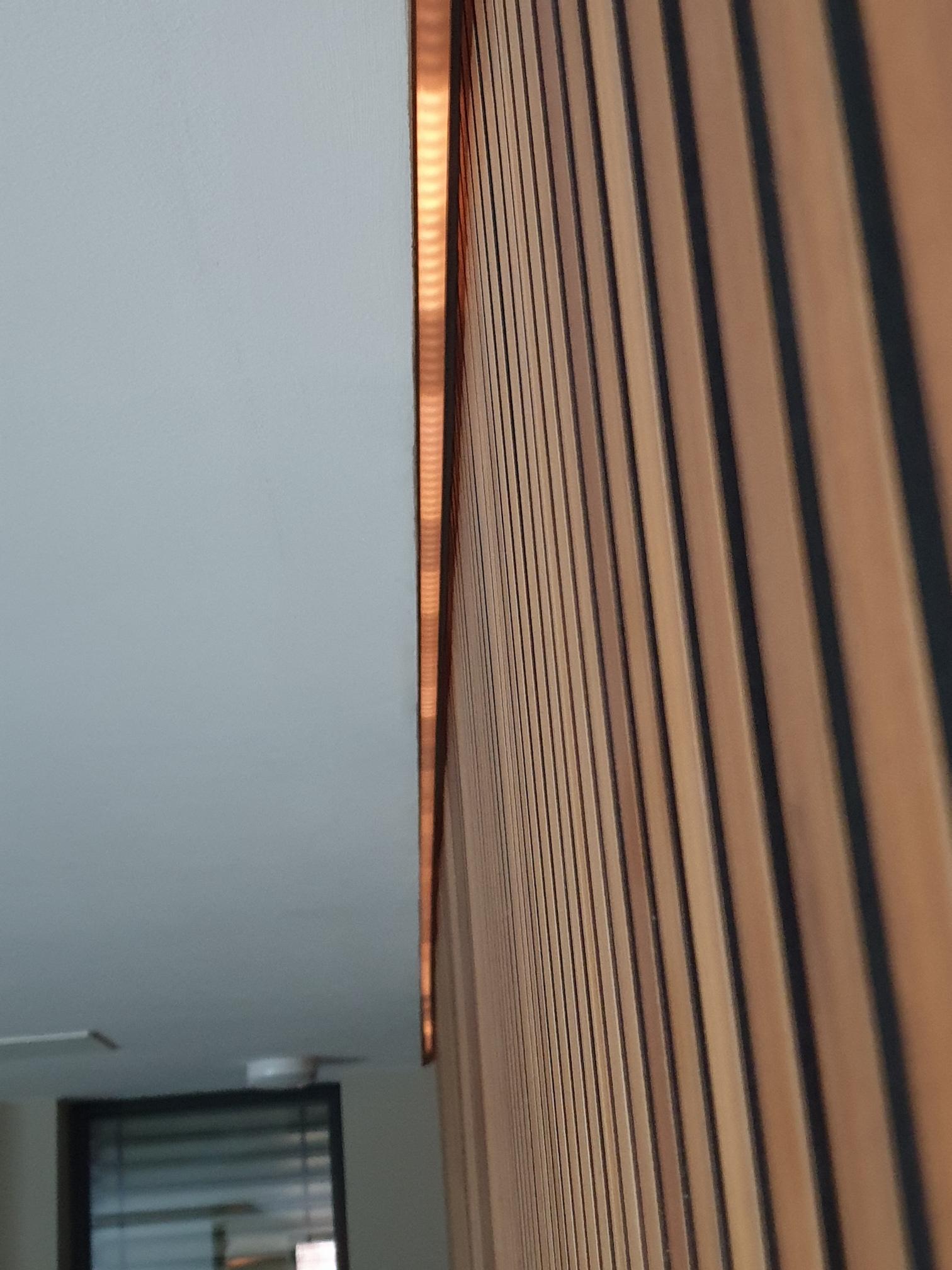

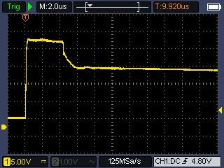

EldoLED @ 5% output (57% perceived)
IMAGE5.jpg.bc8364960c9422f21572599e3b5fbf20.jpgIMAGE6.jpg.0eba7cdabb9d5f75f108cb14946e7f70.jpgIMAGE7.jpg.f0ae9bb79ca844f91765225578ae312d.jpgIMAGE8.jpg.4287f103c67ef8e40f125154d5085905.jpg

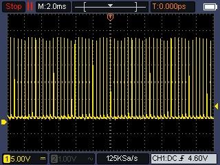

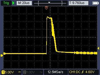

Meanwell @ 1% output (34% perceived)
meanwell1.jpg.4b9e02d61249936ffb7b98670c2b0053.jpgmeanwell2.jpg.4d6b6842974add5ca2326a56cbc8059c.jpgmeanwell3.jpg.f105004e19580e2808dc0ea6d168835e.jpgmeanwell4.jpg.a451cd6ca0b105abe3e5b7146e4f6a66.jpg

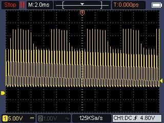

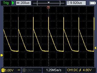

- Meanwell is 2.5kHz and EldoLED 2.4kW.
- That last 2.0ms plot isn't showing reality, as the Meanwell waveform is very consistent.
- Meanwell actually seems to have a faster rise time, but it performs flawlessly vs. the EldoLED.
Looks like the issue may be more to do with the fact that pulses don't seem to be consistently 24v with the EldoLED.  If this is deliberate, a side-effect of the IC or some other component on the tape or some other issue I have no idea!
Rise times are both well under 5us EldoLED is the slower at around 1us and the Meanwell is probably around 100ns so both would shoot-through the mosfet. So both will be unregulated for a brief period. I don't see any great inconsistency in the EldoLED 24V. What does differ is the voltage decay when the driver transistors are off. The LED's will stop conducting when the voltage falls below their forward voltage (looks to be around 15V) so the Meanwell output staying high for around 200us suggests some additional driver output capacitance above the (apparently non-existent) EldoLED. Not sure why this would result in a visible difference becuase the LEDs are fully off in this period anyway, Very puzzling.

From my (more novice) perspective, Meanwell has a consistent 24v pulse which will ensure that the LED forward voltage will always be high enough to be "on".
But, the EldoLED shows peaks of mixed voltages at a low-duty cycle. (I can see 5v, 10v, 17v and 19v peaks in there).
The 7 LEDs per module have a forward voltage of around 2.9v x 7 = 20.3v.  So, my thinking is that any peaks below 20v will mean the LEDs won't come on at all, or will only partially come on.
This would make sense, given light output is less than expected at these levels.  But why this would impact different modules differently I don't know! Any why the EldoLED driver does this is even more confusing.
That's a sampling artifact of the scope as you increase the timebase. I'm so used to it on my DSO that I automatically discount it. Notice that it also shows to a lesser extent on the Meanwell trace at 125kSa/s
I'm talking about this one.  I can see that there are sampling issues at 125kSa/s, but how can you tell that the smaller peaks here are phantom and that signal only has 24v peaks?
If I switch from "auto" to "once" and re-trigger multiples times, each time it triggers I see different peaks, which match this plot.

Sorry, I missed that! It's really odd isn't it...
Implies some kind of filter?  "LINEARdrive" sounds like it might be something in addition to PWM but there's not much you can do to get a lossless volt-drop like that without maybe cycling the on time - sort of 'modulating the modulation'
The clue would be how much time it spends at each different step and if there's a pattern to it which will be hard to see without a bigger storage capacity.

Yes, it's odd.  It's definitely related though, as this phenomenon goes away when the light output becomes consistent.
LinearDrive is just a brand name for their CV driver.  They use a specific PWM frequency which is a multiple of 25, 30. 50 and 60Hz (for TV compatibility in theory) and from what I've seen at higher outputs the signal isn't pure PWM (bunched pulses instead of evenly spaced), but I'm told by their rep that they do not reduce the voltage at lower outputs (that's not what I'm seeing though!)
If the voltage is reduced though,  I've no idea why the LED tape with another LED driver IC (420 instead of 430) is absolutely fine though!   Unless it's something to do with other components on the tape/IC somehow impacting the driver output.
