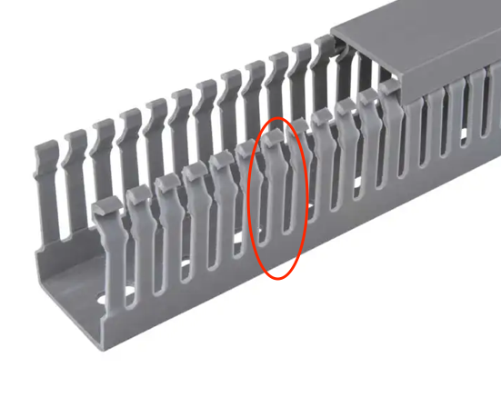

Thorfun Posted January 31 Author Share Posted January 31 think I know the answer to this one but are there any issues with me cutting off a 'finger' of the cable tray to give more room? one of these things circled in red is what I'm talking about? Link to comment Share on other sites More sharing options...
ProDave Posted January 31 Share Posted January 31 38 minutes ago, Thorfun said: think I know the answer to this one but are there any issues with me cutting off a 'finger' of the cable tray to give more room? one of these things circled in red is what I'm talking about? No problem at all, standard practice when wiring industrial cabinets. 1 Link to comment Share on other sites More sharing options...
Rob99 Posted January 31 Share Posted January 31 Yep, you can just push them in and out once and they should snap off cleanly, no cutting needed 1 Link to comment Share on other sites More sharing options...
Thorfun Posted January 31 Author Share Posted January 31 7 minutes ago, ProDave said: No problem at all, standard practice when wiring industrial cabinets. Thank you. I thought that’d be the case but I like to sanity check my ideas sometimes! 2 minutes ago, Rob99 said: Yep, you can just push them in and out once and they should snap off cleanly, no cutting needed great to know. Thought I was going to have to move loads of cable out the way to snip them off. Link to comment Share on other sites More sharing options...
