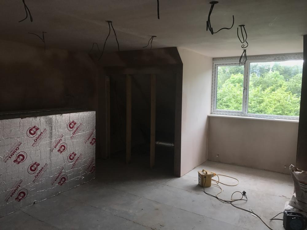

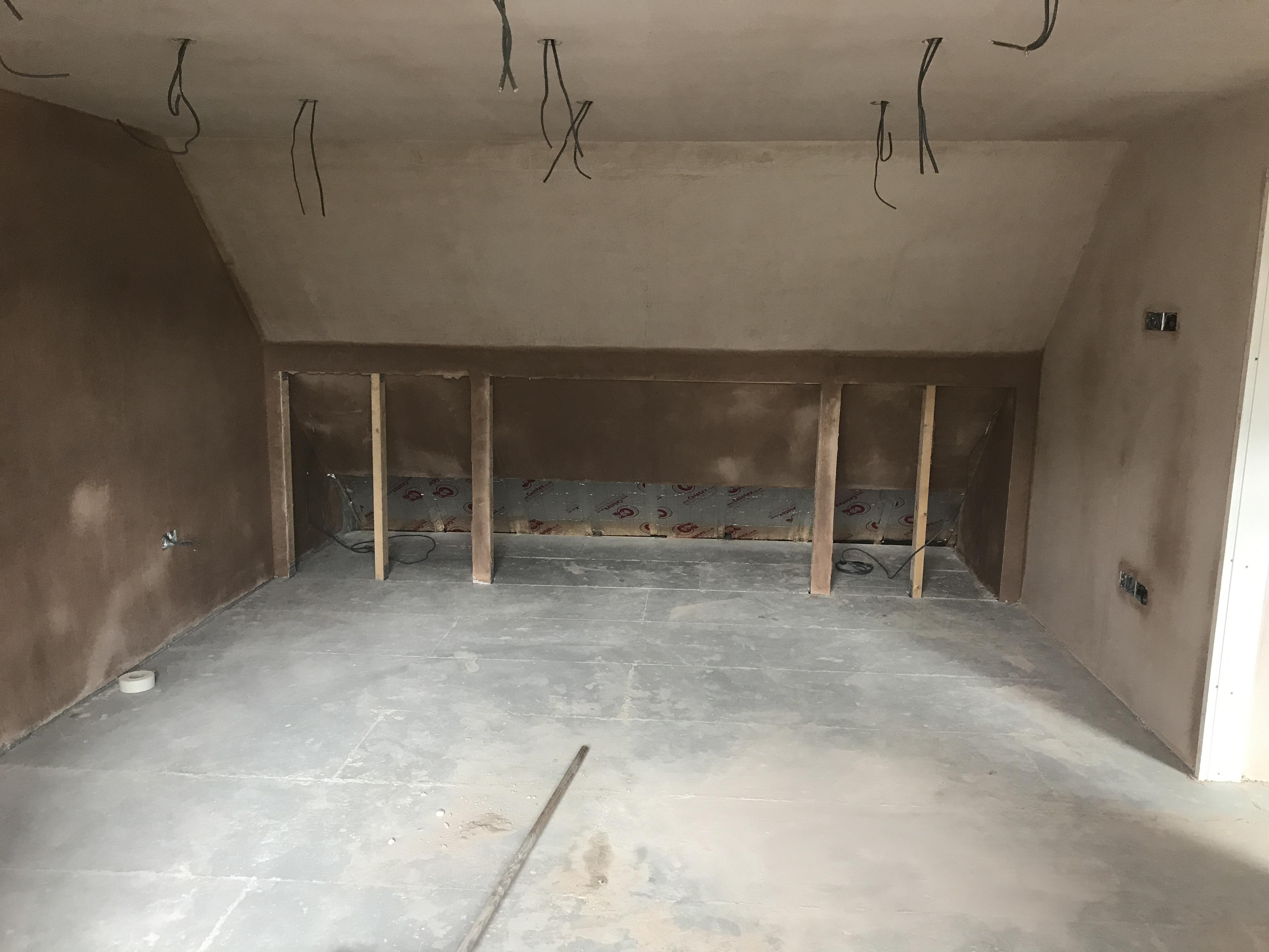

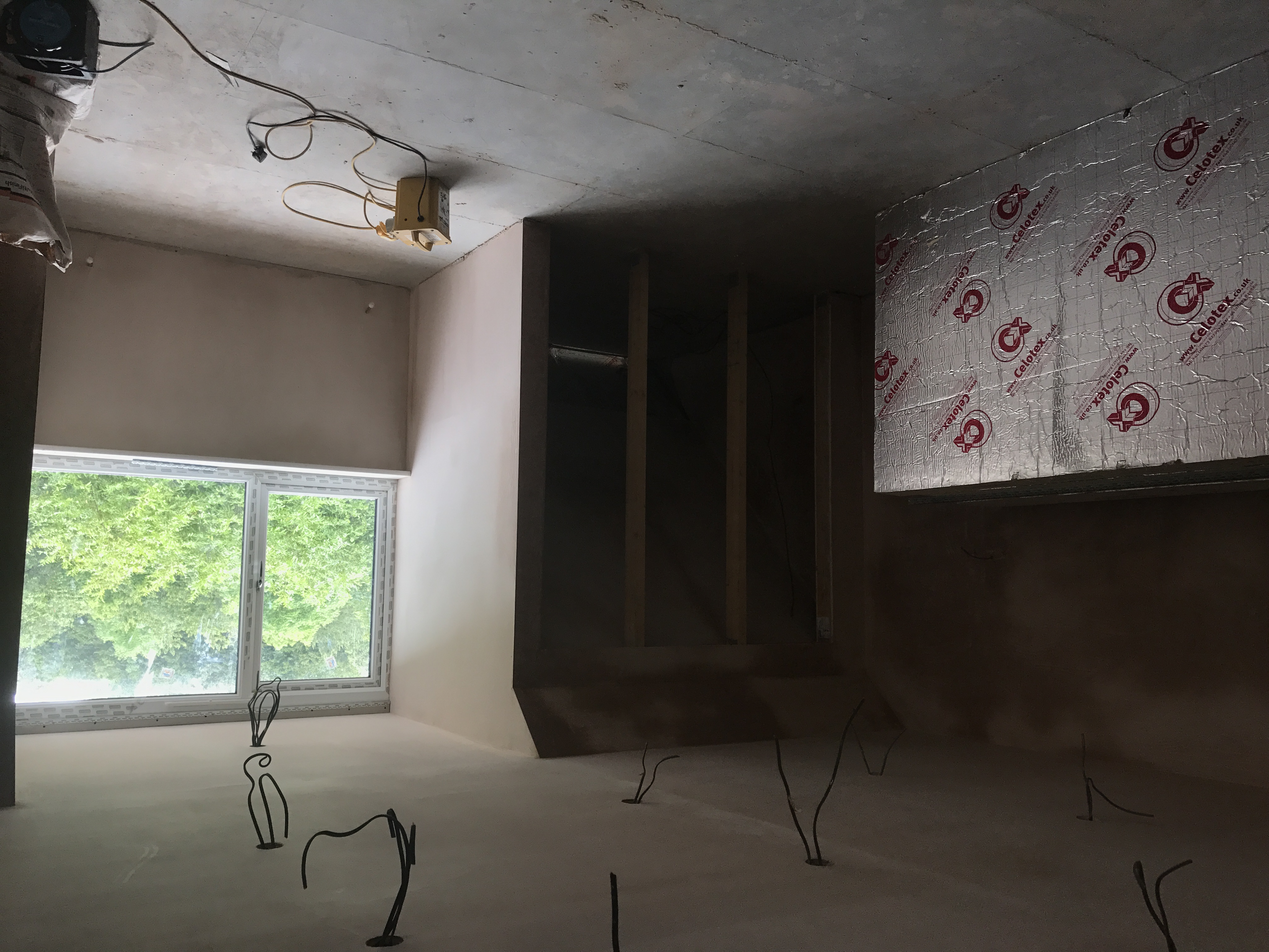

Grosey Posted June 27, 2017 Posted June 27, 2017 I'm looking for bare sheets of material I can use to make custom wardrobe doors to go in the eaves of a room in roof. White gloss. I know howdens kitchen doors are probably an option but wondering if there were any cheaper options or online suppliers? Don't want to go as cheap as melamine, but something along those lines.
