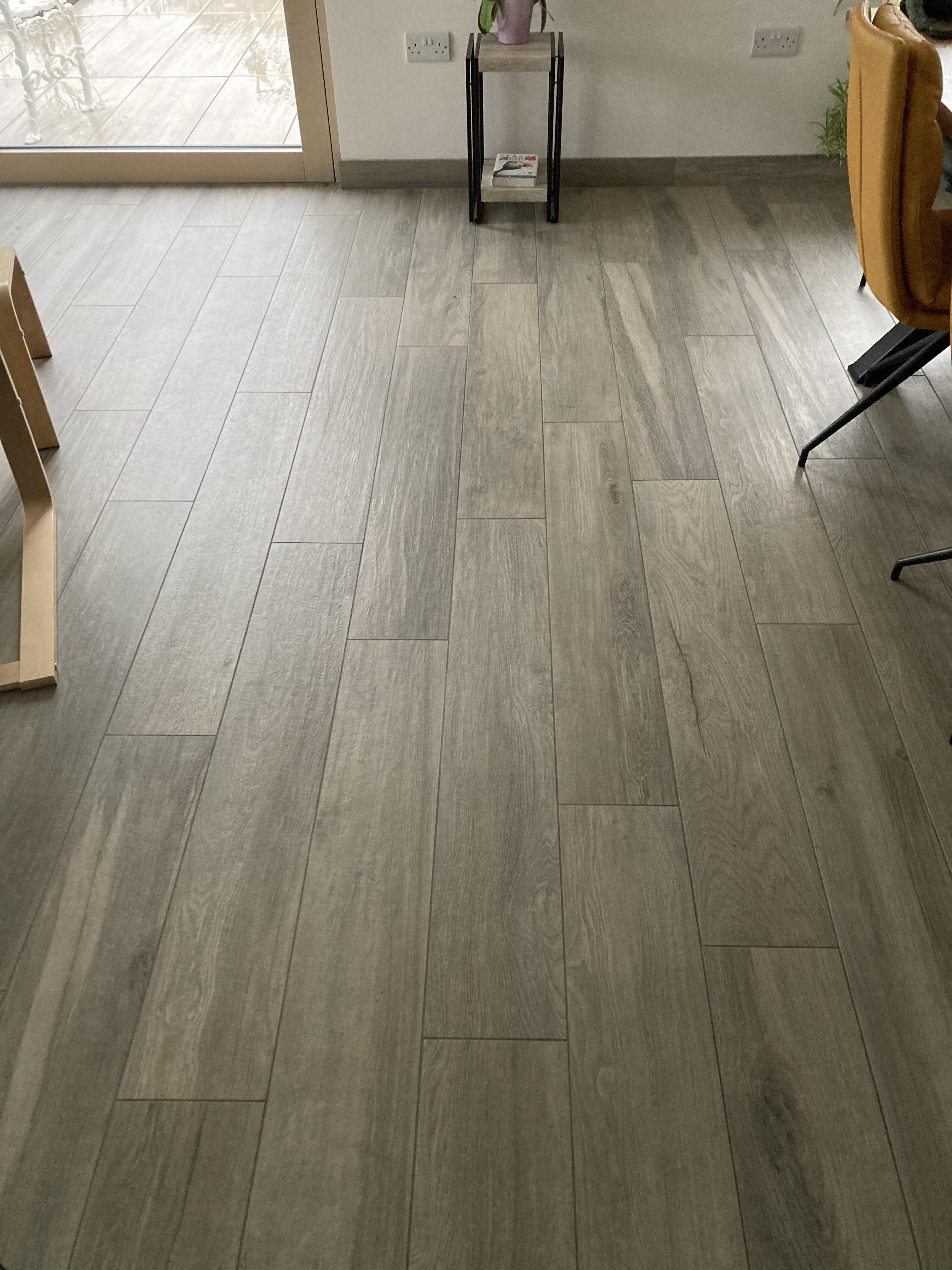

Russdl Posted October 31, 2022 Posted October 31, 2022 We went with textured wood effect porcelain tiles. We live at the end of a lane which for about 6 months of the year is a muddy lane. So far the porcelain tiles have proved indestructible especially when it comes to mud and stone being walked in. The dog is the worst offender, he refuses to wipe his feet. After a quick wipe over with a steam mop the tiles are like new again. Repeated patterns would drive me nuts which I made the tiler aware of. I think he’s done a brilliant job. Most visitors think the floor is timber so I guess it’s ticking that box, the same tile continues outside onto the patio, they are twice the width and thickness. 2
saveasteading Posted October 31, 2022 Author Posted October 31, 2022 That looks good. Do you remember the source/ name.
Russdl Posted October 31, 2022 Posted October 31, 2022 In a word ‘no’ but I’ll try and dig out the information for you later.

Russdl Posted October 31, 2022 Posted October 31, 2022 The tiles are called 'Myspace Cinnamon', they cost circa £50/m2 including VAT after discount, way back in 2021 when the world was only mildly mad. They are very hard wearing, our steel staircase was dropped and dragged a short way across the lightly protected tiles on its way to being installed. With trepidation I removed the protective cardboard to see a big black mark on one of the tiles which transpired to be powder coat abraded from the staircase, once cleaned off the tile was pristine. 2

saveasteading Posted October 31, 2022 Author Posted October 31, 2022 I've found the tiles Russdl recommends online. I wasn't going to mention the price as is about £40, if he paid 50. But now I can. No manufacturer or dealer appears to mention the problem of repeats. However, Russdl's tiles are by NovaBell. Their pictures don't seem to have any repeats, and they say 'infinite' layout. I wonder if they have a digital computer with hundreds of m2 of timber photos on it and every tile is different....or is that wishful thinking... Unfortunately there are no showrooms nearby so we will have to forget them.
