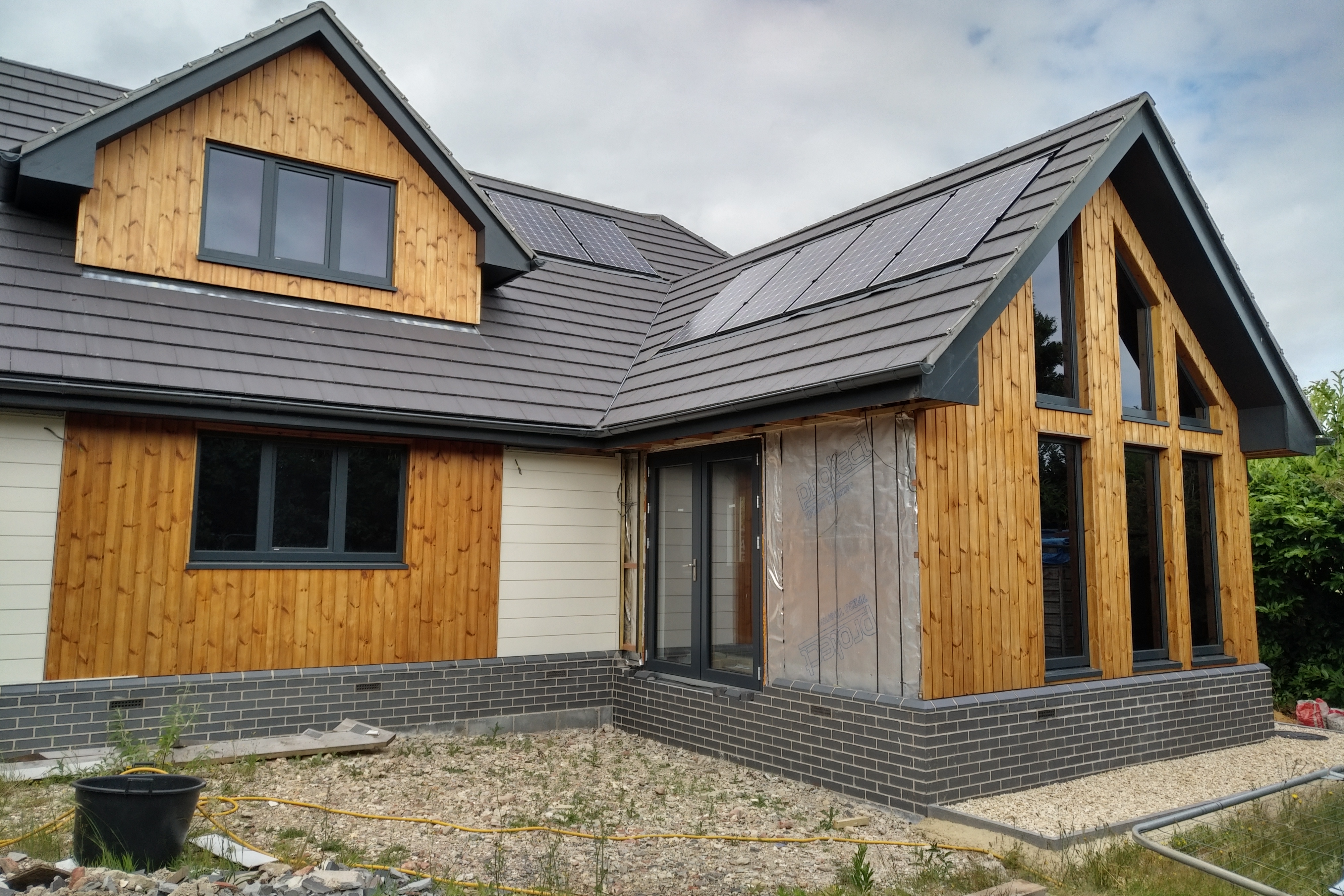

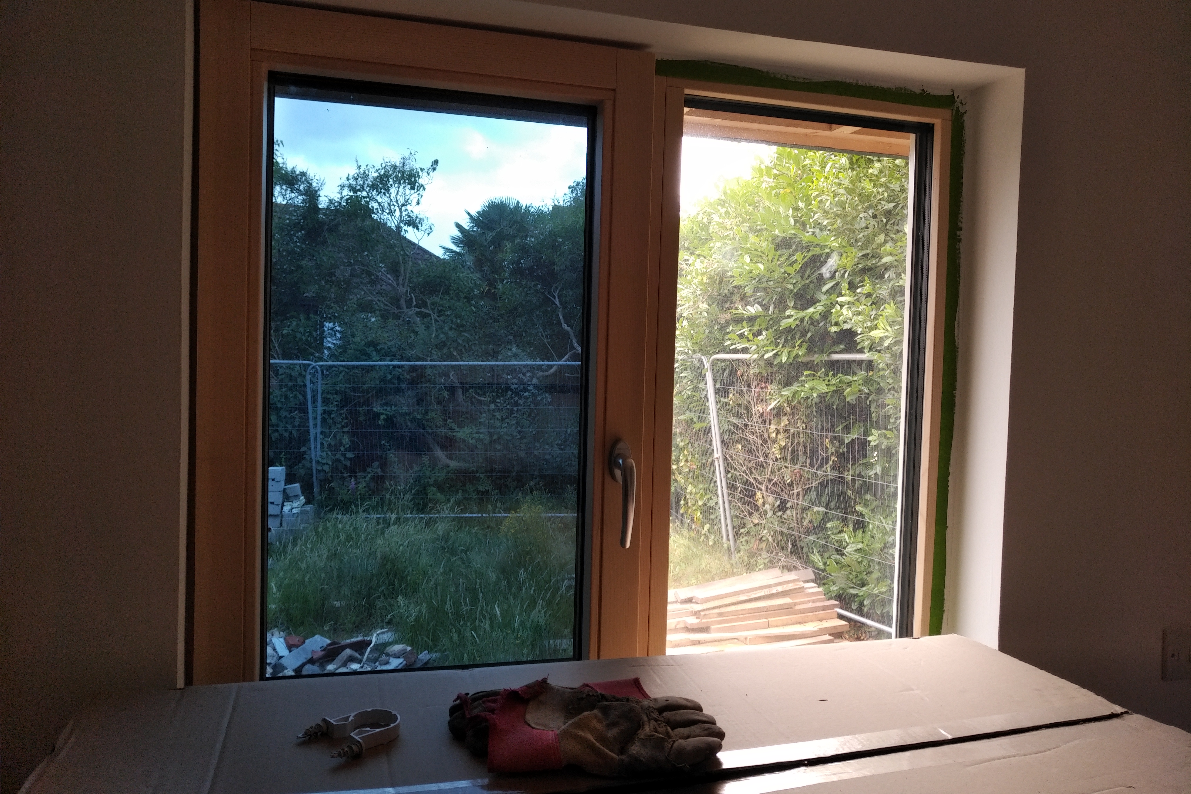

NSS Posted June 22, 2017 Posted June 22, 2017 Hectic day on site today, so just one pic for now showing side by side panes with one tinted to around 50% and the other untinted. Takes about 3 minutes to tint to this level and about 5 minutes to fully tint (which blocks about 96% of the solar gain). More pics tomorrow. 3

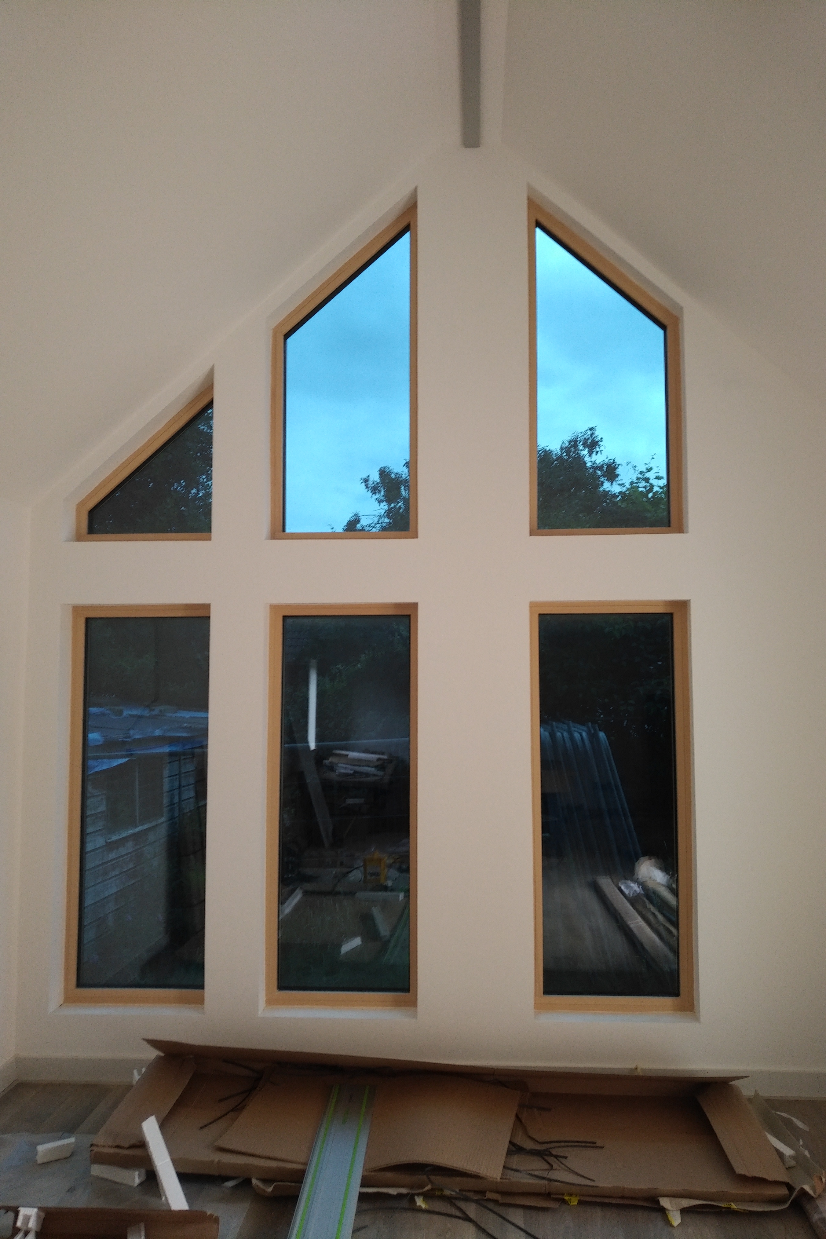

NSS Posted June 23, 2017 Author Posted June 23, 2017 A couple more pic, from inside and outside with the glass in it's fully tinted state. You can see out, but you can't see in. 1

NSS Posted June 23, 2017 Author Posted June 23, 2017 On 23/06/2017 at 17:38, Barney12 said: I do like your build. Looks really nice. And now you can run round the house naked Expand LOL. And more importantly, the SageGlass will now automatically reduce solar gain when we don't need it, but allow it when we do. Okay, it's more expensive than reflective film, but it was noticeable working in the house today just how much cooler it remained.

NSS Posted November 2, 2017 Author Posted November 2, 2017 Did a little experiment earlier this week. We had two consecutive days where there was bright sunshine all morning. On the first day I left the Sageglass in auto and by 10.30am it was tinting to reduce the solar gain and the indoor temperature remained at 21 degrees all day. On the second day the Sageglass again started to tint at around 10.30am but rather than leaving it in auto I manually overrode and left it in its clear state. Within 90 minutes the indoor temperature had risen by 2 degrees and rose a further degree by mid afternoon. Okay, early days yet but it seems to be doing what it was designed to do. 1
