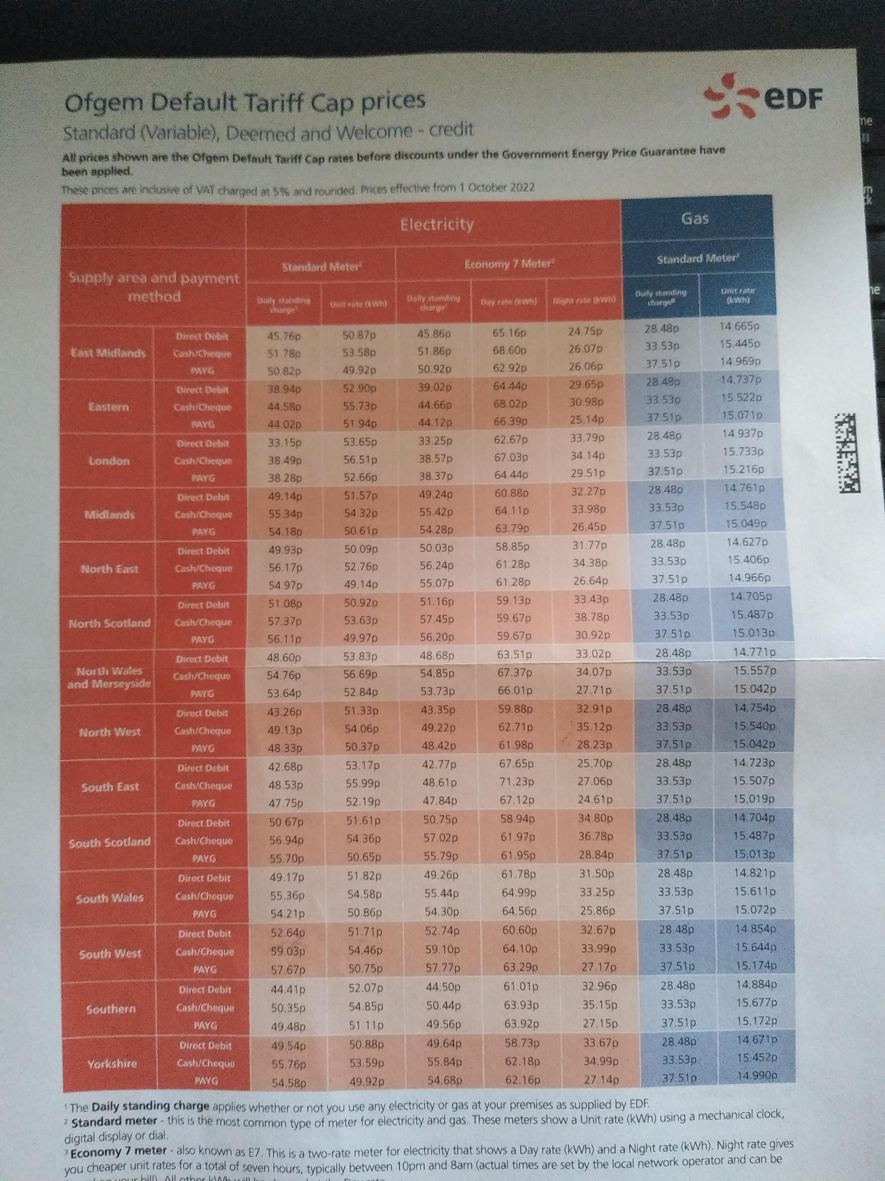

SteamyTea Posted October 17, 2022 Share Posted October 17, 2022 2 minutes ago, jamieled said: a much higher electricity price to convince me of changing the current setup EDF are going to charge me 34p/kWh for night usage. 1 Link to comment Share on other sites More sharing options...
JohnMo Posted October 17, 2022 Share Posted October 17, 2022 1 hour ago, SteamyTea said: EDF are going to charge me 34p/kWh for night usage Wait till next April - they may want an arm and leg also. Link to comment Share on other sites More sharing options...

ProDave Posted October 21, 2022 Share Posted October 21, 2022 On 17/10/2022 at 20:54, SteamyTea said: EDF are going to charge me 34p/kWh for night usage. How come? Is that not the capped price for daytime? Night rate should be lower. If that is the best you can get then E7 / E10 is dead, switch to single rate and ditch the storage heaters. Link to comment Share on other sites More sharing options...
SteamyTea Posted October 21, 2022 Share Posted October 21, 2022 25 minutes ago, ProDave said: How come? Is that not the capped price for daytime? Night rate should be lower. If that is the best you can get then E7 / E10 is dead, switch to single rate and ditch the storage heaters. Yes. I think the reason is, to hit an annual mean price of 2500, they use the E7 mean usage of 4.2 MWh/year. About a third of everyone else's. Small one bed flats maybe, not a normal house. Link to comment Share on other sites More sharing options...
billt Posted October 21, 2022 Share Posted October 21, 2022 Don't understand. Our 7 hour rate has reduced in price, now 17p per unit, day time rate 44p per unit. The rates don't vary depending on the size of the property. Link to comment Share on other sites More sharing options...

Nick Thomas Posted October 21, 2022 Share Posted October 21, 2022 (The actual rates EDF are charging E7 customers: https://www.edfenergy.com/sites/default/files/government_energy_price_guarantee_prices._standard_variable_deemed_and_welcome._credit_meters.pdf ) 1 Link to comment Share on other sites More sharing options...
SteamyTea Posted October 21, 2022 Share Posted October 21, 2022 38 minutes ago, Nick Thomas said: (The actual rates EDF are charging E7 customers: https://www.edfenergy.com/sites/default/files/government_energy_price_guarantee_prices._standard_variable_deemed_and_welcome._credit_meters.pdf ) That's interesting, this is the price list I got sent. Link to comment Share on other sites More sharing options...
Nick Thomas Posted October 21, 2022 Share Posted October 21, 2022 Yes. Read the section in bold: "All prices are the Ofgem Default Tariff Cap rates before discounts under the Government Energy Price Guarantee have been applied". Once those discounts are applied - and they will be applied - you get the rates in the PDF I linked. Link to comment Share on other sites More sharing options...
SteamyTea Posted October 21, 2022 Share Posted October 21, 2022 30 minutes ago, Nick Thomas said: you get the rates in the PDF I linked. I hope so. I think I get a bill fairly soon. As I am only using 3 kWh/day at the moment, and am still on target to use 3 MWh/year this year (did not start cutting back till May), the yearly bill will not be drastic, especially as I am getting £550 off in total. Just for the record, [22:27 21/10/2022] my house is at 21°C and outside is at 13°C. Been a dull, rainy day. Link to comment Share on other sites More sharing options...
