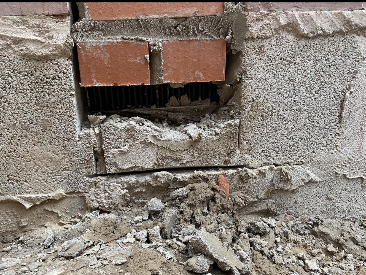

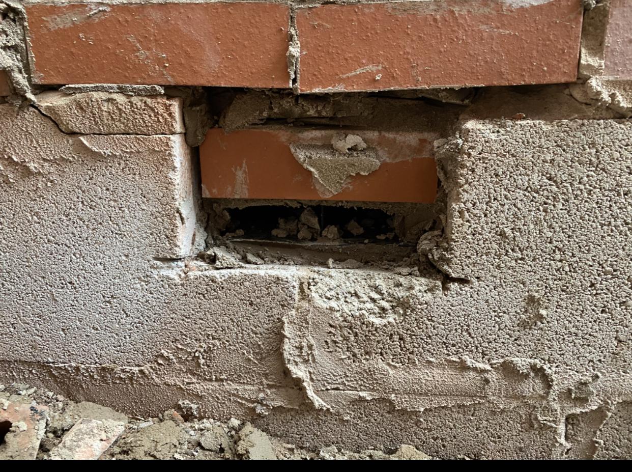

When checking my contractors work I usually go by a simple rule, “If it looks like poor workmanship, then it probably is.”
The majority of my extension involves a suspended timber floor. When the contractor got up to DPC I noticed the lack of air bricks. When I brought this up I was told they were to be notched in later and cavity trays will be installed as they move up.
The contractor is halfway up to GF wall plate and he has started to notch in the air bricks. Outside looks fine, with cavity trays and weep vents. Internally, to me anyway, it looks a complete mess. I also feel the internal load bearing skin has now been compromised (when compared to a non notched wall).
what do you guys think? I feel like I need to now insist on small 65x100 lintels.  Only two pictures but there are 6 openings, all of the same quality internally.

Where the two bricks are length wise should that be a lintel?
But generally - see above, a two year old could do a better job.

I would look at your contract as that little picture shows a fair old mess, appreciate that you might find difficulty in getting another builder but if you continue down this route what else will they mess up, and you will have spent more money on them and then on further trades to rectifying issues, which is generally destructive work.  Best to get it right the first time.

why didnt they just build them in as they went ? It's more than double the work to do it they way they have so there must be a reason. Ask them what it is ?
Show a picture of the brick side, insisite on a 4" lintle over their cut.
Has building control been out yet ?

Don’t believe I have a brick side pick, I’ll take one tomorrow.
I’ve sent the same pictures to building control
