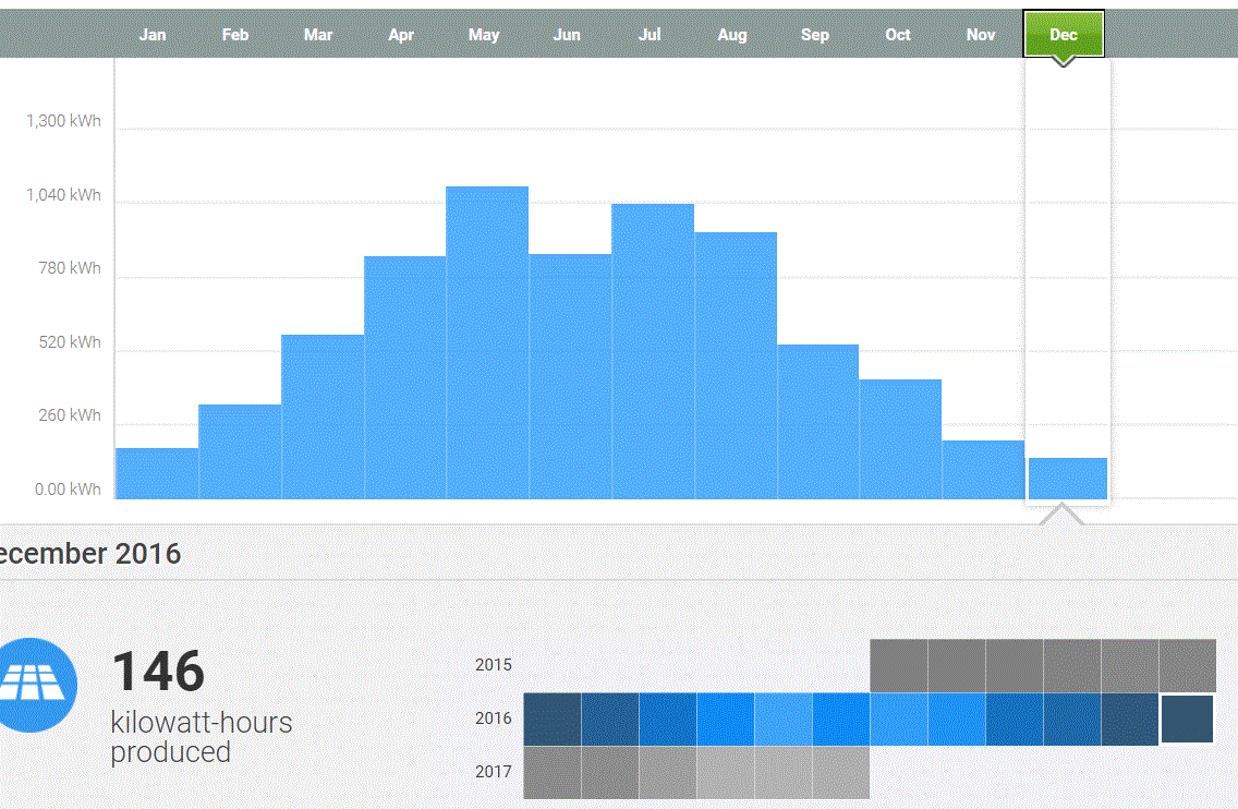

jack Posted June 21, 2017 Posted June 21, 2017 (edited) Welcome. A couple of points: 12kW of PV sounds like a lot, but you'll generate surprisingly little during the darkest months. We have 8.5kW and this was what 2016 looked like: December only managed 146kWh, or less than 5kWh per day on average (we had a few days where we barely got above 1kWh). That's less than two hours of a standard 3kW immersion heater on full bore. We have a 289m2 close-to-Passivhaus Standard house with a 5kW Panasonic ASHP, which covers hot water and underfloor heating. It cost about £1800 + VAT and our electrician and plumbers installed it (monobloc ASHPs are a doddle to install) in a few hours. The ASHP doesn't come on for probably 6 months of the year due to the PV supplying power to an immersion diverter in our unvented hot water tank. The only reason I can see for such a high package cost is if you're using an RHI installer. The process does involve a lot of paperwork and keeping up certifications. That and the payback seems to have encouraged much higher prices from installers signed up to the scheme. Solar thermal is expensive, requires maintenance, and tends to spend a lot of time generating no hot water or far too much hot water. Since you already have PV, you can use an immersion diverter put excess solar energy into a hot water tank. I believe it'll make hot water for a higher number of days than even the best solar thermal. Seems a no brainer if you already have the PV in place. Edited June 21, 2017 by jack Typo and more info
