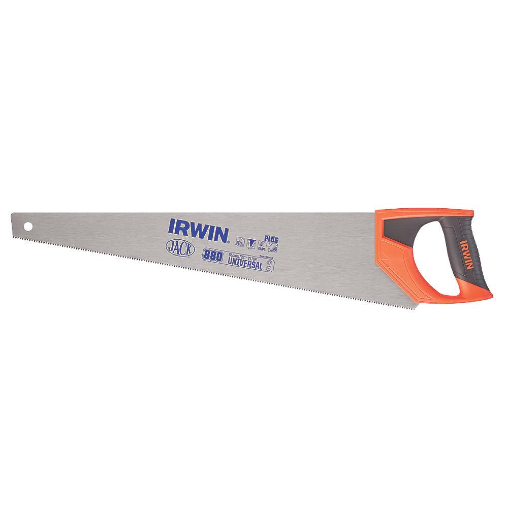

The easiest way for the bulk of it, is SAW it to length with a large panel saw while it is still rolled up and bagged.  then when you unwrap it, you have rolls of your chosen width to suit your joist / rafter spacing.  You only then need to cut to length.
Yes, I find this works a treat. A 22" saw just about gets through a full roll. The rolls I got are 1.2m long with a handy cut marker halfway at 600mm
On 05/10/2022 at 21:36, ProDave said:
large panel saw
Agreed. The material cuts remarkably easily and exactly, as it is compressed within the packaging.

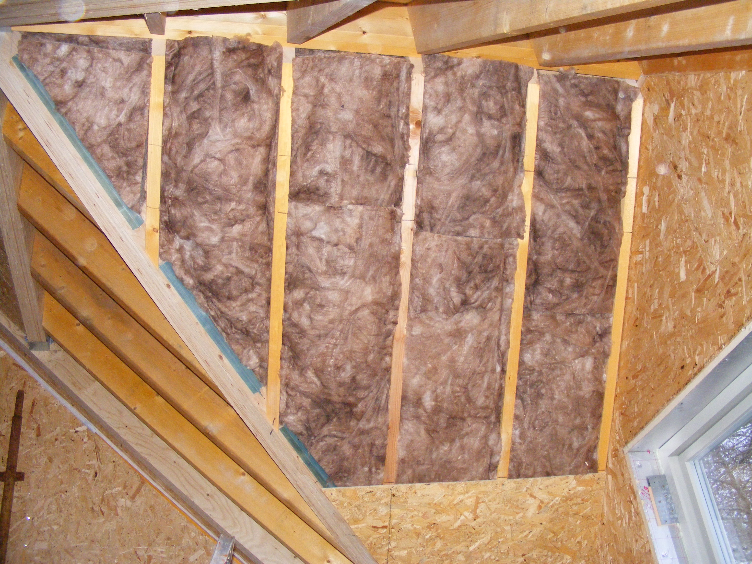

Hi - I'm looking to fit mineral wool or similar between pitched rafters. Is there any reason I can't use Knauf Loft roll instead of frametherm (ignoring u-values)? Will have vcl, 40mm Kingspan and then plasterboard below.
Thanks!
Thanks!
Loft roll is soft and will be unlikely to just stay in place.
Frametherm is much stiffer and if cut slightly oversize will push in place on a sloping ceiling and just stay there.
Early in the build I put a single piece in the roof between the rafters as a test , and 6 months later it had not fallen out or even slipped.
