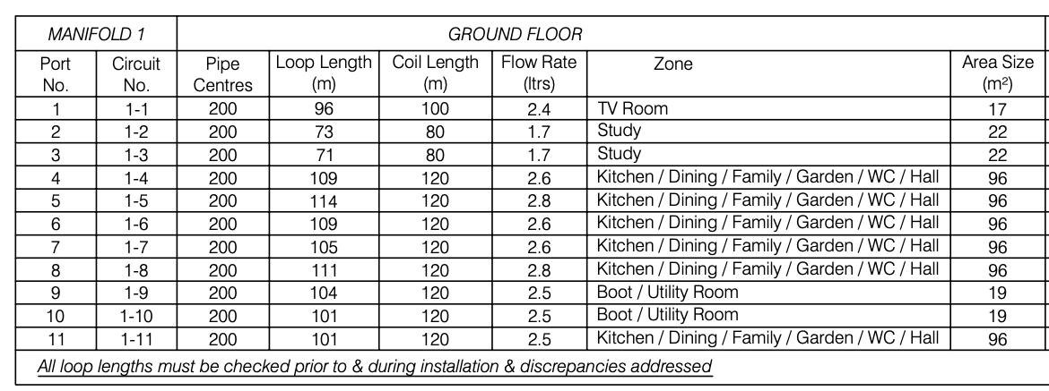

this Friday our heating engineers are coming to connect our GF ufh manifold up. I need to buy a pump! what size, make, model pump would people recommend for the following loops and flow rates (taken from our design by Wunda)
is there an easy way to calculate the required pump size or is it something that you just learn with experience?

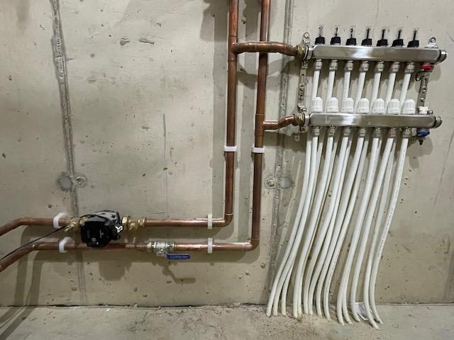

in our basement UFH the heating engineers set it up like this photo. no blending involved, no wiring centre, and no actuators.

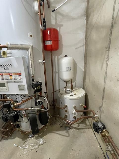

and here are our tanks, hot water and buffer:

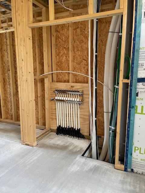

they left a couple of tails going up from the basement manifold which will be taken to the GF manifold. these tails are on the same run of pipes after the current Grundfos pump that's in place which came from Wunda. Here's the GF manifold
now, if we ignore the obvious that I should've got a right ended manifold for a second, the pipes will come up through the hole in the floor where the other utilities are coming up and across to the left hand side.
would the single pump in the basement be sufficient for both manifolds? would I actually need a second pump for the GF manifold?
on the GF we're planning on running it as a single zone but had it designed as 4 zones in case we find we need to split the heating up.

that's a pump set, right? are the blending valves, thermometers etc required for a single zone system? as said above we don't have that in the basement but if it's best to have them then I can ask the heating guys to install a pump set.

I’m just unsure how the different sections of the house will each behave, if they are sent one flow temp. You’d typically be running much cooler temps in upstairs (GF) vs the basement which may require higher flow temps to meet the same ambient.
Just seems a bit indiscriminate to me, but could all work perfectly by ‘accident’ or design.

now I've written all of the above I believe I've actually answered your original question. I believe it's 'buffer > pump > manifold with no temp control.

ok cool. so, for now, we can just ignore any pumps on the GF manifold and just use the one pump in the basement and see what happens? if we find we're needing different flow temps then we can cross that bridge at that time and re-plumb at the manifolds?
