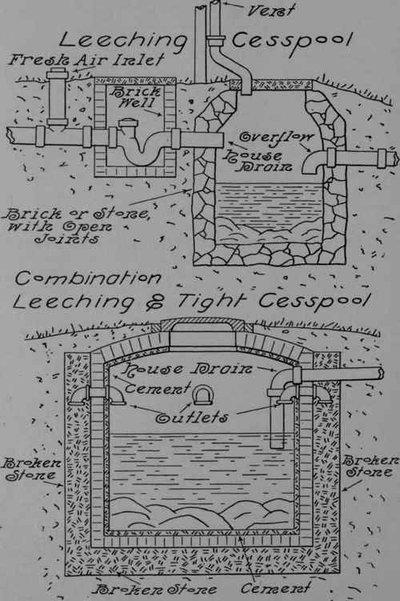

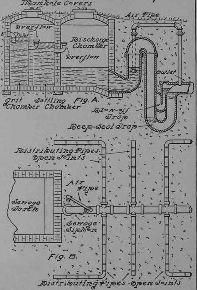

As a bit of an aside someone on another forum kindly found these for me. Mine I think is the first type:
Nice... I've got a book somewhere that Dad used as the basis of our design - I expect it's got similar pictures in.
