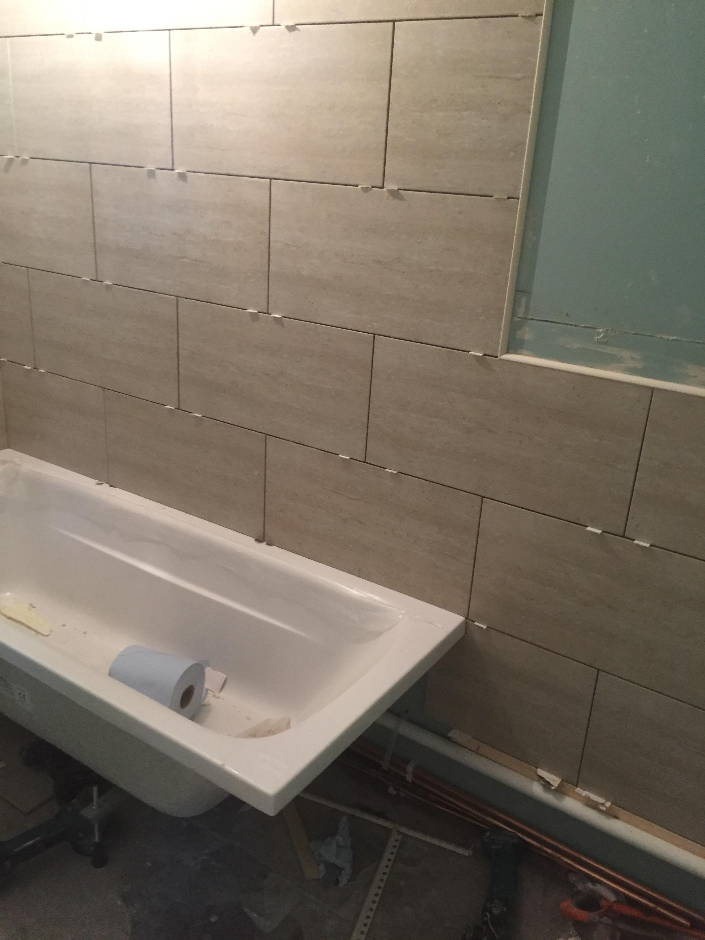

Posted
This is one of my current jobs. Tiles straight onto MR PB and the trims fitted prior to skimming. I purposely fitted 12mm trims where I could have got away with 10mm, and I set the tiles an extra 2mm off the walls so the skim didn't eat too far into the visible trim. I'll post a pic tomw of the skimmed and painted job, ( one I skimmed myself to make sure the trims didn't get 'dinked' by the trowel ).

Posted
Expand
That looks like mine.....will.....one day! :)
