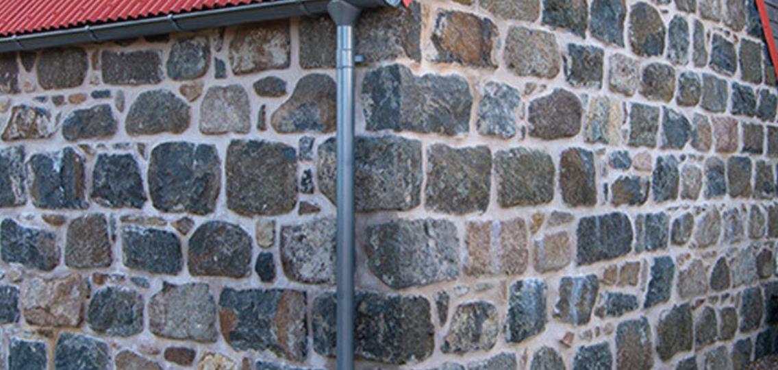

Bozza Posted September 22, 2022 Share Posted September 22, 2022 I am currently building a loose stone granite retaining wall in the garden. I am considering pointing it to gave the effect in the attached pic which is likely to be lime mortar. It doesn’t need to be lime mortar, which is quite expensive, so I am consider dying cement based mortar a lighter colour using white pigment dye. I have zero knowledge or experience of dying cement, or using lime mortar, etc I would appreciate any advise of anyone with relevant knowledge. cheers ! Bozza. Link to comment Share on other sites More sharing options...
nod Posted September 22, 2022 Share Posted September 22, 2022 If you add hydrated line You will get the effect pictured 4 sand 1 cement 1 lime and lime is as cheap as chips 1 Link to comment Share on other sites More sharing options...
Bozza Posted September 22, 2022 Author Share Posted September 22, 2022 31 minutes ago, nod said: If you add hydrated line You will get the effect pictured 4 sand 1 cement 1 lime and lime is as cheap as chips Cheers Nod I’ll give that a go. I thought the hydrated lime was pricey at £17 per 25kg bag but I supposed that will make 150kg on the ratios you suggest. Link to comment Share on other sites More sharing options...
Onoff Posted September 22, 2022 Share Posted September 22, 2022 I did 3 builders sand, 1 sharp sand, 1 cement and 1 lime to get this colour around my flints. I didn't want "white" that would contrast too much with the mortar which was 4 builders sand to 1 cement. Link to comment Share on other sites More sharing options...
nod Posted September 22, 2022 Share Posted September 22, 2022 27 minutes ago, Bozza said: Cheers Nod I’ll give that a go. I thought the hydrated lime was pricey at £17 per 25kg bag but I supposed that will make 150kg on the ratios you suggest. It will go a long way Probably worth doing a couple of trial mixes till you get the colour you want Use Something small like a cup Four cups of sand etc Dont use a plastersizer The lime will aerate the fix Link to comment Share on other sites More sharing options...
Canski Posted September 22, 2022 Share Posted September 22, 2022 Try white cement and yellow sand with some lime. Link to comment Share on other sites More sharing options...

joe90 Posted September 23, 2022 Share Posted September 23, 2022 12 hours ago, nod said: If you add hydrated line You will get the effect pictured 4 sand 1 cement 1 lime and lime is as cheap as chips My builder did this as I wanted it to look like lime, and it does, just what I wanted. Link to comment Share on other sites More sharing options...
Conor Posted September 23, 2022 Share Posted September 23, 2022 (edited) If you want lighter than the lime mix (if your sand is quite orange, the mix will come out looking a bit muddy) you can replace 1 of the standard sands with white sand. Going by your posted pic, think white sane may be needed. I'm doing to experimental mixes soon myself as we've a lot of red brick butting against white render and want to soften the contrast with pale mortar. Edited September 23, 2022 by Conor Link to comment Share on other sites More sharing options...
Gone West Posted September 23, 2022 Share Posted September 23, 2022 As @Canski has said you can use white cement which is what I have used in the past to create that look for mortar. Link to comment Share on other sites More sharing options...
PeterW Posted September 23, 2022 Share Posted September 23, 2022 I’ve used white cement and lime with plastering sand to get a near “sandstone” finish and it works well. The issue is normally though that your sand provides most of the colour - see if the BM can get you yellow sand in bulk bags Link to comment Share on other sites More sharing options...
