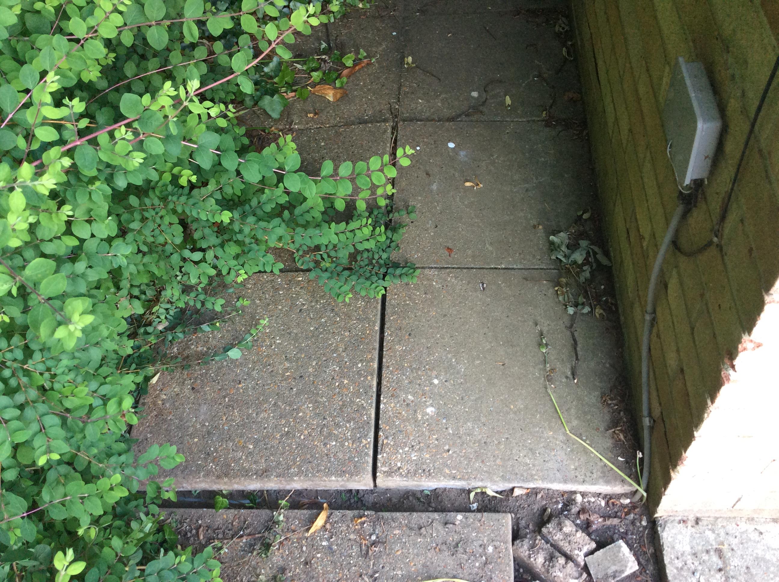

Weebles Posted June 18, 2017 Author Posted June 18, 2017 Here's a photo of the set up. Grey BT box on wall of existing house. Grey cable goes off underground and off the property (boundary is only 1.5m or so from the house here, to the left). So we could dig back to the boundary. The problem is that the caravan will be at least 20m from this bit of cabling. We can't put this external box on the static van as it won't reach. Does it need to be mounted or can it just be left on the ground (in some makeshift housing). Or should we splice extra cable before the grey box to enable it to reach the van? The BT open reach internal box is in the house about 20m from the point of entry of the black cable (that comes out of the grey exterior box). Please could someone walk me through what to connect to what? I assume we need to keep the internal BT open reach box? Many thanks.
Barney12 Posted June 18, 2017 Posted June 18, 2017 (edited) What I would do is: Remove the lid of the grey box and note the connections (take a photo). Disconnect the black wire that goes into your house. It may simply be spliced to the supply cable with jelly crimps. If it is cut the black cable to the house not the supply cable. Leave the jelly crimps behind for now. There's likely to be a number of pairs of cables but only two connected to your black cable (unless you have more than one line). Disconnect the internal box and save it for the van. Again note or photograph the connections, Do not splice or interfear with the BT supply cable. Just dig it back and remount the grey box on your boundary fence or a 4" fence post if you've got no boundary fence. Get your self some external phone cable or external CAT5 cable. If you've not got a fence to tack it to then you'll either need to put it in a conduit or get an armoured cable and bury it so it doesn't get damaged. You could also put it overhead but I'll guarantee someone will pull it down at some point! Connect the new cable to the grey external box and take it to the van and connect up the internal box you saved. Ideally grab a few jelly crimps from eBay or just charm a couple out of a passing BT man . The wires simply slide in to the crimp housing and your squeeze the connector to make a connection. Post some photos with the boxes removed if you want some more help. Edited June 18, 2017 by Barney12

Nickfromwales Posted June 18, 2017 Posted June 18, 2017 Once it's all connected and you pick the phone up for the first time, you'll hopefully have your dial tone back. Then dial 17070. That's the ring-back test facility . Select option 1 and hang up, then it'll immediately ring you back to confirm your line is properly ringing etc and then just hang up again as instructed
