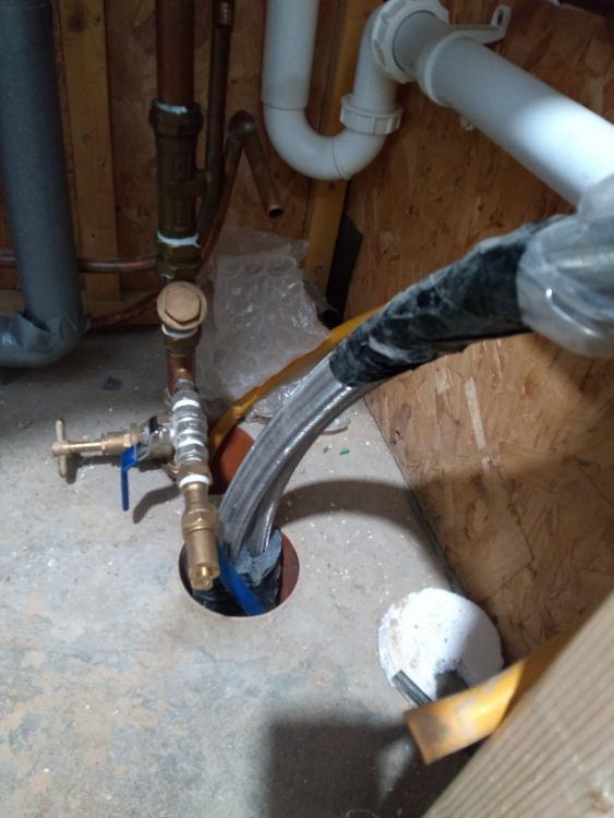

JanetE Posted February 10, 2018 Share Posted February 10, 2018 Just resurrecting this thread as we need to future proof in case we decide to install an ASHP. At the moment the Willis heater is doing a pretty good job of keeping us warm, but we may need some cooling in the summer and that will call for an ASHP. The electrical supply is not a problem but it is the pipe runs that we need a bit more information about. We are just about to have the paving done outside and need to sort the access. The ASHP will need to be installed outside against the shed. The access for the pipe runs go under the slab, this is simply some 110mm soil pipe coming into a 90° bend straight into the utility room. This is probably going to cause us a bit of grief. We didn't do our homework on this when the slab was installed and now need to work around this issue so any advice would be welcome. Link to comment Share on other sites More sharing options...
Jeremy Harris Posted February 10, 2018 Share Posted February 10, 2018 I'm assuming that it's the 90 deg bend that's the potential issue. Is the bend a standard one or a swept one? If the former then you may really struggle to get insulated 22mm plastic pipe round it, if the latter then it may just get around OK. One solution may be to terminate some insulated 22mm pipe with a long full bore flexi, test the joints for leaks, insulate the flexis with Armaflex, tape the open end of the flexis to stop muck getting in, then feed the pipes in from outside. With luck the flexis will just go around the bend in the 110mm pipe easily and just pop up inside, where you can make the internal connections. Link to comment Share on other sites More sharing options...
JanetE Posted February 10, 2018 Share Posted February 10, 2018 1 hour ago, JSHarris said: I'm assuming that it's the 90 deg bend that's the potential issue. Yes and it's not a swept bend either! Terry thought maybe we could leave the insulation off that end of the pipe. I assume we would use the 22mm hep20 stuff with some kind of insulation taped around it. We could finally fill the 110mm pipe as it comes into the house with expanding foam. The pipe will be under the insulated slab by then anyway. Link to comment Share on other sites More sharing options...
Jeremy Harris Posted February 10, 2018 Share Posted February 10, 2018 It's a lot easier to use the pre-insulated pipe that's made for the purpose, like this: https://cpv.co.uk/product-range/pre-insulated-pipe/hiline-flex-pe-xa (I'm not recommending this one, it was just the first website with a photo I could quickly find). You won't get 22mm pipe to bend around a standard bend, so I suggest you have a think about the possible solution I suggested above. You can get 1.5m long large bore flexis, I have them connecting our pressure vessels. I'm certain that two of those, wrapped with Armaflex, would get around that bend OK. 1 Link to comment Share on other sites More sharing options...

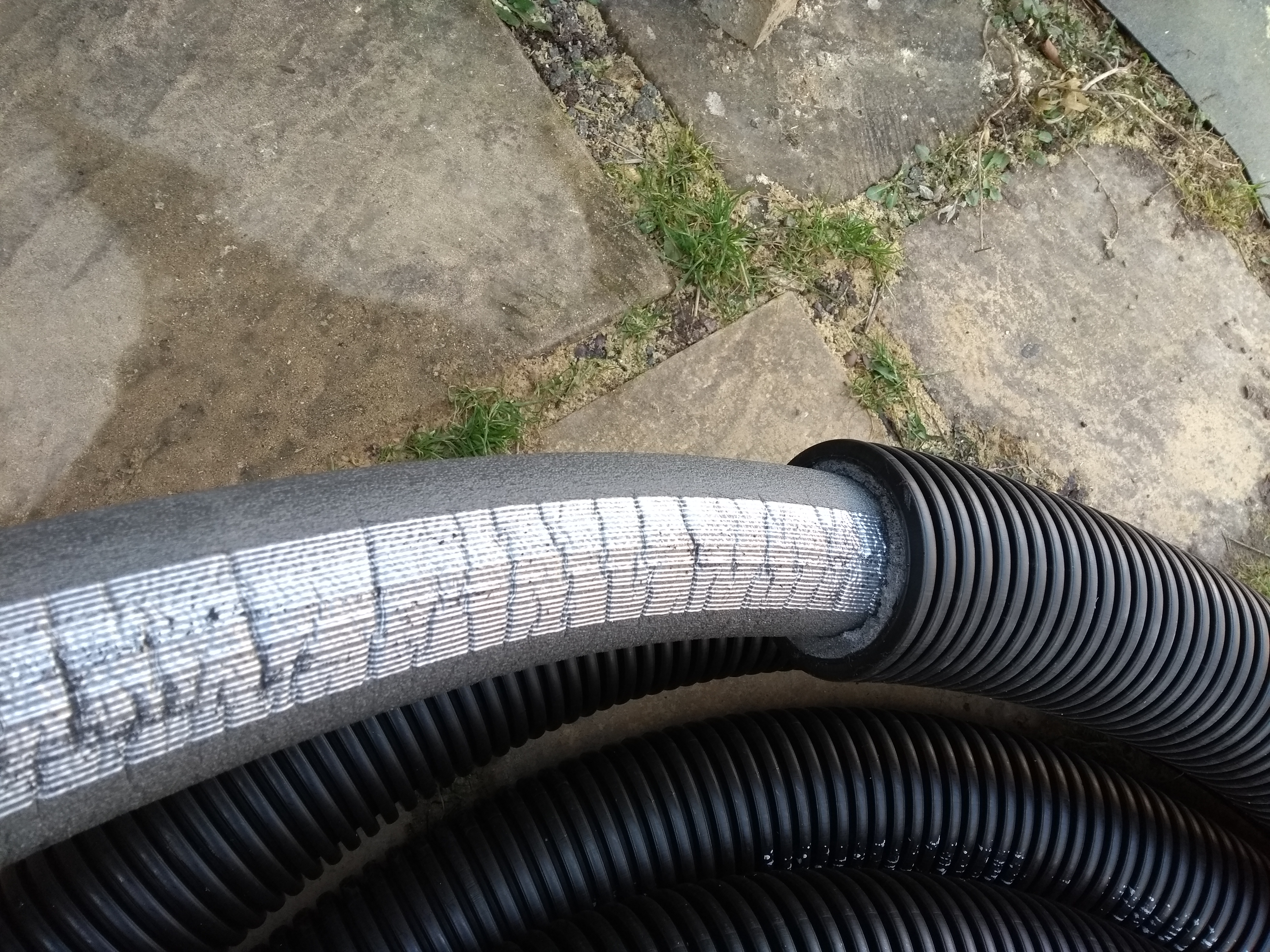

PeterW Posted February 11, 2018 Share Posted February 11, 2018 Thanks @JSHarris - what is the outer dimension on the flexi pipes ..? Just wondering if 22mm insulation will fit. Link to comment Share on other sites More sharing options...
Jeremy Harris Posted February 11, 2018 Share Posted February 11, 2018 (edited) 9 hours ago, PeterW said: Thanks @JSHarris - what is the outer dimension on the flexi pipes ..? Just wondering if 22mm insulation will fit. I used 28mm insulation, as 22mm was too tight. I can measure one of the spares I have and let you know the size tomorrow. Edited to add: @PeterW, I've just found what look to be similar spec, but shorter length, flexis on the Pipestock website. They give the OD of their 19mm bore, 3/4" BSP fittings, pipes as being 27mm. My guess is that the BES ones would be the same, as the spec seems to be the same, apart from Pipestock not doing flexis that are that long. Edited February 11, 2018 by JSHarris Added info Link to comment Share on other sites More sharing options...

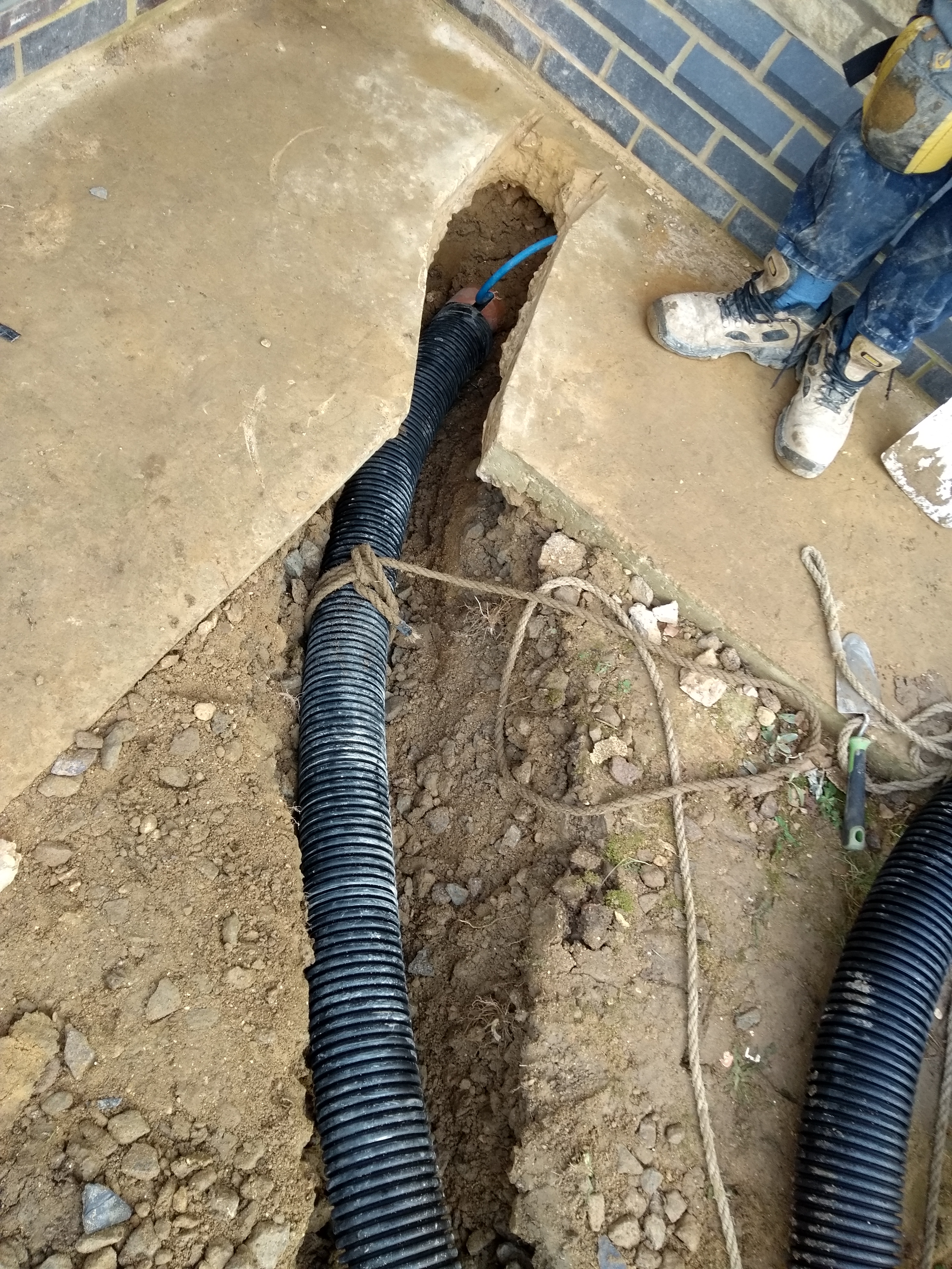

TerryE Posted February 11, 2018 Share Posted February 11, 2018 (edited) Thanks guys. You are just juggling so many balls in the air during design and construction that you are bound to drop one or two. In this case we used 110mm pipe foulwater pipe as an access path from the service cupboard out beyond the slab. I mistake that I made was using a normal 87½° bend to bring it up into the service cupboard instead of a Drainage 87.5° Rest Bend, or even a 45° and cutting the stub off at an angle. The normal bend has a radius at centre of around 110mm and 160 at the outer curve. This was enough to get a 25mm MDPE DCW feed up the other access pipe. It's really touch and go as to whether installing an ASHP will be cost effective, and there's no urgency. I was going to wait until autumn when I've seen how the house performs during both winter and summer before making the call. The issue that we now face if that Jan is now in JFDI mode and wants to get all of the outside paving done by a local contractor including paving over the run where we'd need to bury the pipe. It's just not worth having to dig up a trench across the new paving, so I guess that the sensible thing to do now is to fork out the £500 or so for the proper insulated pipe and get our paving guy lay it under the paving whether we end up using it or not. Time get the 9" angle grinder out. I've got to clear the concrete perimeter up the pipe -- yes, I know that I should have left a length of ESP along the trench line and had the concrete about 25mm depth over it, but again -- a Tardis moment. PS. Concrete trenching all done and outside of access pipe exposed. A combination of a 9" Angle grinder with diamond disc and a decent SDS drill to put "stamp tear perforations" across the bit wanted to chop out made fairly easy work of it. As Jan pointed out, the reason for our JDFI (army acronym -- Just F***ing Do It) mode is that we want our VAT back as the paving plan was part of our landscaping and implementing is a planning condition so the work is zero VAT rated if we do it before sign-off. Edited February 11, 2018 by TerryE Add PS 1 Link to comment Share on other sites More sharing options...

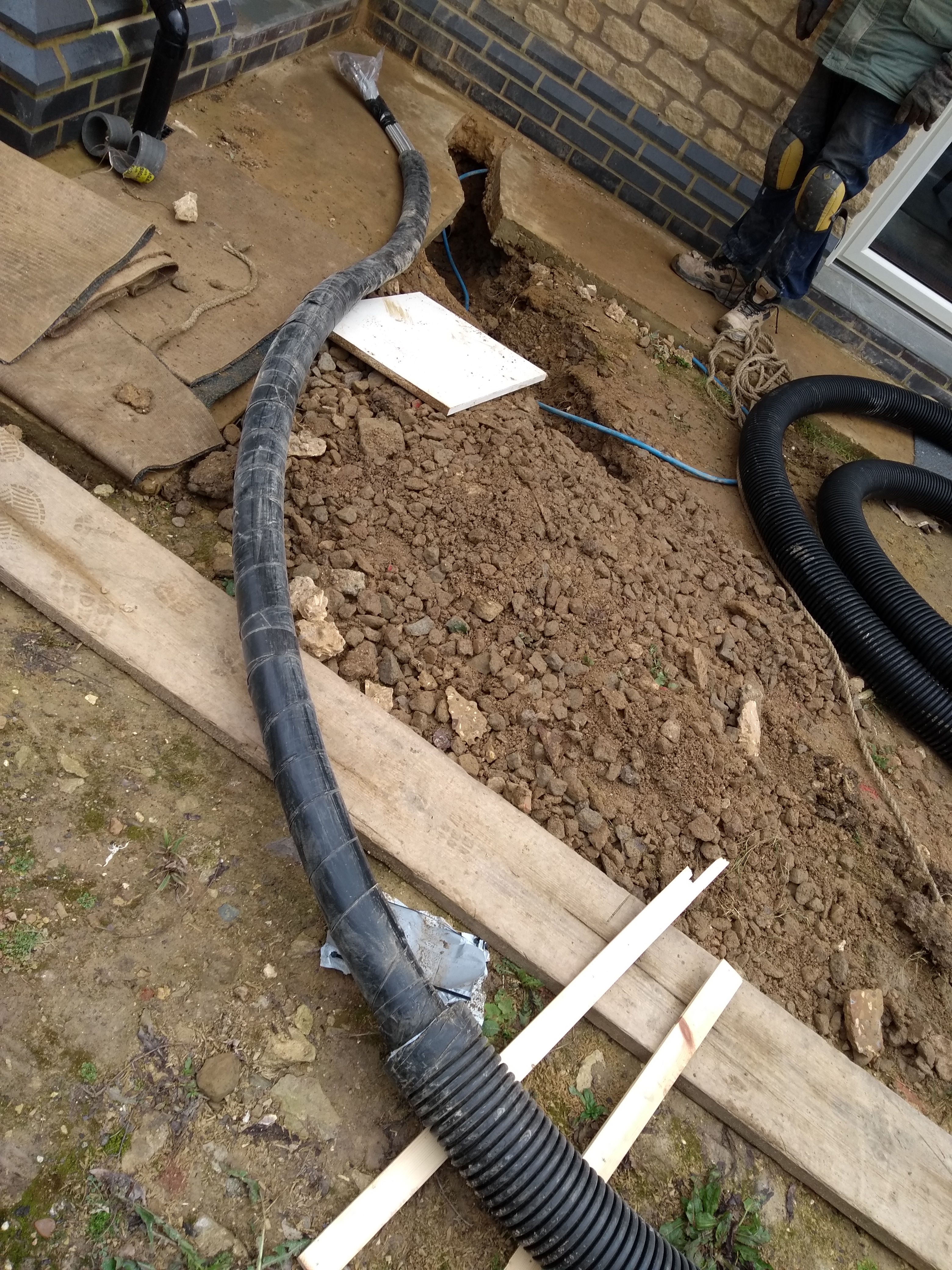

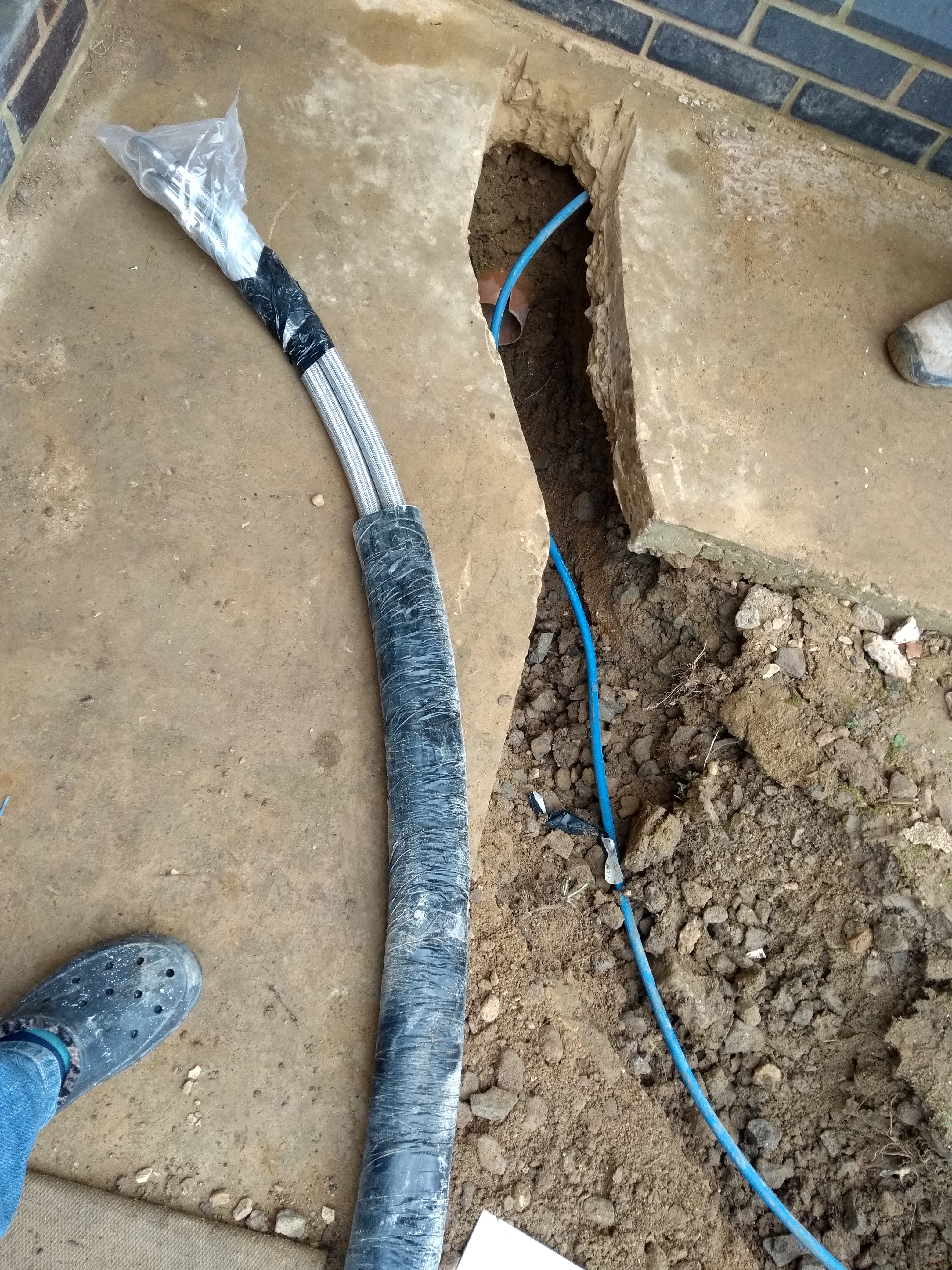

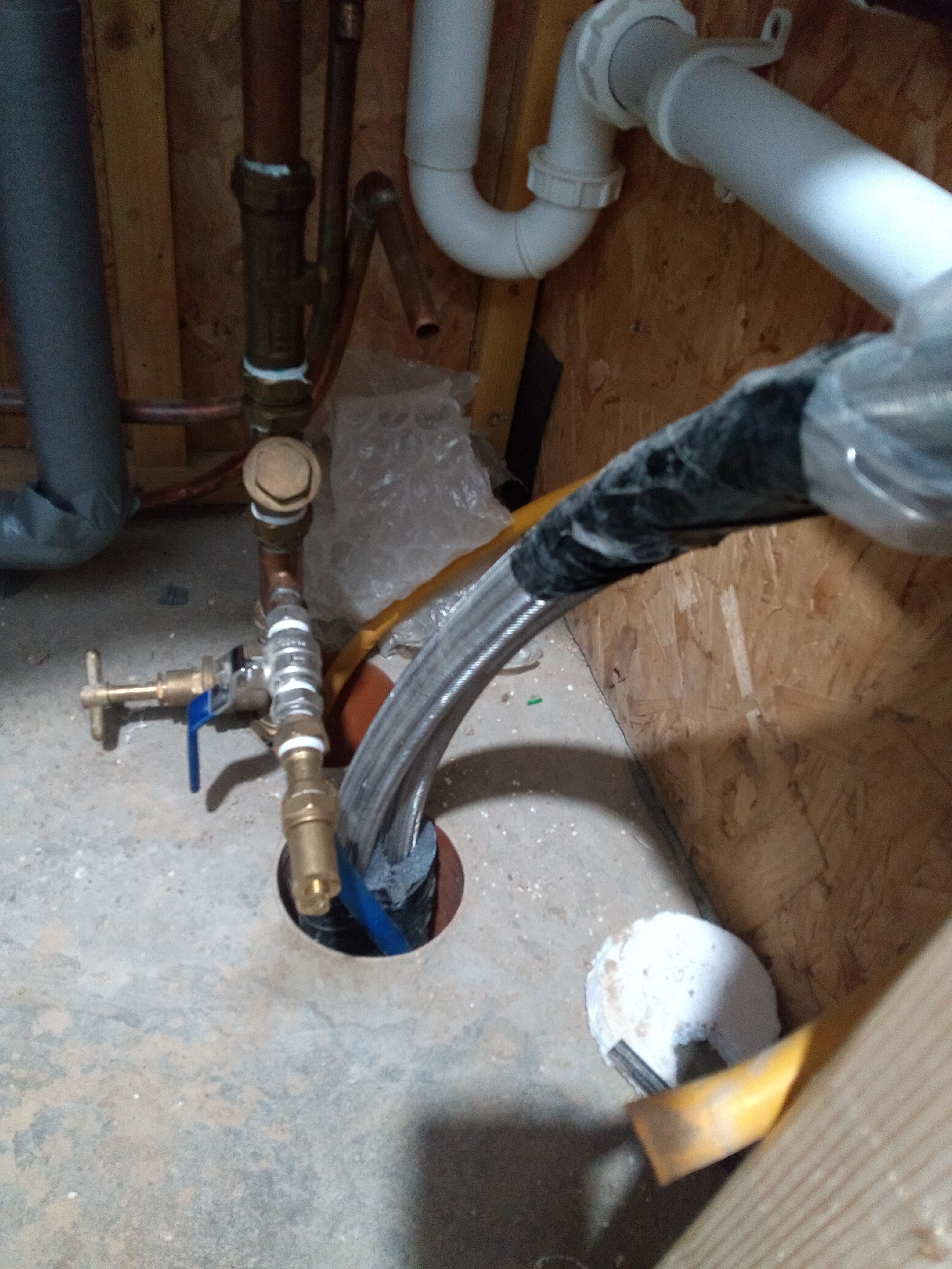

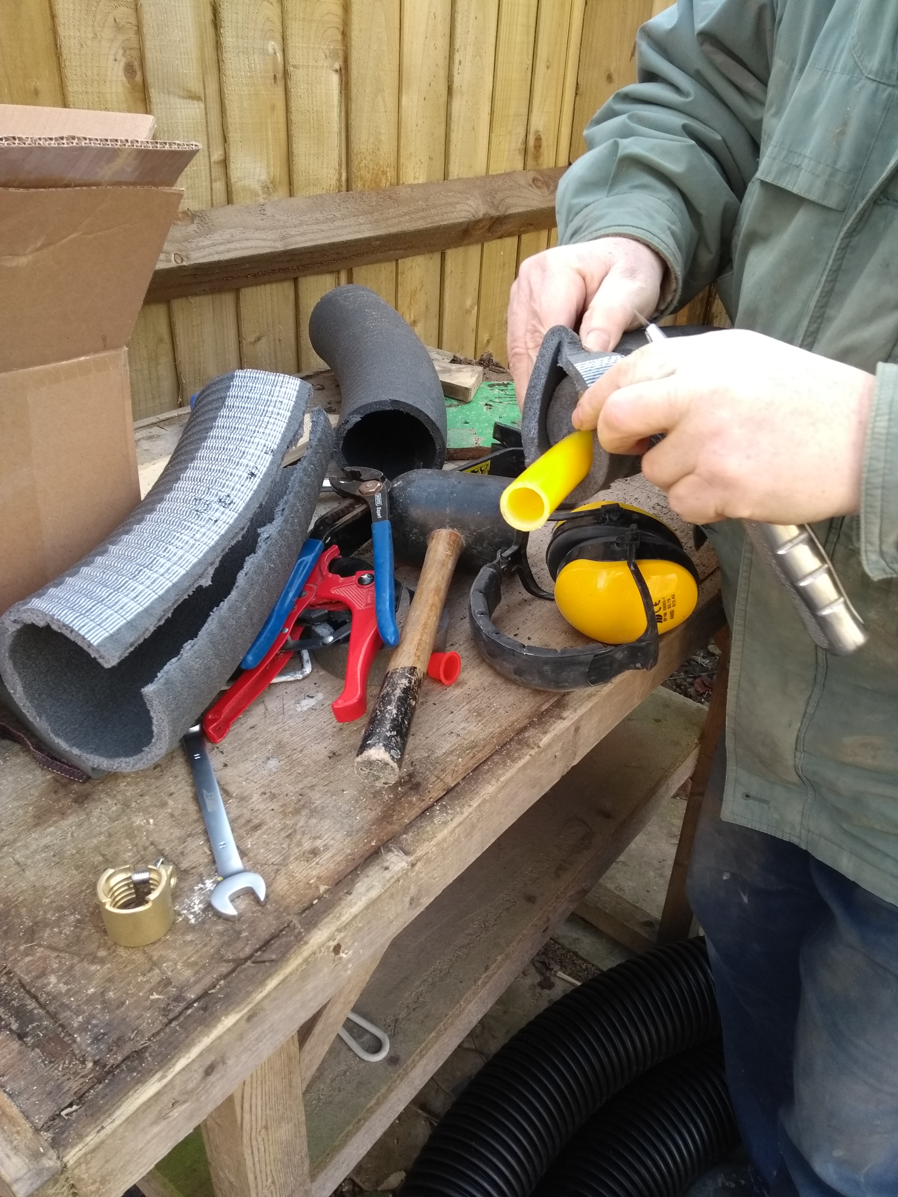

JanetE Posted February 18, 2018 Share Posted February 18, 2018 (edited) Well we've spent the weekend fitting the ASHP pipe according to @JSHarrisrecommendation (thanks Jeremy, great help as always). Bought the pre insulated pipe that @Barney12 recommended. Stripped off the outer corrugated protection for the part that enters the access pipe. Luckily there was a double layer of insulation and we only needed to remove the first layer. Then connected the 1.5m flexis. Wrapped them in insulation and then wrapped the stripped back section and the insulated flexis in polythene and duck tape. The pipe fed in pretty easily once we got some rope tied around the corrugated section about two meters back and used it to give us a grip on the pipe and enable us to push it in. We can now just get the paving guys to bury the pre insulated pipe to the approximate position for the ASHP. Edited February 18, 2018 by JanetE 1 Link to comment Share on other sites More sharing options...
Jeremy Harris Posted February 18, 2018 Share Posted February 18, 2018 Really glad it went well for you. Looks like a pretty good job, too, and it should be easy to seal up around that hole. One thing to watch is rodents. What I did before sealing ducts with foam was to roll up a ball of chicken wire, thread a bit of stiff wire (I used old coat hanger wire) through and make it secure, then push the chicken wire down the duct, leaving the thicker wire poking up. Then foam and seal around the pipes in the duct and trim the bit of wire down a bit if need be. Do this at both ends of the duct. If you ever need to get the pipes out of the duct for any reason, you can then chip away the foam, grab the stiff wire with a pair of pliers and pull the chicken wire and remaining foam out. 1 Link to comment Share on other sites More sharing options...
