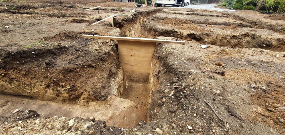

Mulberry View Posted September 13, 2022 Share Posted September 13, 2022 I'm just debating getting the shuttering in place in my foundation trenches. I have a few to do, but the specific one that's concerning me is one where I have to have a 600mm step on a T-Junction. Instinct initially said to shutter on the face of the joining trench, but I'm now thinking of setting the shutter some way (perhaps 500mm) into the leg of the 'T'. My rationale is that it'll be easier to install the shutter there and will provide a decent infill gap between the step and the adjoining wall, instead of the very short piece I'll have to add if the step is right up to the adjoining trench wall. Would a shutter holding back 600mm of concrete, say 500mm back from a corner be risky? Might it break the corner off the trench? I hope my explanation makes some sense to someone! Also, what materials to use? It would be helpful to see pictures of your shuttering for inspo. Link to comment Share on other sites More sharing options...

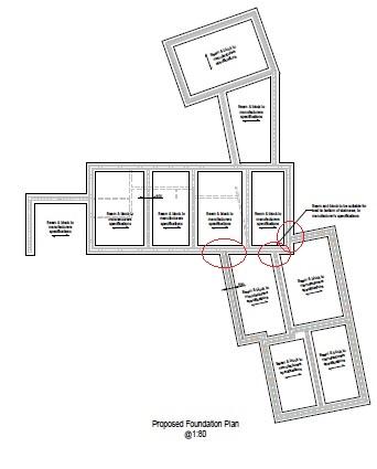

Mulberry View Posted September 13, 2022 Author Share Posted September 13, 2022 5 minutes ago, ProDave said: That is a big step. I would do it in two 300mm steps, much more managable. Fair point. I have 3 trenches that require this step, circled in red on this plan. The main rectangular shape (the one with 3 sleeper walls) is 600mm lower than the adjoining building. You'll notice that one of the 3 adjoining trenches is rather close to a corner, so I'm not sure of the practicality of 2 steps. Maybe one would be before the corner and one after it? We're on hard chalk, so apparently we don't have to think too much about overlaps. Link to comment Share on other sites More sharing options...

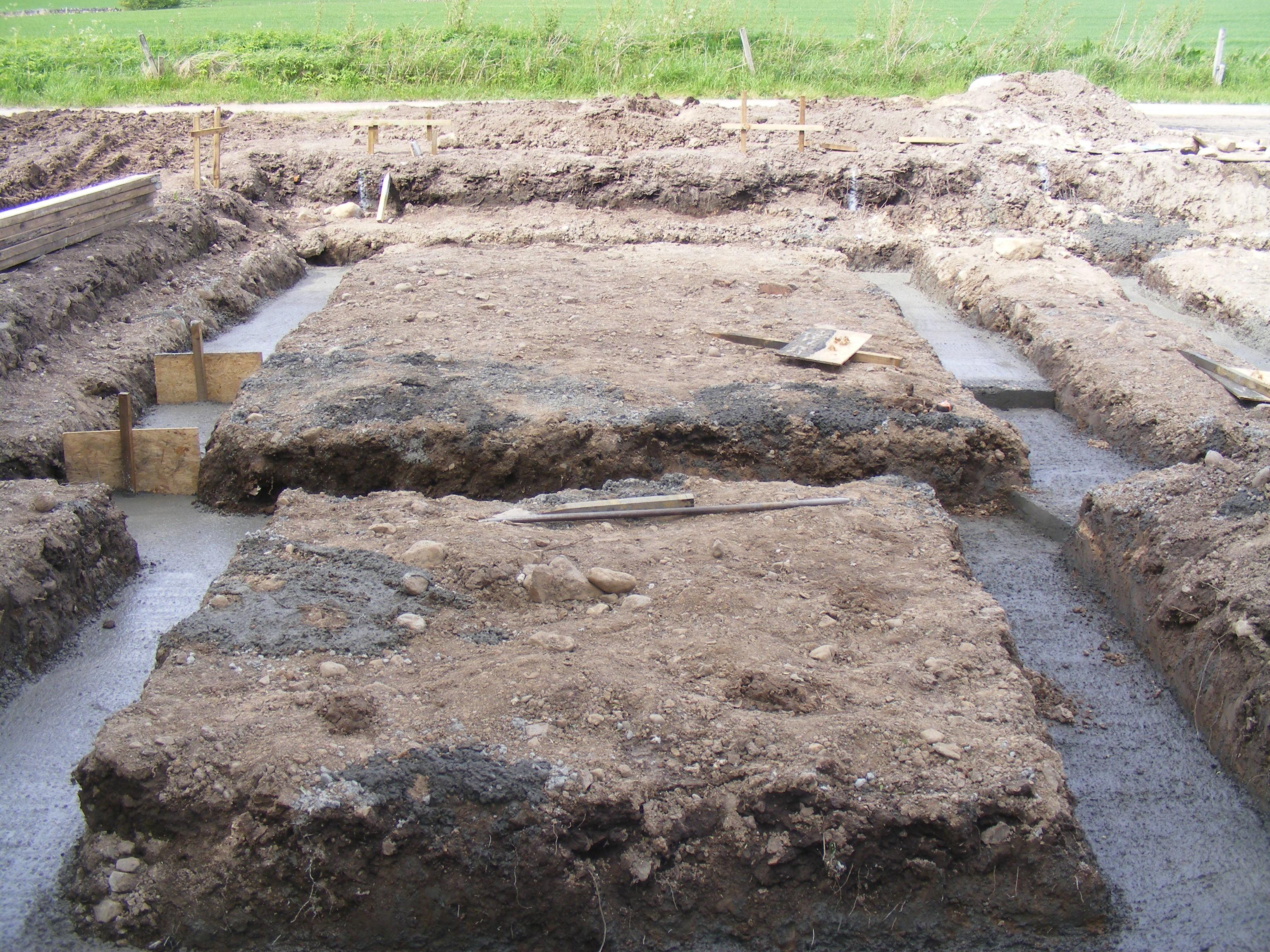

ProDave Posted September 14, 2022 Share Posted September 14, 2022 If the concrete flows under the shutter then it if far too wet. Our steps were small so the shuttering was very simple. 1 Link to comment Share on other sites More sharing options...
Mulberry View Posted September 14, 2022 Author Share Posted September 14, 2022 17 minutes ago, ProDave said: If the concrete flows under the shutter then it if far too wet. Our steps were small so the shuttering was very simple. It's a pump grade spec, going in with a boom pump. Will that mean its wetter? Thanks for the pic, I'm assuming some element of your timber will be stuck in the concrete afterwards? How far apart are the 2 steps in the top left of your pic? That's a similar arrangement to mine, though my steps will be bigger of course. Link to comment Share on other sites More sharing options...

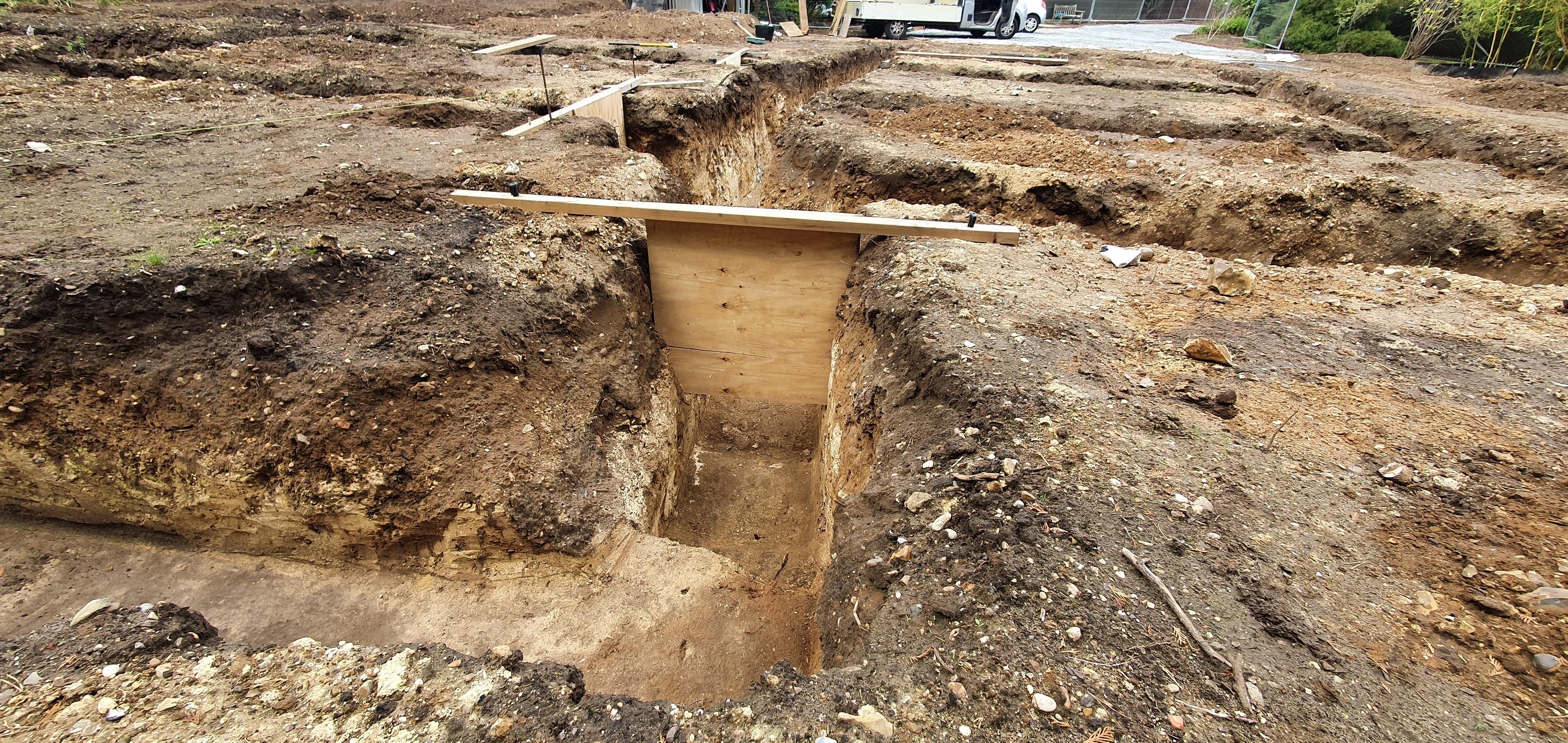

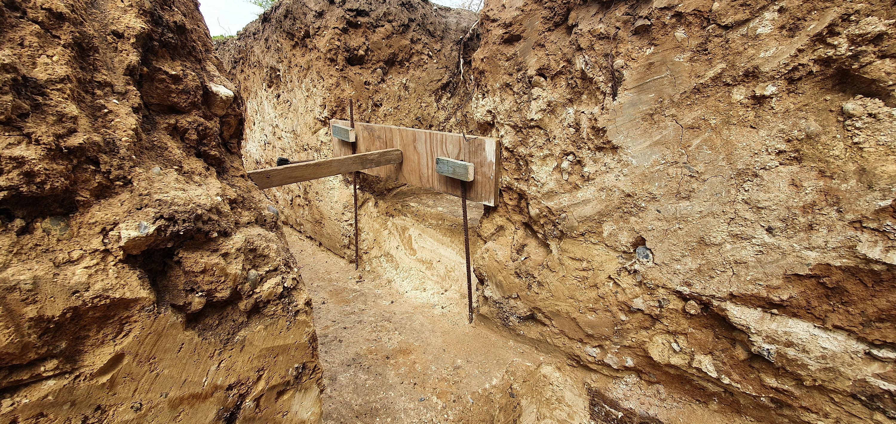

Mulberry View Posted September 19, 2022 Author Share Posted September 19, 2022 I can't get my head around the notion that this shuttering will work. In this example, the shutter is set up so that the bottom edge is the level of the concrete in the adjoining trench on the other side of the shutter. On the nearside, the step is 600mm (for reference, there is a line of screws that denote the level, it's about 300mm down from the top of the board). As the concrete can flow under the shutter, will the large head of concrete on this side of the shutter not influence the level on the low side? Here's another example. The concrete on the nearside is about 400mm deep and will be level with the underside of the shutter, on the far side, the level rises to 125mm higher, but not quite to the top of the shutter. I'm the king of overthinking. Pour day is tomorrow, I need to be able to sleep tonight knowing my shutters will work. Link to comment Share on other sites More sharing options...
Canski Posted September 19, 2022 Share Posted September 19, 2022 Looks fine. When you pour put some against the shutters first to close the gap then move on somewhere else in the foundation. Come back to it later and it should have gone off enough to fill it up. ( as long as your shutters hold) 1 Link to comment Share on other sites More sharing options...
Mulberry View Posted September 19, 2022 Author Share Posted September 19, 2022 Baffling, but thanks. I really hope the shutters hold. 🤣 Link to comment Share on other sites More sharing options...
saveasteading Posted September 19, 2022 Share Posted September 19, 2022 In theory that can work, but beware the ready-mix driver just pouring it fast and hard, as the force from fast moving concrete is huge. That apples especially where the fixing pin is near the trench edge. Safer to have it poured into the trenches away from the shutter then shifting it along, with similar pressures both sides. Prepare for the worst and it should be an anti-climax, which is what we want. Link to comment Share on other sites More sharing options...
Miek Posted September 19, 2022 Share Posted September 19, 2022 With a boom pump you will be fine as long as the operator is good, they do this day in day out, they will know how to avoid breaking the shuttering. 1 Link to comment Share on other sites More sharing options...
Canski Posted September 19, 2022 Share Posted September 19, 2022 I would put another timber on shutter 2 though Link to comment Share on other sites More sharing options...
saveasteading Posted September 19, 2022 Share Posted September 19, 2022 Just now, Miek said: as long as the operator is good Prepare for the worst, assume he is not good, and the weather is foul. There is often a reluctance to tell a tradesperson 'how to do their job'. tell him you are nervous about the shuttering (ie your skills not his) and ask if there is a way of protecting it and he will possibly be patronising, but all will be well. Link to comment Share on other sites More sharing options...
