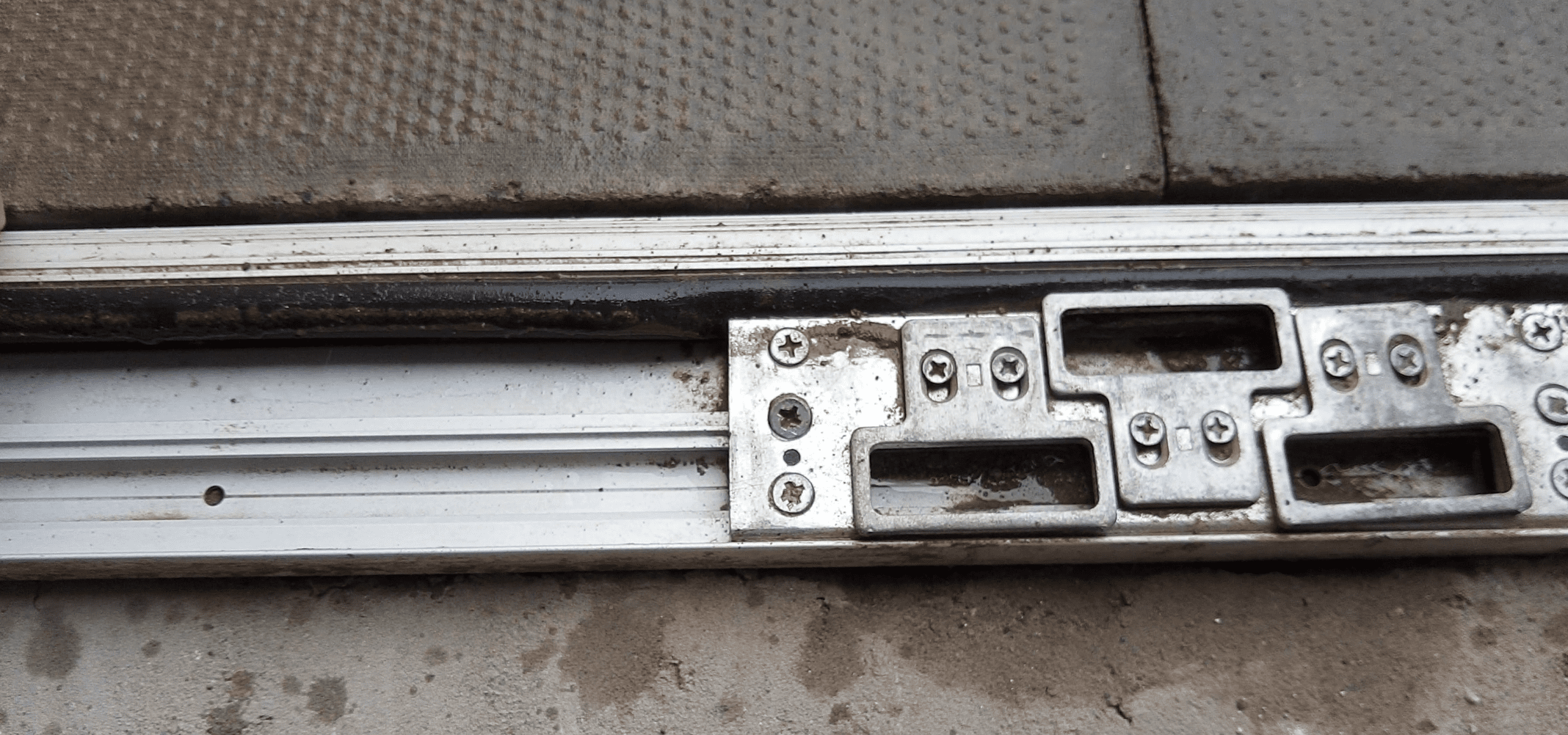

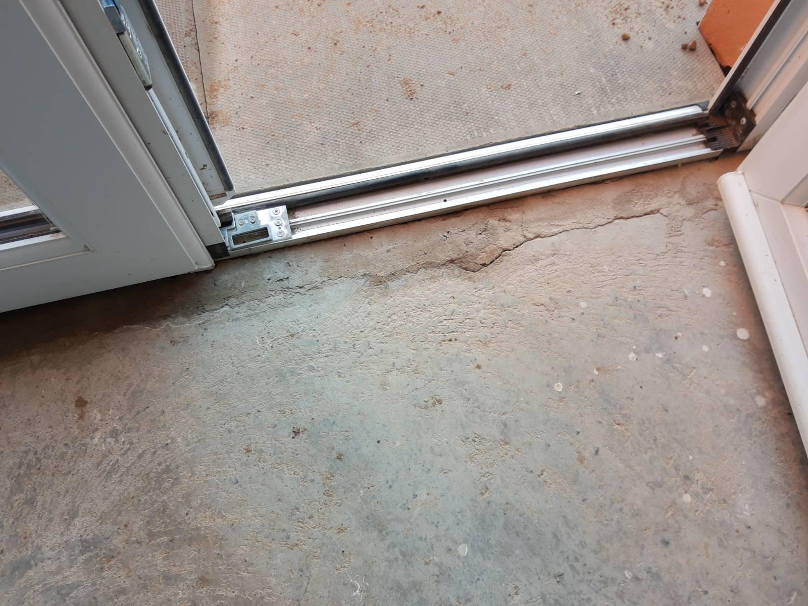

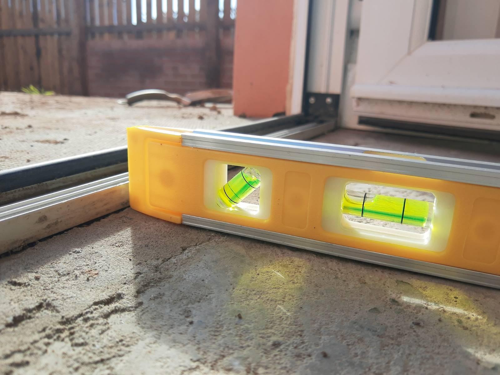

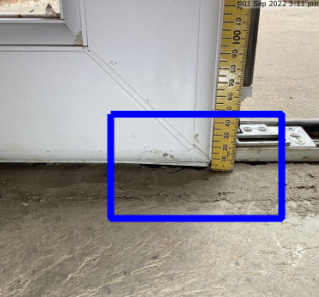

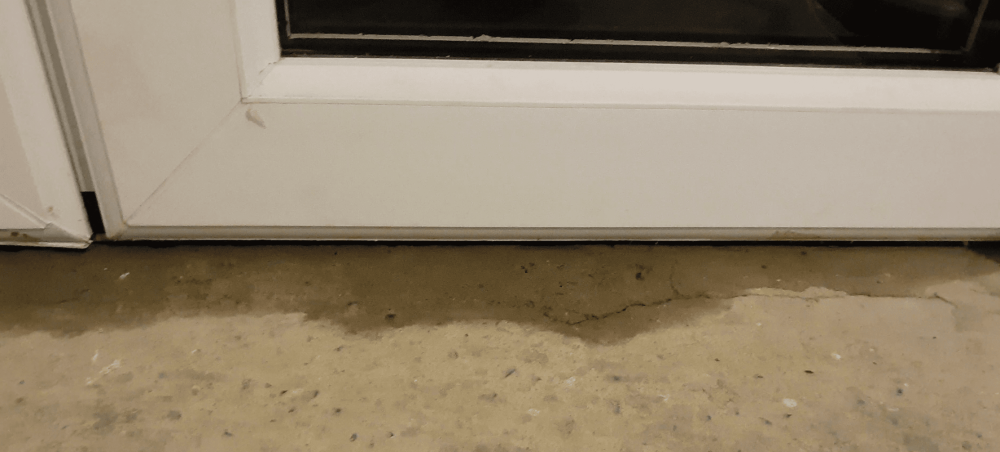

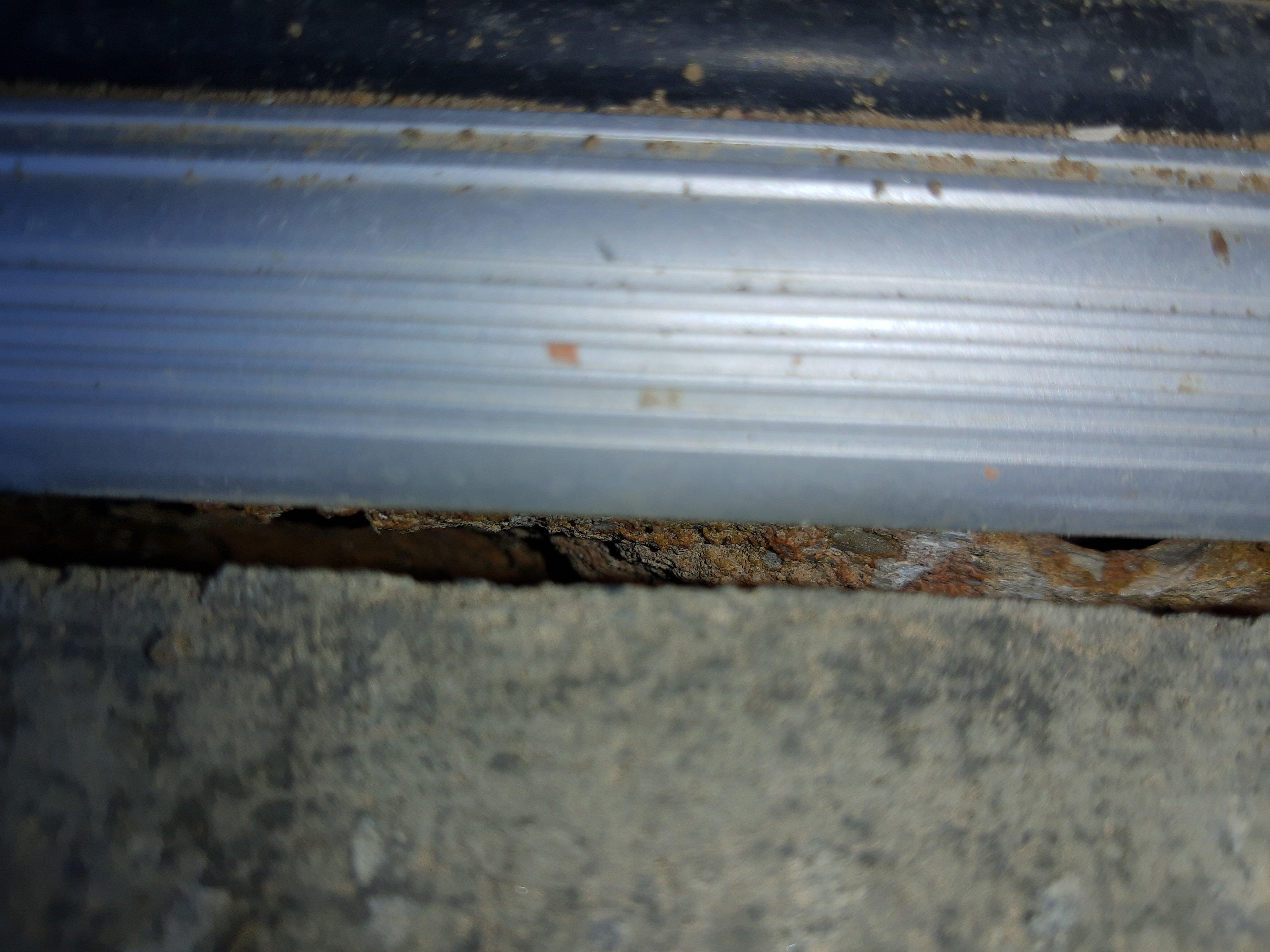

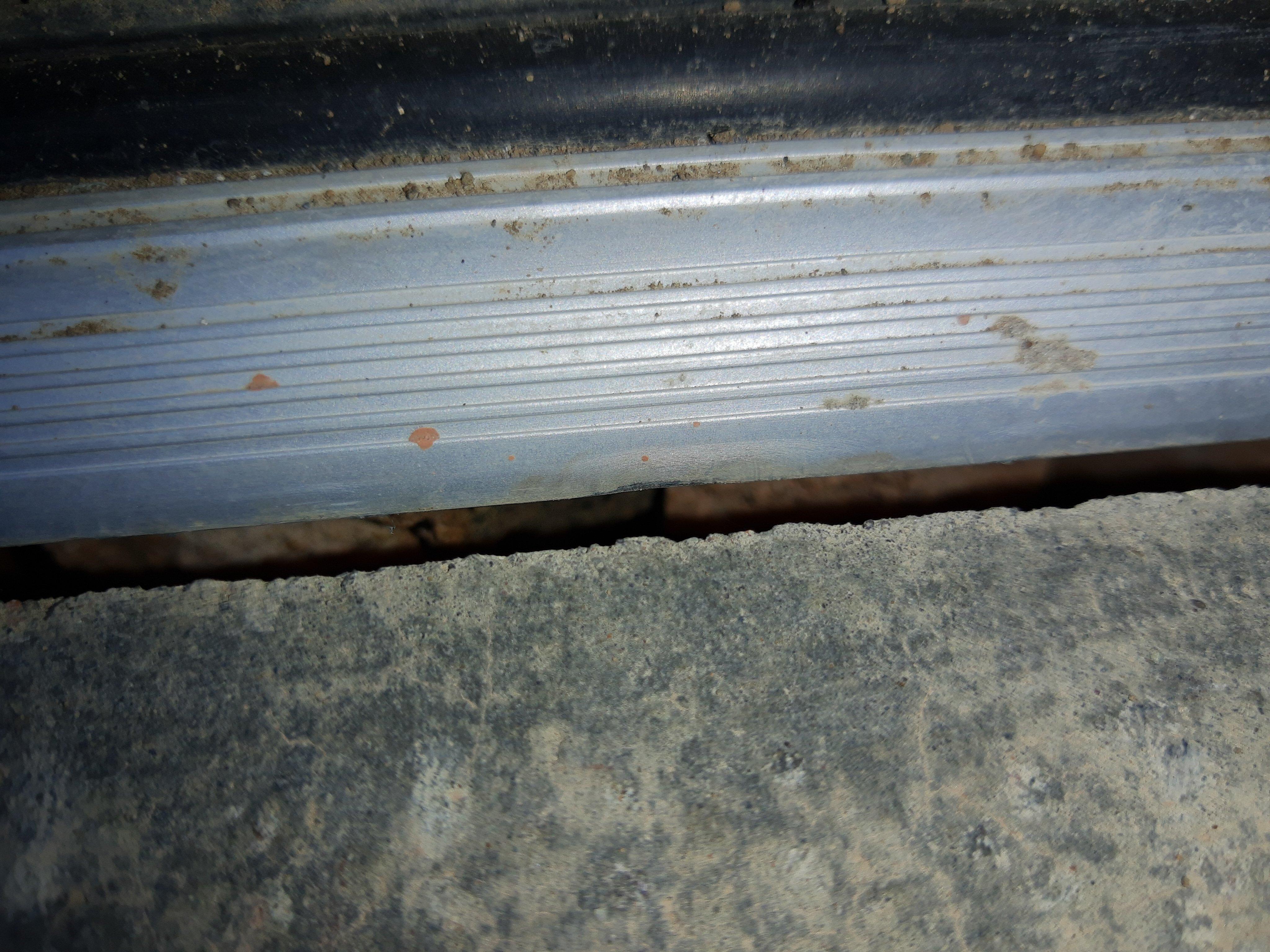

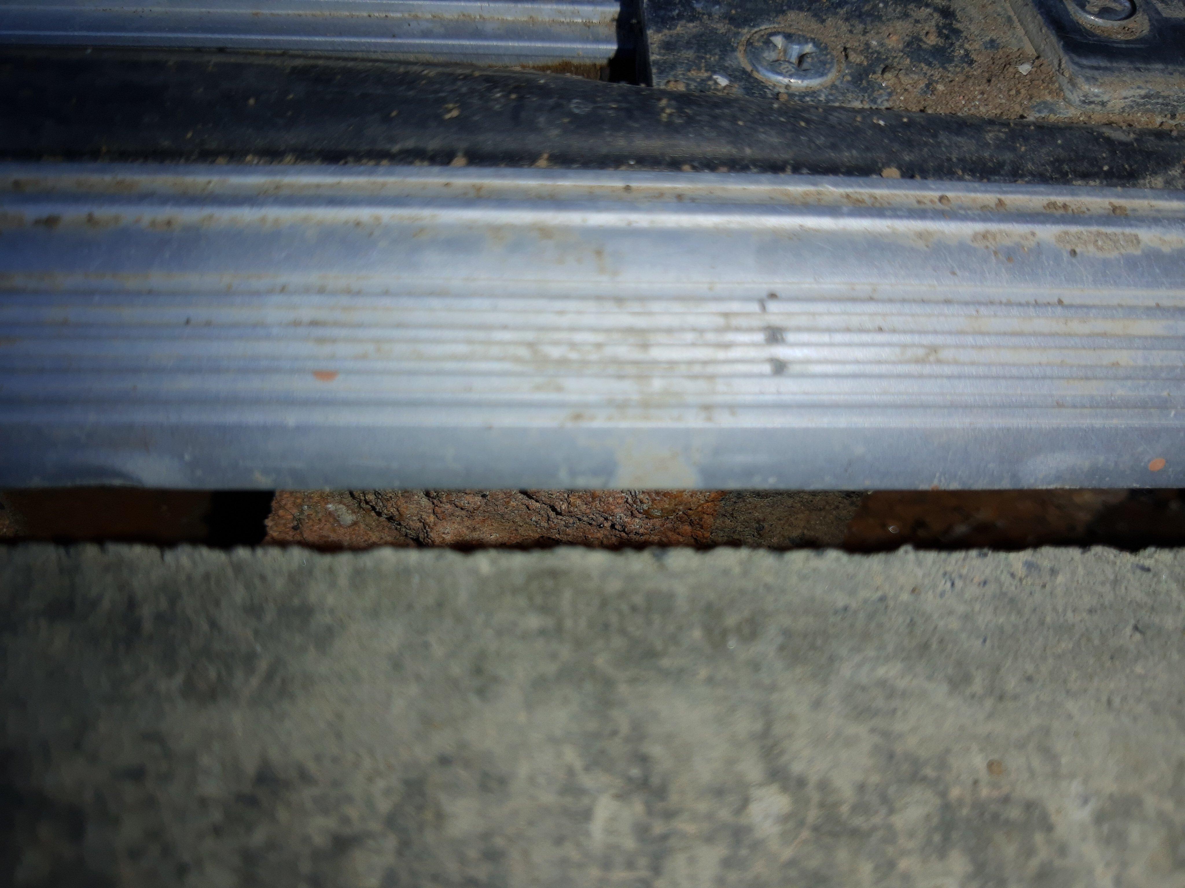

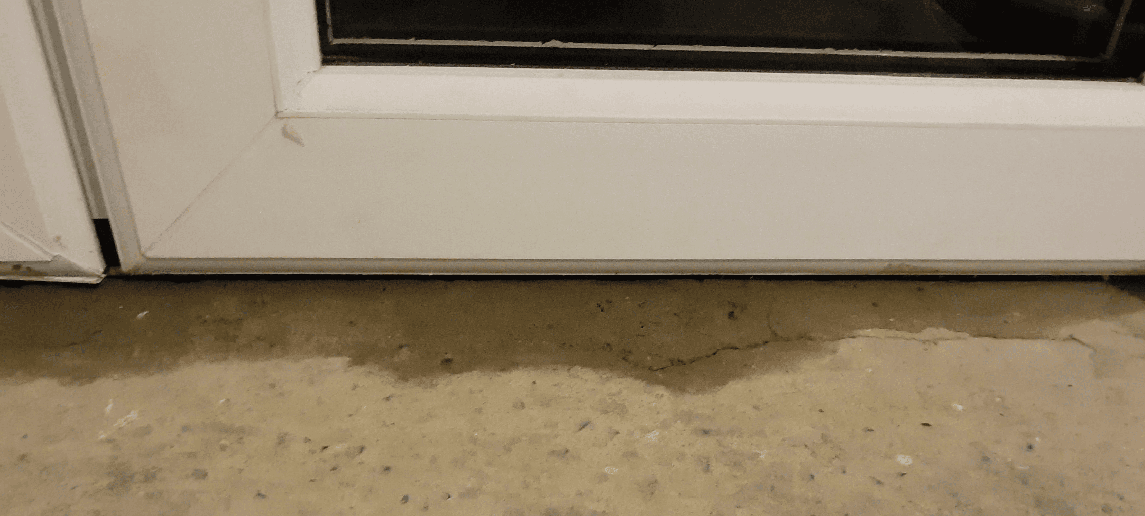

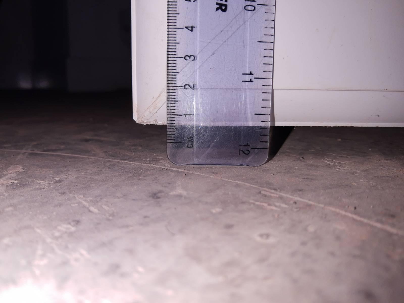

Tamdray Posted September 13, 2022 Share Posted September 13, 2022 Hello, Forgive me if this is not a right place for this post but I do not know where to look for advice, and I would appreciate it if anyone could direct me to a right organisation or person. I have a problem with the French doors in the new build that I have recently purchased. Description of the problem: - “French door are approximately few 3mm of floor level” as reported on a snag report (snagging was conducted by an independent company – picture 1), - “Door frame is level with floor slab”, as reported on the snag report (picture 2) - “frame at ground level secured to nothing it moves”, as reported on the snag report (picture 2), - The gap between the floor and the bottom of the French door does not allow to lay flooring other than vinyl sheet, according to a flooring company, - The concrete inside the house next to the ground part of the frame becomes wet when it rains (Picture 3a and 3b) - My neighbours also noticed the ingress of water next to their French doors. The builder’s respond: - The French door has been built/installed correctly as it is for wheel chair access and this is the reason why the door frame is level with floor slab and why the frame must be loose. - The water ingress should not take place and DPC tape/insulation will be used between the concrete floor and the bottom door frame to prevent the ingress. The fix will take place when the concrete becomes dry. My points are: - When comparing the build, design, condition or installation of the French door with the recommendation presented at https://www.building.co.uk/cpd/cpd-7-2015-level-thresholds-and-water-ingress/5073874.article (I am located in Scotland), I have a serious concern about the condition of the drainage (pictures 4a-c). I cannot lift the landing area to inspect it and provide better photographs. Instead of a drainage channel there is only a gap between the landing area and the door’s slab. In the gap, there seems to be nothing but earth ground (no concrete, no PVC element, or anything that would work a drainage system). However, what I am worried the most is that under the door slab there seem to be some randomly put stones or bricks with huge gaps, cracks and wholes in and between them. I think that these areas are responsible for the ingress of water. - If the above is correct, I think that the DPC tape/insulation will not solve the problem because the ingress of water takes place underneath and not between the slab and the concrete floor. Could you advise, please? Link to comment Share on other sites More sharing options...
Nickfromwales Posted September 13, 2022 Share Posted September 13, 2022 Hi. The gaps under the threshold are unacceptable and zero requirement for disabled access compliance. Complete and total bollocks, I’m afraid. Negligence in setting the entire door / frame unit in, to be sympathetic to your chosen floor covering is just poor practice, and again, shouldn’t be tolerated. Damp / water ingress from outdoors to inside is a fundamental installation error and that should have been mitigated BEFORE the unit was installed, and cannot practically be done retrospectively afaic. The unit needs to be removed and reinstalled, with those measures considered and executed correctly. 35 minutes ago, Tamdray said: The builder’s respond: - The French door has been built/installed correctly as it is for wheel chair access and this is the reason why the door frame is level with floor slab and why the frame must be loose. - The water ingress should not take place and DPC tape/insulation will be used between the concrete floor and the bottom door frame to prevent the ingress. The fix will take place when the concrete becomes dry. This is utter nonsense, and simply fails to accept the problems which 100% defo exist here. The unit needs to come out, there is no other way. That will allow for the threshold height to be set to the internal finished floor level ( ffl ) according to what you prescribe that to be. Tell this muppet “no sale”. 4 Link to comment Share on other sites More sharing options...
Temp Posted September 13, 2022 Share Posted September 13, 2022 (edited) 1 hour ago, Tamdray said: The builder’s respond: - The French door has been built/installed correctly as it is for wheel chair access and this is the reason why the door frame is level with floor slab and why the frame must be loose. - The water ingress should not take place and DPC tape/insulation will be used between the concrete floor and the bottom door frame to prevent the ingress. The fix will take place when the concrete becomes dry. Total BS. 1) The Building Regulations (Part M) normally only require the front door to be "level access" and even then you are allowed a 12mm high step/weather bar above the finished floor level (eg above any wood flooring or carpet). 2) There is no excuse for a loose frame. 3) The water is coming in because its not fitted correctly. Worse they propose sealing it with tape on the inside ! Totally wrong. The water seal should be on the outside but that might mean taking the door out and fitting it correctly. As others have said the door needs to come out and be correctly fitted. The door might need to be remade.... It's quite possible they measured or built the opening incorrectly so when it came to fitting the door frame it was too tall. It's too difficult to raise the lintel above the door so they probably removed or cut bricks at the bottom and installed the door lower than it should be. The correct thing to do was get the door remade. Edited September 13, 2022 by Temp 2 Link to comment Share on other sites More sharing options...

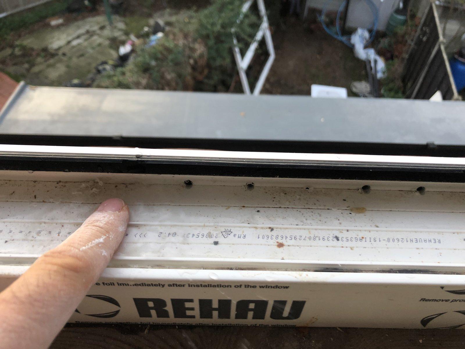

Temp Posted September 13, 2022 Share Posted September 13, 2022 (edited) PS: If this door does need to be wheelchair friendly for some reason.... I believe they have used the wrong type of door and sill. It looks like they have just fitted a standard non-wheelchair type too low in the hope that will do. A clue is the thin upstand nearest to you in this photo. I don't think its strong enough for a wheel chair to drive over regularly.. Edited September 13, 2022 by Temp 1 Link to comment Share on other sites More sharing options...
Dave Jones Posted September 14, 2022 Share Posted September 14, 2022 (edited) The door manufacturer will have a specification for building in a level threshold design, ask them for it then ask builder/fitter if its been complied with. There are not many who make them. We have used successfully in the past a standard full cill, where the cill provides the both the drainage channel for the frame and the weatherproofing, this is then slabbed over tight top the frame. You must make sure though that the cill can drain under this either by bedding on pea gravel if your ground doesn't pool or a linear under it tight to house and then drain to the soakaway (better). Lastly as you are breaching the DPC i would recommend the builder fits a cavity tray along the full elevation of that wall 1 block higher on the inside to comply with building regs about ground level being below DPC by a min 75mm etc All of this cant be done as an afterthought and needs to be planned from the get go which many on a price builders wont care/do as it requires time and effort. Architects even more clueless if your unlucky enough to be paying one to 'manage' it. Edited September 14, 2022 by Dave Jones 1 Link to comment Share on other sites More sharing options...

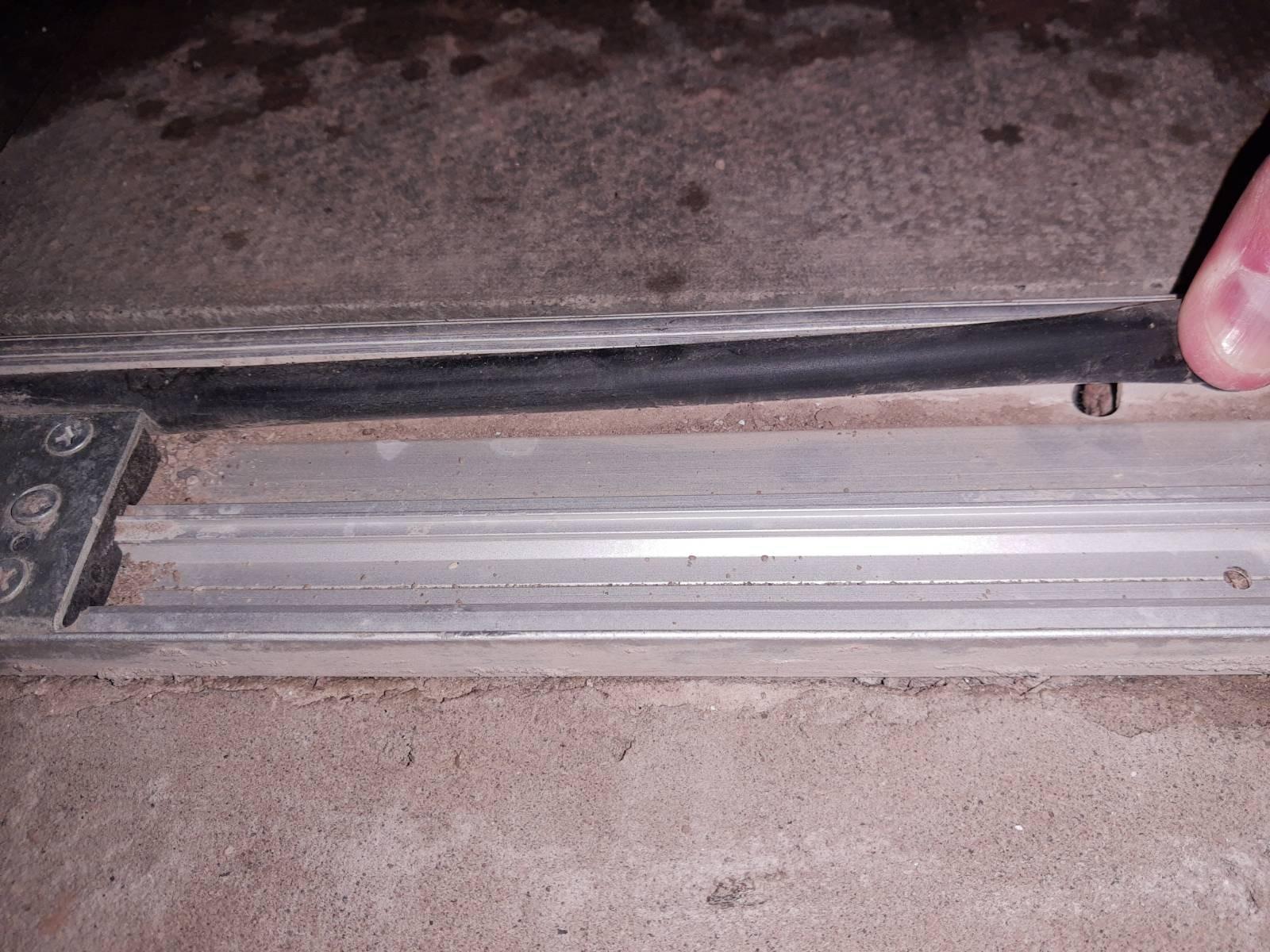

Marvin Posted September 14, 2022 Share Posted September 14, 2022 Yes.... when you put the frame in you have to take into account the inside floor covering thickness. Secondly the cill must have solid support otherwise it will bend when wheeled over. Last one I repaired the fitters had filled the gap below the threshold with foam!!! 1 Link to comment Share on other sites More sharing options...

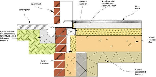

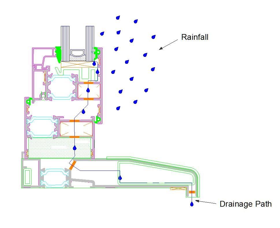

Temp Posted September 14, 2022 Share Posted September 14, 2022 (edited) 3 hours ago, Tamdray said: There has been some positive development today. The builder proposed to use a solution similar to the one described on the website from my first post i.e. https://www.building.co.uk/cpd/cpd-7-2015-level-thresholds-and-water-ingress/5073874.article, and although they are trying to avoid taking out the doors and fitting it again it seems that they are considering the option, and I think that thanks to your elaborate comments I will be able to reason and persuade them or even demand it from them. The only aspect they are adamant about is the necessity for wheelchair access, which puts me in the position of conducting research on actual building regulations and learning whether they must apply. Thank you, @Temp for mentioning the Part M. Depending on that, I will be either be arguing for taking out the frame and fitting it with the threshold height accommodating flooring of my choice or fixing it in accordance to your suggestions. I trust you all entirely and I would like to have the frame removed and refitted but I am not sure whether I will be able to win the 'building regulations' argument. OK the drawing from that link is similar to what we did for our front door. However it won't solve your other problem which is an inability to open the door if you fit carpet or wood flooring. To solve that the door and sill need to be raised, probably at least 20mm. But if you raise the sill you have I don't think it will meet wheel chair access regulations as it will probably be too tall. Its hard to tell from the photos but looks like wrong design. Regarding the water ingress... The weather seals on many doors will leak to some extent but they are normally designed so that any water that does get past the seals drains through passageways in the frame to the outside. This is sometimes called secret drainage. If they are installed too low or incorrectly this drainage route can be blocked and the only place for the water to go is inside the house. There is also the possibility of it collecting in the frame and freezing in winter. I would try and get information from the door manufacture. Check if it's intended for wheelchair use. Check their installation instructions have been or will be followed regarding drainage of the frame itself. This photo shows secret drainage holes on a window. Don't let the builder just drill holes, they will be designed in by the manufacturer.. And this shows the complicated path through the door and frame that water can take on some doors. Try and get the equivalent drawing for your doors from the manufacturer. Regarding the need to be wheelchair friendly.. I know the regulations have changed since we built our house so it is possible they have to be. Perhaps a planning condition was imposed requiring greater wheel chair access. Edited September 14, 2022 by Temp 1 Link to comment Share on other sites More sharing options...
Tom Posted September 15, 2022 Share Posted September 15, 2022 21 hours ago, Tamdray said: The only aspect they are adamant about is the necessity for wheelchair access, Sure, but it should be level with your finished floor covering - whatever you choose that to be. They clearly realise it's been fitted wrong and are grasping as straws to avoid having to replace the door (which they will need to do as they won't be able to shave anything off the lintel). Stick your heels in and hold your ground! 1 Link to comment Share on other sites More sharing options...

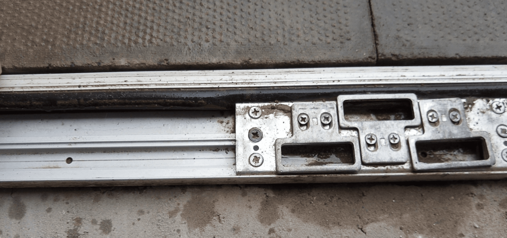

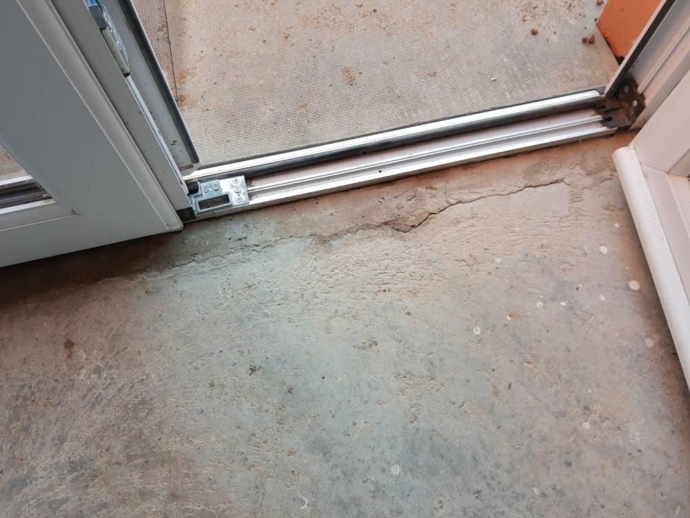

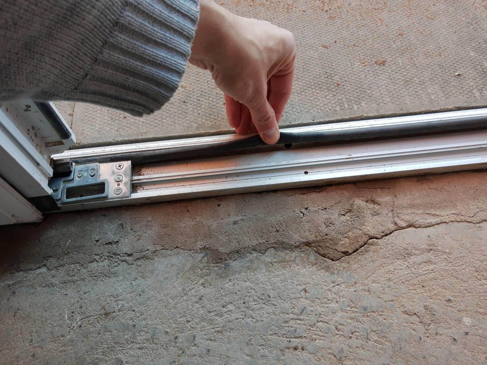

dpmiller Posted September 16, 2022 Share Posted September 16, 2022 @Tamdray where did the last photo in your post come from as it's from a different door? Link to comment Share on other sites More sharing options...
Tamdray Posted September 16, 2022 Author Share Posted September 16, 2022 It is the same door. 'Fresh' photographs below. Link to comment Share on other sites More sharing options...
craig Posted September 16, 2022 Share Posted September 16, 2022 It's installed wrong. Part M covers one main door for disabled access, the specs may indicate this to be done everywhere but the maximum stepover is 15mm and a straight-up edge is to be avoided. However, it looks like a complete failure to take this measurement from the FFL and they have taken this from the screed level. From screed, you would normally have 15mm/20mm floor covering, so at least 20mm of that frame on the bottom should be visible, which would supply approx. 5mm from the underside of the door sash, to the FFL. Link to comment Share on other sites More sharing options...
