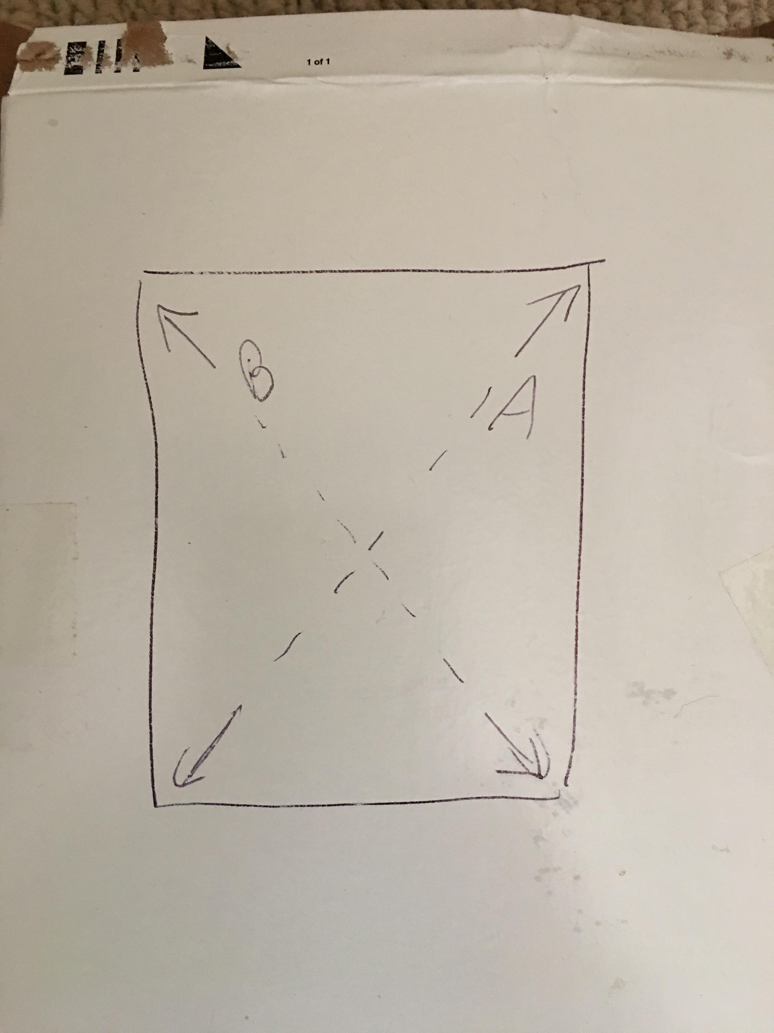

Pocster Posted June 12, 2017 Posted June 12, 2017 (edited) Hey all, Finally managed to source everything I need to do the 'wall' for which the sole plate sits on. Have a spinny rotating laser (technical term! ) for getting it level. One thing I am wary of is how to make sure it's square? i.e. A is the same length as B. Difficult to measure with a tape or pin and line as it's around 12metres. I'm concious I could drift and not be 'square'. Any suggestions on how I make sure this is ok? Also I *assumed* I would bed the corner blocks first so I have something to follow? Or should I use the length of A & B to set my run of bricks i.e. those lengths (assuming the same) are my guide??? I know I could pythagoras and build a 3-4-5 wooden triangle or similar; this the best method for the 90degress angle? Any advice appreciated! Cheers Edited June 12, 2017 by pocster

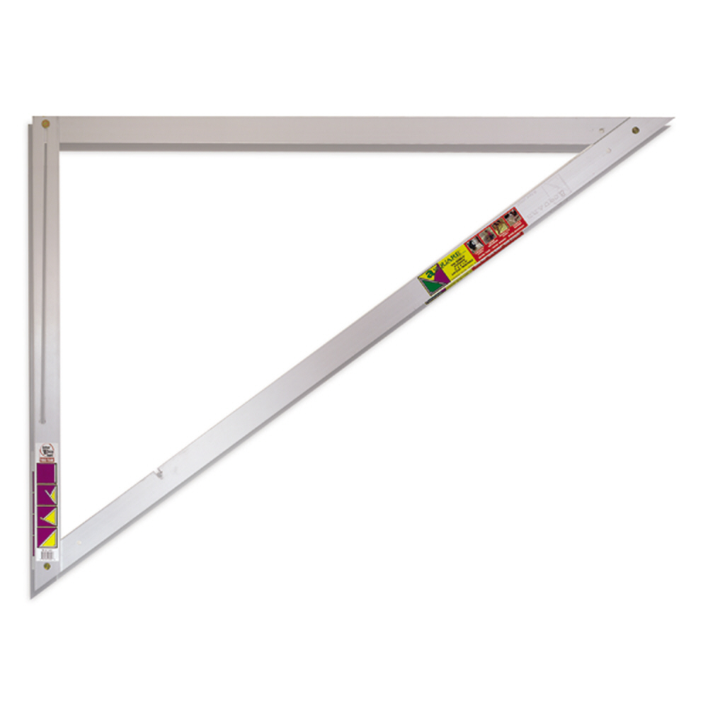

Russell griffiths Posted June 12, 2017 Posted June 12, 2017 This is very informative, the first 15 mins are probably irrelevant to you as I know you have started building already, I started to type out some of the things you need to do but as they say a picture paints a thousand words so I looked up a vid that should get you to a point where you will have a number of lines up that you can then check for square. I would go out and invest in a longer tape measure so you can check your diagonals. You can also buy a 3/4/5 square that folds up into a nice tube for protection, they are fairly dear but you will use it hundreds of times before you finish your build so long term a good investment.

Declan52 Posted June 12, 2017 Posted June 12, 2017 Buy two good quality metal tapes that are long enough for your diagonal. Plastic will stretch when you pull it.
Russell griffiths Posted June 12, 2017 Posted June 12, 2017 You can't beat tapping a nail in and pulling the tape measure out. Personally I would save my money on a digital tape and buy one of these. And as Declan said a good metal tape not a cheap plastic thing.

Declan52 Posted June 13, 2017 Posted June 13, 2017 If use 2 metal tapes then you will square it mins. If as mentioned you use nails to mark the points it's a job you can do yourself very quickly and accurately in no time in any weather. We all love a bit of new tech but for this job a gd metal tape is the winner every time. 1
