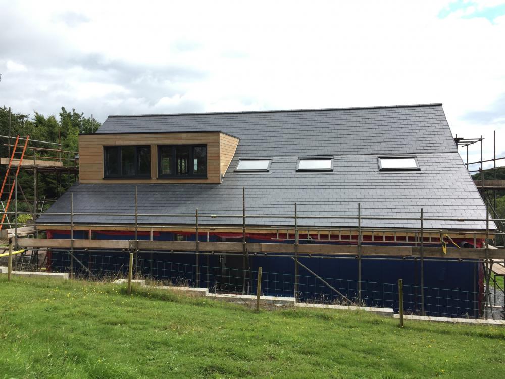

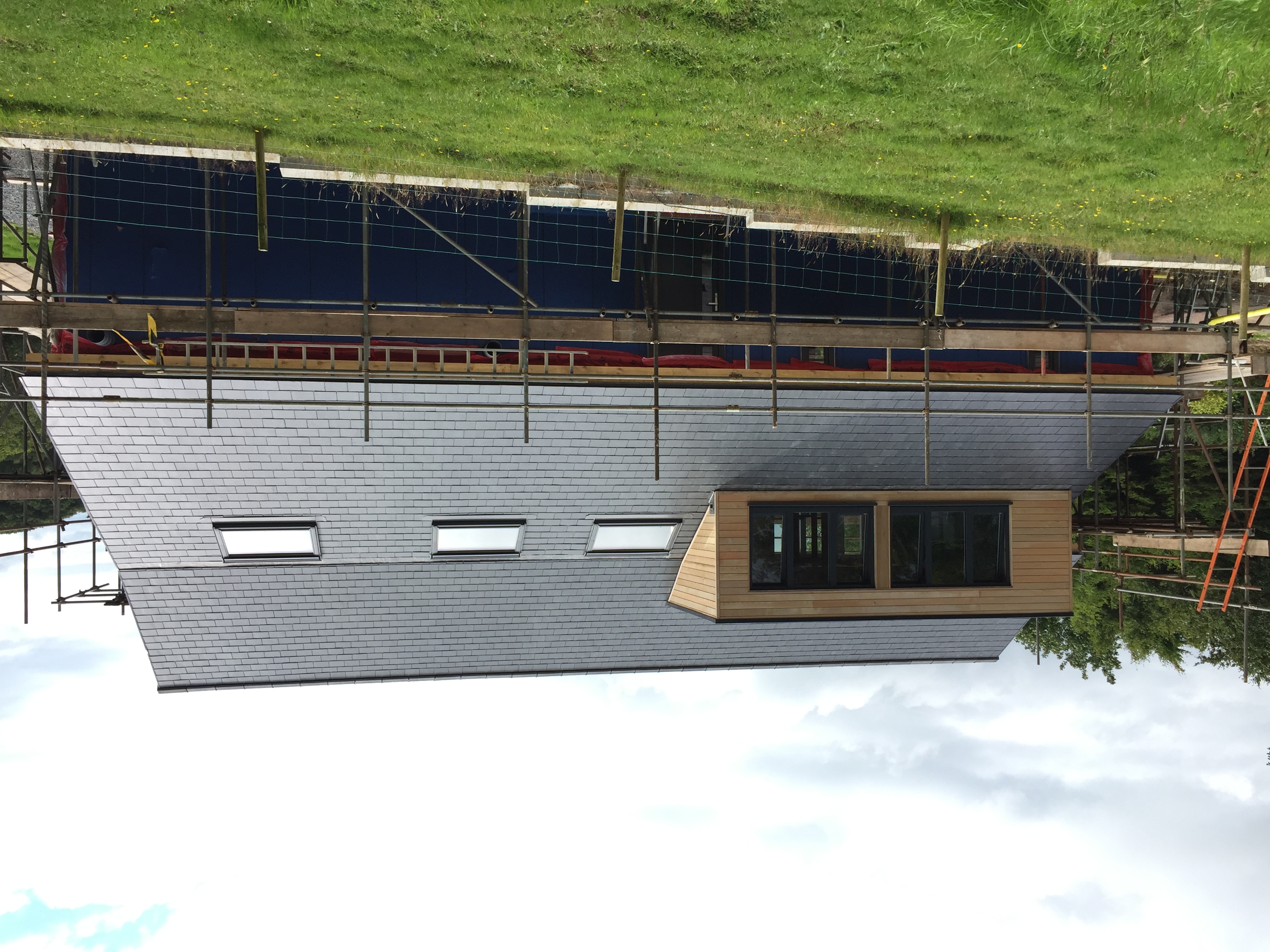

Barney12 Posted August 9, 2017 Author Posted August 9, 2017 (edited) The roof is finished! Hurrah!! I'm not doing that again. FAR to much like hard work. Actually there is still the porch to slate once it's built but I think I can cope with a couple of m2! Edited August 9, 2017 by Barney12 5
Construction Channel Posted August 9, 2017 Posted August 9, 2017 2 minutes ago, Barney12 said: The roof is finished! Hurrah!! I'm not doing that again. FAR to much like hard work. Actually there is still the porch to slate once it's built but I think I can cope with a couple of m2! Very tidy, I bet you're glad that is over though. thats a monster of a roof
Barney12 Posted August 9, 2017 Author Posted August 9, 2017 Just now, Construction Channel said: Very tidy, I bet you're glad that is over though. thats a monster of a roof You are not wrong! Thankfully the front was much smaller. It's what they call a "cat slide" roof round these parts. It's very much part of the National Park vernacular (great word!) hence why we were forced to have one There is some logic to it. They are generally sited North so that the North elevation is protected from the elements, that area contains the 'service' rooms and have tiny windows, if any. 1

Moira Niedzwiecka Posted October 13, 2017 Posted October 13, 2017 Your roof looks fantastic. Can I ask how much the materials cost? We have a roof that incorporates an in roof PV array & also triple glazed velux. It has one very large dormer. The are to slate is about 122 sq mts. The vertical battens are on. We have been quoted nearly £15,000 using a decent quality natural Spanish slate at £1.19 per slate. It seems a lot to me but I don't really have anything to compare it to. Moira
Barney12 Posted October 13, 2017 Author Posted October 13, 2017 5 hours ago, Moira Niedzwiecka said: Your roof looks fantastic. Can I ask how much the materials cost? We have a roof that incorporates an in roof PV array & also triple glazed velux. It has one very large dormer. The are to slate is about 122 sq mts. The vertical battens are on. We have been quoted nearly £15,000 using a decent quality natural Spanish slate at £1.19 per slate. It seems a lot to me but I don't really have anything to compare it to. Moira That slate price isn't too bad. We got our Armada Premium Spanish down to about £1.10 a slate but its all the extra's that add up. We spent nearly £1000 on lead alone. That North section in the pics is approx 135m2. The South is smaller. Hard to expain in an email but the North goes from two story to single story, which locally is refered to as a 'cat slide roof'. IIRC the best price we had for the entire roof (approx 255m2) was around £12k but that was a cheap Chinese slate that would have never been accepted by the National Park. My gut feeling is your quote feels a little high and I'd certainly try and get a couple of other quotes. Having said that I'm not sure I'd attempt DIY again, it's a real slog!
