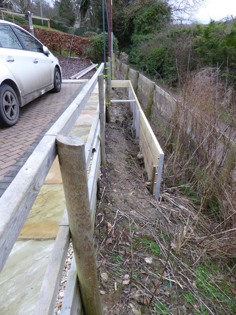

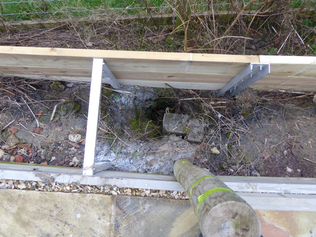

Jeremy Harris Posted February 8, 2018 Author Posted February 8, 2018 Right, I've been clambering around on what's turned into a very slippery clay bank, building a large'ish planter to raise the level and allow me to put in some better soil in which to plant the trees. Roughly in the centre of this there is a deep hole that used to hold a power pole, which I'm going to fill with rubble in the hope that it will provide a natural soakway to make sure that water doesn't collect in this thing (the gault clay underneath is virtually completely water impermeable). There are also some old railway sleepers that were driven down vertically, presumably to help support the power pole, and I'm just going to leave them, as they are around 600mm below where the soil surface will be: I could do with a bit more advice though. This is what I've built so far, using 8 x 2 treated C24 timbers, bolted with M10 bolts to some metal beams driven around 1m down into the ground. I've also driven metal beams into the top, again going down about 1m, to help stabilise the bank and also hold the thing in place. These are left over bits of aircraft alloy, a bit stronger than mild steel, and very corrosion resistant (it's the same stuff they may aluminium boats from). In this application it should be fine, as although it's more flexible than steel (much lower Young's Modulus) I'm using it mainly to take shear or tensile loads, so bending isn't an issue. This is what the part built thing looks like, I've yet to fit the ends properly and the other cross ties that hold the top in (not that it seems to need it; it's pretty solid as it is - it doesn't lean and isn't bent, that's just the camera distortion): The question is, should I line the inside of the timber with some heavy duty membrane or not? I have some DPM lying around, and could easily line the inside with this, folded over and stapled just below the soil line at the top, with a drainage gap at the bottom (I can fold the DPM under the boards at the bottom). My thinking is that a lining like this will help to keep the timber dry, but I'm also a bit concerned that it might make things worse, but allowing damp to be trapped between the membrane and the timber. Any thoughts?
Construction Channel Posted February 8, 2018 Posted February 8, 2018 I would line it. It’ll help keep the bugs away from the timber as well. 1
Jeremy Harris Posted February 8, 2018 Author Posted February 8, 2018 Thanks, I'd not thought about bugs, but there are probably bugs in soil that eat timber, given half a chance.
PeterW Posted February 8, 2018 Posted February 8, 2018 If you do DPM line it then it means you can treat the timber with a preservative without any fear of the trees being affected. 600mm DPM is ideal for this job.
Oz07 Posted February 8, 2018 Posted February 8, 2018 Me and a cousin built some raised beds for our grandad. I'd never heard of dpm lining till we did it for him. I can't see it being that effective. Surely the timber is still damp regardless?! The bugs is a good point but in reality how long are we expecting these structures to last and how many extra days/weeks/months/years will a bit of dpm make?! The treatment angle is another good point. Just begrudgingly do it like I did and atleast you can say I told you so in 20 years!
Cpd Posted February 8, 2018 Posted February 8, 2018 I think lining it will be a good idea, i would think the wood will last longer as it will have more chance to dry out. I got a whole load of c24 8x2 for free as it had fallen of the back of the stack and had been on the wet ground under an overgrown hedge, its still usable for garden work but i was shocked at how quickly some had deteriorated... i guess its just not designed to be left under a wet hedge ! So any level if protection would be a good idea. You could fold the dpm over the top and put a length of sarking on top to protect it from the elements and uv, that way your not going to get soil between the plastic and the wood and this will help to prolong its life, did this on a sheds turf roof and it worked really well.
Onoff Posted February 8, 2018 Posted February 8, 2018 Line it I would. I've seen people use slaters felt before on the basis it's quite oily.
Hecateh Posted February 8, 2018 Posted February 8, 2018 20 minutes ago, Cpd said: I think lining it will be a good idea, i would think the wood will last longer as it will have more chance to dry out. I got a whole load of c24 8x2 for free as it had fallen of the back of the stack ................................ a what? LOL that's a new one
Jeremy Harris Posted February 8, 2018 Author Posted February 8, 2018 Thanks everyone, looks like I will be lining it tomorrow! I also have some offcuts of the plastic slates we used on the roof, so I may see if I can fit a mini roof along the top, trapping the DPM. @Hecateh C24 is a timber strength and quality grade, important when using timber like this for rafters or joists. 8 x 2 = 8" x 2" = 220mm x 45mm regularised timber, again the standard size is important for things like rafters and joists, where you need consistent dimensions. The planter I've made uses this size and grade of timber.
Ferdinand Posted February 9, 2018 Posted February 9, 2018 (edited) I would line the retaining wood, but fold over the top to prevent moisture running down the back. I assume you will be stopping the lining a little above the bottom of the retaining planks. I have usually just used a staple gun to attach. On drainage, I would also line the gap at the base of the retaining planks with half bricks or gravel or similar .. like crocks at the bottom of a plant pot. Just to make sure that water has a rapid escape route ... depending slightly on the nature of the soil you use. With this type of structure eg for a raised patio I also sometimes knock round fence posts in on the outside say 100mm rounds and screw back through into the planks using timbascrews of 125mm. THat would tie in the design as rustic like your fence, and also gives the opportunity for a parapet should one be needed by using longer posts. I do that to prevent bulging should the soil become heavy with water. If such posts rot after say a decade it is a work of minutes to add a couple of new ones, and cut the old ones off at the base, removing the screws. Your cross braces may be adequate however. Do you plan to colour the planters to match the house? Ferdinand Edited February 9, 2018 by Ferdinand
