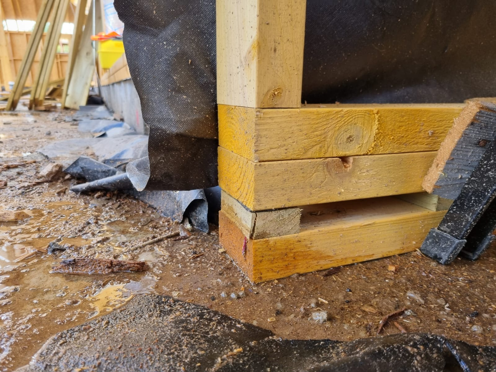

saveasteading Posted August 11, 2022 Share Posted August 11, 2022 Doing it again I would write the floor construction tolerances on the drawings. NHBC seems to only refer to the final floor level, and not to the subfloor. Obv there are some expectations or it could be +/- 100mm. I come from doing commercial projects and can't believe how poor house building is allowed to be. Then this amount of packing would not be even argued about......'nobody cares about the subfloor level...it doesn't matter' The slab is not thin here, as there is a footing under it. That gap will be filled. Haven't decided whether folding wedges or drypack...or both. Link to comment Share on other sites More sharing options...
