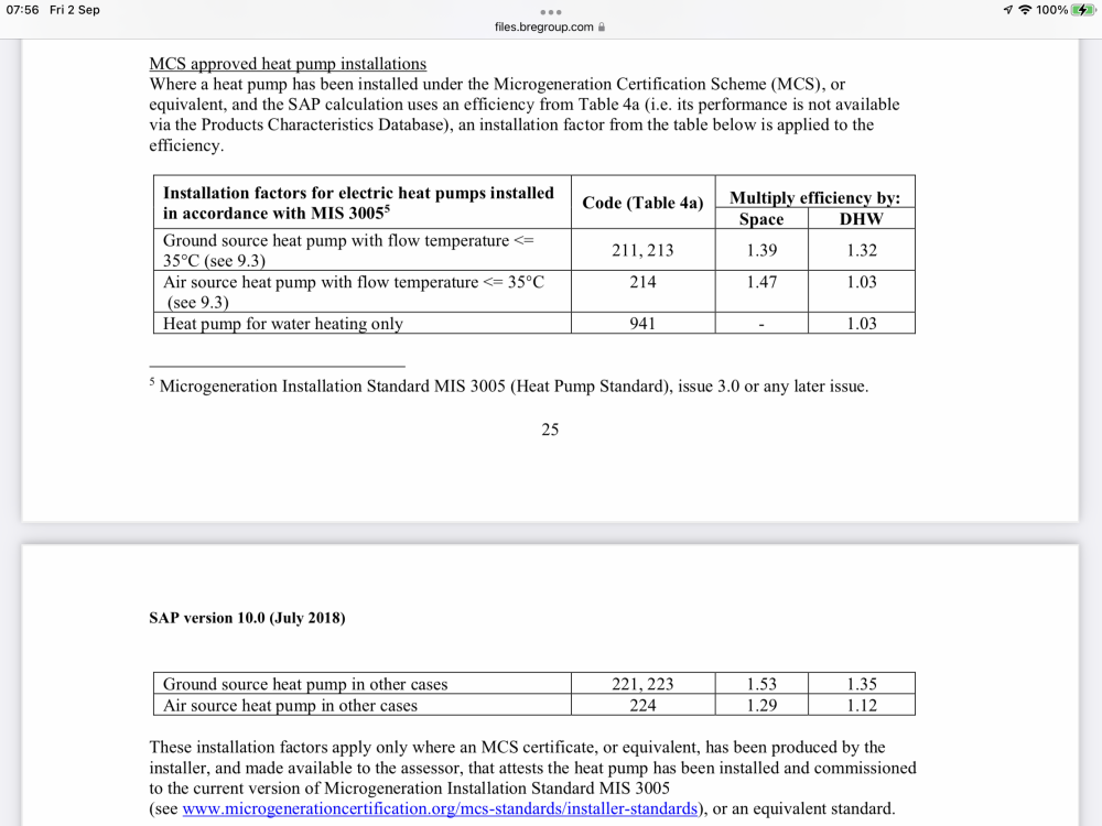

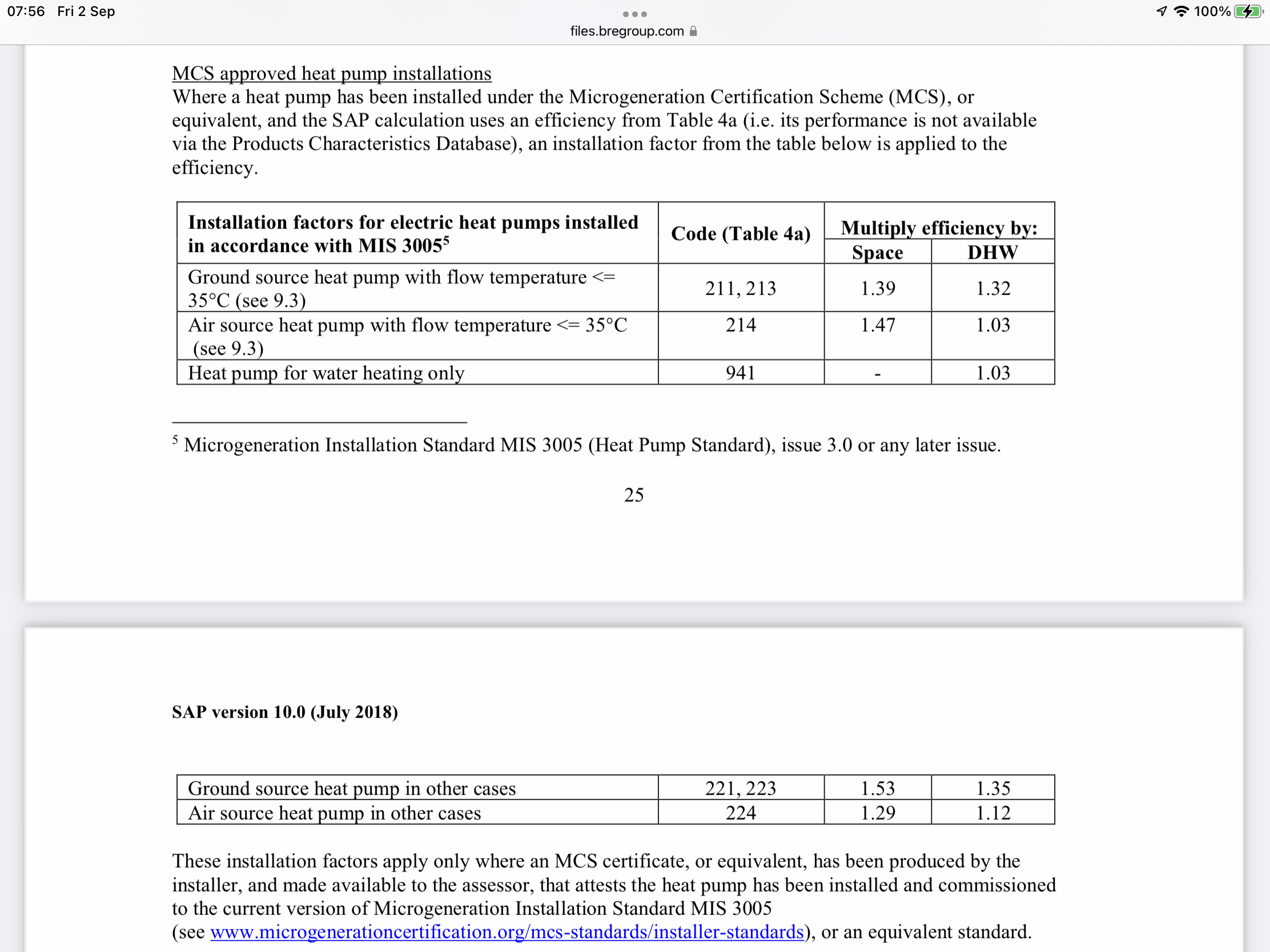

Dreadnaught Posted September 1, 2022 Share Posted September 1, 2022 Don't count on spending that £5k from the BUS. An ASHP install that would cost £6,000 will magically cost £11,000 under the bus ("there is so much paperwork don't you know"). I am buying the ASHP myself and will use a local air-conditioning engineer to install, 1- or 2-days work max. No BUS for me. 1 Link to comment Share on other sites More sharing options...
Nick Laslett Posted September 2, 2022 Share Posted September 2, 2022 (edited) 11 hours ago, Dreadnaught said: Don't count on spending that £5k from the BUS. An ASHP install that would cost £6,000 will magically cost £11,000 under the bus ("there is so much paperwork don't you know"). I am buying the ASHP myself and will use a local air-conditioning engineer to install, 1- or 2-days work max. No BUS for me. Will the engineer sign-off on MCS for the ASHP install? I don’t know if it is of any significance, but the SAP calculation for an ASHP is different if it is not an MCS compliant install. I can’t remember how many points it knocks off. *(Edit) If the characteristics of an ASHP are in the SAP product database, these efficiency values will be used. https://www.ncm-pcdb.org.uk/sap/searchpod.jsp?id=17 Edited September 2, 2022 by Nick Laslett 1 Link to comment Share on other sites More sharing options...
ProDave Posted September 2, 2022 Share Posted September 2, 2022 15 minutes ago, Nick Laslett said: Looks like they are still trying to find ways to claim the very much more expensive MCS install is "better" Link to comment Share on other sites More sharing options...
Dreadnaught Posted September 2, 2022 Share Posted September 2, 2022 Thanks Nick. 27 minutes ago, Nick Laslett said: Will the engineer sign-off on MCS for the ASHP install? No. I won't be asking for this. I wonder if the Arotherm Plus ASHP will be available in the "Products Characteristics Database" for SAP. Does anybody know? I've emailed my SAP assessor to ask. 32 minutes ago, Nick Laslett said: If the characteristics of an ASHP are in the SAP product database, these efficiency values will be used. Did you mean "aren't" rather rather than "are"? Link to comment Share on other sites More sharing options...
Dreadnaught Posted September 2, 2022 Share Posted September 2, 2022 (edited) @Nick Laslett, I just heard back from my SAP assessor. He said "Yes, the arotherm products are on the PCDB so we will use this data within the assessment". Edit to add: when I also asked whether MCS certification (or its absence) will affect the SAP result in any way, he said: "We do get an option to tick "MCS certified" but it does not affect the results in any way." So I think I am doubly content with that. Edited September 2, 2022 by Dreadnaught Link to comment Share on other sites More sharing options...
PhilT Posted September 2, 2022 Share Posted September 2, 2022 18 hours ago, ProDave said: I still struggle to see where these costs come from? ASHP easily bought for £5K, it took me 2 days to wire one and the plumber about 2 days to plumb it a few weeks back. I really wish between us we could have been paid £6K to install it. Appreciate the possibilities if you are able to do/manage everything yourself. Although my house is a self build I'm now too old unfortunately so this is a 3rd party commercial installation of ASHP, new HP compatible DHW tank, header tanks, six new radiators, all plumbing, controls and electricals and took 2 guys a whole week to install. £15k gross less £9k RHI grant. Link to comment Share on other sites More sharing options...
Nick Laslett Posted September 2, 2022 Share Posted September 2, 2022 6 hours ago, Dreadnaught said: @Nick Laslett, I just heard back from my SAP assessor. He said "Yes, the arotherm products are on the PCDB so we will use this data within the assessment". Edit to add: when I also asked whether MCS certification (or its absence) will affect the SAP result in any way, he said: "We do get an option to tick "MCS certified" but it does not affect the results in any way." So I think I am doubly content with that. Your assessor is correct. I just checked with the Stroma SAP software. If you use the PCDB entry the SAP result is not effected by the MCS tick box. If you use the default SAP values for a generic ASHP, then the MSC tick box does improve the values. Back when I originally played about with the software, I just used the generic ASHP entry, this is because the software lists the PCDB category as "boiler", which confused me at the time. 1 Link to comment Share on other sites More sharing options...

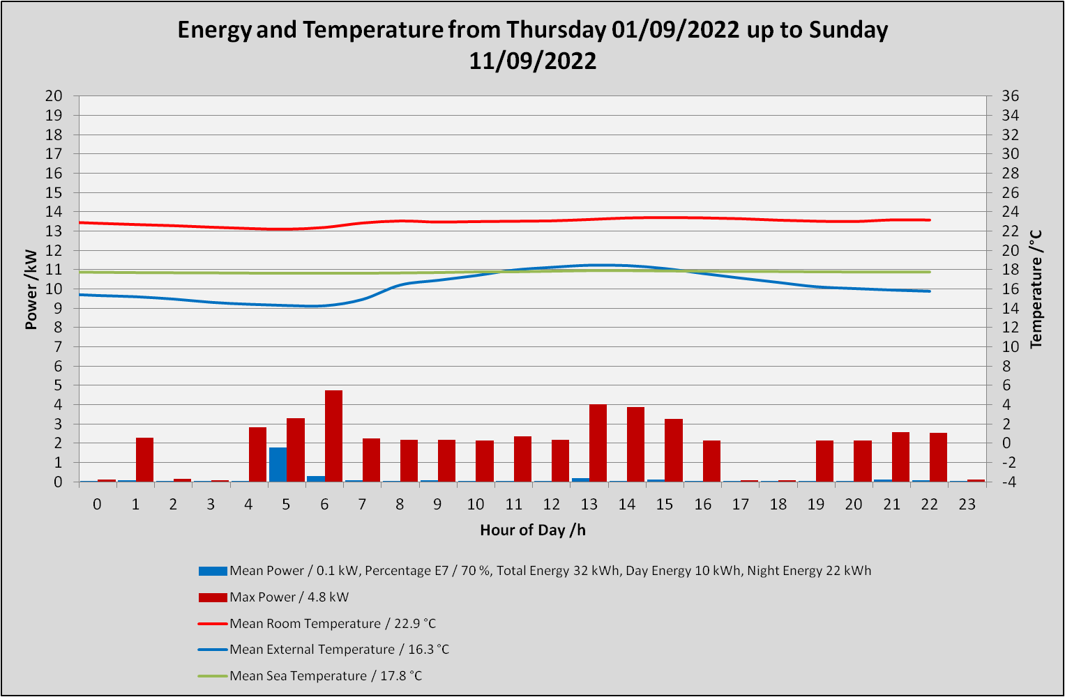

Cleighton Posted September 12, 2022 Share Posted September 12, 2022 I looked into this myself 4 years ago trying to future proof my self build. Having spoken to countless people at self build shows I ended up with gas. I have installed a baxi eco blu 30kw heat only boiler, 300l unvented cylinder, 4.8kw solar edge PV with optimizers, Beam MVHR and a solic 200. I over sized the radiators in case i changed to ASHP in the future, however, the heating upstairs is not used its just to warm. Wet underfloor downstairs is rarely used, I also bought a Scan 58-6 log burner which is an expensive ornament at the moment, it has not been fitted with a flue and I will probably sell it as it is not needed. As some have mentioned solar gain is often missed and underestimated, I will probably fit a canopy blind or air con. My kitchen diner has 2- 3m sets of bifolds and a further 2- 1m floor to ceiling glass panels! This is my first self build and was a huge learning curve, would I change anything? Probably more PV and batteries which I am considering. Solic 200 is worth its weight in genuine gold, it supplies nearly all my hot water for 2/3 of the year, Boiler comes on for 45 minutes in the morning, only because my wife likes a scolding shower before work !!!! and that's only when she is working early. MVHR is probably the best investment with the insulation in my circumstances. 4 years on, I am doing the same for my daughter, who is building next to me. In the current fuel climate, I still cannot justify the cost of an ASHP if the investment is put into the fibre first. At the time of writing, these are the temperatures in the house. I am still new to self building, but have been in the trade for years and these are just my personal experiences and opinions. Link to comment Share on other sites More sharing options...
SteamyTea Posted September 13, 2022 Share Posted September 13, 2022 Similar to mine. This is for all of September so far. 1 Link to comment Share on other sites More sharing options...
