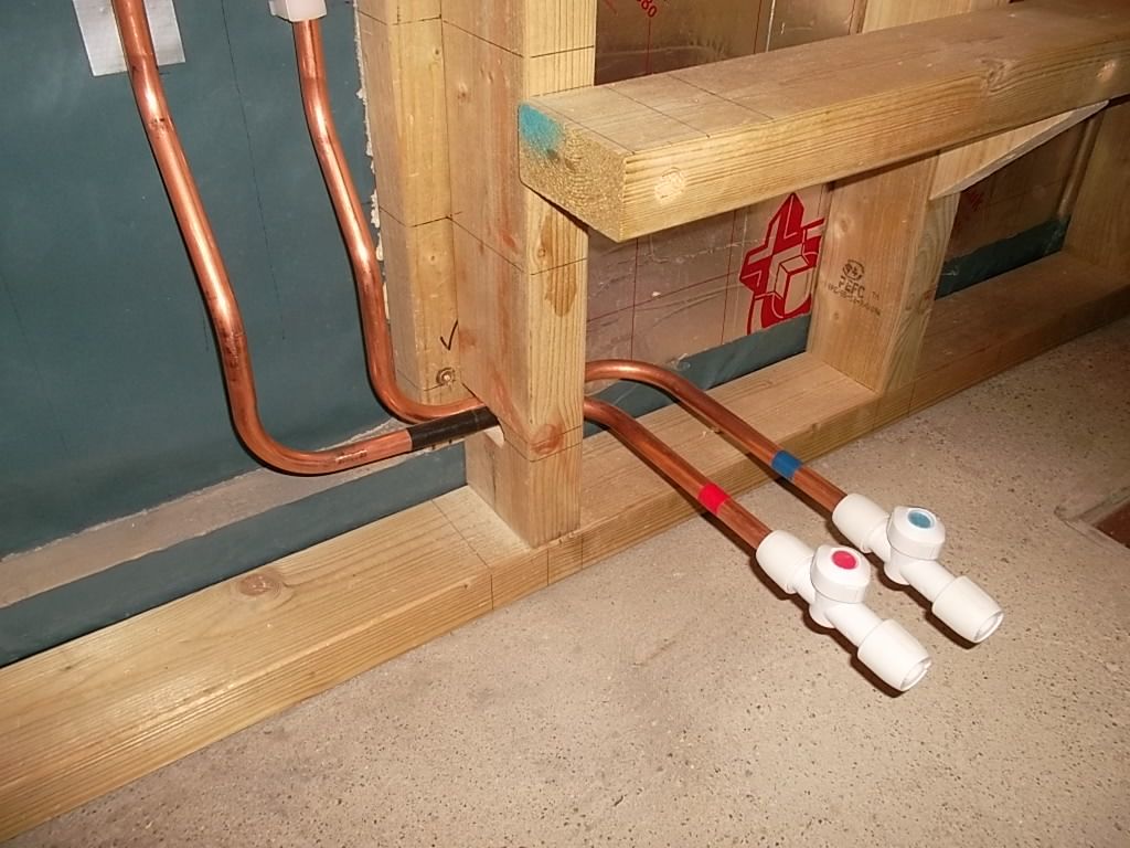

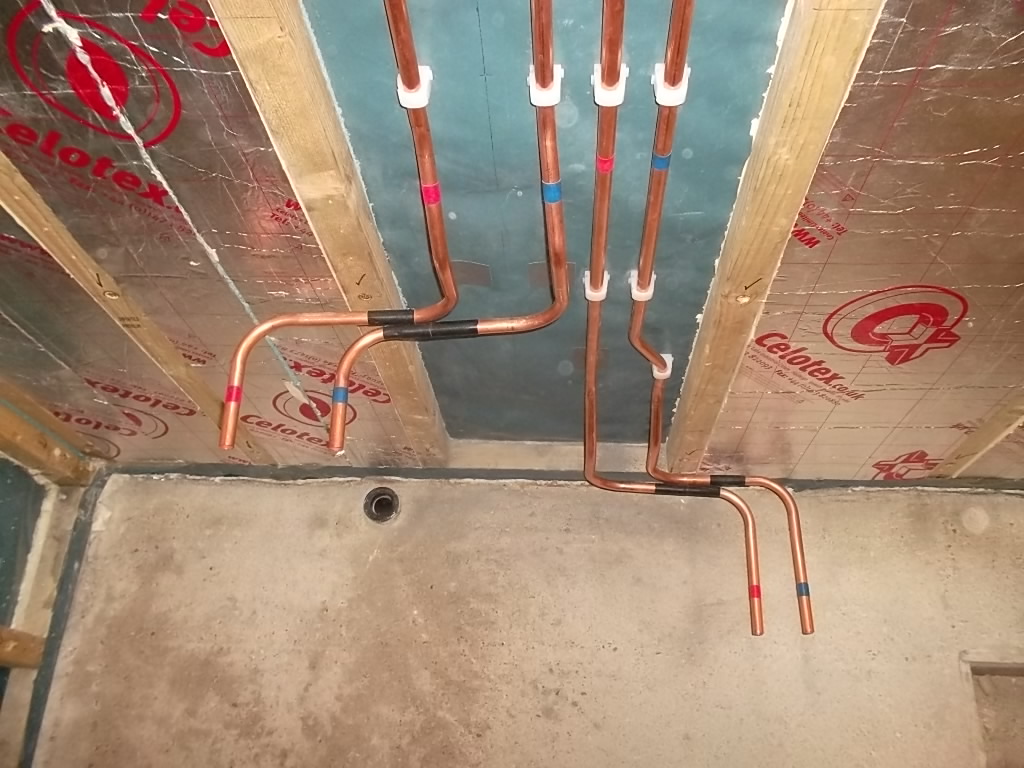

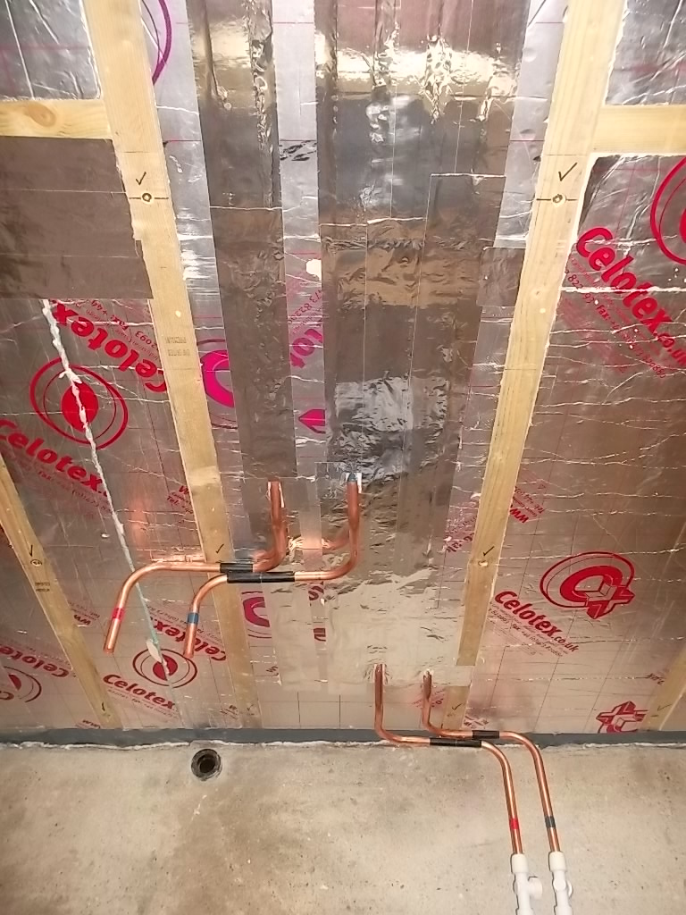

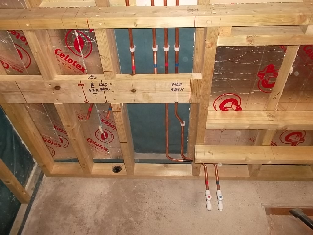

Nickfromwales Posted August 14, 2016 Share Posted August 14, 2016 Your getting good at this now . DONT use Denzo tape!! It's not allowed for use on potable water any more Where the two pipes are touching, just use insulation / gaffa tape to physically separate them, and there won't be any issues with them then IMO. If you don't want a joint, drop a separate pipe for the bath hot and tee it in above where you have access to the joint maybe? Also did you say the upstairs basin cold is off the CWS? I'd want that off fresh cold myself, but you may have to change the tap to acheive it ( if it's a mixer / mono block ) as the hot won't have much gravity ( pressure ) at that location to fight off cold mains. Apart from those niggles it's going good guns, and one less tiled access panel to do . Link to comment Share on other sites More sharing options...
Onoff Posted August 14, 2016 Author Share Posted August 14, 2016 I was considering to drop a separate hot for the bath tbh. It means drilling another hole. The main thing for me and it might seem a bit (a lot?) anal is that it upsets the symmetry of the pipework. At the mo there's 3 equi-spaced pipes and a fourth would throw it all out and make it look ill considered. That's how I think, I get stuck in a loop etc. Sad I know! I'll have to get over it! I've just been in to stare at it all again and decided it's not the biggest issue! The alternative being to redo it all and I think I've peaked on that front. Saying that I am getting to enjoy the bending. Yep the upstairs bathroom sink is fed off the cws tank. This is a tiny 25 gallon one that sits above the upstairs ceiling. The hot is from a copper hot water cylinder above the downstairs ceiling. Think I mentioned back on eBuild that since fitting the tap style below, upstairs we periodically have the cold from the cws get slower and slower till it stops. I then have to bleed the cws run from that 22 mm grey Hep2O stop end you can see in the loft pics above. It's only been an issue since fitting this type of tap. Plan is to change over to mains cold. Link to comment Share on other sites More sharing options...
Nickfromwales Posted August 14, 2016 Share Posted August 14, 2016 Aye, there's not enough flow / velocity to keep water from air locking in the pipe run. Those small waterways through modern monoblock taps don't bode well for mixed / gravity supplies. Link to comment Share on other sites More sharing options...

Onoff Posted August 14, 2016 Author Share Posted August 14, 2016 (edited) That's it, it's staying like this. Duct tape around the pipes, old screw holes taped over. Now got to fit the PIR around these pipes. Was thinking to maybe "V" the PIR so it comes in from each side then foam fill the gap? sans the dwarf wall: dwarf wall in place: Valves just sitting on there for effect, might crank these ends down a few degrees with the spring: Edited August 14, 2016 by Onoff Link to comment Share on other sites More sharing options...

Onoff Posted August 15, 2016 Author Share Posted August 15, 2016 Needed to reinstate the 50mm PIR on the cavity wall where the pipes are. Figured as above to V the PIR which I did on the table saw after marking with a bevel gauge to clear the 15mm copper. Just got to infill it now: The V meets at the back. Can't decide whether to just gun foam the Vs and trim off later or stick back in the removed sections (trimmed for depth)with low expansion foam, At least then the Celotex writing would be back in place! Can't see that "burying" these pipes is an issue on the basis there are no joints in them whatsoever just offsets and bends. 1 Link to comment Share on other sites More sharing options...

Onoff Posted August 17, 2016 Author Share Posted August 17, 2016 Thank God for silver tape! Presumably then (and I have) it's a GOOD idea to keep aluminium foil tape from touching copper pipes because of potential electrolytic reaction? Link to comment Share on other sites More sharing options...
Nickfromwales Posted August 18, 2016 Share Posted August 18, 2016 I just whip the pipes with a few layers of insulation tape for physical separation as it's easier than gaffa tape on the bends. Gaffa tape on the long straight runs is easier if you have both available. Looks neat and tidy, stand down red alert. Link to comment Share on other sites More sharing options...

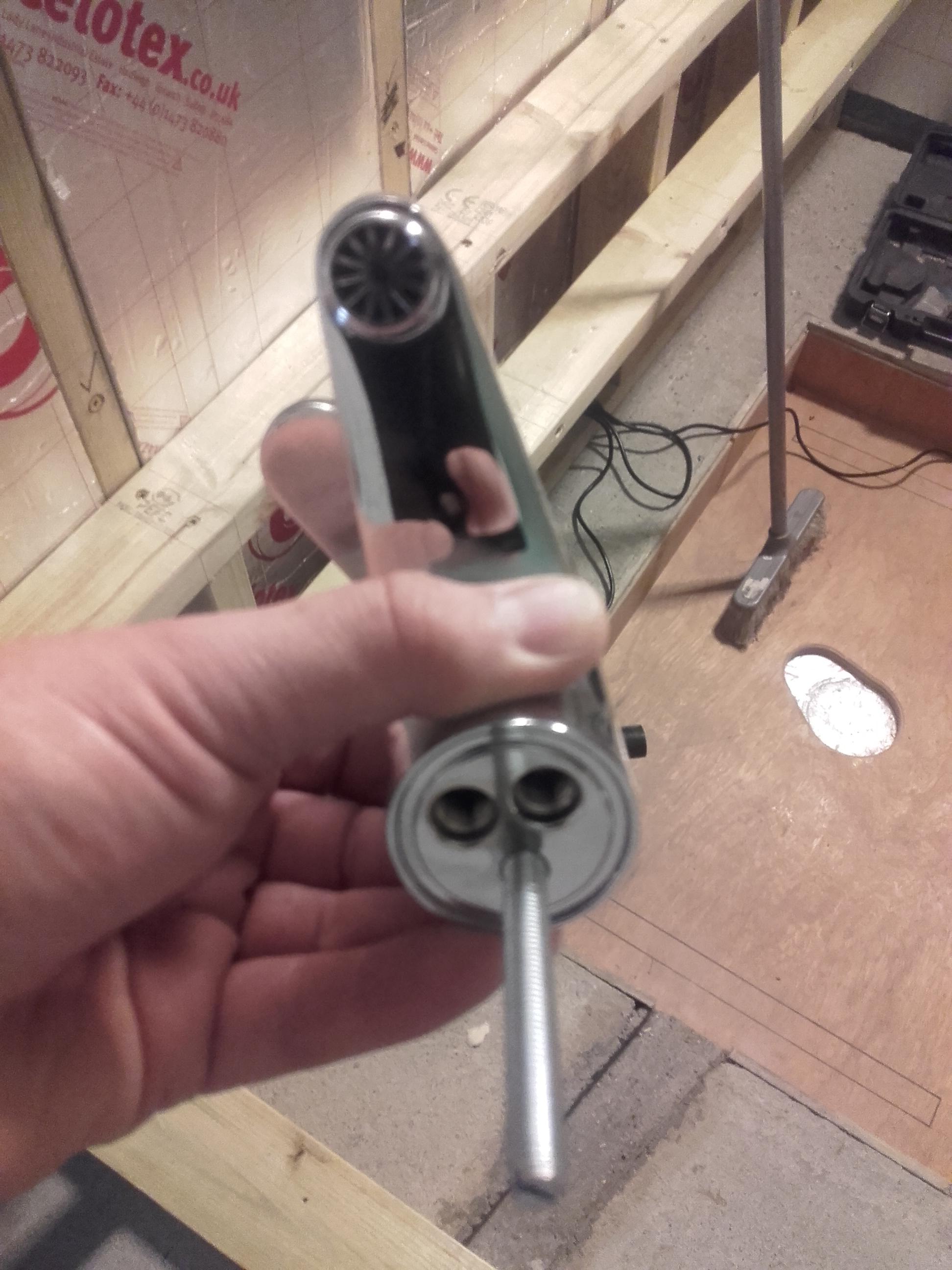

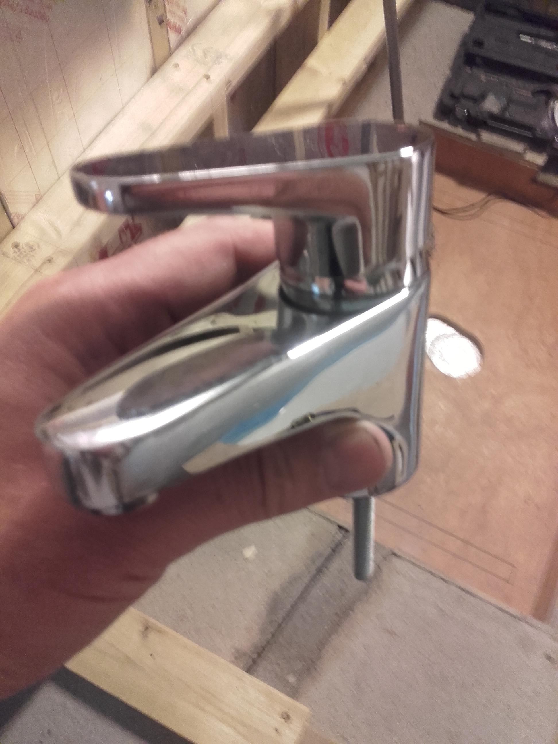

Onoff Posted August 22, 2016 Author Share Posted August 22, 2016 (edited) Nick, you bought this bath filler I believe: http://m.ebay.co.uk/itm/BATHROOM-ROUND-OVERFLOW-FILLER-WITH-CLICKERPLUG-WASTE-CHROME-BATH-EXOFILL-/161023564006?nav=SEARCH What "taps" did you fit? Guessing maybe it's fed from a combined shower valve? Looks to only have one inlet in the picture..... Ta Edited August 22, 2016 by Onoff Link to comment Share on other sites More sharing options...
Nickfromwales Posted August 22, 2016 Share Posted August 22, 2016 I've got a 3-way diverter sunk into the wall. Pics later. For your application you just tee the hot and cold outputs from each tap together and send the unified feed to the filler . Link to comment Share on other sites More sharing options...

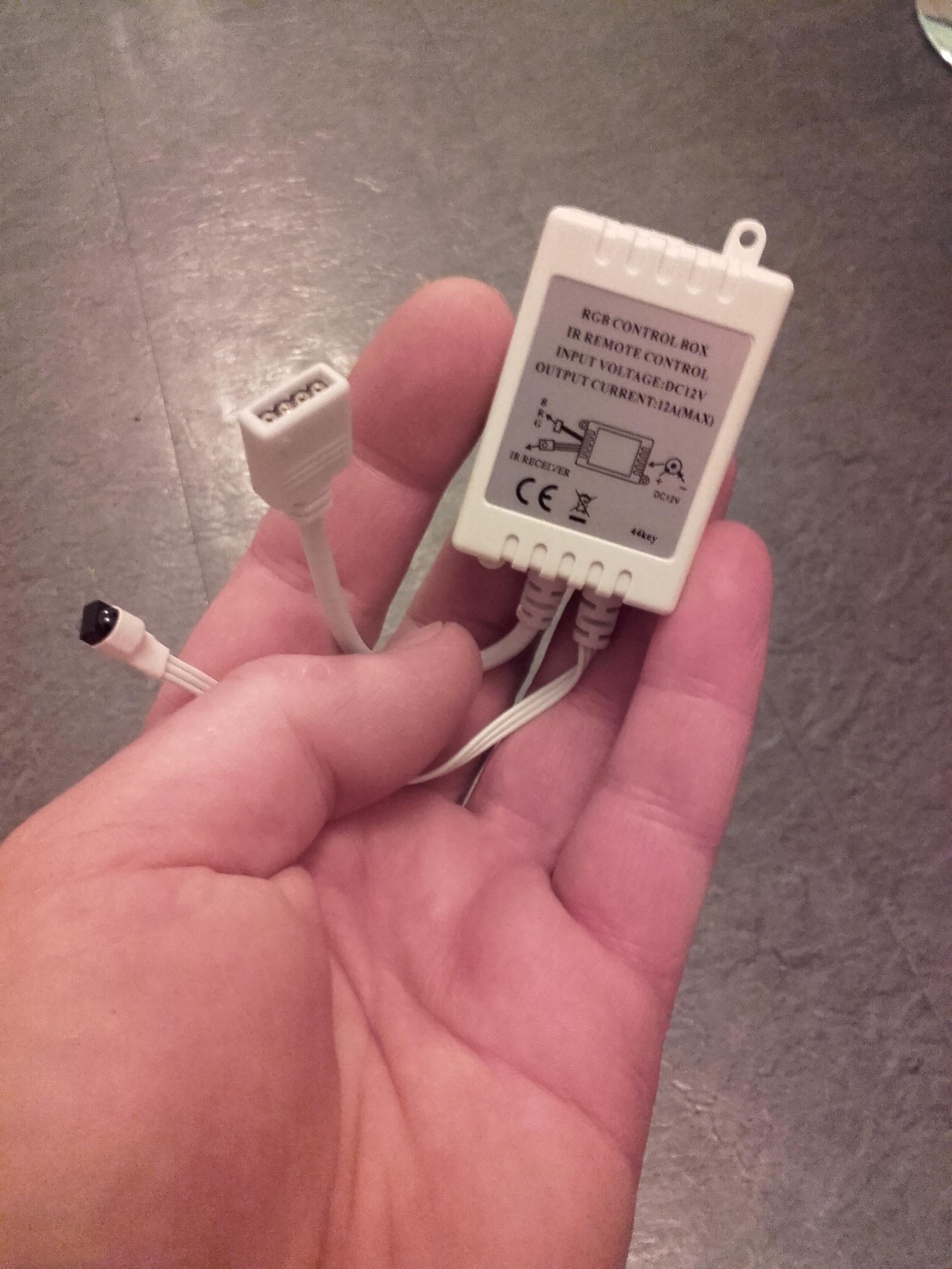

Onoff Posted August 22, 2016 Author Share Posted August 22, 2016 Ergonomics.....the way it's looking you'll lie in the bath with your head in the corner of the room and feet the basin end which feeld "right". Taps on your left. The bath controls; jets and lights will be on your right by your feet so you'll have to sort of sit up & forward to reach them. If the bath was spun thru 180deg the taps would be on your right, the jet/light controls over your left shoulder. Got to hide the LED gel strip box too somewhere yet have it easily acessible / replaceable: Link to comment Share on other sites More sharing options...
