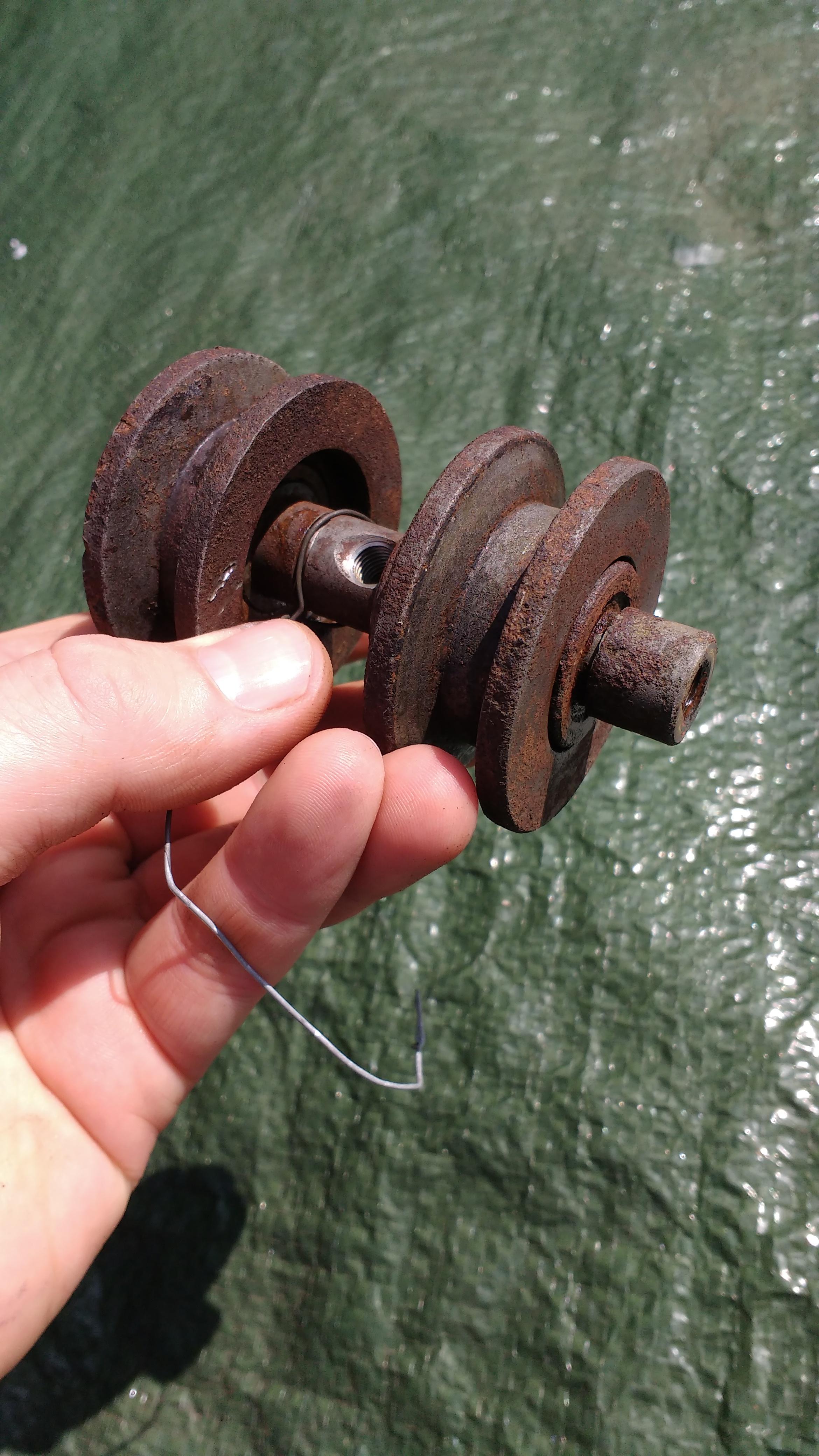

Jeremy Harris Posted August 20, 2019 Posted August 20, 2019 48 minutes ago, joe90 said: Timely reading!!!, I have just bought an old cylinder mower which has a fair amount of rust on various parts, I was going to wire brush with angle grinder then hammerite. Would I be better off using above acid stuff? Is there a particular way to get good results?. It's easier to just get the remaining paint off and then treat the rust, either by electrolysis or by using phosphoric acid. I've not used electrolysis, but used to use loads of phosphoric acid when I had a side line in repairing rusty Minis years ago. Phosphoric acid has the slight advantage that it provides reasonable protection against future rust formation, as the black iron phosphate coating it leaves behind is chemically bonded to the steel, so good in terms of acting as a first stage paint primer. For best results get the paint off, remove the loose stuff, get all traces of oil and grease off, then either brush on or immerse the part in phosphoric acid. 1

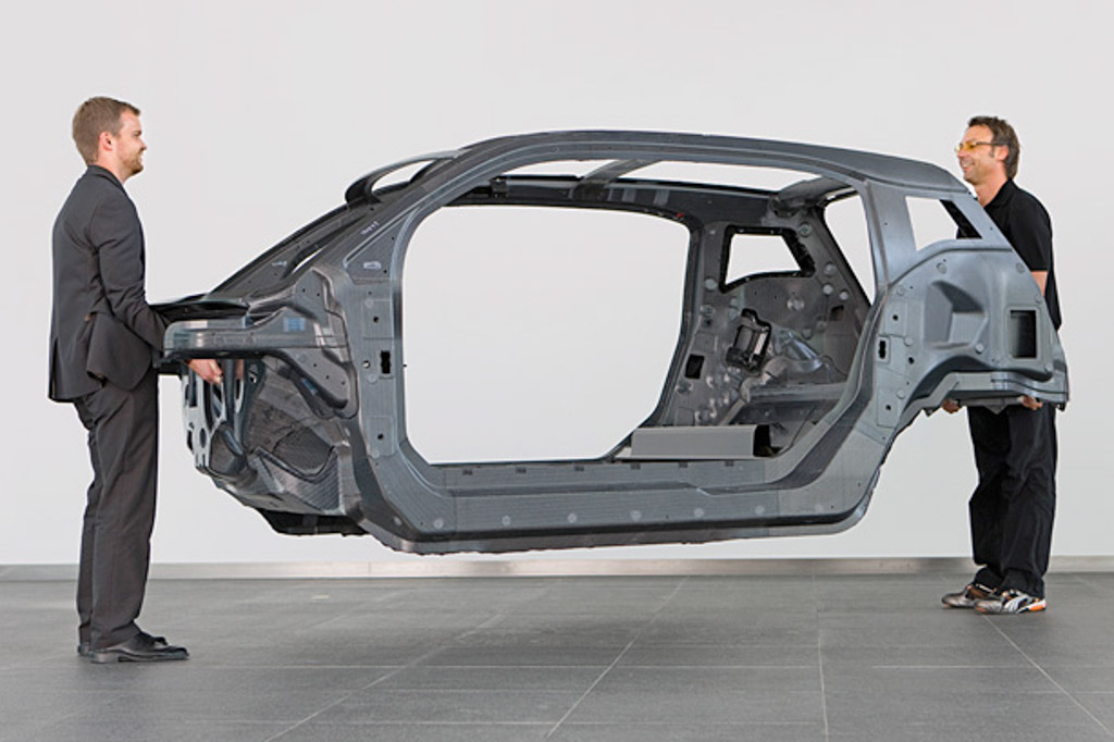

Jeremy Harris Posted August 20, 2019 Posted August 20, 2019 26 minutes ago, PeterStarck said: Presumably all car bodies are galvanised these days. Some (like mine) are all plastic. Even the "chassis" of my car is primarily carbon fibre, with an aluminium alloy subframe at either end, where the suspension bits bolt on.
Gone West Posted August 20, 2019 Posted August 20, 2019 5 minutes ago, JSHarris said: Some (like mine) are all plastic. Even the "chassis" of my car is primarily carbon fibre, with an aluminium alloy subframe at either end, where the suspension bits bolt on. Is that because your car is electric and it's for weight saving.
Jeremy Harris Posted August 20, 2019 Posted August 20, 2019 11 minutes ago, PeterStarck said: Is that because your car is electric and it's for weight saving. Partly, yes, and partly because I think BMW are using their electric car model range to explore new materials. Being electric removes some of the constraints in design, as the drive train is a lot more compact. This is what the "chassis" of my car looks like, with all the plastic panels removed: 1

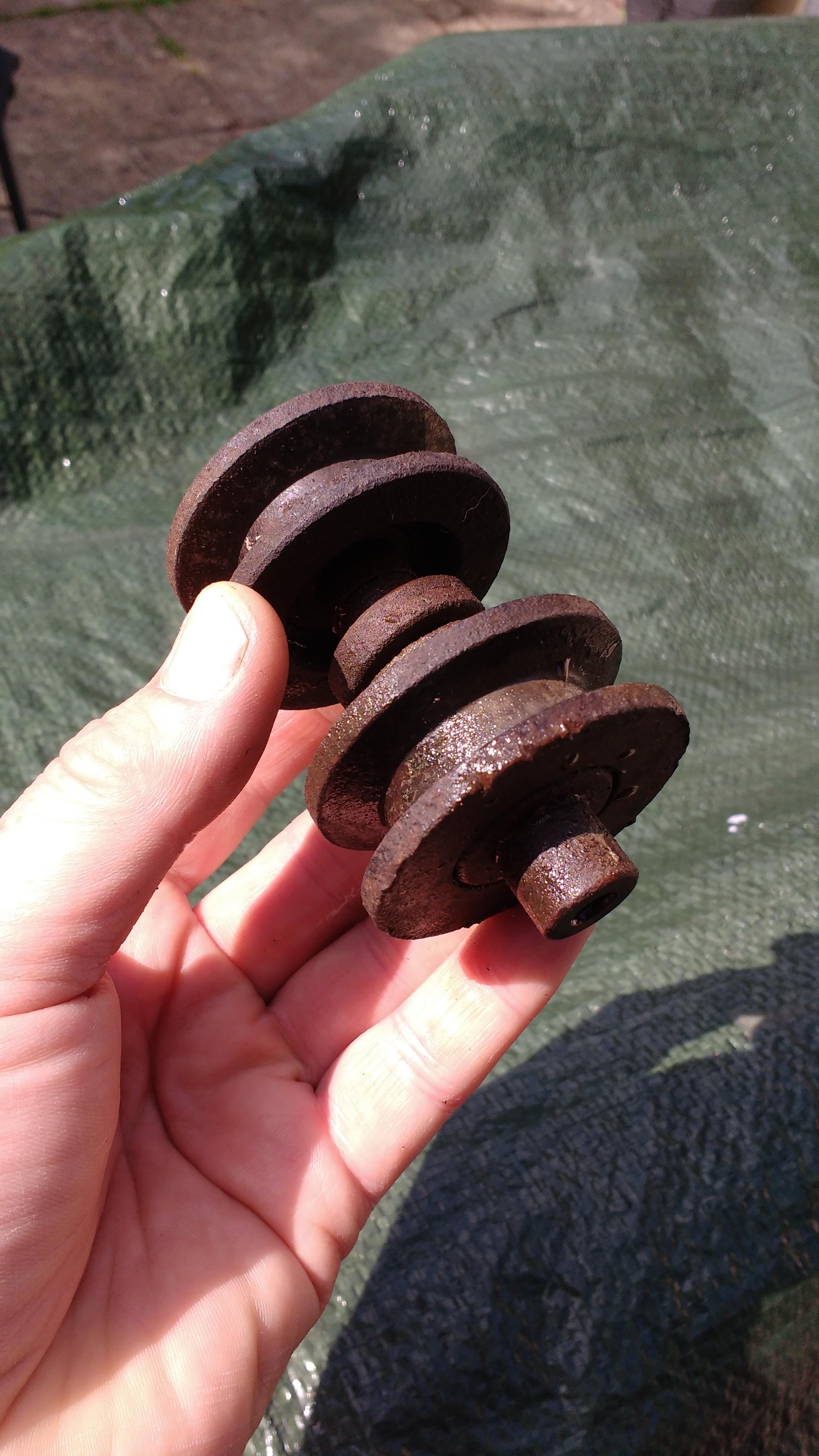

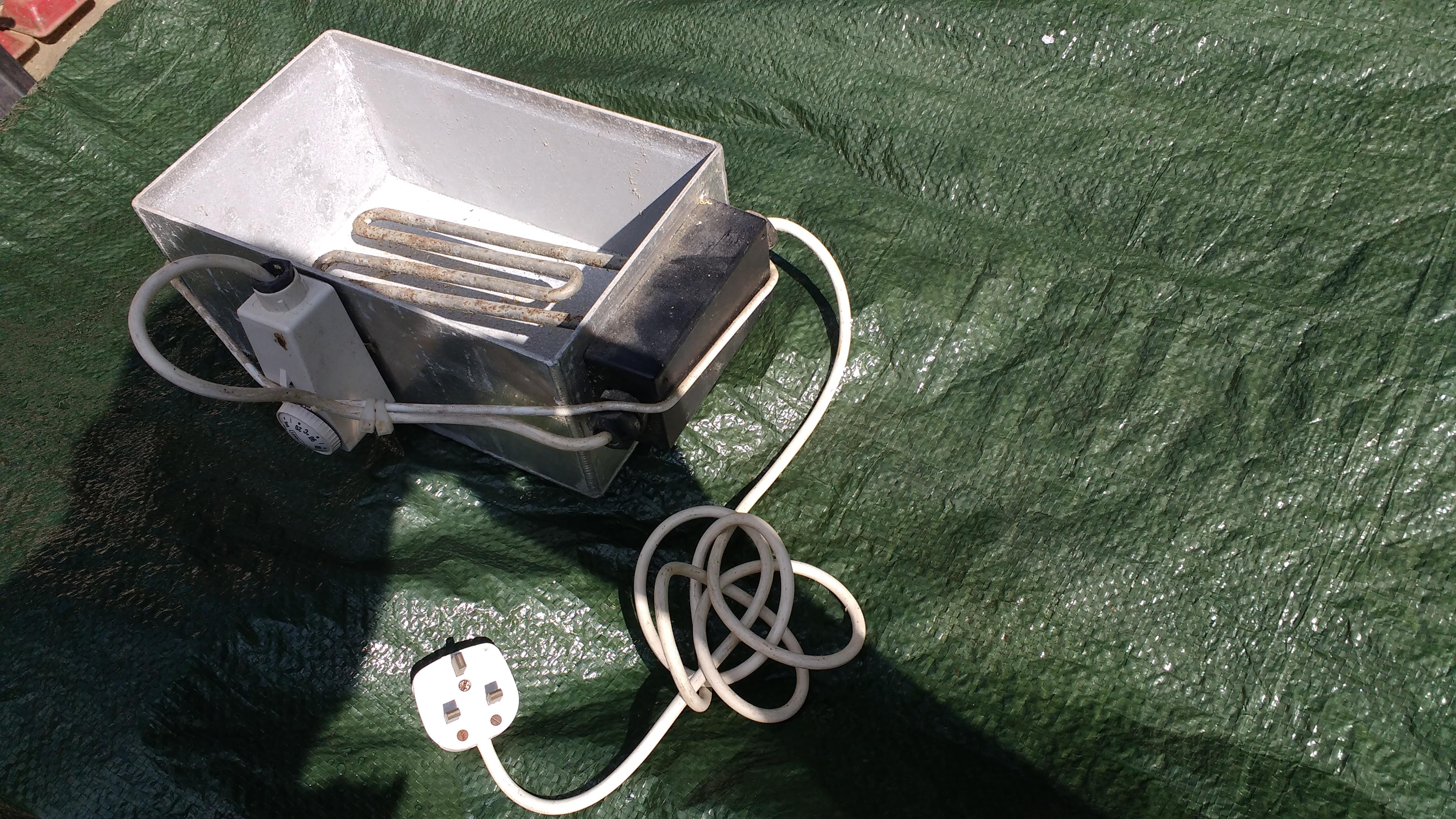

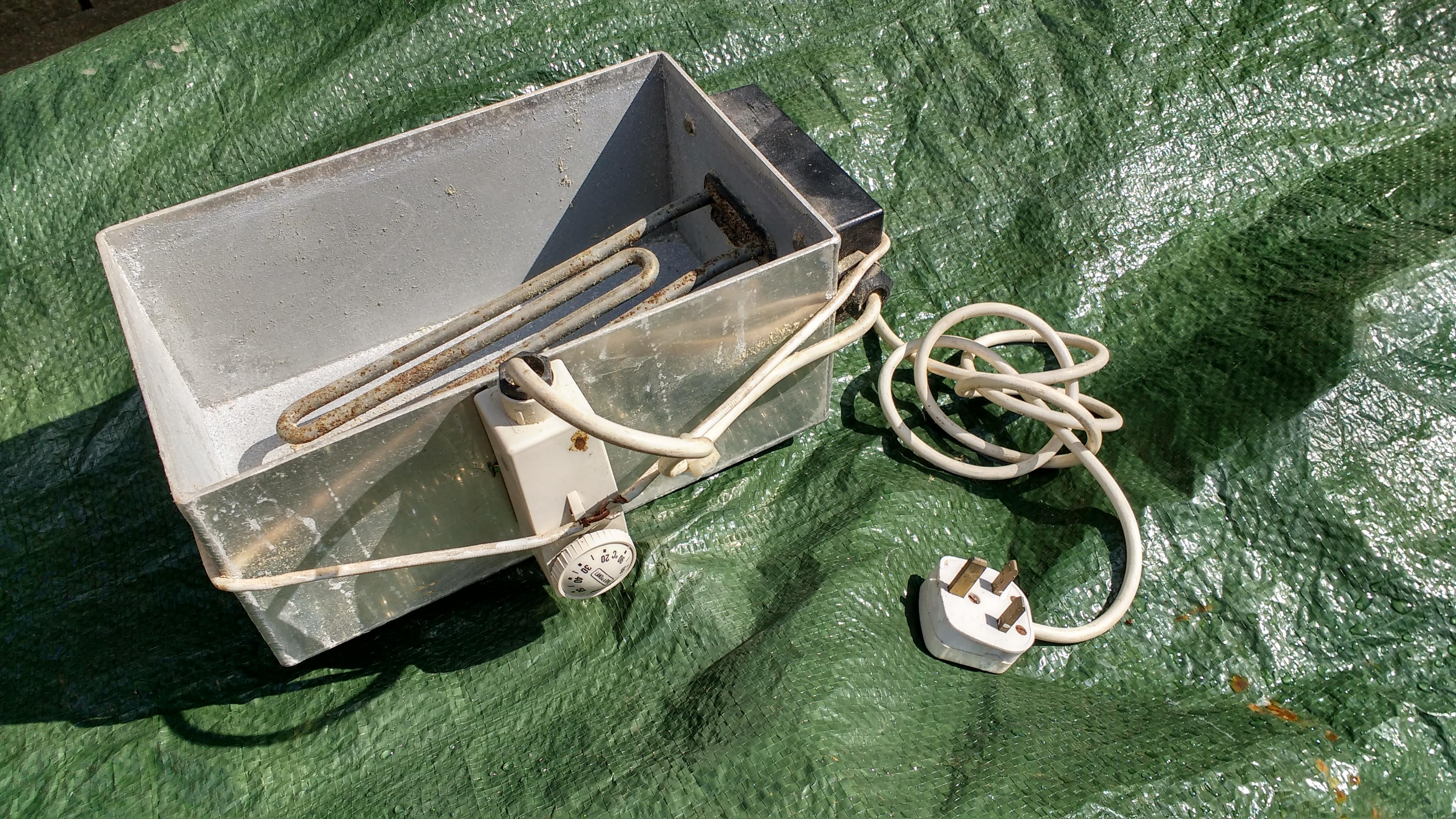

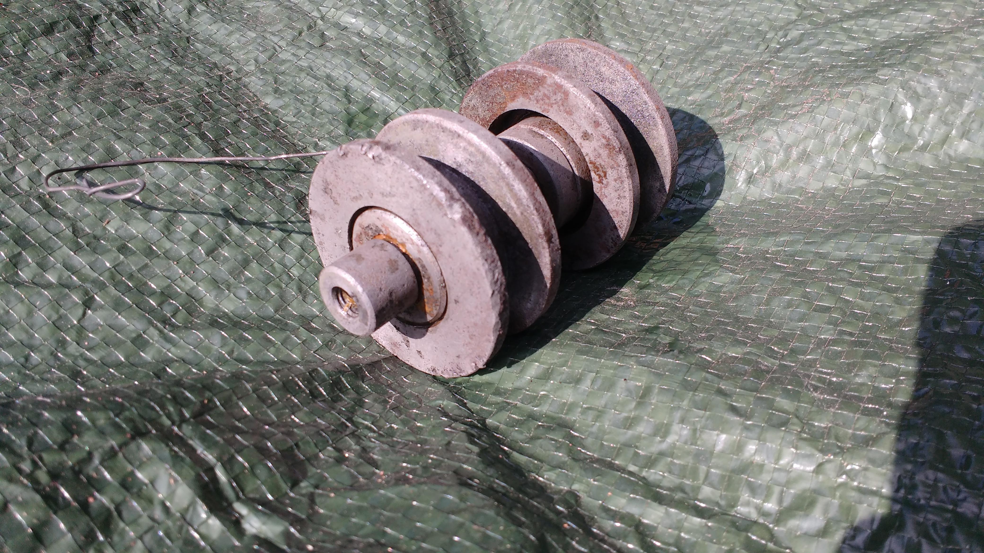

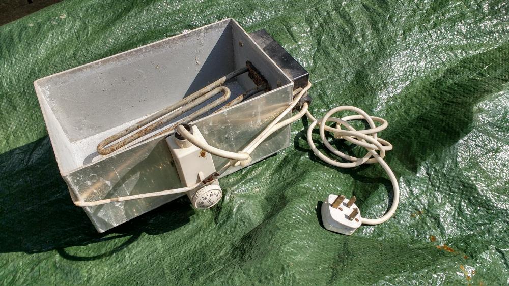

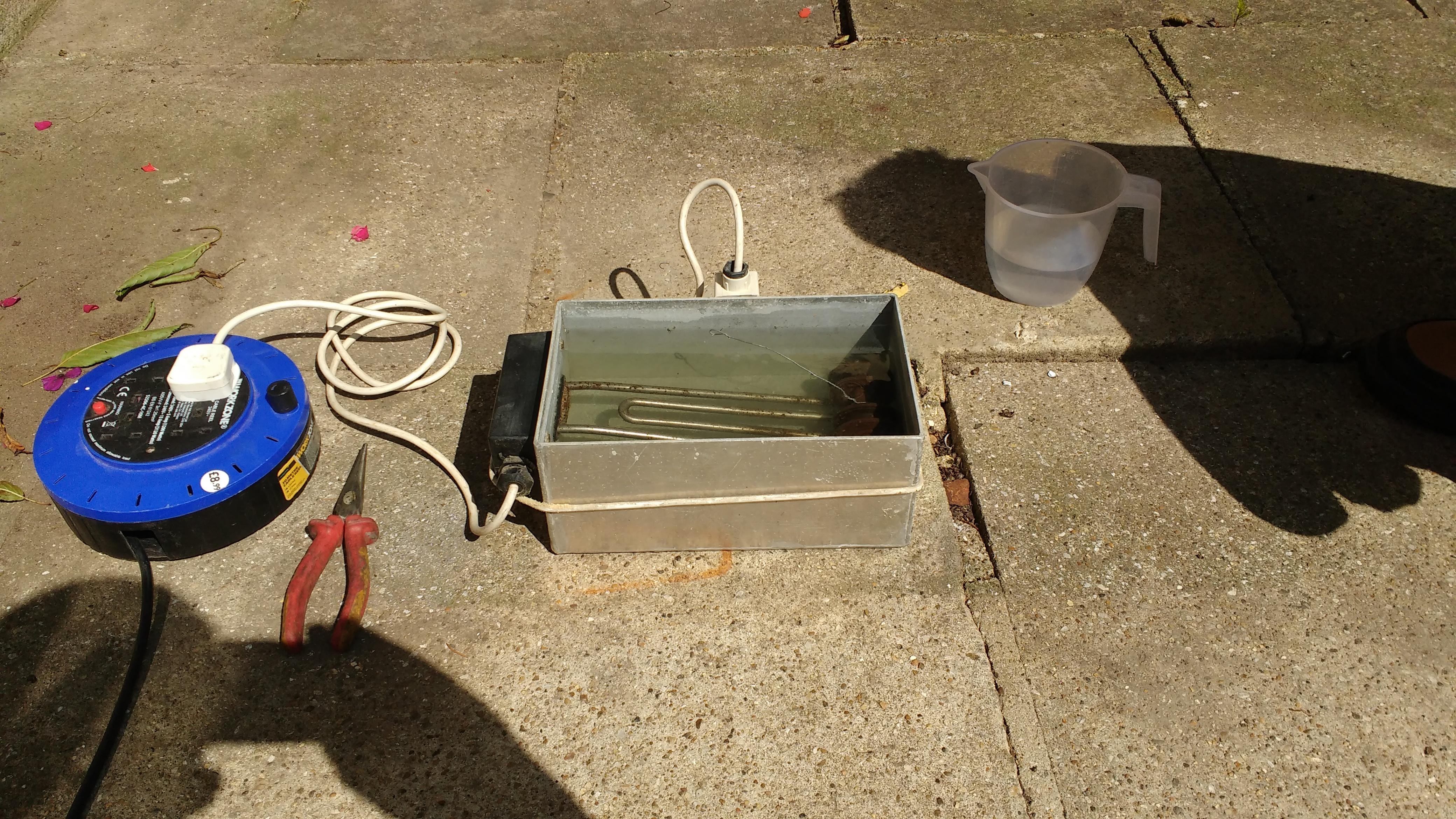

Onoff Posted August 20, 2019 Author Posted August 20, 2019 This is the mower pulley assembly: A trip to Wilko, £1.75 a pack: And something I made 30 odd years ago. Might change the plug and check the earth...
Gone West Posted August 20, 2019 Posted August 20, 2019 1 hour ago, Onoff said: A trip to Wilko, £1.75 a pack: And something I made 30 odd years ago. Might change the plug and check the earth... How much better is the citric acid when heated rather than cold?

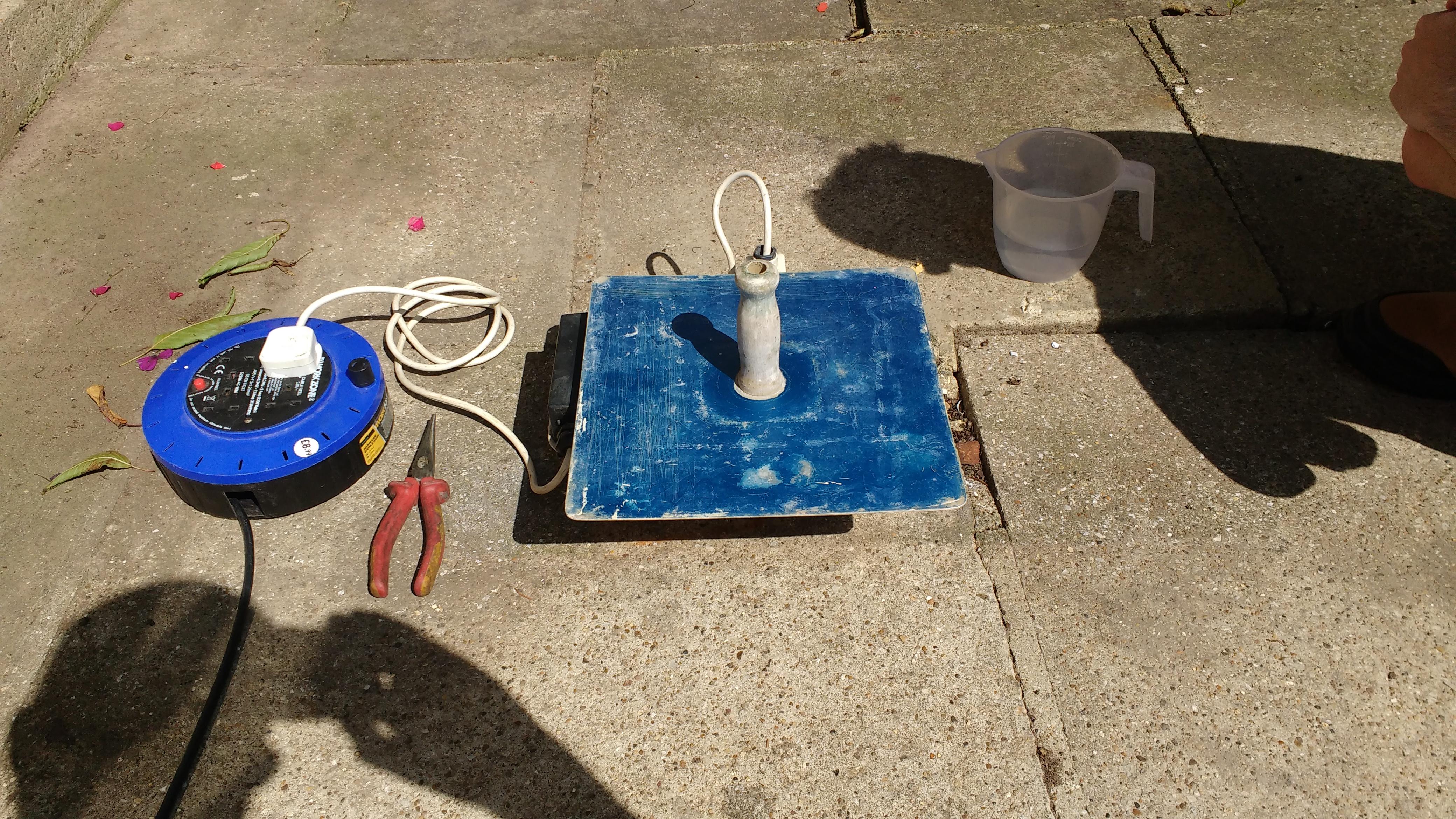

Onoff Posted August 20, 2019 Author Posted August 20, 2019 I'm treating the citric acid as Deox-C. Instructions say a strong solution 4:1, normal solution 19:1: Deox-c_Technical-1.pdf We've put 750g of citric acid in with 3L of water then added half a litre of water to cover everything. So a little over 4:1 but still a strong solution. Cylinder stat is holding everything at 70degC and it's all bubbling away nicely. H&S being paramount and to limit evaporation a cover over the top! Pulley went in at 13:00hrs.
Onoff Posted August 20, 2019 Author Posted August 20, 2019 3 minutes ago, PeterStarck said: How much better is the citric acid when heated rather than cold? The Deox-C instructions suggest much better. 1
Onoff Posted August 20, 2019 Author Posted August 20, 2019 After 1 hour: The liquid takes on a green tinge, darkening as it loses its efficiency / gets contaminated by the rust coming off. This is just what Deox-C does. Reading the Deox-C instructions again and it contains "detergents". I'm thinking this might be to help lift oily rust. Tempted to put a squirt of Fairy in my little tank. Coming up on 3 hours in there at 70degC: I've also thrown in a few equally rusted hand plane blades, an old leather punch, a hammer head etc.

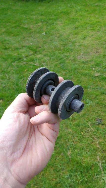

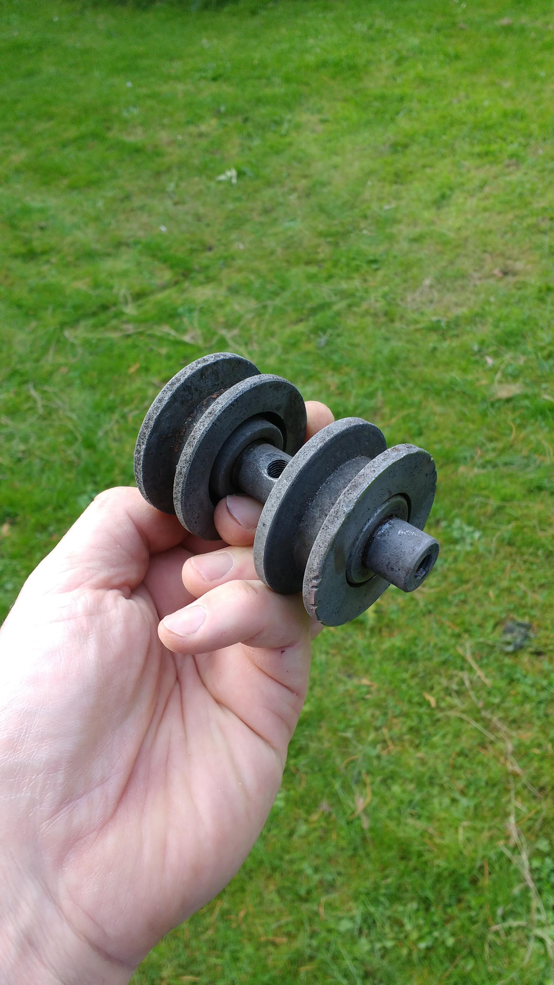

Onoff Posted August 20, 2019 Author Posted August 20, 2019 At the 5.5hr mark. Both pullies spin freely. Pretty much ready to mask up and etch prime! 1

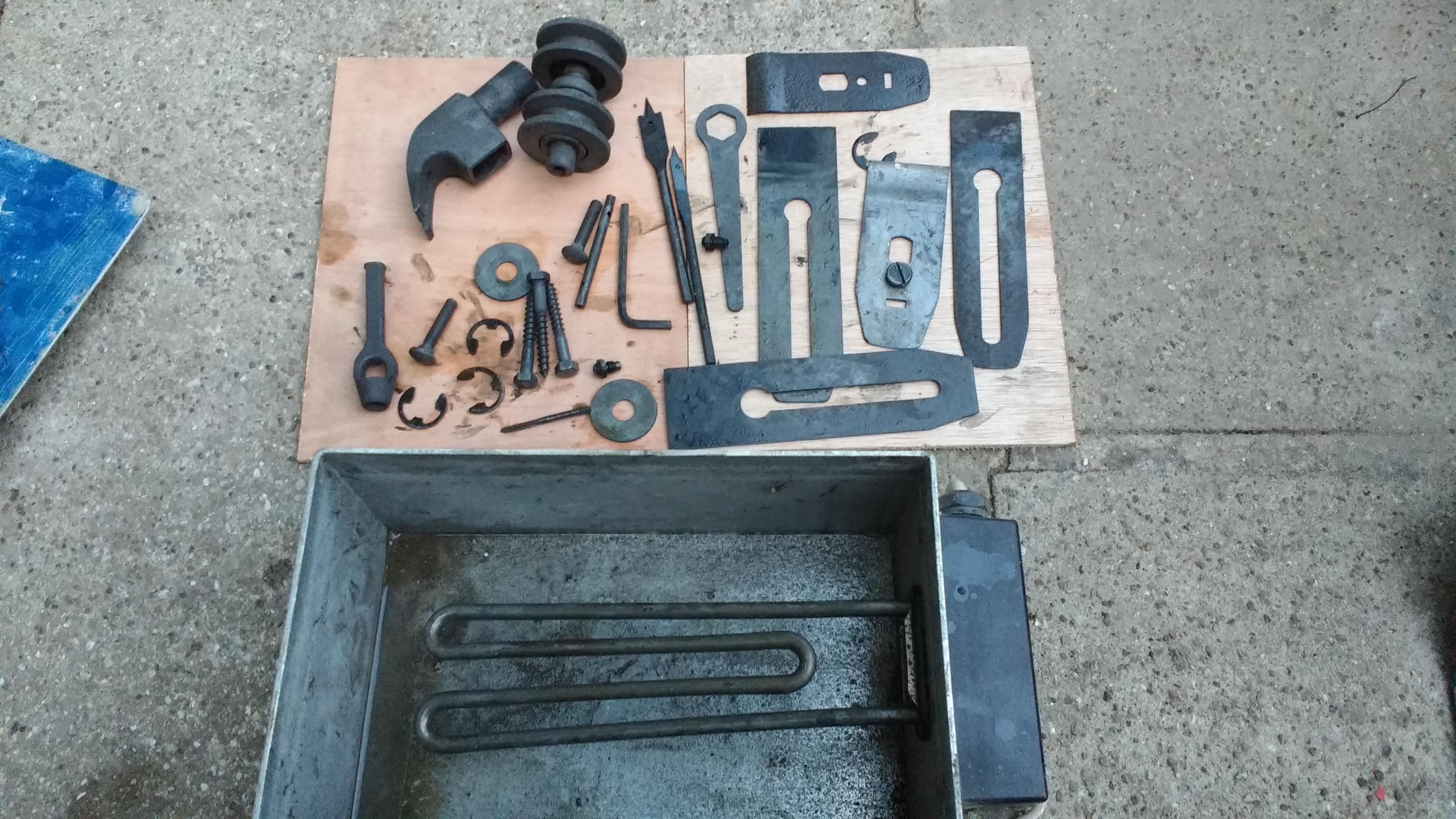

Onoff Posted August 20, 2019 Author Posted August 20, 2019 (edited) Just fished this lot out of the heated tank. Pre rinsing but you can see how good it is: What I recall from using Deox-C was that pretty much everything came out with a black, greasy film on it, that would stain anything. It came off easy enough with a scrub. This citric acid though seems to leave a nice, clean matt grey surface for the most part. I do note the two flat wood bits are a bit black/greasy. Random bits from a tap to the old, heavily rusted coach screws off the freebie satellite dish. Of course, things like the plane blades would be further wet & dried then kept oiled. To reuse the coach screws outside they would ideally need replating. Happy with the process all in all. For now I've rinsed the tank out and dumped all the bits in an unheated plastic bucket with the solution where it'll continue to do its thing albeit at a slower pace. Edited August 20, 2019 by Onoff
