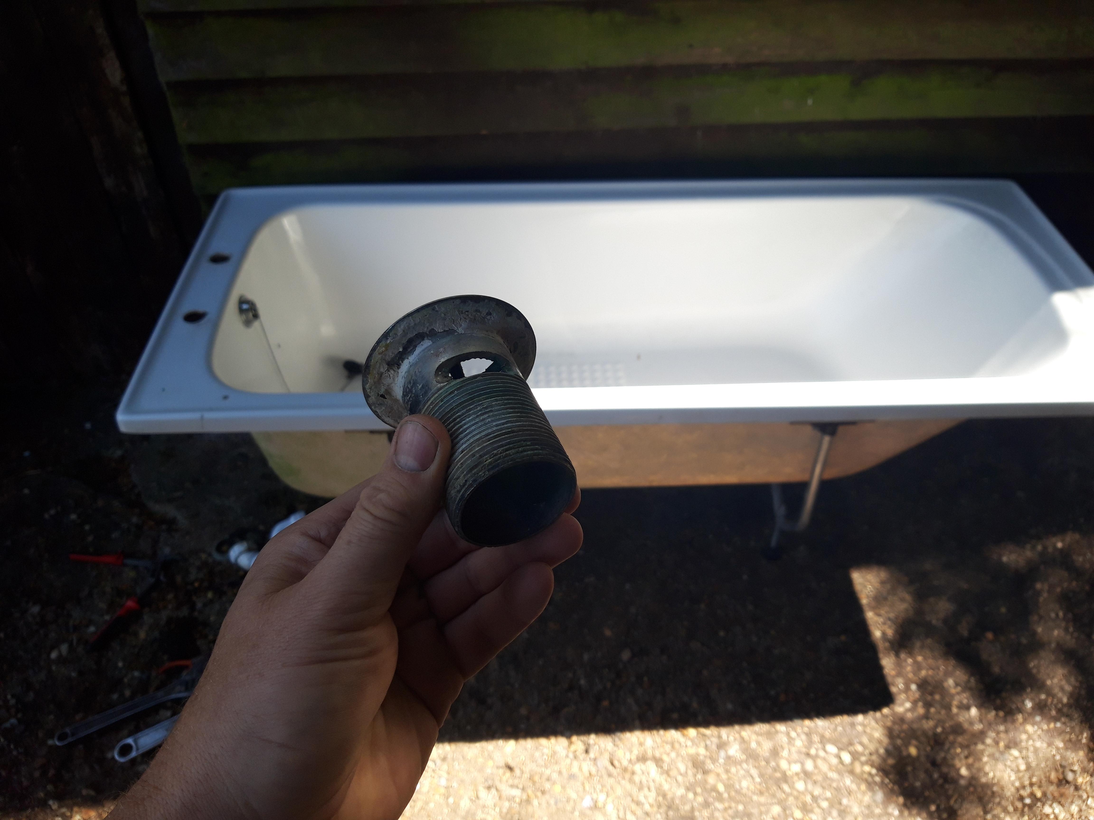

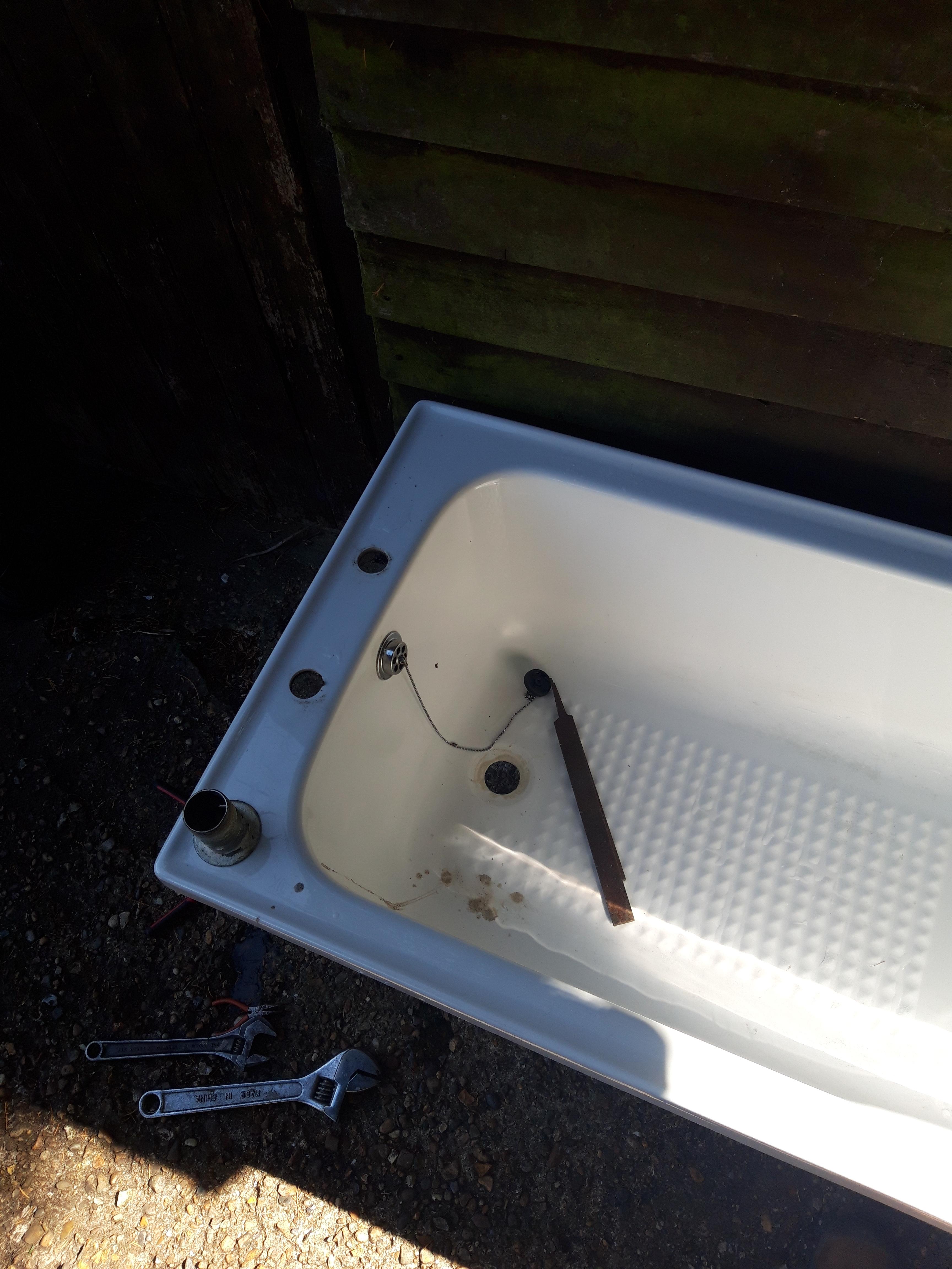

Onoff Posted August 31, 2019 Author Posted August 31, 2019 Need to blank the plug hold off for the big bath tank. Figuring though the citric acid might eat whatever alloy the waste is made of as it says it'll eat zinc, tin, lead and alloys thereof. How to blank it off?

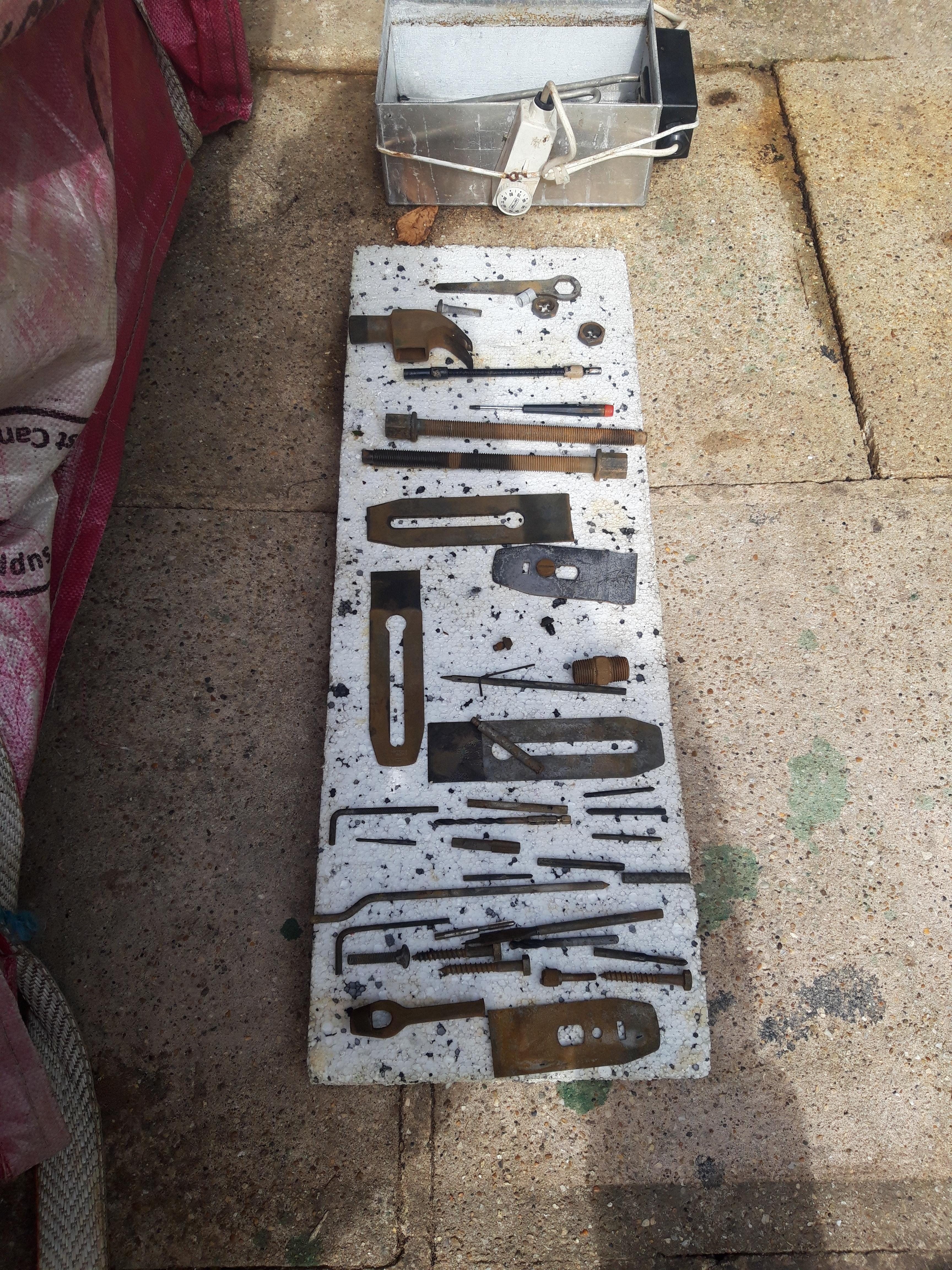

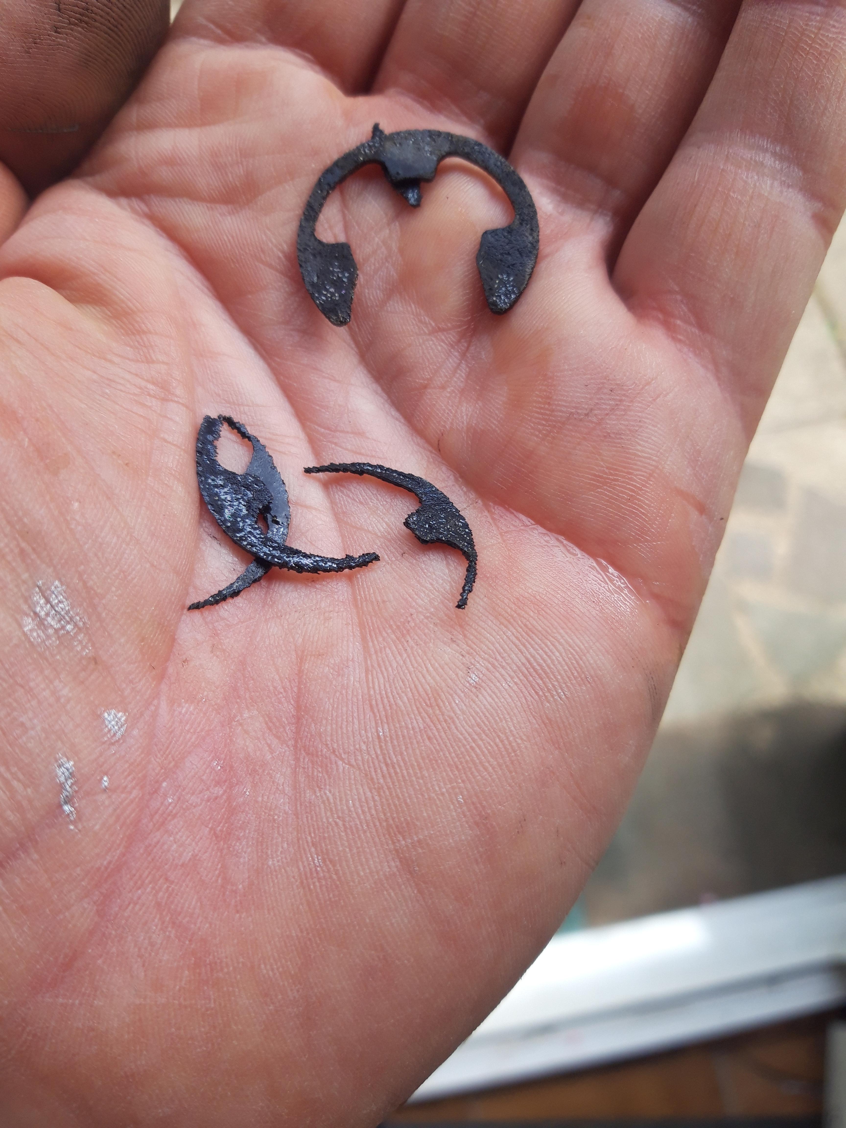

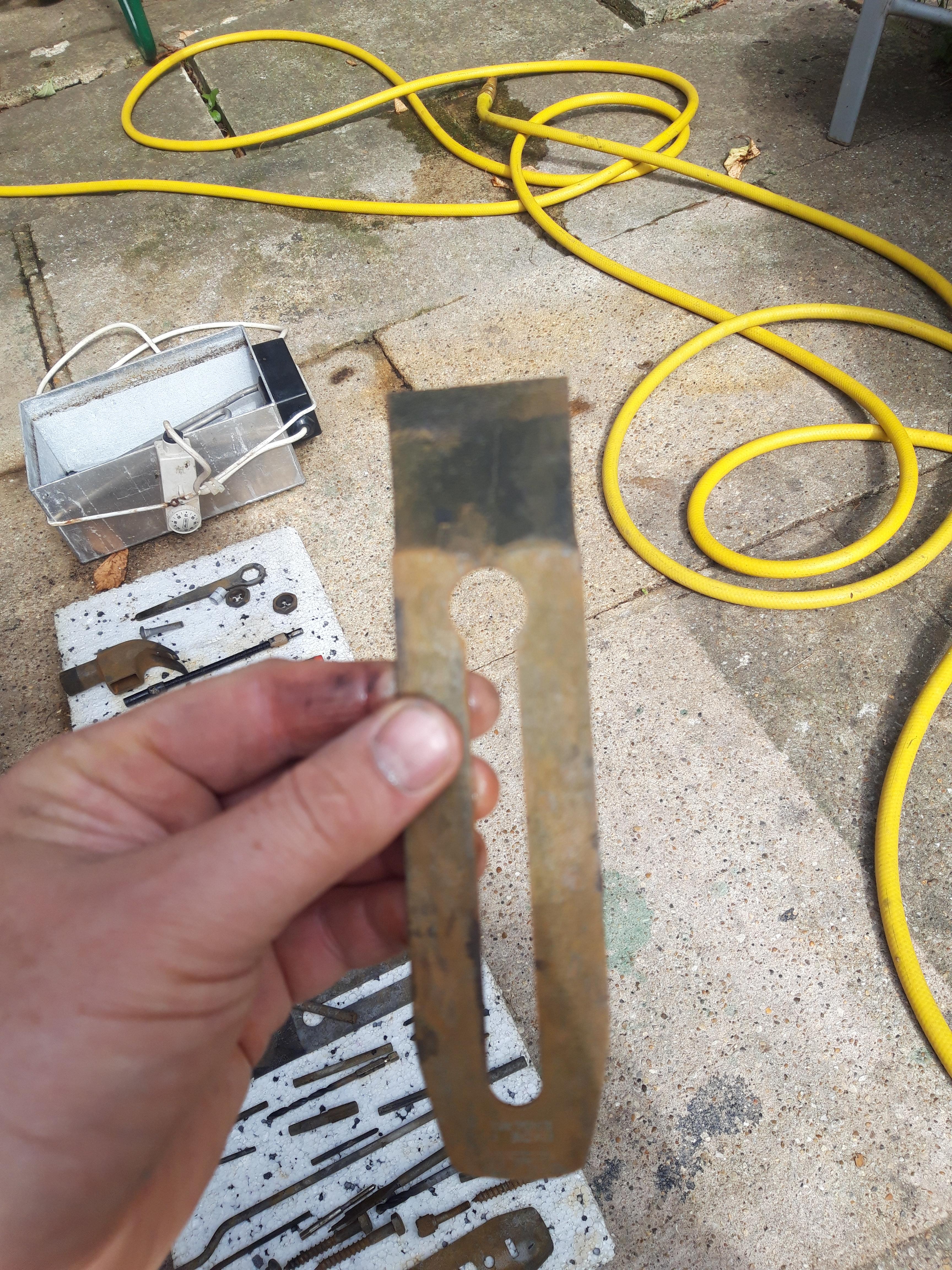

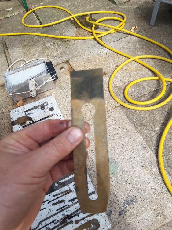

Onoff Posted August 31, 2019 Author Posted August 31, 2019 1 hour ago, Ferdinand said: Layer of cement in the bottom? I don't think so! Sounds like hard work and overkill. Might have a black plastic waste somewhere here... One thing I'd noted is I left the parts in the small tank for over a week and some parts have corroded/ disintegrated! What was 4 circlips: The plane blades are interesting (and annoying). They've both thinned down and narrowed at what I guess is the high carbon content end:
Ferdinand Posted August 31, 2019 Posted August 31, 2019 I would think that a normal plug would be too high risk for coming out by mistake or leaking with a corrosive like that.
Jeremy Harris Posted August 31, 2019 Posted August 31, 2019 Bit of GRP over the hole? Coupled with a bit applied on the underside, bonded to the bit of the top, should seal it up OK. Might be quicker to just stick something over the hole with a bit of CT1, probably do a good enough job. One advantage of using phosphoric acid over citric acid is that the corroded steel won't get eaten away and thin. Once all the ferric oxide (rust) has been converted to ferric phosphate, it becomes pretty much inert to further action from the phosphoric acid. For something heavily corroded I'd be inclined to remove the worst of the ferric oxide with something like citric acid, but not go too far with this, just enough to get back to the original dimensions. Then wash off and dry the part and treat it with phosphoric acid (make sure it is properly dry before treating with phosphoric acid; water can form insoluble salts which appear as white powder and prevent paint adhering. When it's uniformly black, then remove the part and dry it as quickly as possible. Don't wash off the phosphoric acid from the surface, just let it dry naturally.
Simplysimon Posted August 31, 2019 Posted August 31, 2019 kiss, piece of wood, rounded off, hammered in.
Onoff Posted September 1, 2019 Author Posted September 1, 2019 (edited) I might have a black plastic waste here somewhere. I'd put that in then the plug with a bit of silicone for good measure. Was half thinking a flat metal disc like a conduit lid whacked in with CT1? EDIT: But not a conduit lid as that's galvanised so zinc. Edited September 1, 2019 by Onoff

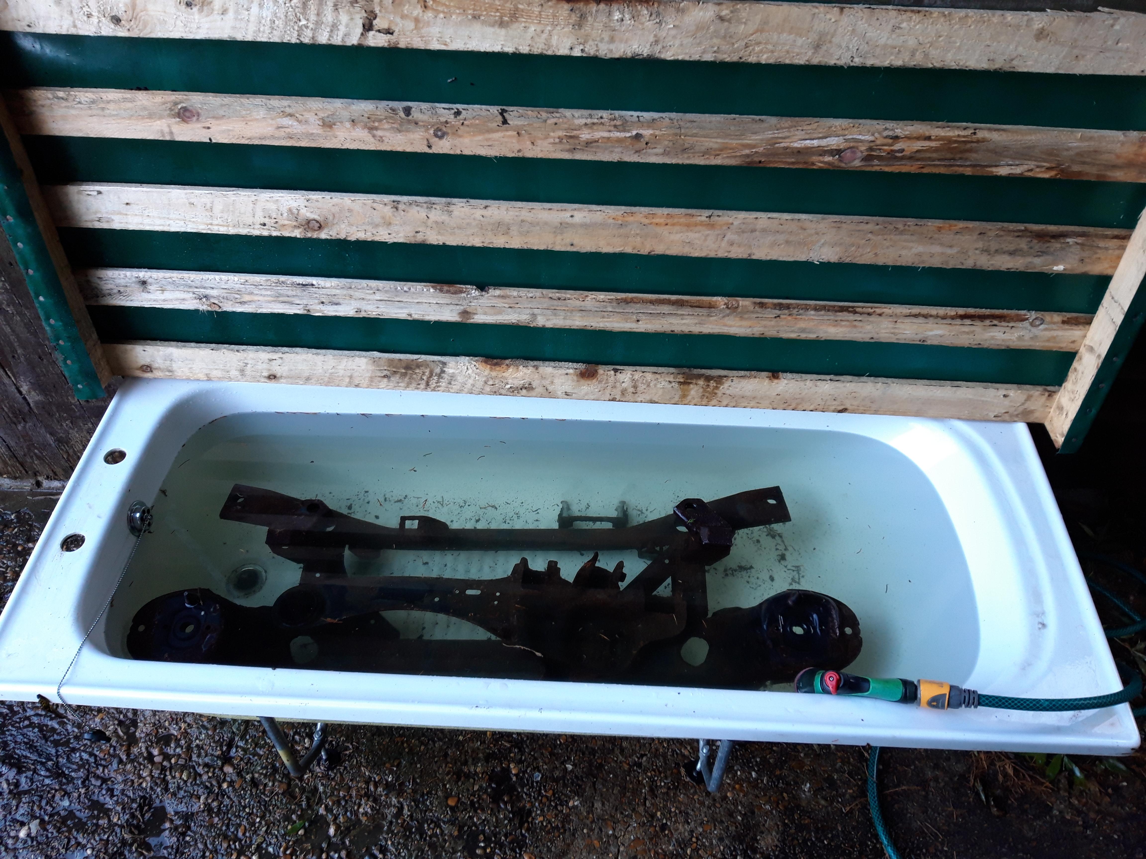

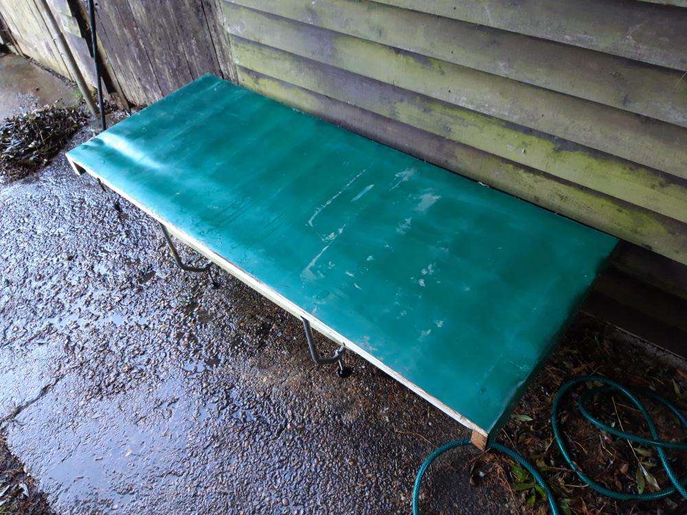

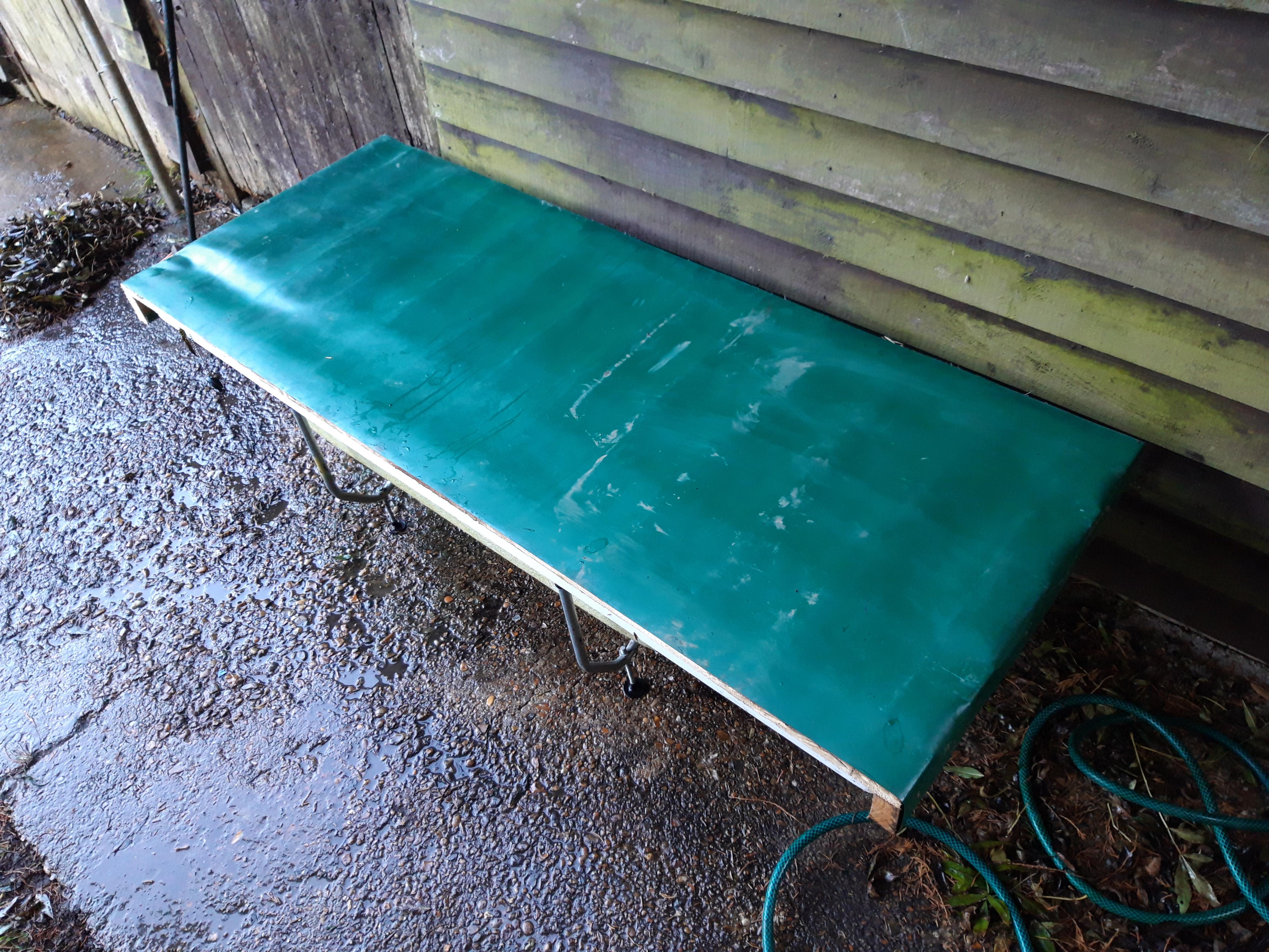

Onoff Posted November 10, 2019 Author Posted November 10, 2019 Should have done this back when it was warmer but I finally got around to filling the old bath up with 9kg of citric acid in water. The only "hot" was the 3 buckets from the tap that I mixed it up with, the rest was from the garden hose. Should have blocked the overflow off too to get a deeper fill as a couple of bits of the crossmember are poking above the surface. Made a rough lid from a denailed / renailed pallet and a bit of lorry siding (not quite wide enough). In went the MK1 Focus rear cross member (gut feel it's too far gone to be bothering) and one of the rear trailing arms (salvageable I reckon). No ideas what'll happen in this weather, guessing it might freeze? The bath is outside up against the derelict stable. Assume the derusting will be really slow too with no heat?
