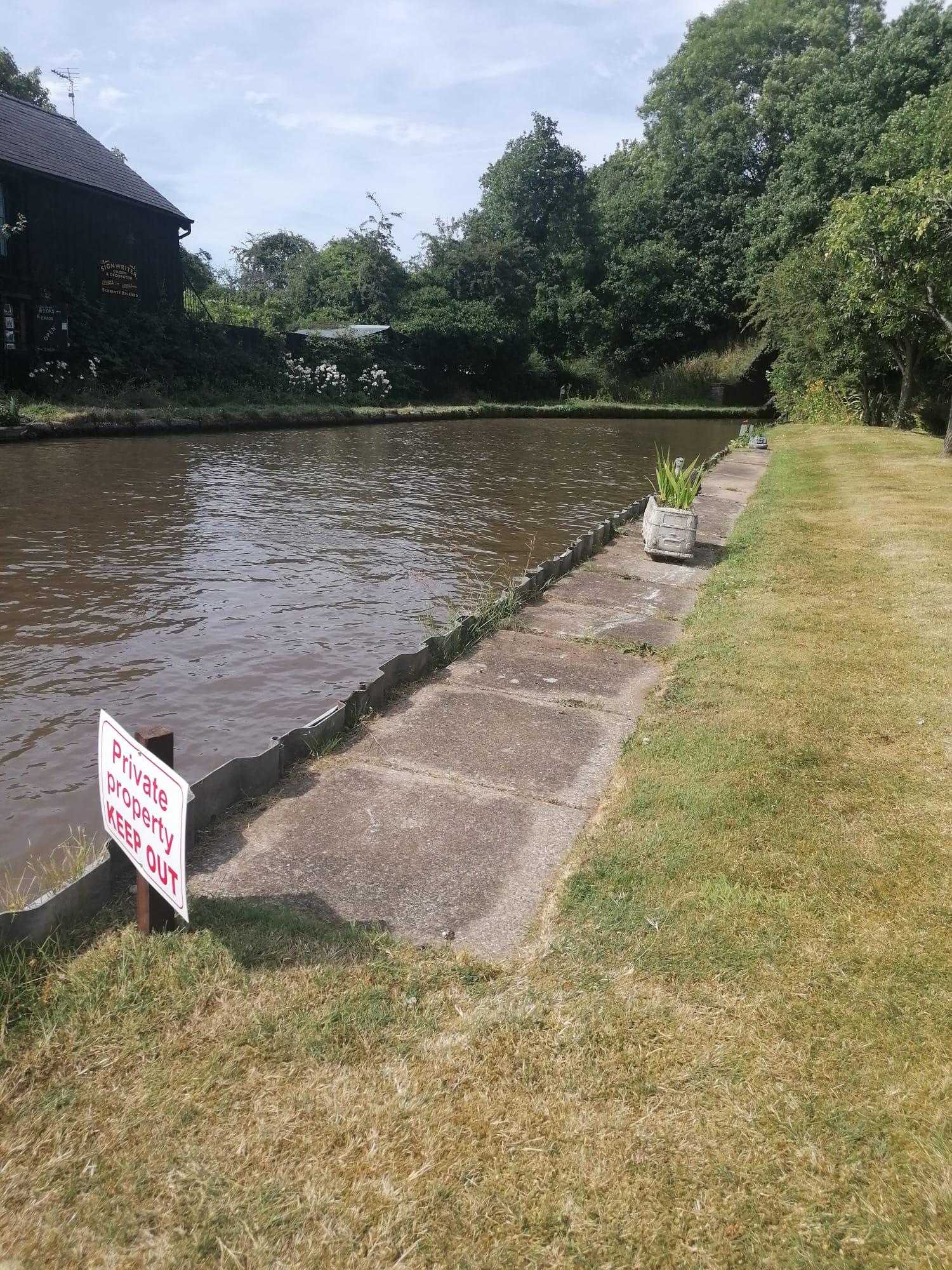

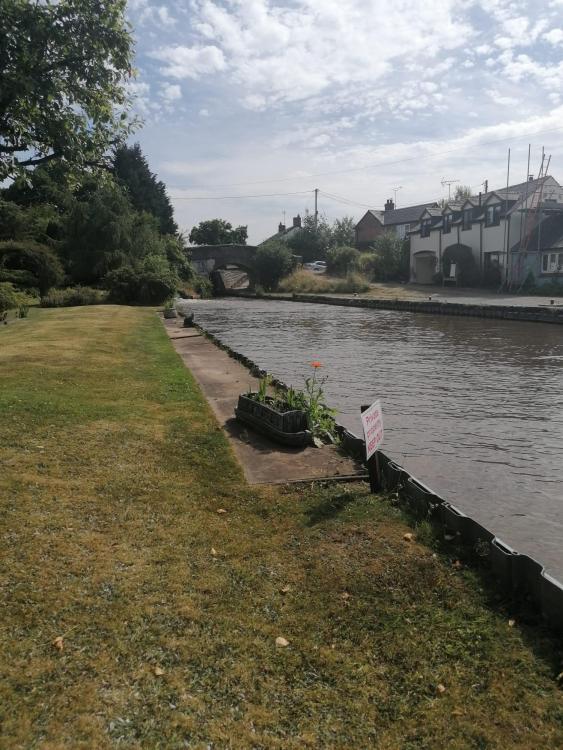

canalsiderenovation Posted July 17, 2022 Share Posted July 17, 2022 We are looking at putting in some posts and rope/chain in between where we moor our boat in the garden (boat currently at the marina so not in picture). One side would be around 10.5m and the other 16.5m. This is mainly as idiot hire boats occasionally get onto the wrong side and end up stood in our garden despite 'private' signs or mistake the flagged area for somewhere they can pull up (anyone that hires a narrowboat - take note you always stop or moor on the towpath side)!! We are removing the flags as we end up with boats getting stuck and revving their engine and flooding the flags so they have moved. The most logical option is just to turf the area where the flags are and either side of the boat looking at fence posts and rope/chain. My wife was considering wooden posts and rope and had seen a website https://richthepostman.business.site/?utm_source=gmb&utm_medium=referral#posts with the posts we can push straight into the garden. She had a quote for the cheap 45 degree angled with 18mm double rope and the cost on this website is about £870 😱 but I'm worried about them being wood, the proximity to the canal and likely them getting wet etc from boats and would prefer something more weatherproof. The posts need to be about 700/800mm in height with about 1.5/2m in between each post. I've seen some plastic posts and chain but I can't seem to find them in the height we want. Pics of the area from each side; Does anyone have any suggestions please? Thanks 👍 Link to comment Share on other sites More sharing options...

Onoff Posted July 17, 2022 Share Posted July 17, 2022 1 hour ago, Simplysimon said: scaffold poles cut to length? They could slot the bottom so they slip over that corrugated edging by the water. A couple of drilled and tapped holes for securing bolts. Link to comment Share on other sites More sharing options...
canalsiderenovation Posted July 17, 2022 Author Share Posted July 17, 2022 11 minutes ago, Onoff said: They could slot the bottom so they slip over that corrugated edging by the water. A couple of drilled and tapped holes for securing bolts. We can't actually drill or fix anything into the piling as that's CRT property and they can be a bit funny with stuff attached on it. Link to comment Share on other sites More sharing options...
AdamSee Posted July 17, 2022 Share Posted July 17, 2022 I've used 10 x 10 recycled plastic from here https://www.earth-anchors.com/product-category/lumber/ for decking in the past. Won't rot, so it's ideal for here. They have a free cutting service. Not sure if that extends to a free drilling service. But it's worth an ask. It's available in 8 x 8 which would work for rope posts. Just needs the holes (and the rope). What's your plan for fixing them? Can you dig near the edge or allowed to bolt to the hard standing that is the edge. Best of luck. 1 Link to comment Share on other sites More sharing options...

canalsiderenovation Posted July 17, 2022 Author Share Posted July 17, 2022 34 minutes ago, AdamSee said: I've used 10 x 10 recycled plastic from here https://www.earth-anchors.com/product-category/lumber/ for decking in the past. Won't rot, so it's ideal for here. They have a free cutting service. Not sure if that extends to a free drilling service. But it's worth an ask. It's available in 8 x 8 which would work for rope posts. Just needs the holes (and the rope). What's your plan for fixing them? Can you dig near the edge or allowed to bolt to the hard standing that is the edge. Best of luck. Cheers I've messaged them too. Re fixing, digging near the edge is fine but we are removing the hard standing flags as they have all lifted up and will probably just keep it grass I think. Hammer them into ground, could put a bit of concrete in if needed I guess. Link to comment Share on other sites More sharing options...

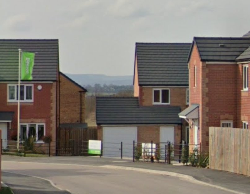

Ferdinand Posted July 17, 2022 Share Posted July 17, 2022 The other type of inexpensive fencing that I like is metal "Estate Fencing", like this: The one above is "Chatsworth" style fencing at £25 + VAT per metre, which is not bargain basement, but is very reasonable for what you get. I think that would look attractive along your canal bank, and could be postcreted in without risk of rotting in 10-15 years. It should outlast you. You can get gates for it, which would help if you are mooring your own boat. And if within say 250-500mm of the edge people would be discouraged from getting off (the boat). Especially people on their first boating holiday ... who are your main customer group aiui? Here's another example: https://www.thetraditionalco.co.uk/estate-fencing/ I have noticed developers using an ersatz manufactured version of this, which looks good and must be inexpensive - but I have no idea where it is sourced. Distant crop from Streetview. This is on a development called Sutton Heights by a company called Gleeson if you want to follow up. Detail below. Above is outside the show house. Ferdinand 1 Link to comment Share on other sites More sharing options...
