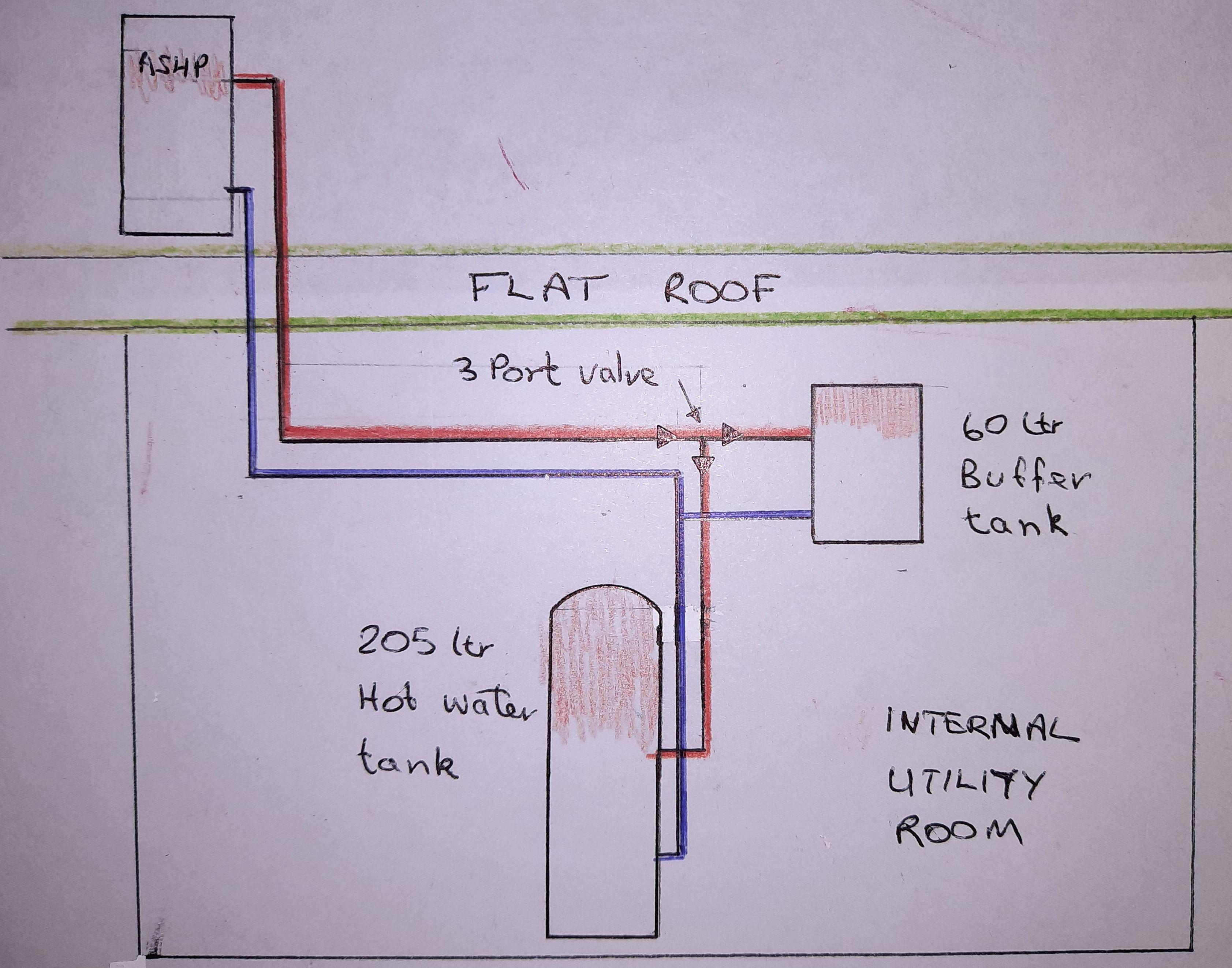

Marvin Posted July 7, 2022 Share Posted July 7, 2022 Its that time of year (and getting hotter) when we require both hot water and cooling from our ASHP. Hot water works fine, cooling works fine, however, today the buffer tank was 36C although it had not been heated for weeks. This suggests to me that the heat from the hot water tank is migrating to the buffer tank. This also coincides with my thoughts about what may be happening on cool nights in winter when the bungalow heating doesn't come on over night and the hot water tank seems to lose a lot of its heat. ( it would be reasonable to loose a couple of kW's from the hot water and it be enough to warm the bungalow on a cool night) The primary pipework is all 28mm and very insulated. The primary pipework only goes to the hot water tank and the buffer tank. The emitters are on a secondary circuit circulating through the buffer tank. The 3 port valve only has no mid position, so either supplying the buffer or the hot water, not both. Three port valve working correctly. The top of the ASHP is about 1.4 meters above the top of the buffer tank. The top of the buffer tank is about 0.7 meters above the top of the hot water tank. A circuit of the longest part of the primary pipework is about 11 meters. So, my thoughts are: Can a 900mm long 28 mm copper pipe full of static water carry 2kW of heat from the hot water tank to the buffer tank (noting that the port valve would stop the possibility of the water circulating through the pipe) within 8 hours? If this is not the case what is happening. If this is the case what safe options can I use to stop this. Your thoughts please. Thank you. Marvin Link to comment Share on other sites More sharing options...

Nickfromwales Posted July 8, 2022 Share Posted July 8, 2022 Does your ASHP cycle the heating after a bout of cooling? If not, I’d say the 3-port valve is passing when ‘closed’. Installing a 28mm anti-gravity valve may also help as that is quite an adverse arrangement in terms of mitigating against such a problem, eg it completely relies on the zone valve to stave off 100% of the reverse flow. You may benefit from a zone valve on the return of the buffer to resolve this long-term. Are there gate valves ( isolation ) on the buffer? If so, try closing the return one and see how that goes. Link to comment Share on other sites More sharing options...
joth Posted July 8, 2022 Share Posted July 8, 2022 What make ASHP / controller is it? As @Nickfromwales suggests, our ecodan FTC6 circulates all pumps when transitioning from DHW back to cooling, which means I get a slug of hot water right the way through to the bedroom FCU. So I've put a thermistor in the heat exchanger of the FCU so it can shutoff the fan when the water temperature is above that of the room it is trying to cool! Avoids a blast of warm air hitting us at 4:30am All that said we also has a 3 port diverter valve (mid position valve, stupidly) and I do worry it lets some by. If I knew how to do plumbing I'd change that up. 1 Link to comment Share on other sites More sharing options...

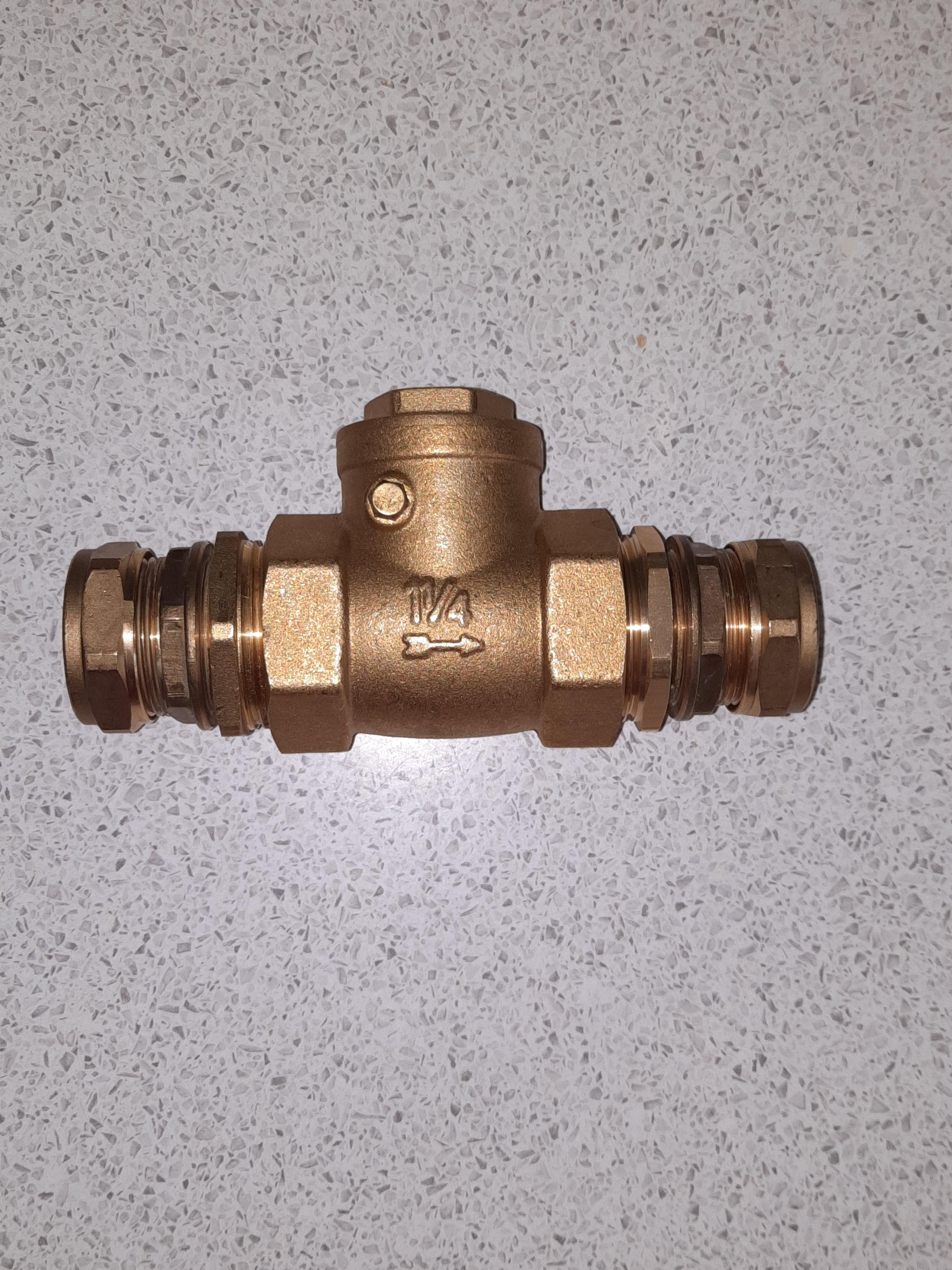

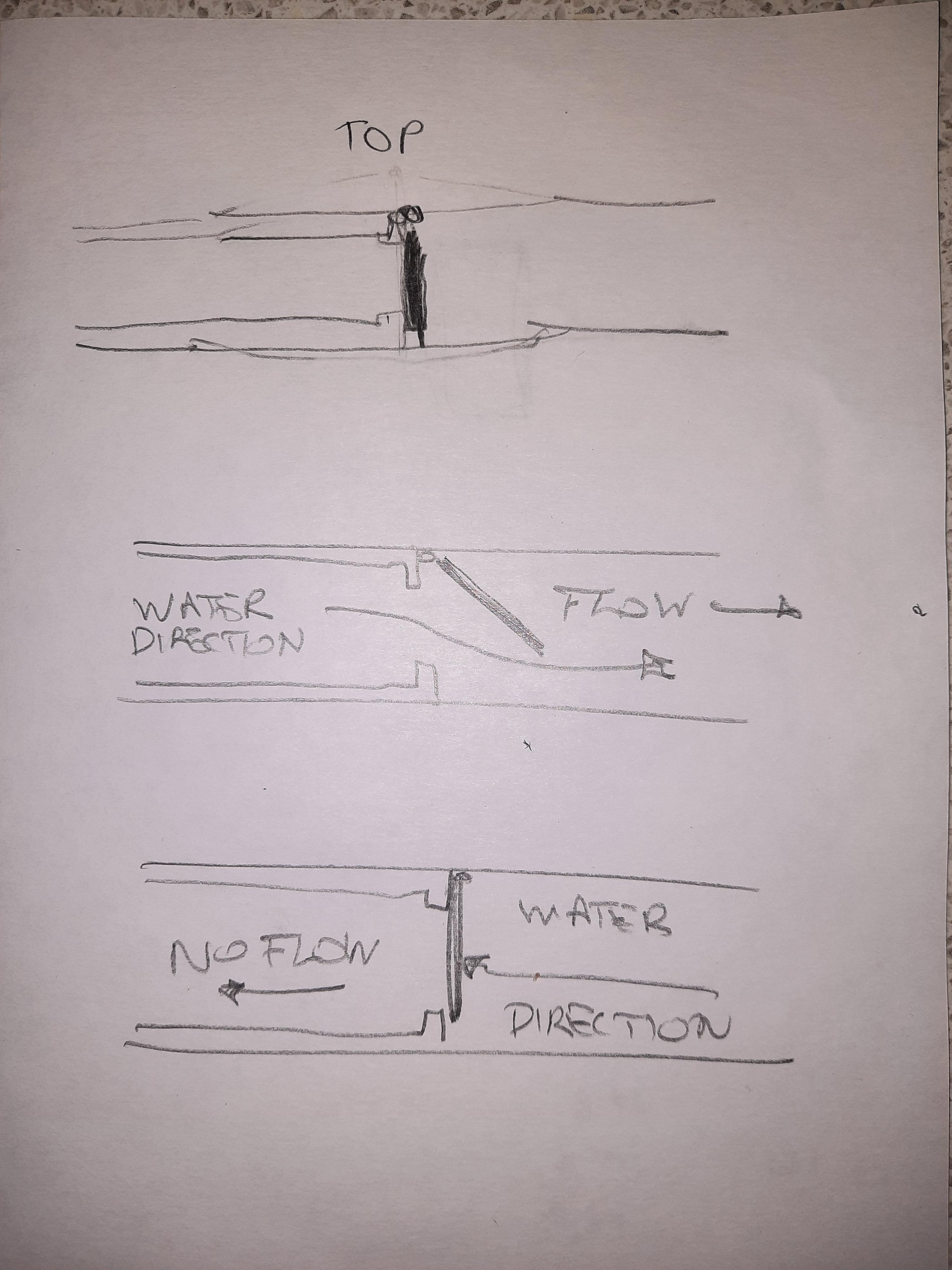

Marvin Posted July 8, 2022 Author Share Posted July 8, 2022 (edited) Decided to fit an anti gravity valve.... this will be fun! Must put it in facing the right direction.... Edited July 8, 2022 by Marvin clarification 1 Link to comment Share on other sites More sharing options...

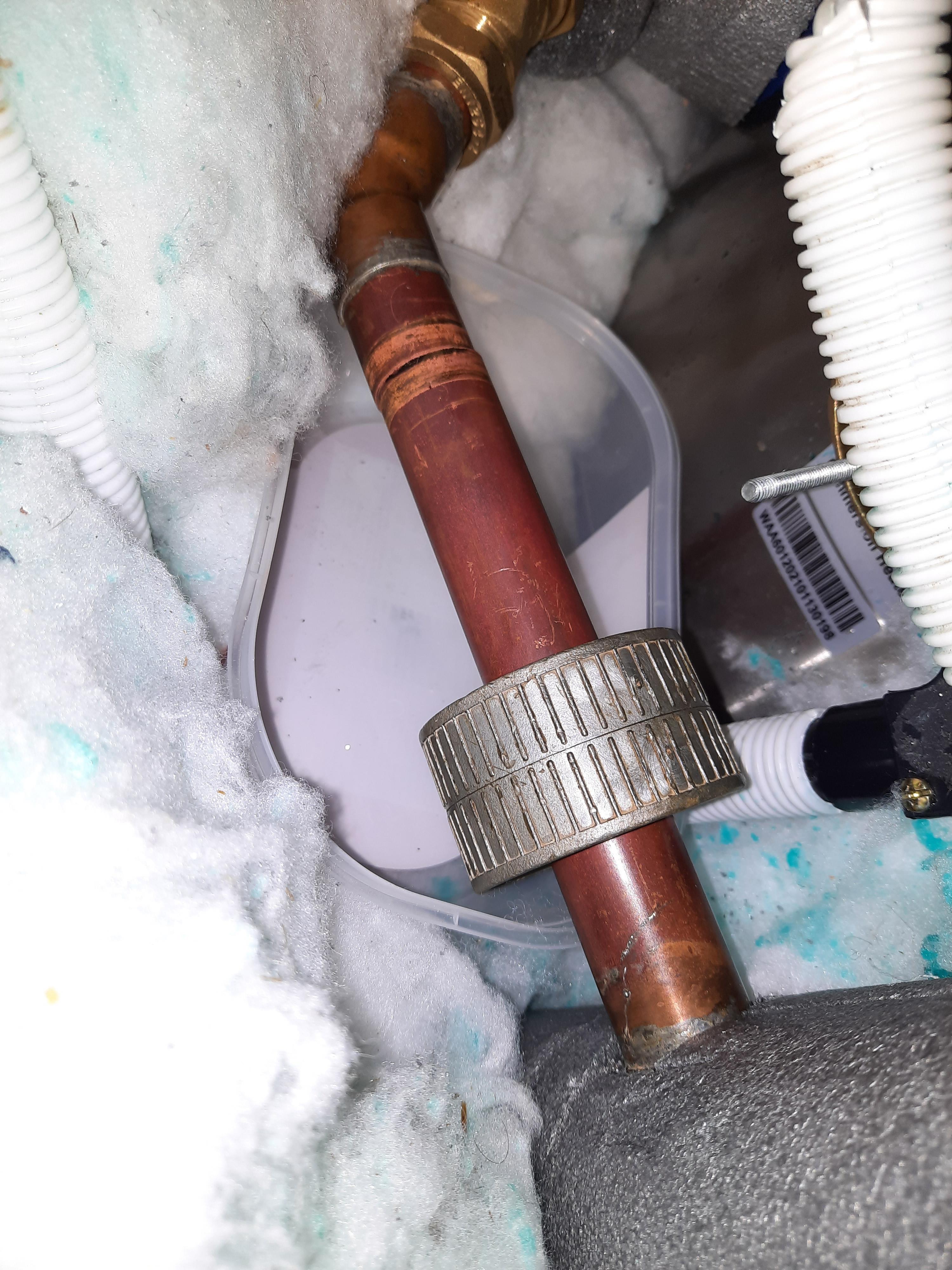

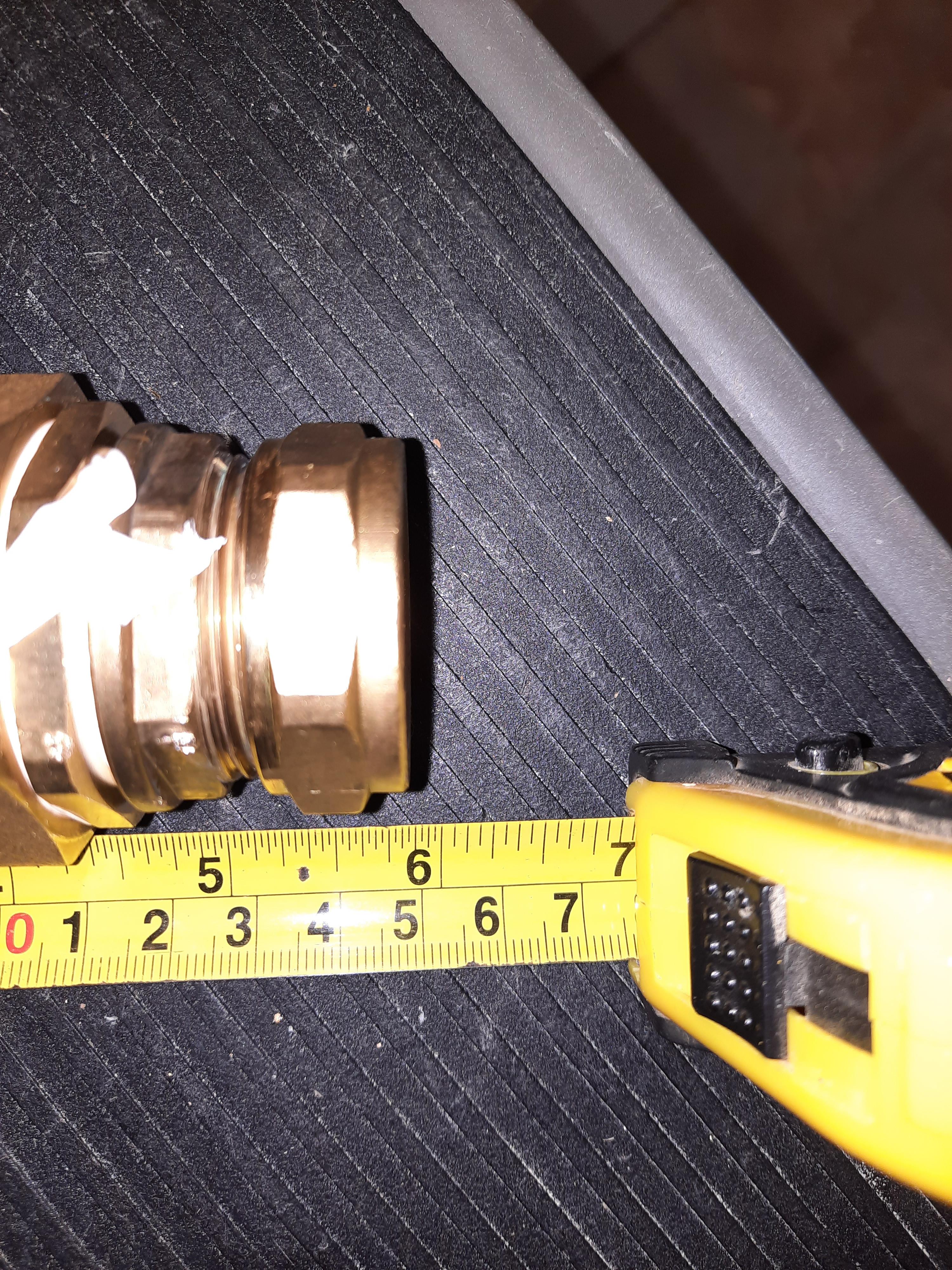

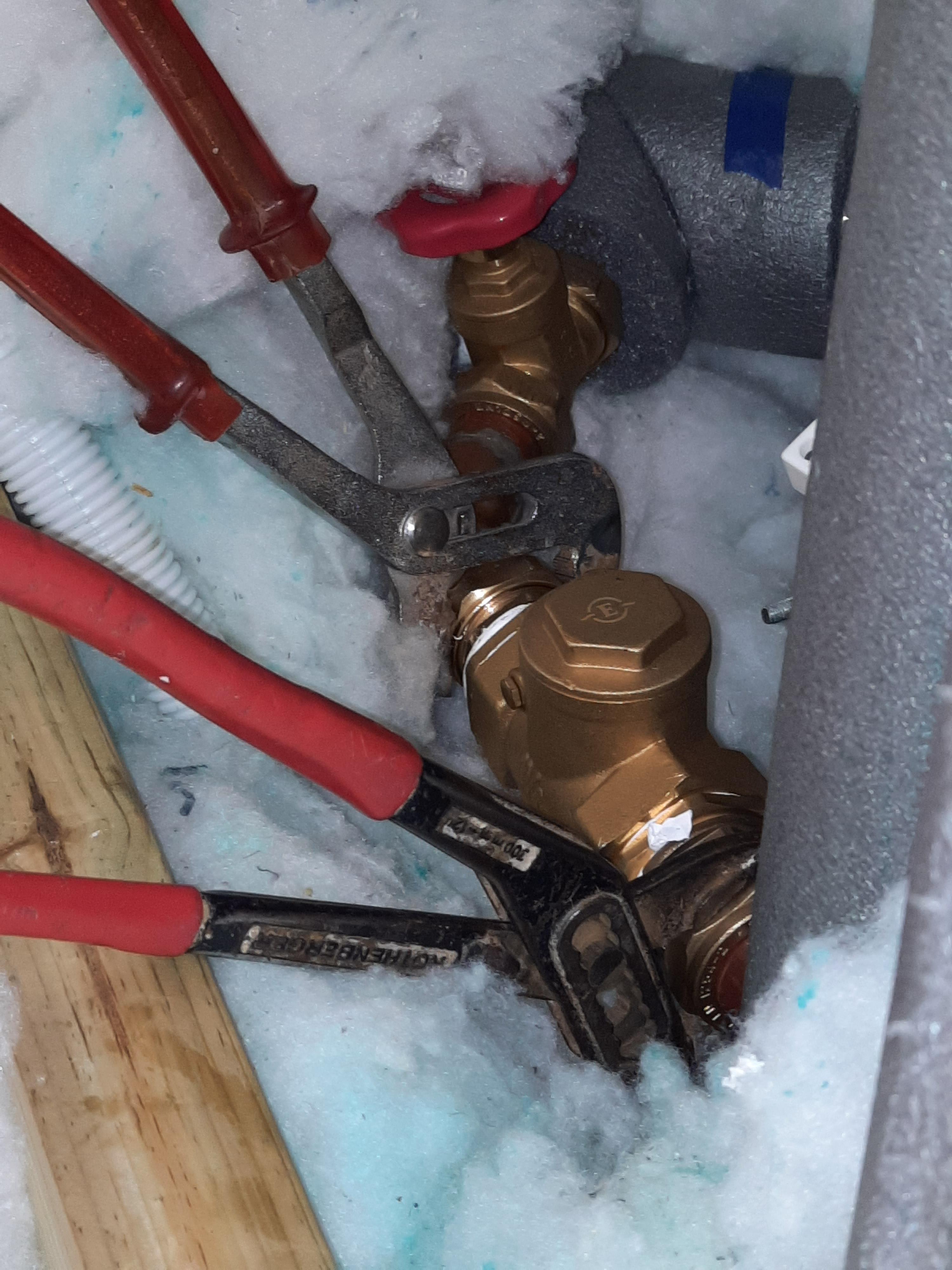

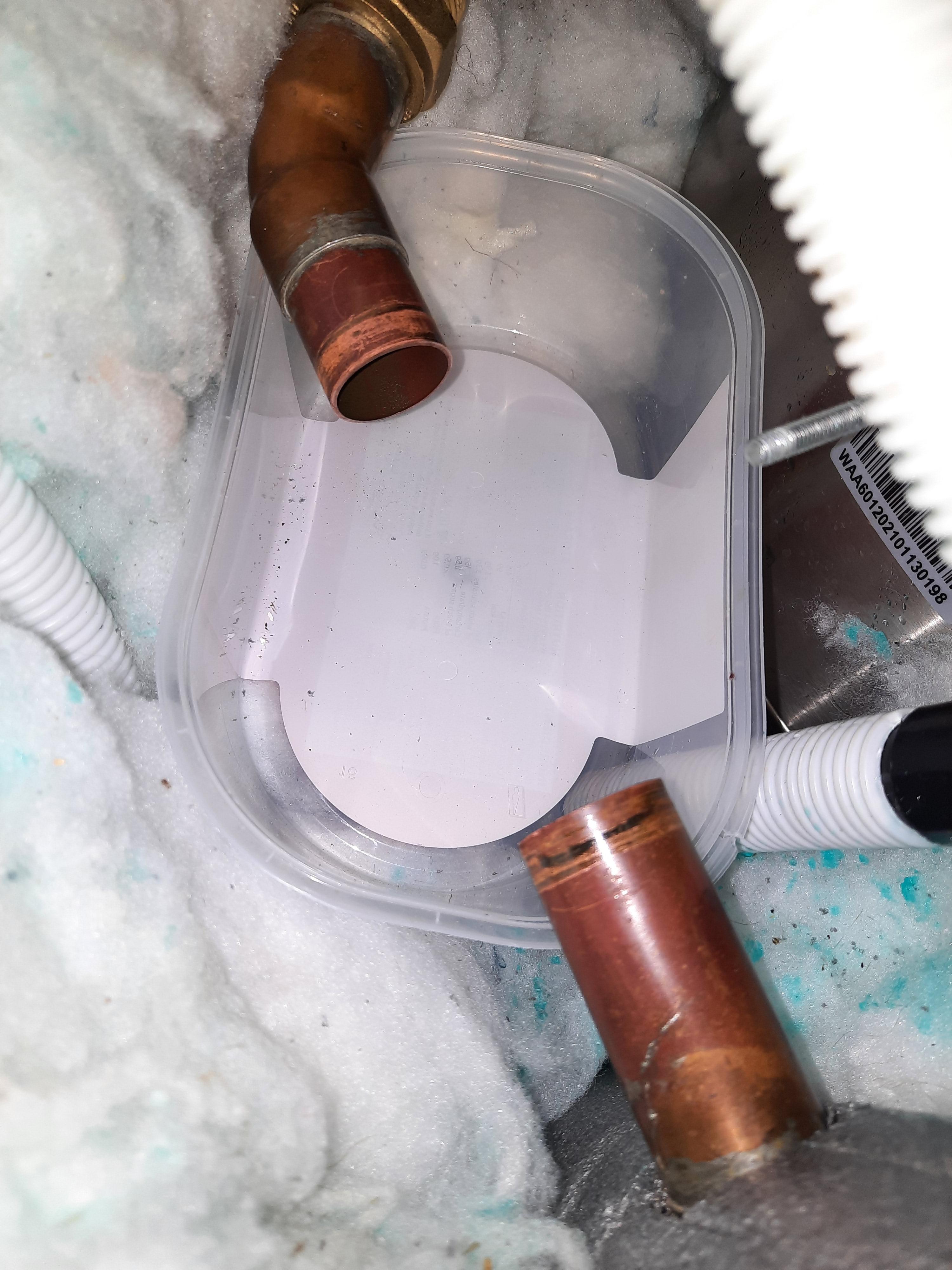

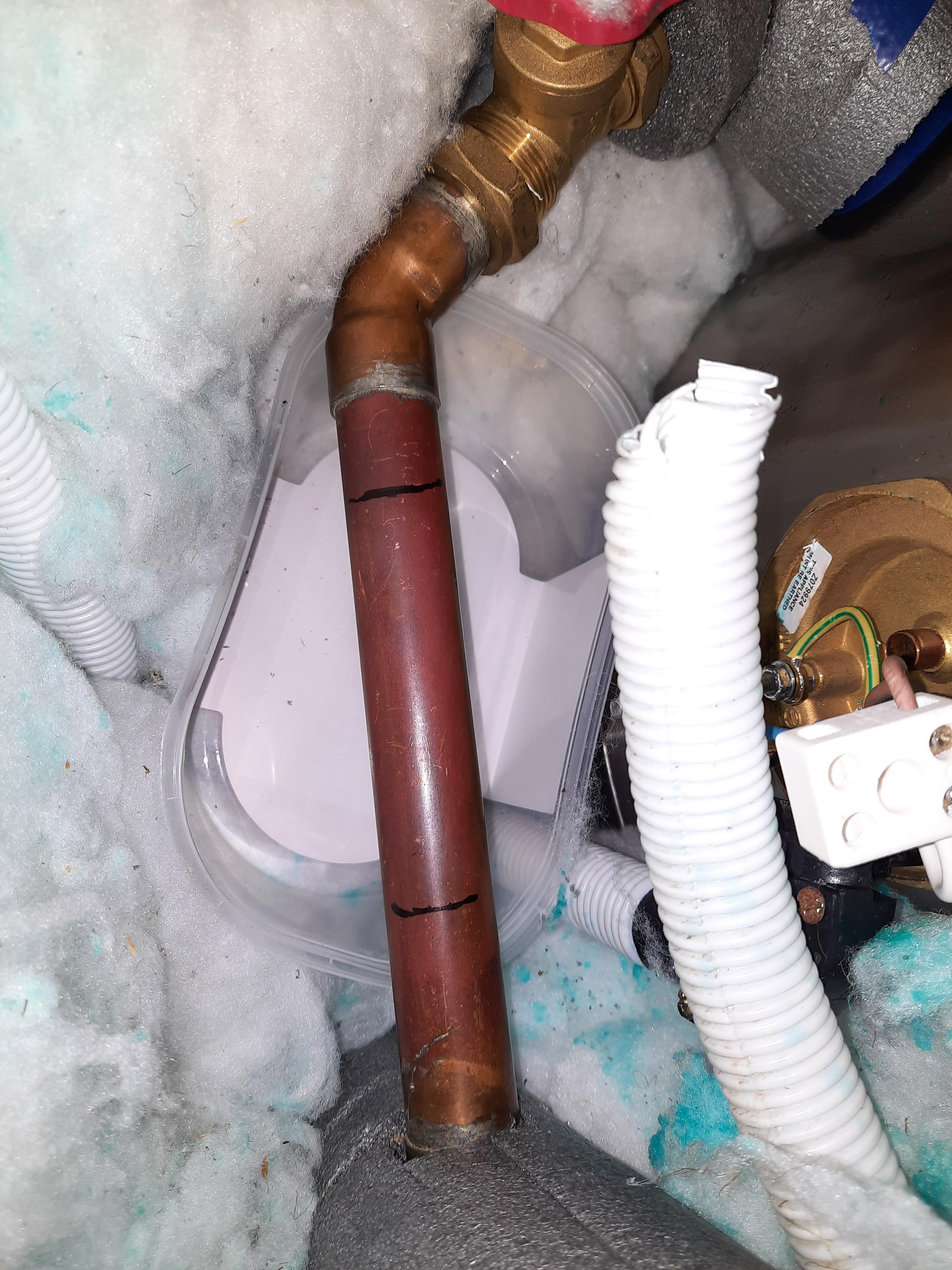

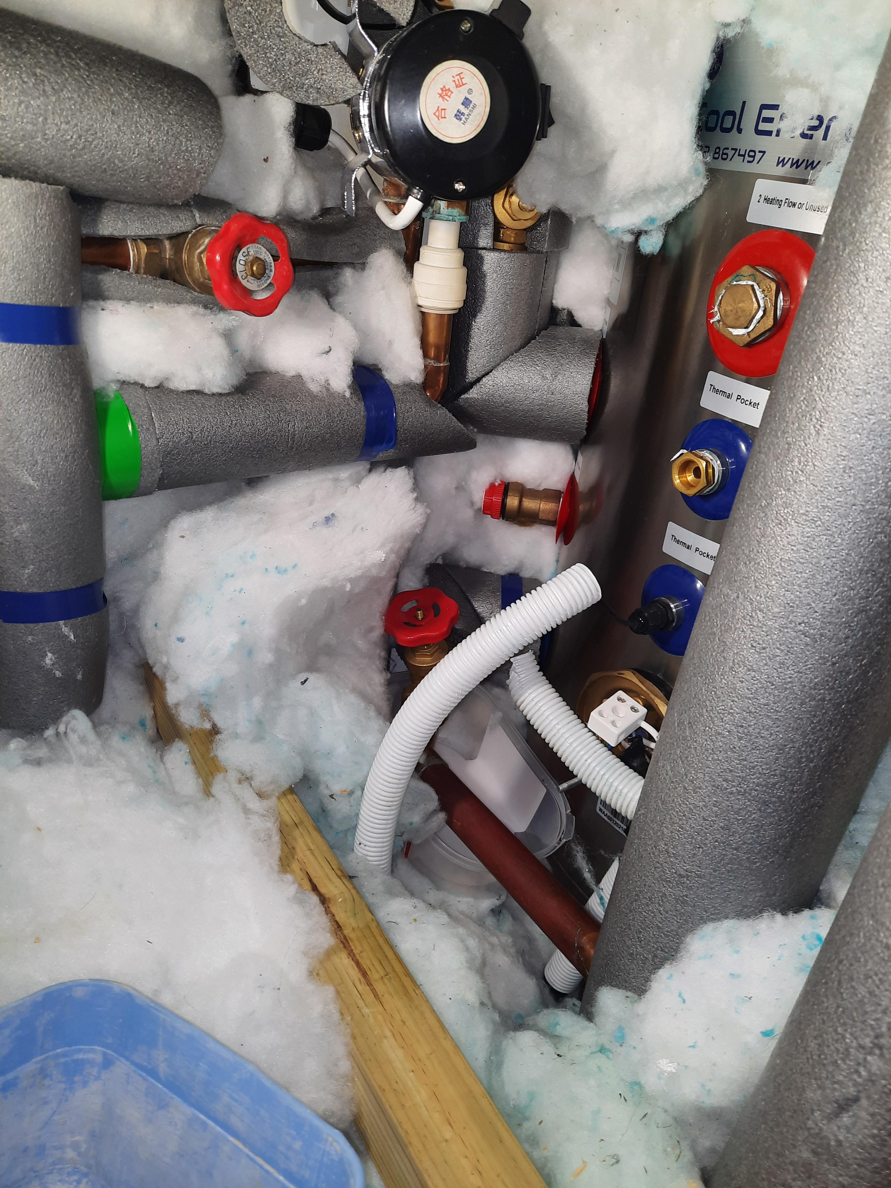

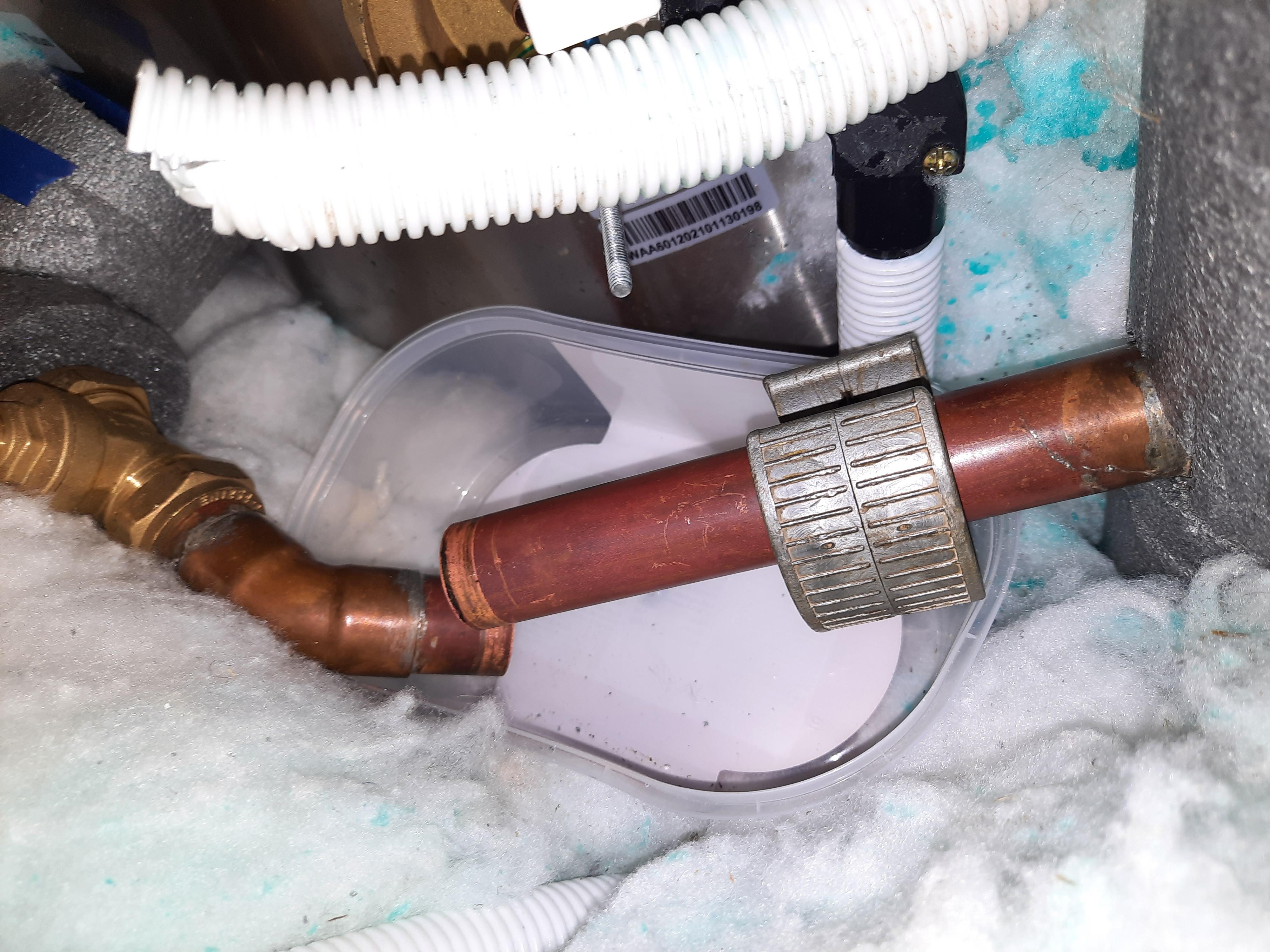

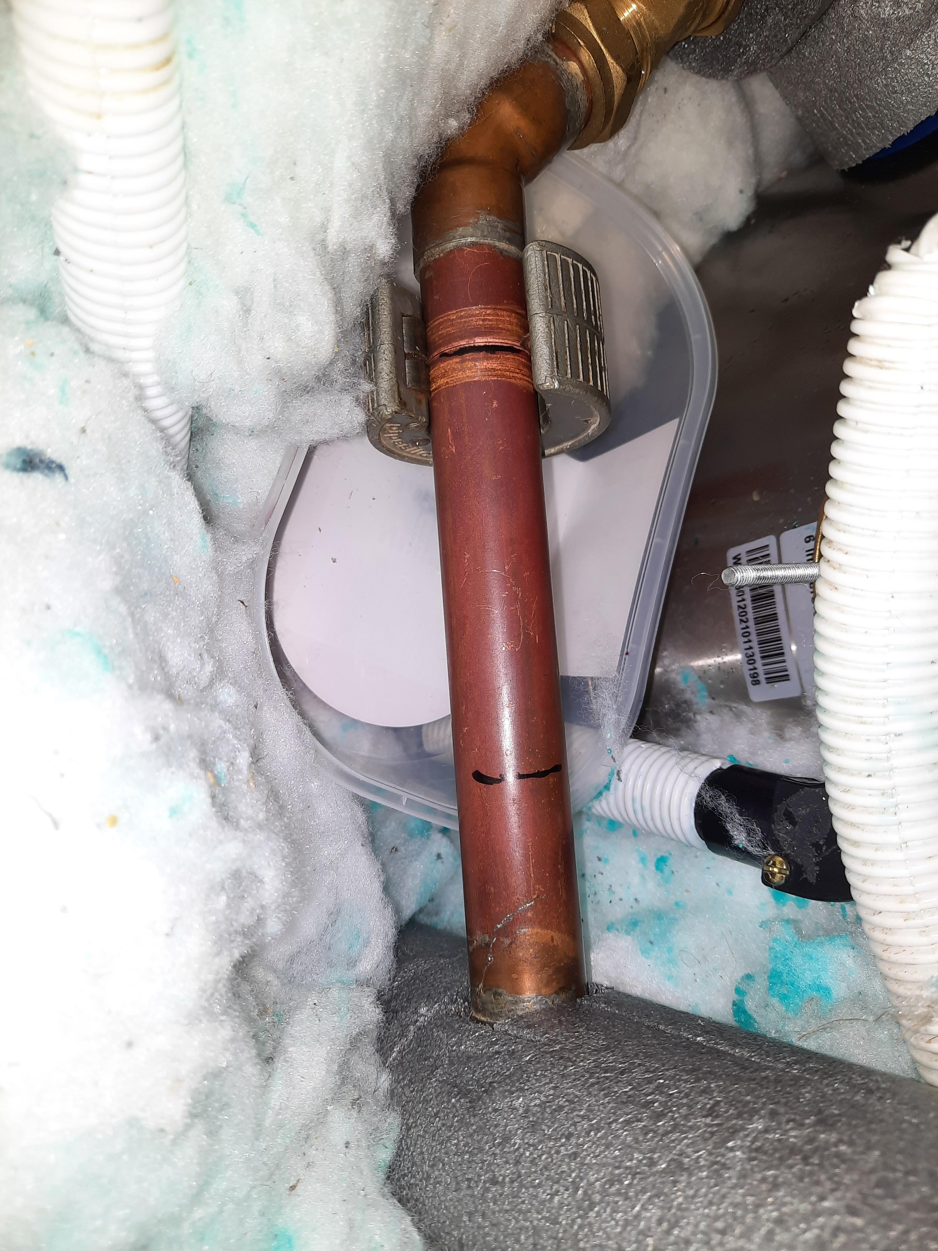

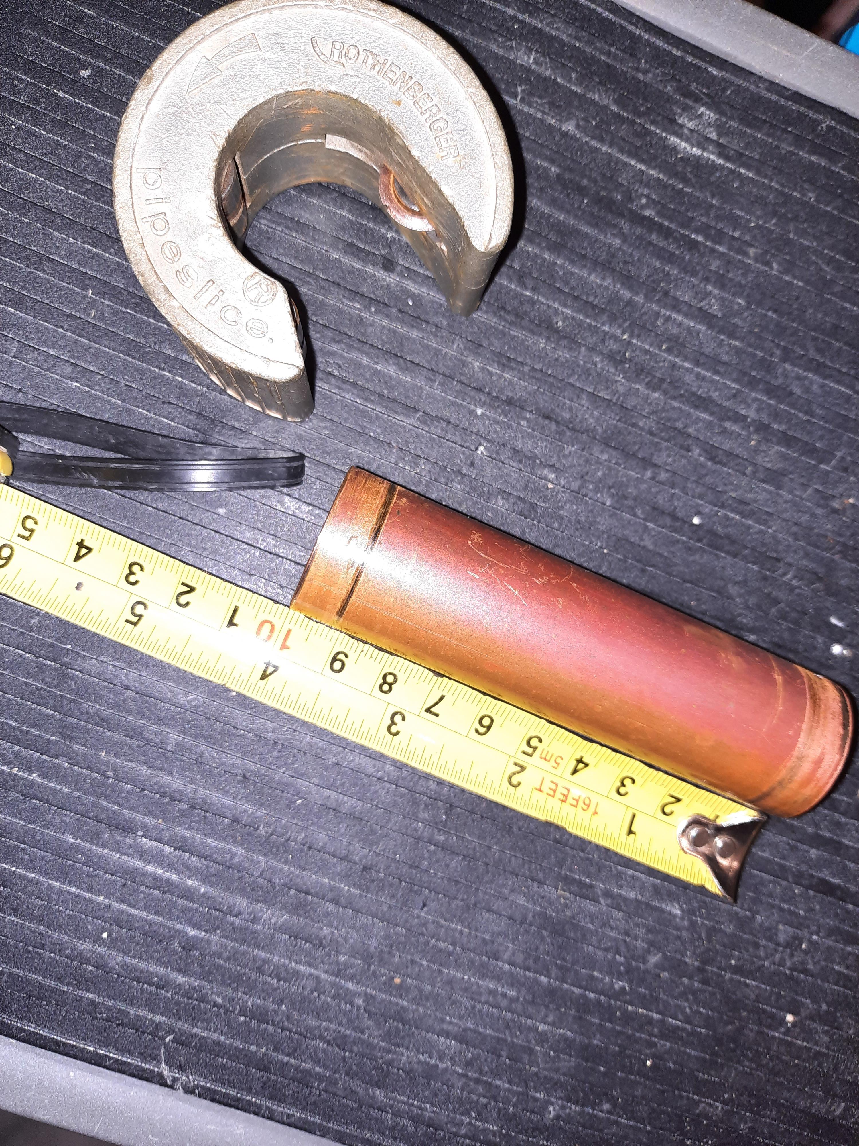

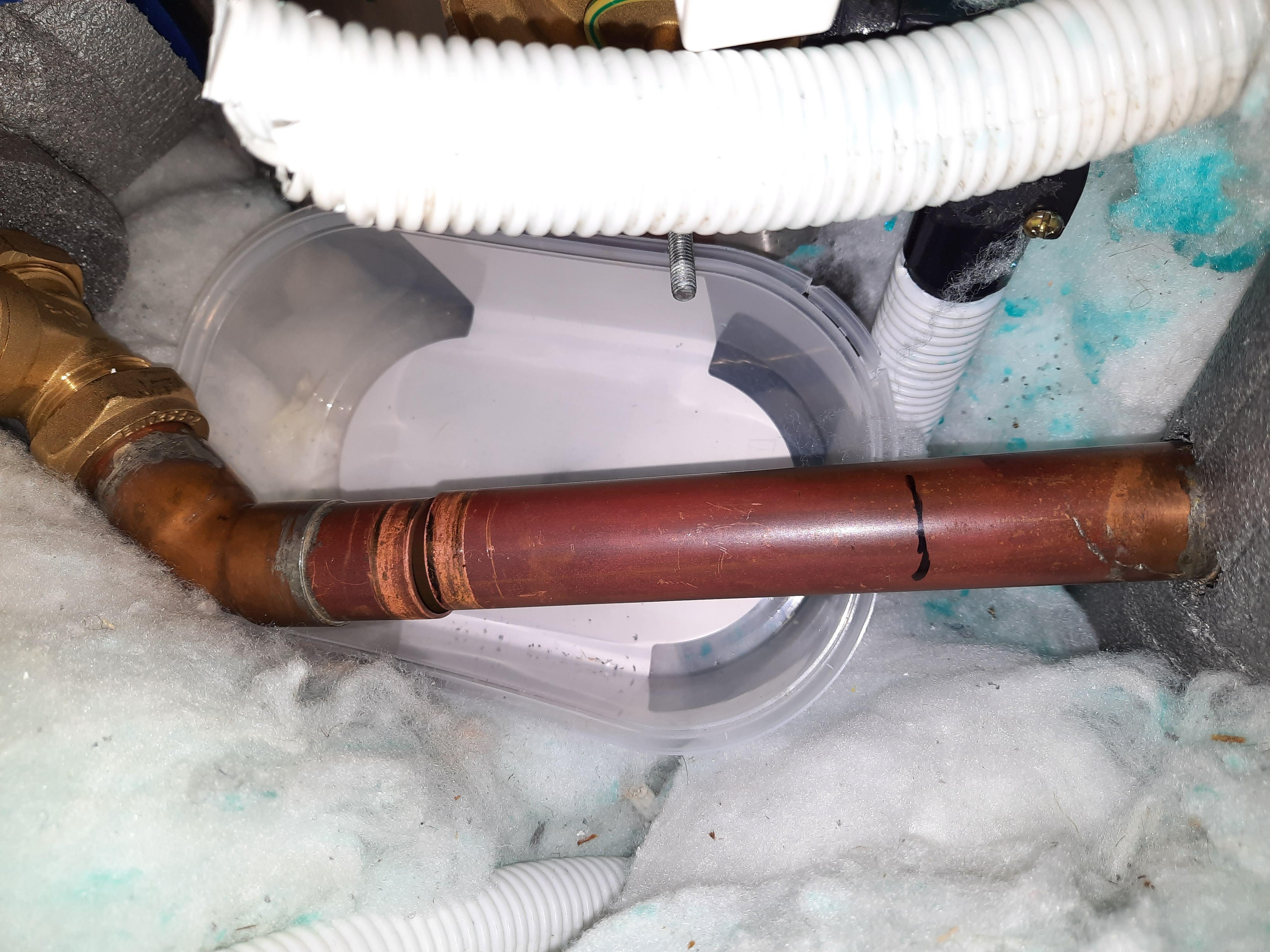

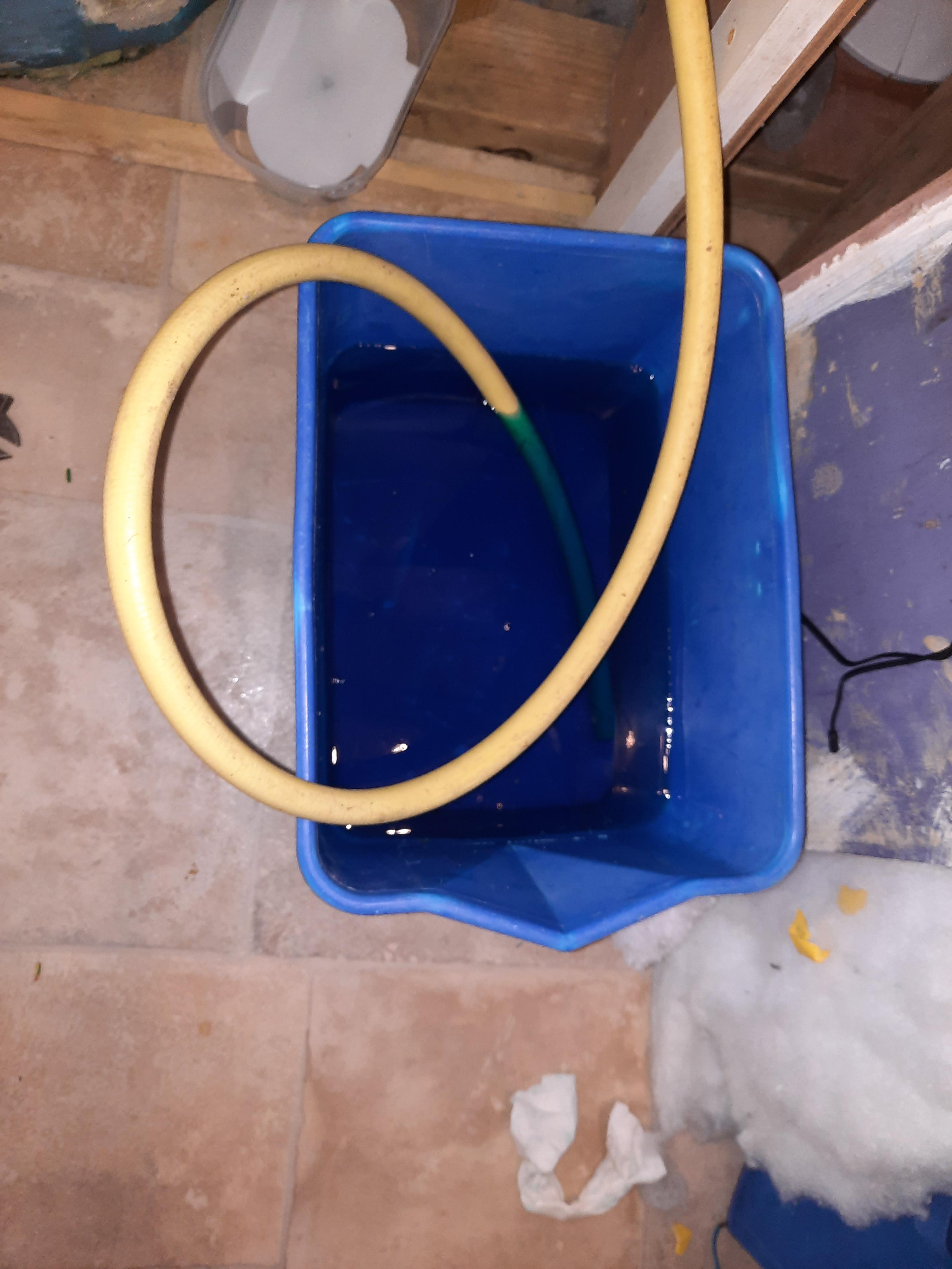

Marvin Posted July 9, 2022 Author Share Posted July 9, 2022 (edited) Because I had already put in a load of gate valves I only need to drain about half s bucket from the primary circuit. However the straight piece of pipe after the buffer tank valve is only 185mm long. Not a lot of room.... The valve is just about short enough to fit. Minus the ends of the pipe that slot in I need to cut out 100mm but at least 25mm from any fitting. Here we go.... Rough marks Cut one end Making sure that the piece is 100mm as calculated,cut the other end. Pray that it is right because unlike 15mm or to some degree 22mm pipe, 28mm is very unforgiving if you cut the length or angle wrong! Phew! Edited July 9, 2022 by Marvin Link to comment Share on other sites More sharing options...
markocosic Posted July 9, 2022 Share Posted July 9, 2022 Thermosyphon up the return pipe Link to comment Share on other sites More sharing options...
Marvin Posted July 9, 2022 Author Share Posted July 9, 2022 9 minutes ago, markocosic said: Thermosyphon up the return pipe I think that is part of the problem because of the large bore of the pipe and the height f the buffer tank above the hot water tank. Link to comment Share on other sites More sharing options...

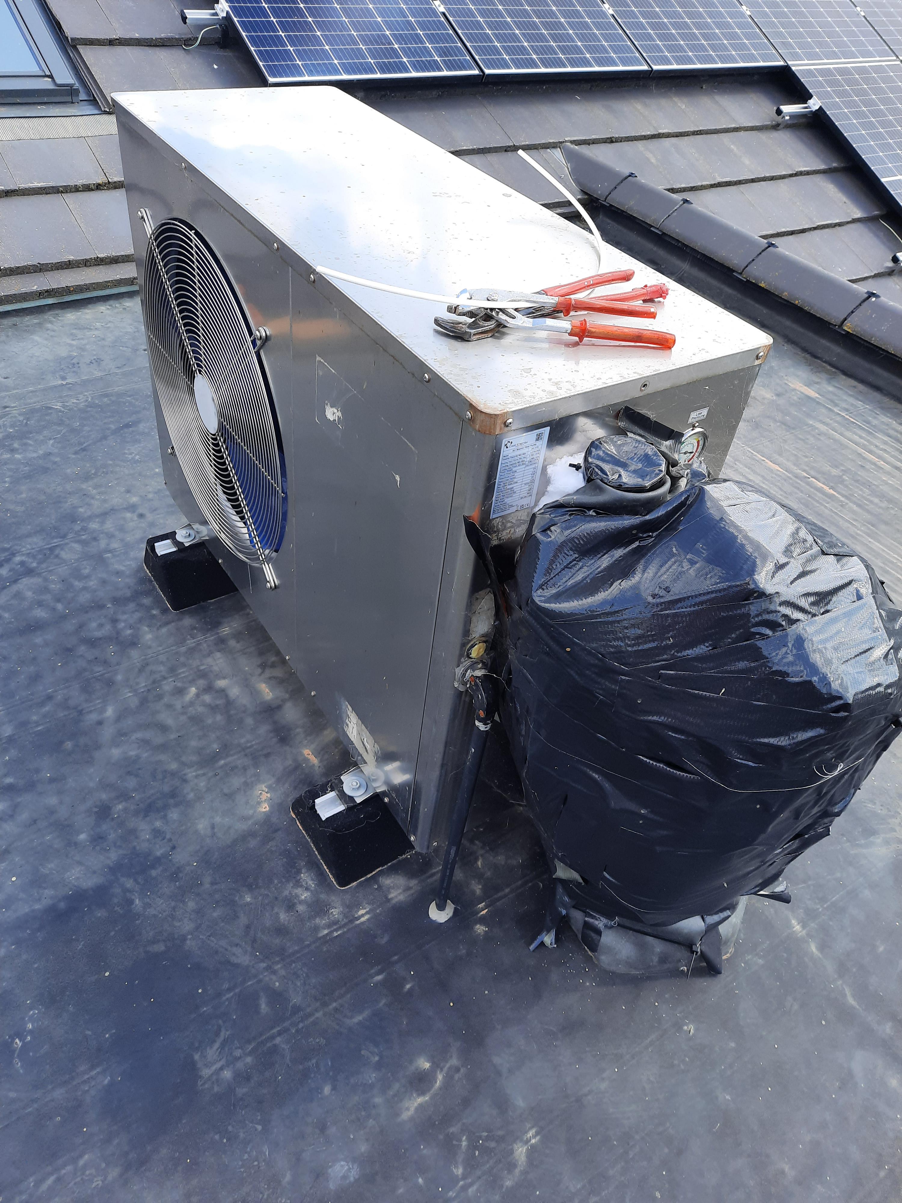

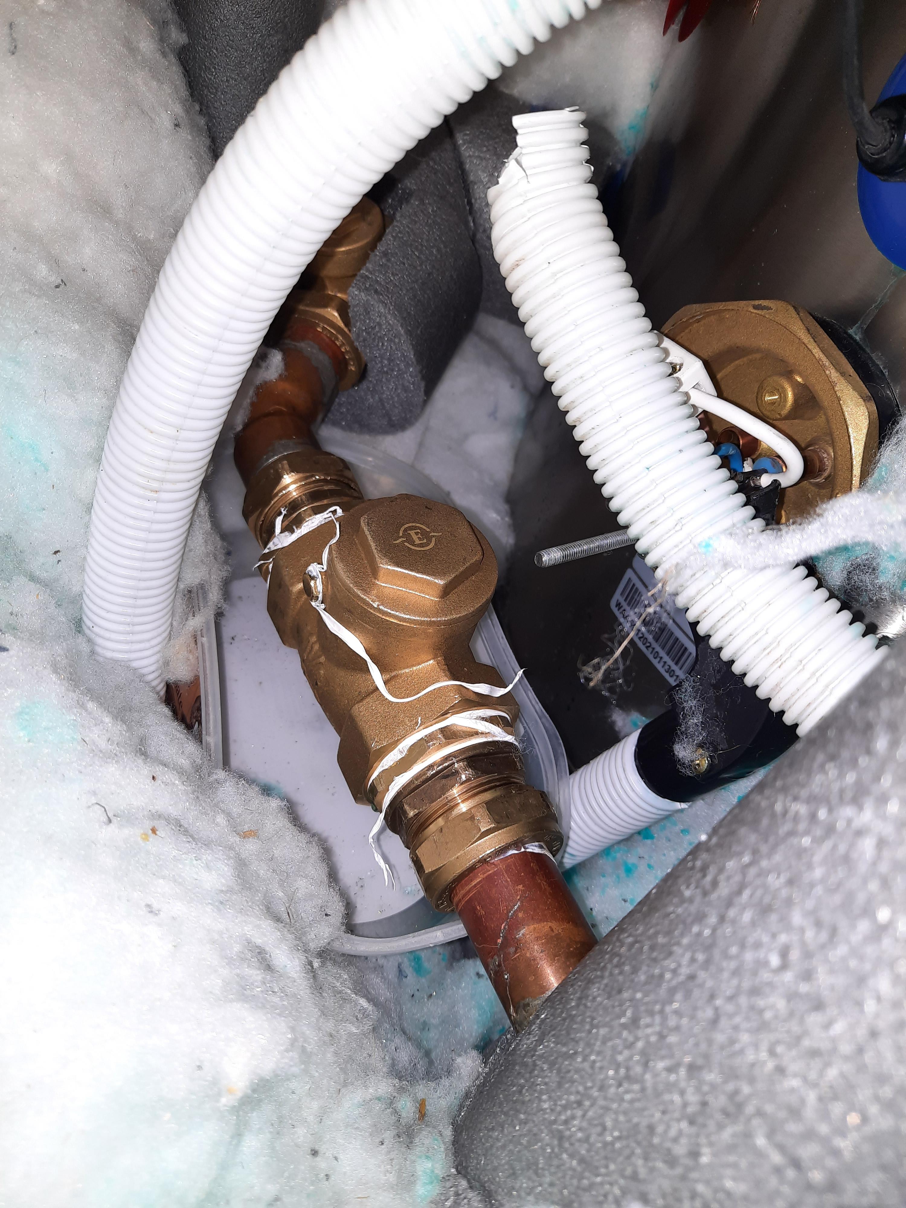

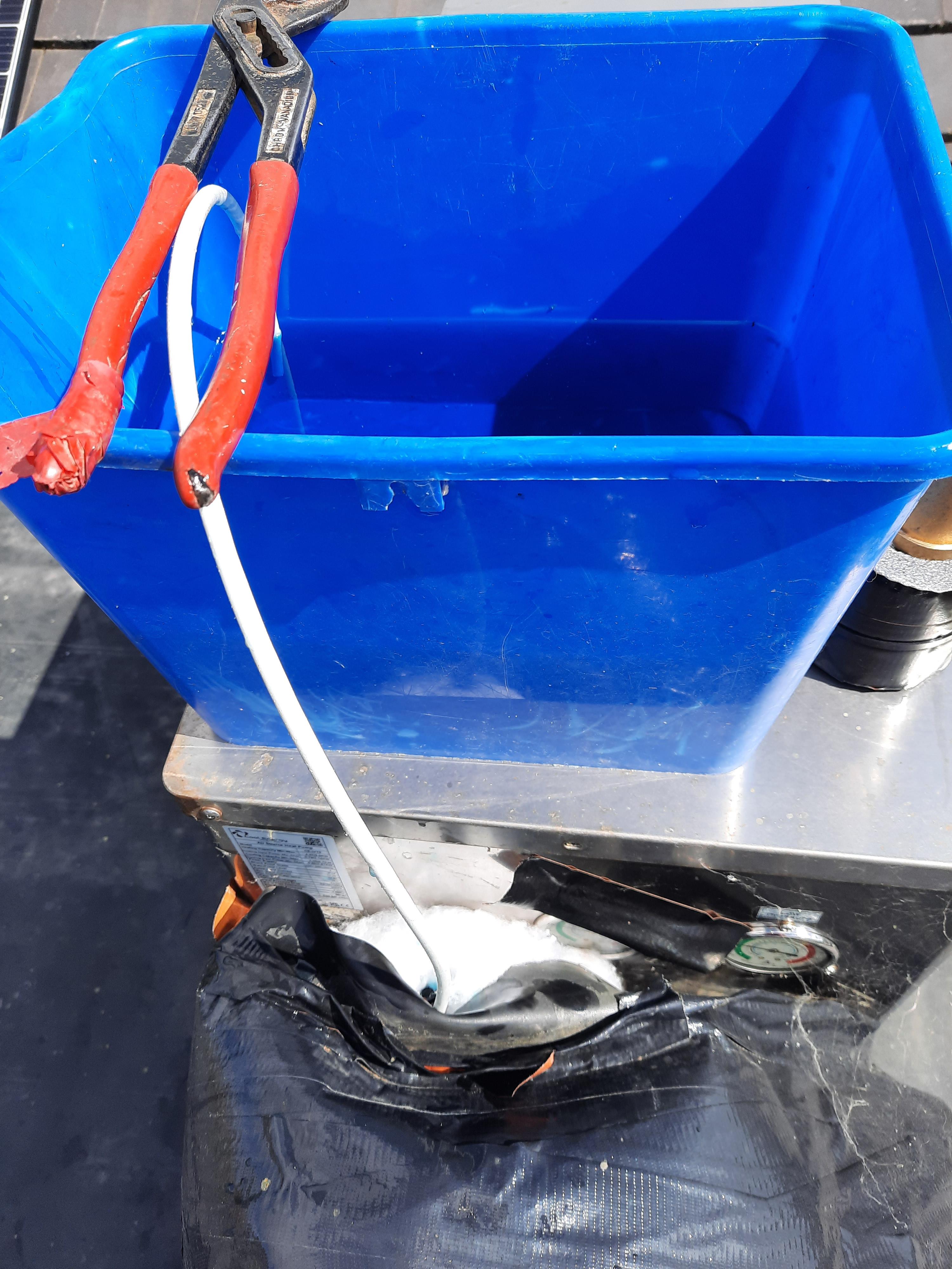

Marvin Posted July 9, 2022 Author Share Posted July 9, 2022 With the anti gravity valve fitted... Now it’s time to refill the system. With the ASHP unit the highest point this means filling from on the flat roof... 1 Link to comment Share on other sites More sharing options...

SteamyTea Posted July 9, 2022 Share Posted July 9, 2022 19 hours ago, Marvin said: Decided to fit an anti gravity valve.... this will be fun! Must put it in facing the right direction.... Gravity works in all directions, why it is a vector. Link to comment Share on other sites More sharing options...
Marvin Posted July 9, 2022 Author Share Posted July 9, 2022 1 hour ago, SteamyTea said: Gravity works in all directions, why it is a vector. Well I don't know everything, but I think it's because the flap inside the fitting hangs down. Link to comment Share on other sites More sharing options...

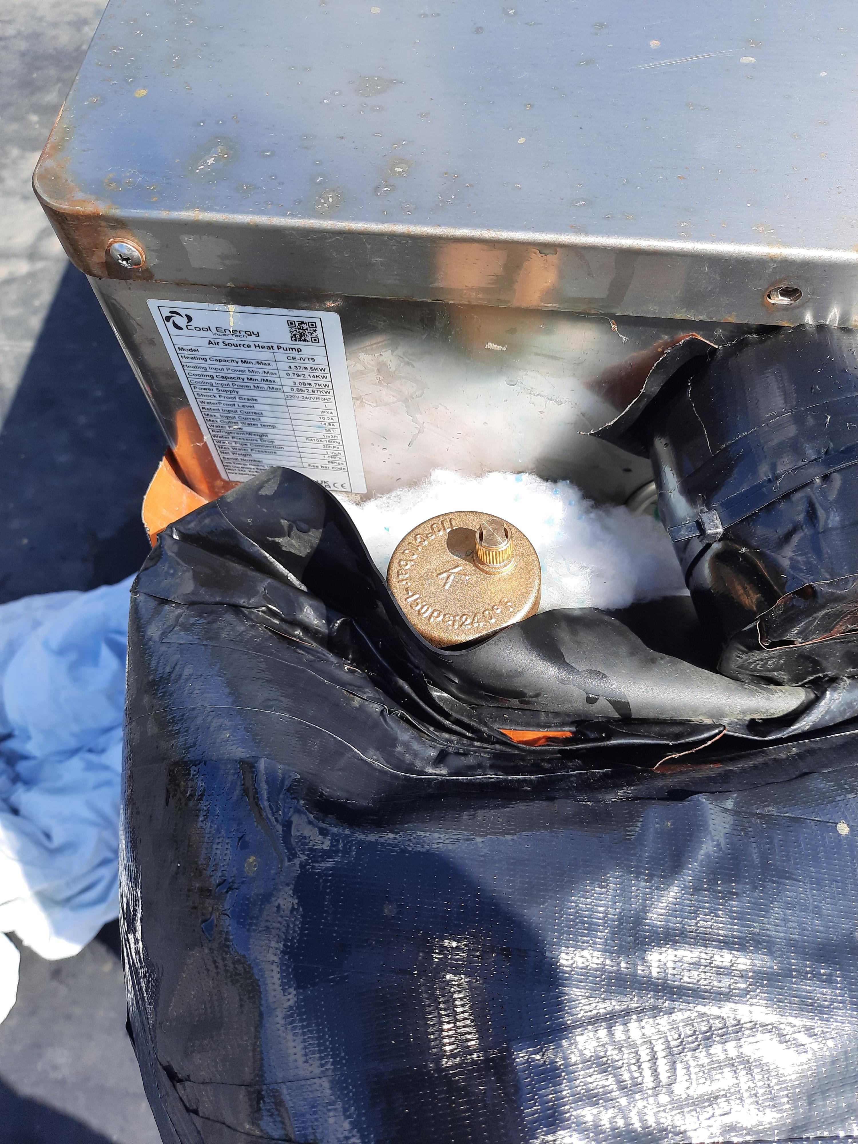

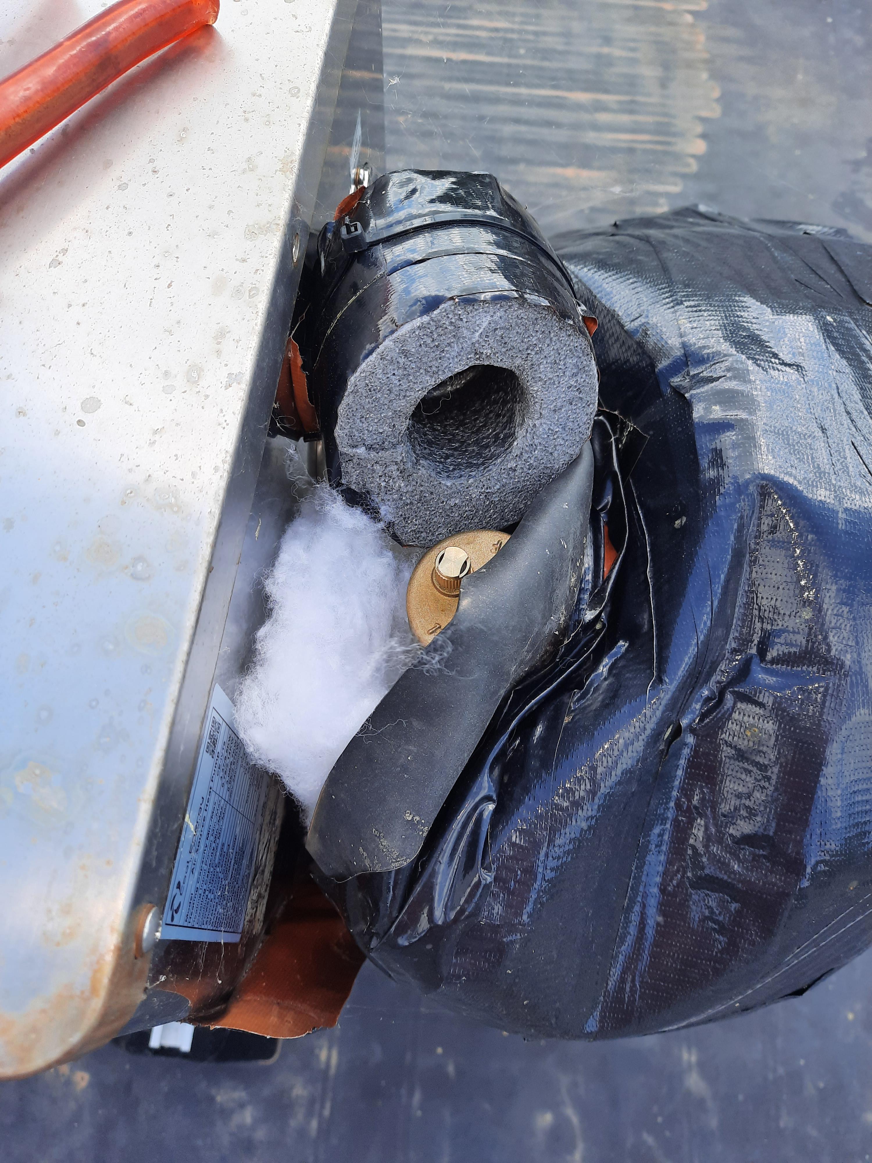

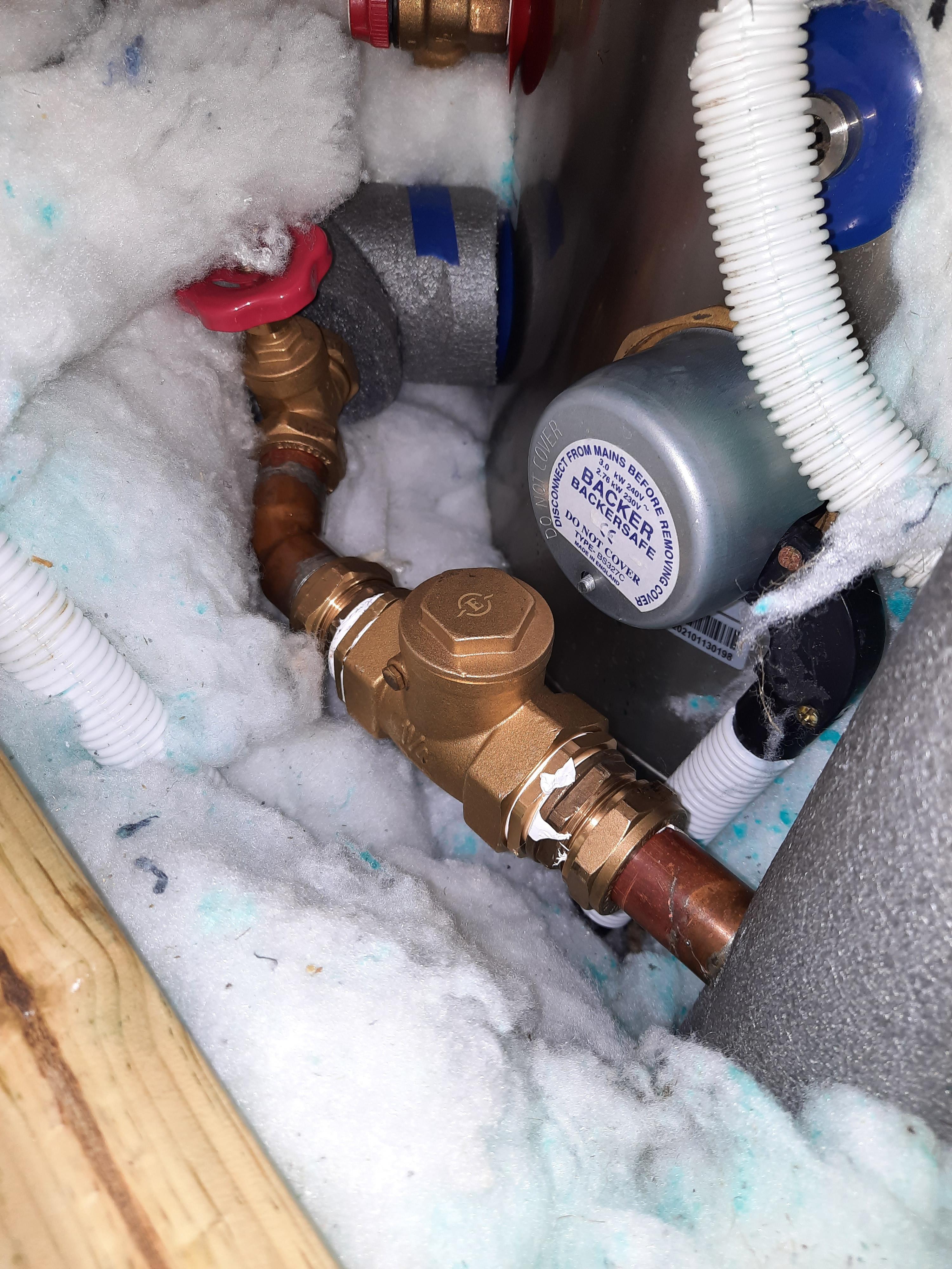

Marvin Posted July 9, 2022 Author Share Posted July 9, 2022 Yes the primary pipes outside the thermal envelope are well insulated. Removing the bleed valve cover. Refilling after removing bleed valve. Valve replaced. However after testing the new valve I found some of the thread joins leaked. I shut everything off to sort this out. I undid the brass fitting a few turns and added 3 miles of PTFE and did them up again. Pressure tested and passed this time. Well the filling is done! Now to test the cooling.. Link to comment Share on other sites More sharing options...

markocosic Posted July 9, 2022 Share Posted July 9, 2022 Is that dirt or corrosion on the top cover of the monobloc? Thermosyphon can happen within a single pipe btw; it doesn't need the flow pipe to be open from cylinder to buffer though that would definitely help matters! Link to comment Share on other sites More sharing options...
dpmiller Posted July 9, 2022 Share Posted July 9, 2022 corrosion, but it pretty much wipes off. Suspect their flap wheel has some mild steel residue on it as only refinished surfaces show it... Link to comment Share on other sites More sharing options...
kommando Posted July 9, 2022 Share Posted July 9, 2022 5% phosphoric acid solution will remove the rust stains and change any iron/steel particles to iron phosphate, so stopping the stains from reappearing. Apply using a nylon scouring pad, polish after with chrome polish if the dulling from the nylon grates. Link to comment Share on other sites More sharing options...
HughF Posted July 9, 2022 Share Posted July 9, 2022 Rust on the corners where they’re welded up. Heat from welding causes a reduction in the chrome content and hence the stainless part. Electrolytic weld cleaning or pickling paste is usually used to restore the stainless part, post welding. 1 Link to comment Share on other sites More sharing options...
Marvin Posted July 12, 2022 Author Share Posted July 12, 2022 After a lot of testing the conclusion is that the pipes out to our radiators which run in the loft heat up and are heating up the buffer tank water. There was no significant loss of temperature in the hot water tank over night and the increase in temperature in the buffer tank was greatly reduced. The radiator pipes are all under at least 300mm of fluffy and thick pipe insulation. This brings me to the problem of the hot roof in summer. I have added another roof vent at the ridge/gable end of the roof to get more airflow. I noted a couple of days ago that the loft was 15C hotter than the air temperature outside. I'm thinking of setting up a fan on the loft end of the vent with a thermostatic relay to come on when over 25C..... Can't see why not.. M Link to comment Share on other sites More sharing options...
