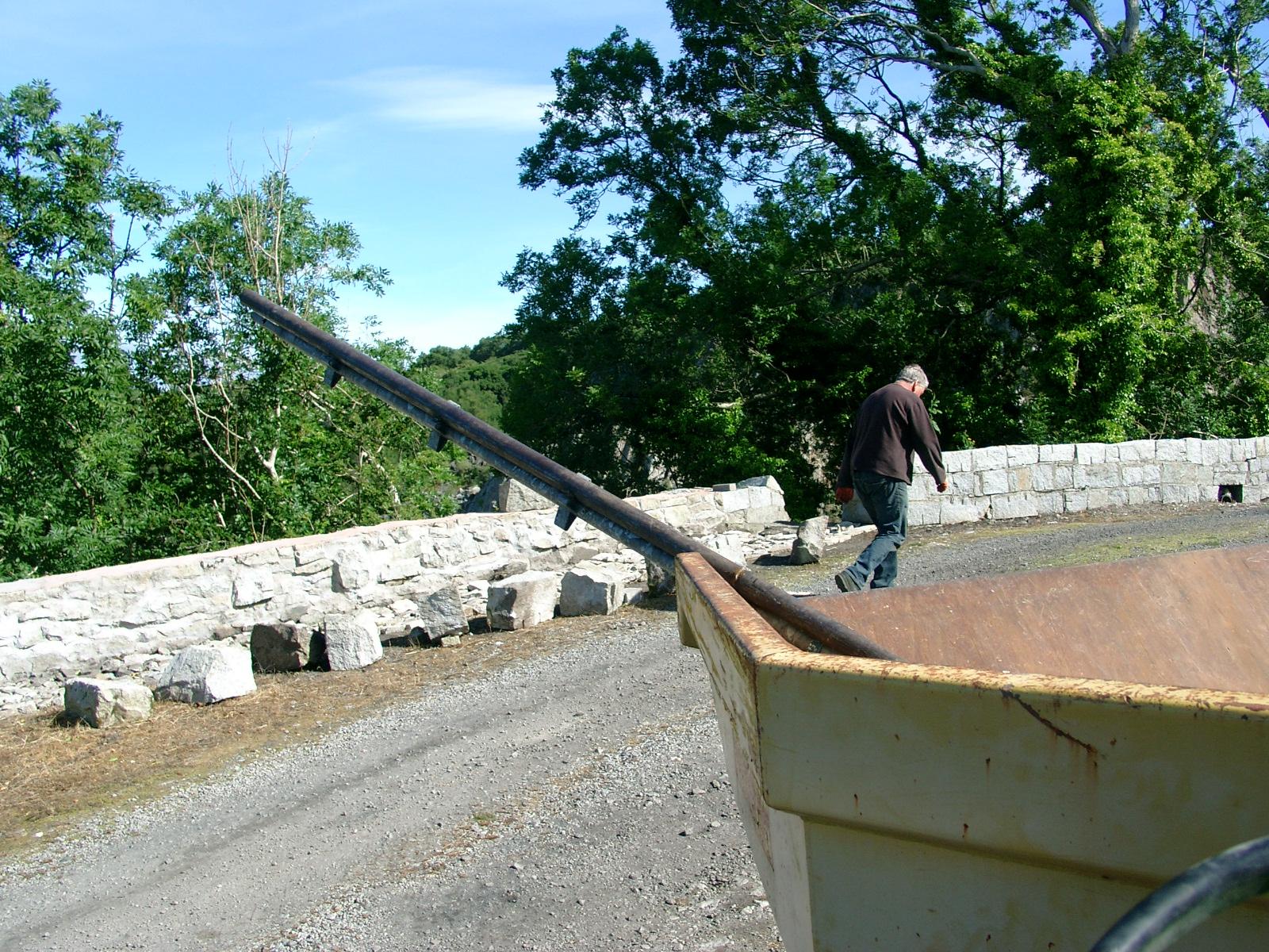

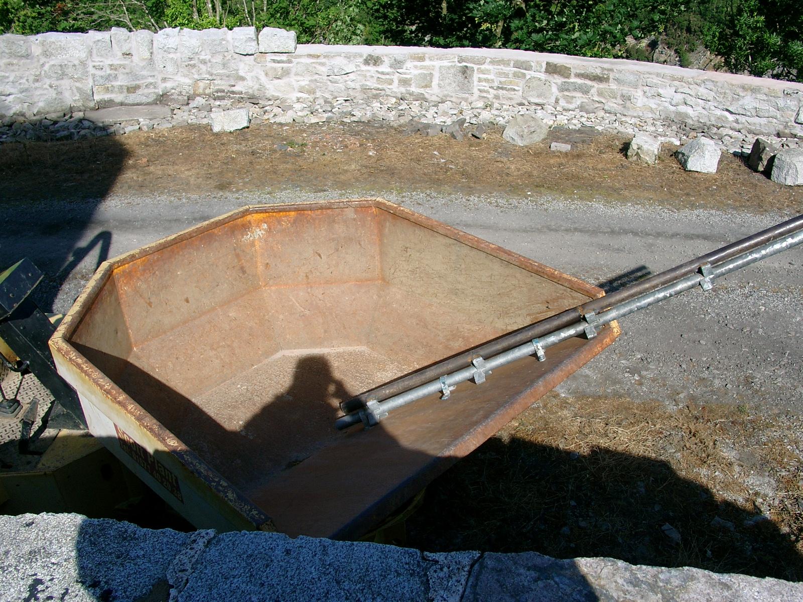

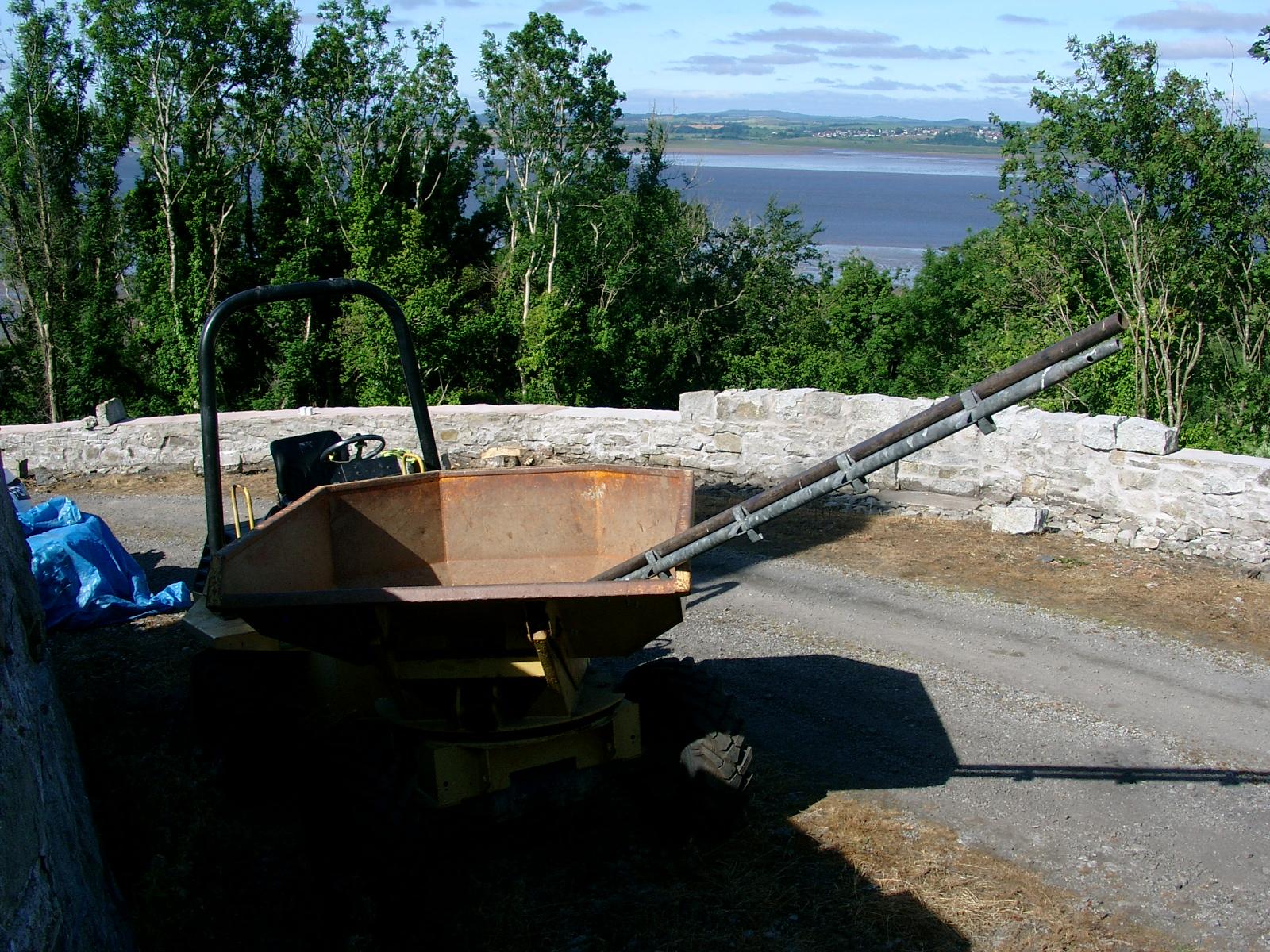

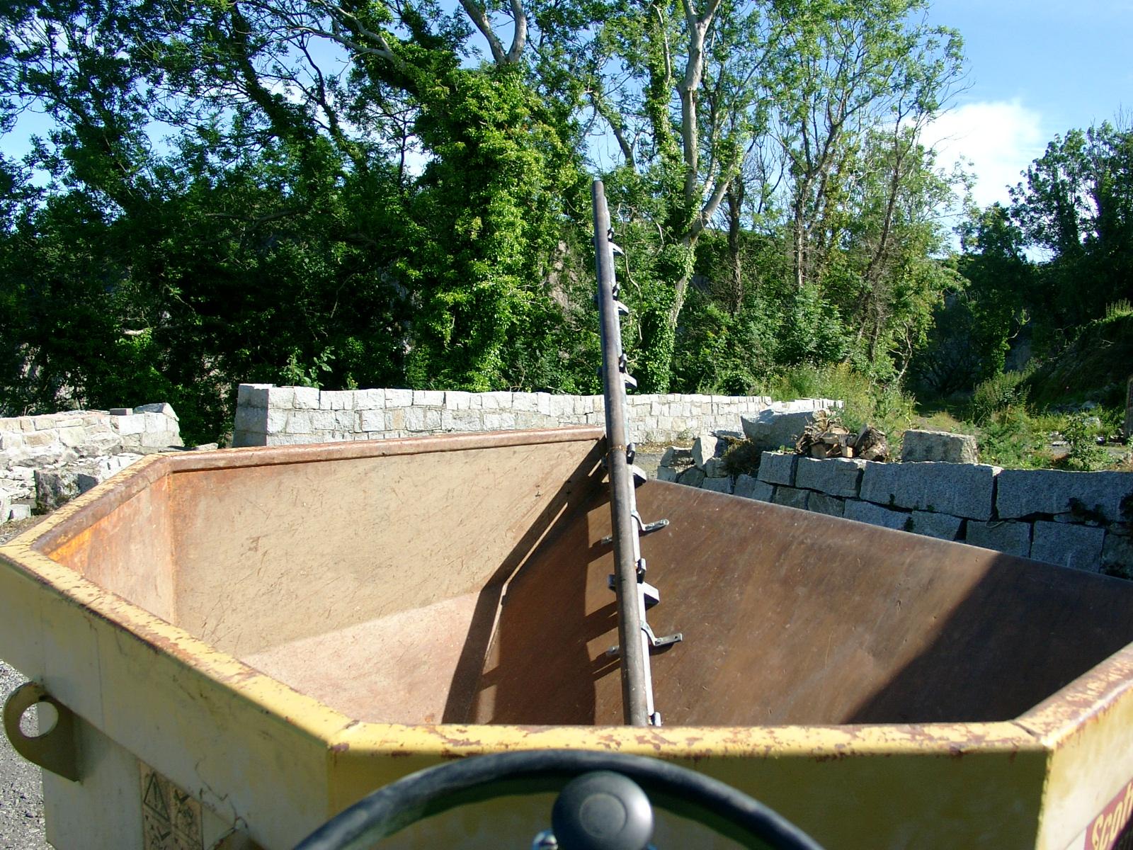

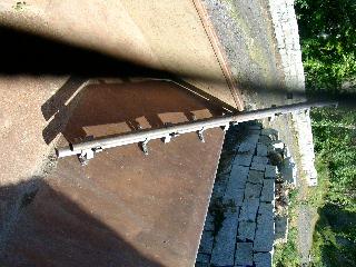

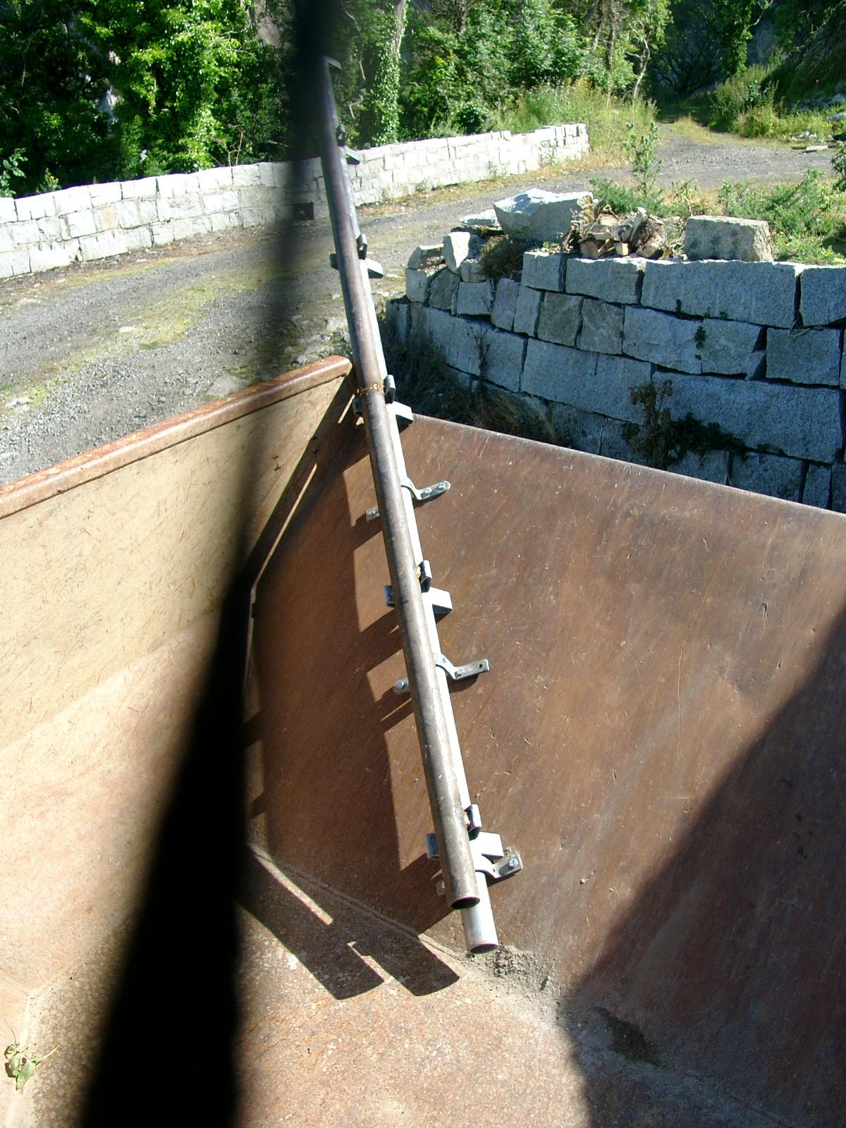

scottishjohn Posted July 7, 2022 Author Share Posted July 7, 2022 (edited) dumper converted and working well consists of a kwickstage upright 10ft with a length of thick walled steam pipe tack welded to the scaffolding pole brackets ,so I can reclaim the pole when done and bolted with brackets to the dumper at one corner -so i can still use it if needed in the mean time dumper can still tip fully ,pole end is close to ground when tipped It lifts every stone i have tried so far with no bending or even flexing average granite stone size I have been moving about is 700mm x 350m x 350mm. the capping stones for my big long wall. taking down wall to repair and rebuilding with morter ,not just dry so far 12t of sand 70bags of cement and only about half way will post pictures at some point Edited July 7, 2022 by scottishjohn 3 Link to comment Share on other sites More sharing options...

scottishjohn Posted July 9, 2022 Author Share Posted July 9, 2022 this mornings pictures of dumper and attaxhment 3 Link to comment Share on other sites More sharing options...
