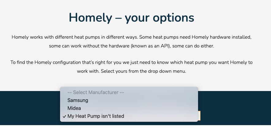

joth Posted July 21, 2022 Posted July 21, 2022 On 24/06/2022 at 13:50, HughF said: 6 (Leaving the best till last). Homely, by Evergreen energy - wow, this is a game changer. A modbus enabled, IoT based, smart thermostat and heat pump controller that takes control of a wide range of modbus controllable heat pumps and will optimise the flow temp and operating times depending on occupancy, weather, solar gain, predicted weather for the coming 24hrs, TOU tarrif data from the tarriff provider, storage battery %SOC, etc etc. It can automatically commision Midea and Samsung units over modbus and provides a full app for the end user to setup their schedules and temperatures. It has an indoor light/temp/humidity sensor that allows the unit to automatically setup the weather comp curves for a property, no installer callbacks, no fiddling by the user. I was very impressed with this and can see it being of real benefit to end users. They are going to enter a line of communication with Cool Energy to add support for their units. This does sound very interesting and full of promise, although the reality of it today is somewhat short of this with only 2 (relatively minor) heat pump manufacturers supported. Also the lack of any API or expansion possibilities in Homely itself (but coming with its own mobile app) means you're just trading one manufacturer's walled garden for another. (in fact, by their own admission the ASHP may have a more open API than they themselves are offering). In a complex home with heating, A/C, automated blinds and stack venting, and perhaps even MVHR bypass control, there's no point installing Homely to fully control the ASHP if it just ends up in fight with the other systems. To succeed Homely needs to open up new integration possibilities, not close them off.
HughF Posted July 22, 2022 Author Posted July 22, 2022 On 21/07/2022 at 12:19, joth said: This does sound very interesting and full of promise, although the reality of it today is somewhat short of this with only 2 (relatively minor) heat pump manufacturers supported. Also the lack of any API or expansion possibilities in Homely itself (but coming with its own mobile app) means you're just trading one manufacturer's walled garden for another. (in fact, by their own admission the ASHP may have a more open API than they themselves are offering). In a complex home with heating, A/C, automated blinds and stack venting, and perhaps even MVHR bypass control, there's no point installing Homely to fully control the ASHP if it just ends up in fight with the other systems. To succeed Homely needs to open up new integration possibilities, not close them off. I think the target customer is the person who has an average house, and just wants a smart thermostat. And/or installers who don’t want to have to come back and tweak the weather comp curves, or try and get the customer to do it from an archaic controller. Because it is smart, it can learn the thermal response of the property and the emitters, therefore it can offer load comp on heatpumps that don’t have it in their native controller and then revert to weather comp automatically if the property is permanently occupied. It can also make a decision based on energy pricing at the time that heat is called for. yes it is another walled garden but having in essence an iot modbus interface to the heat generator, and controlling the flow temp from the smarts in the cloud, I can really see the opportunity for optimum control and cost savings. I agree that more integrations would be good and from talking to their engineers on the stand, they were totally on board with adding more heat pumps to the list. Midea and Samsung are supported for now because Graham Hendra consults for them. They were happy to talk to cool energy about adding support their carel based units.
