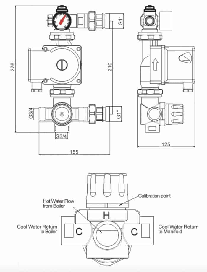

Moonshine Posted June 23, 2022 Author Posted June 23, 2022 17 minutes ago, PeterW said: Pump won’t fit in a stud wall. I have the oppotunity to make the cavity deeper, this pump looks 125mm if i made the cavity 140mm could i fit the manifold and pump in?

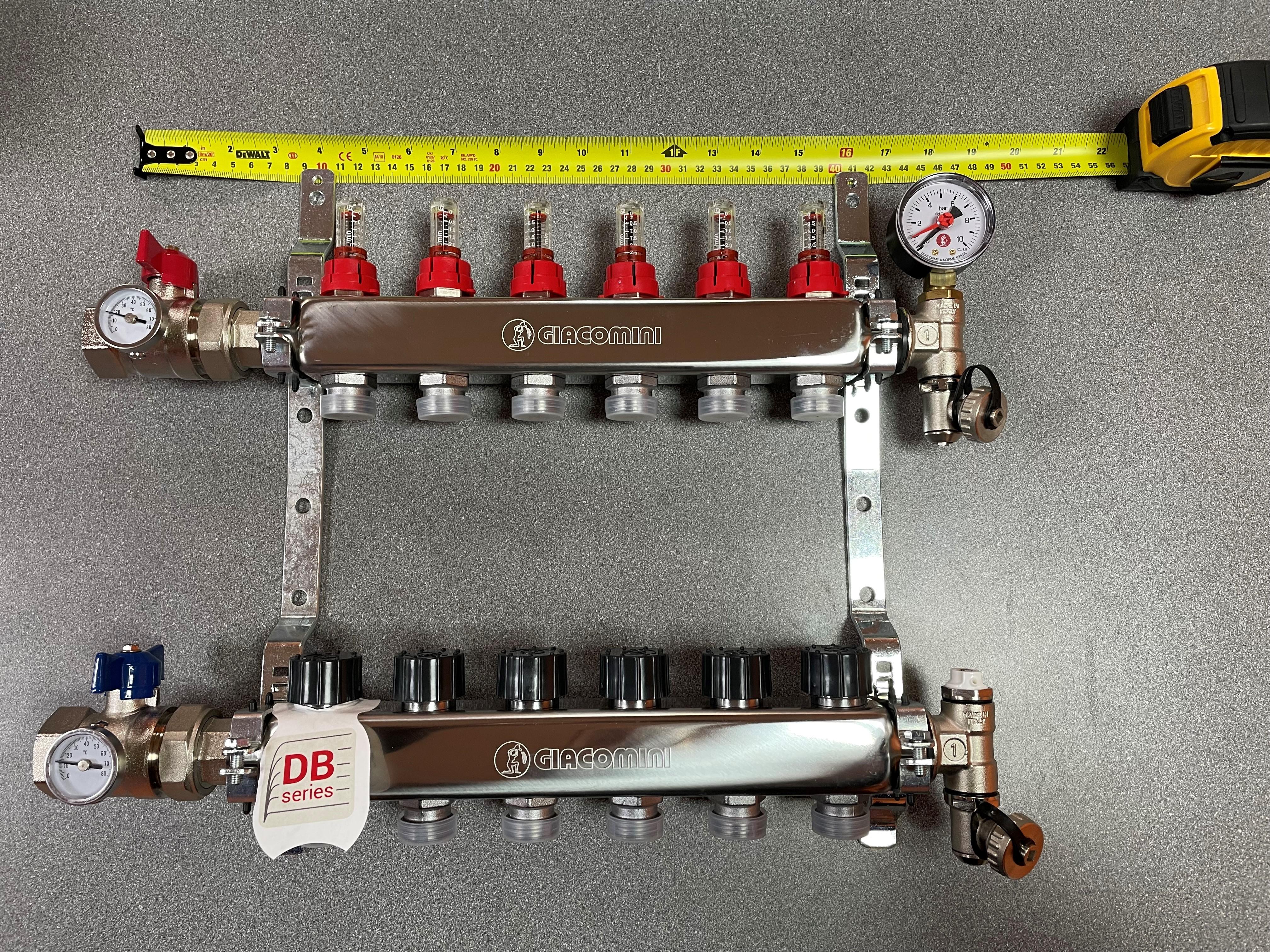

TerryE Posted June 23, 2022 Posted June 23, 2022 23 minutes ago, Moonshine said: Has anyone installed a manifold in a studwork wall cavity before with an access hatch. I am using 89mm studwork As Peter suggests this doesn't really make sense practically. The manifold might only be 50cm wide but you've got the pump return on the LH side so you are going to have to cut out at least one stud vertical which will then need cross bracing top and bottom and the bottom bracing will then impede the UFH out and return runs. Have you got 60 or 40cm stud centres? If 40 then getting it in is going to be problematical. OK if you really want to lose your UFH out and return runs within the studwork, then you may be able to notch back the CLS uprights to 40mm and brace/support the two cutouts sections lengths of CLS at 90°. That would allow you set back the manifold and pump 50mm or so and allow the UFH pipework to run cleanly within studwork, but then so you will still need to box out the manifold and pump area with a shallow cover maybe 80-100mm deep. Even so, this is all very tight and for very little gain IMO. Also heaven help you if you need to do any maintenance !!
ProDave Posted June 23, 2022 Posted June 23, 2022 I fitted one of mine in a void made for it about 160mm deep. To achieve that I rotated the pump for least protrusion forwards.

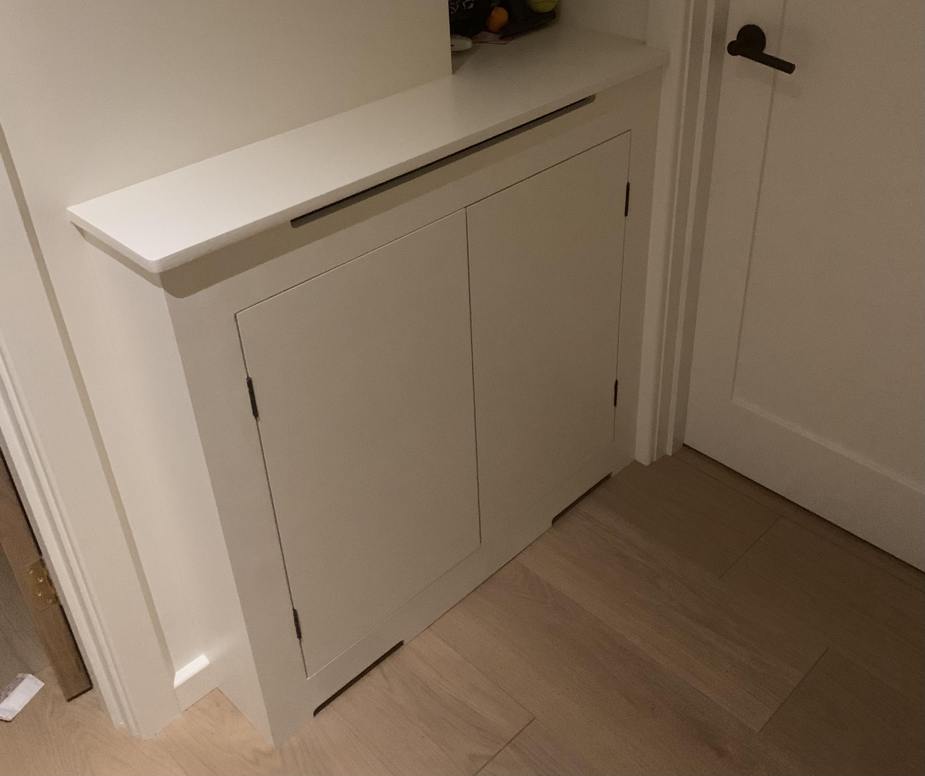

Adsibob Posted July 27, 2022 Posted July 27, 2022 Is the Location of your manifold already fixed? If not, consider moving it elsewhere, maybe on the other side of that same stud wall, and hiding it with a self made MDF cupboard like this:
