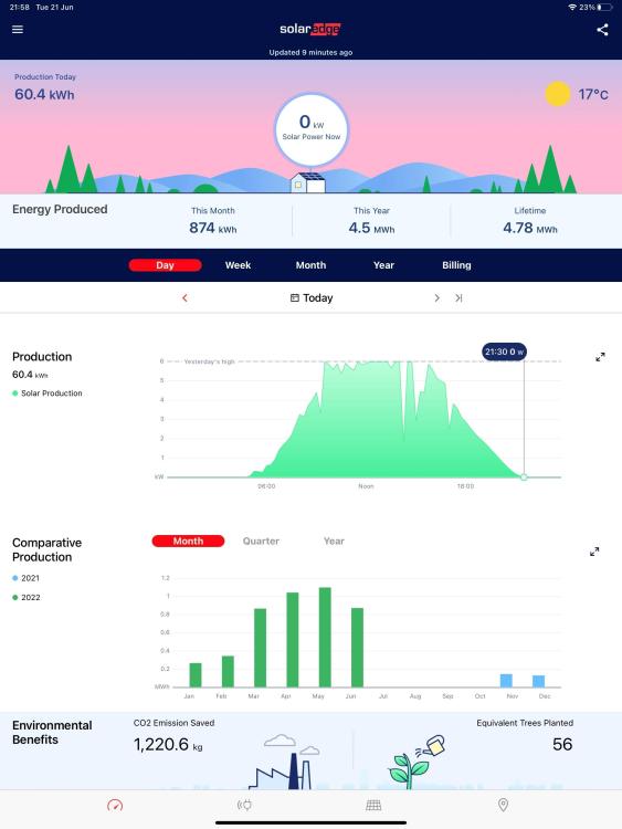

Johnnyt Posted June 21, 2022 Posted June 21, 2022 Here's my production profile for today 21 June. 10.02kW array over 3 orientations. God I wish I could get hold of that bloody Solar edge battery and DHW divert. You can see the clipping as my inverter is 6Kw but the benefit of the dc coupled battery is that the excess energy can do direct to the battery uninverted. Interested to see what other have produced today. 1

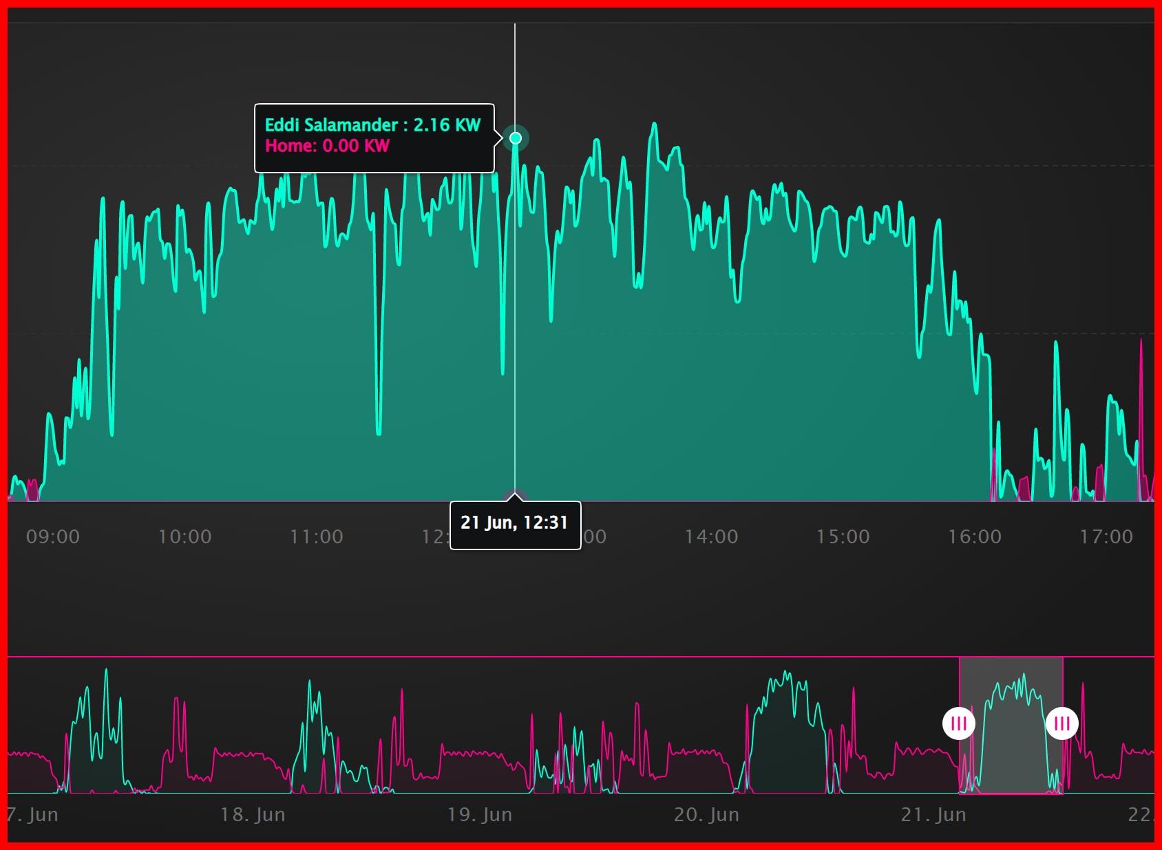

ToughButterCup Posted June 22, 2022 Posted June 22, 2022 21st June. 3.8kWp array - appears to have shunted 13.42kWh into our SunAmp ( its max capacity is about 13.7kWh). Luckily the SunAmp was 'empty' at the beginning of the PV generating period. I say ...appears to have... because I don't trust the Eddi data-reporting system.

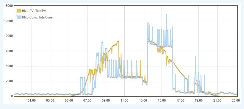

Wil Posted June 22, 2022 Posted June 22, 2022 I got 35kWh of solar yesterday. Accidentally exported 2.5kWh 14.5kWh went into the 300lt HW tank (was 80degC in the middle) 5.4kWh went into the Heating tank 5-6kWh went into the car The rest must have gone to running the house between 4am and 9pm when I was generating.

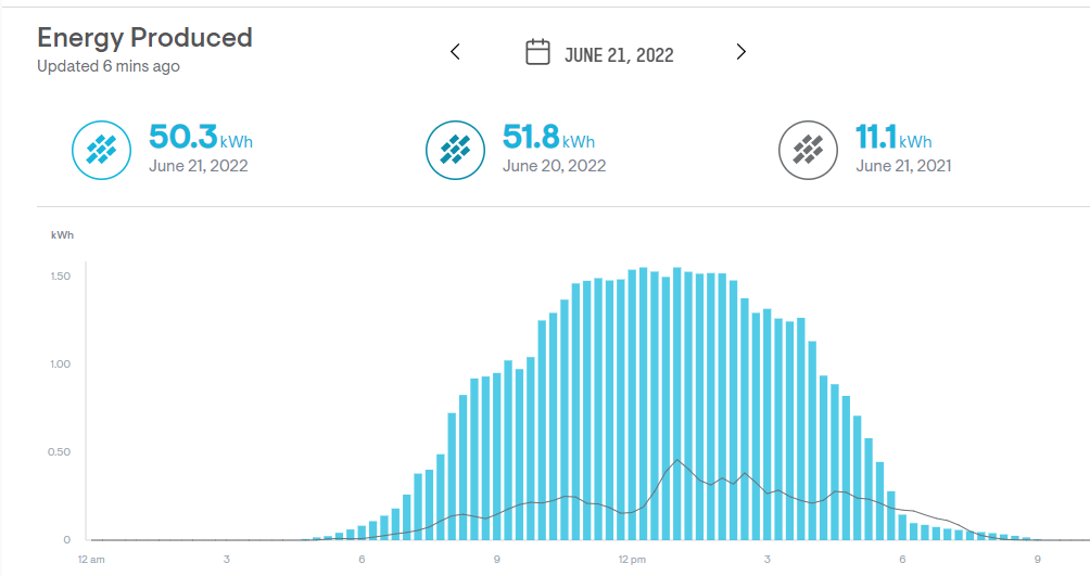

jack Posted June 22, 2022 Posted June 22, 2022 We have an 8.5 kW array with Enphase micro inverters, and managed over 50 kWh yesterday. Looks like about the third best day this year for us (best was 52.2 kWh on 14 June). Much better than the same date last year (the line on the same graph). 1

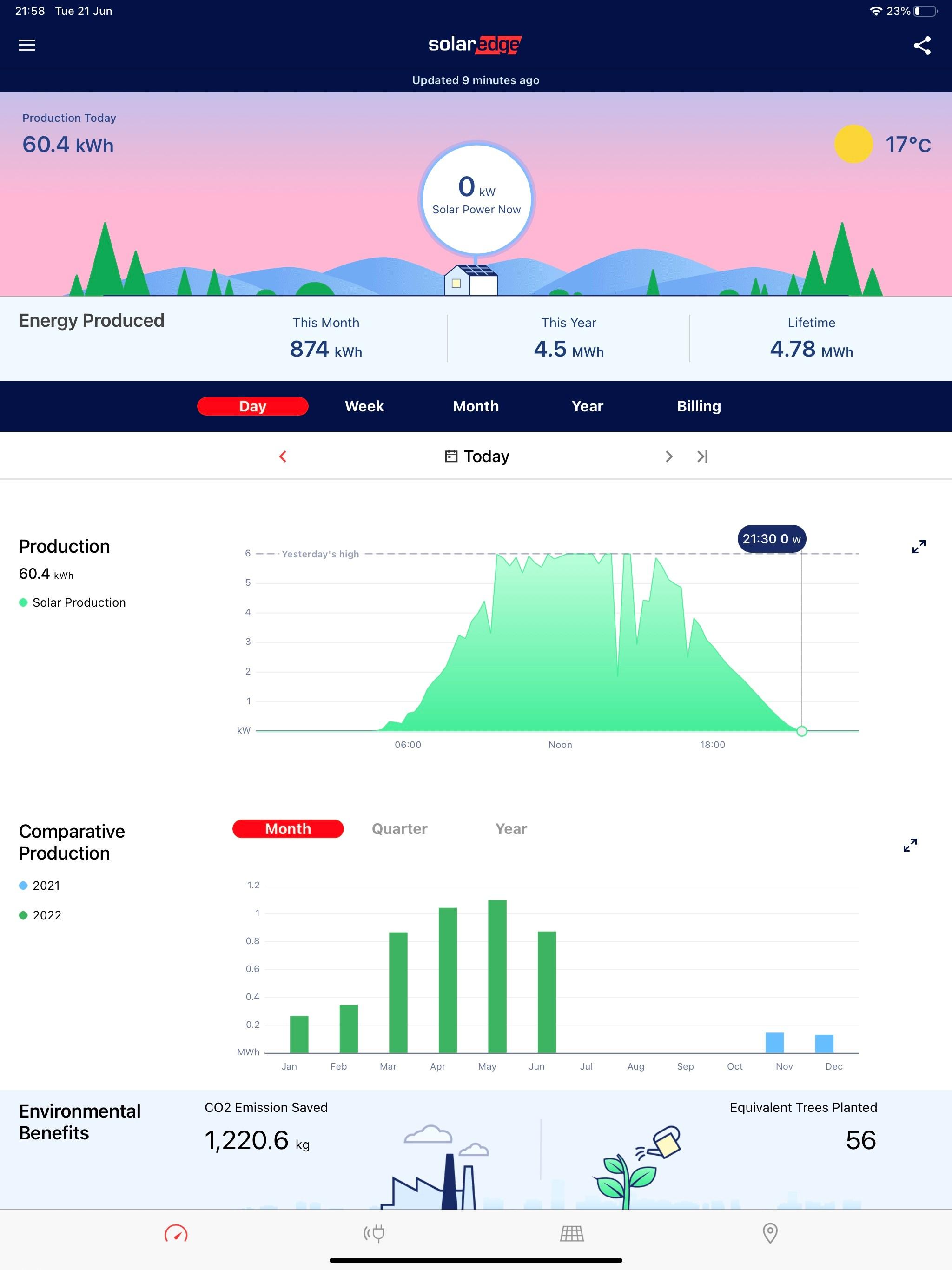

billt Posted June 22, 2022 Posted June 22, 2022 63kWh here. It could have been over 80 but the batteries were full at 10:30 and the inverters throttled back. However, only got 9.9kWhr on the 5th of June.
