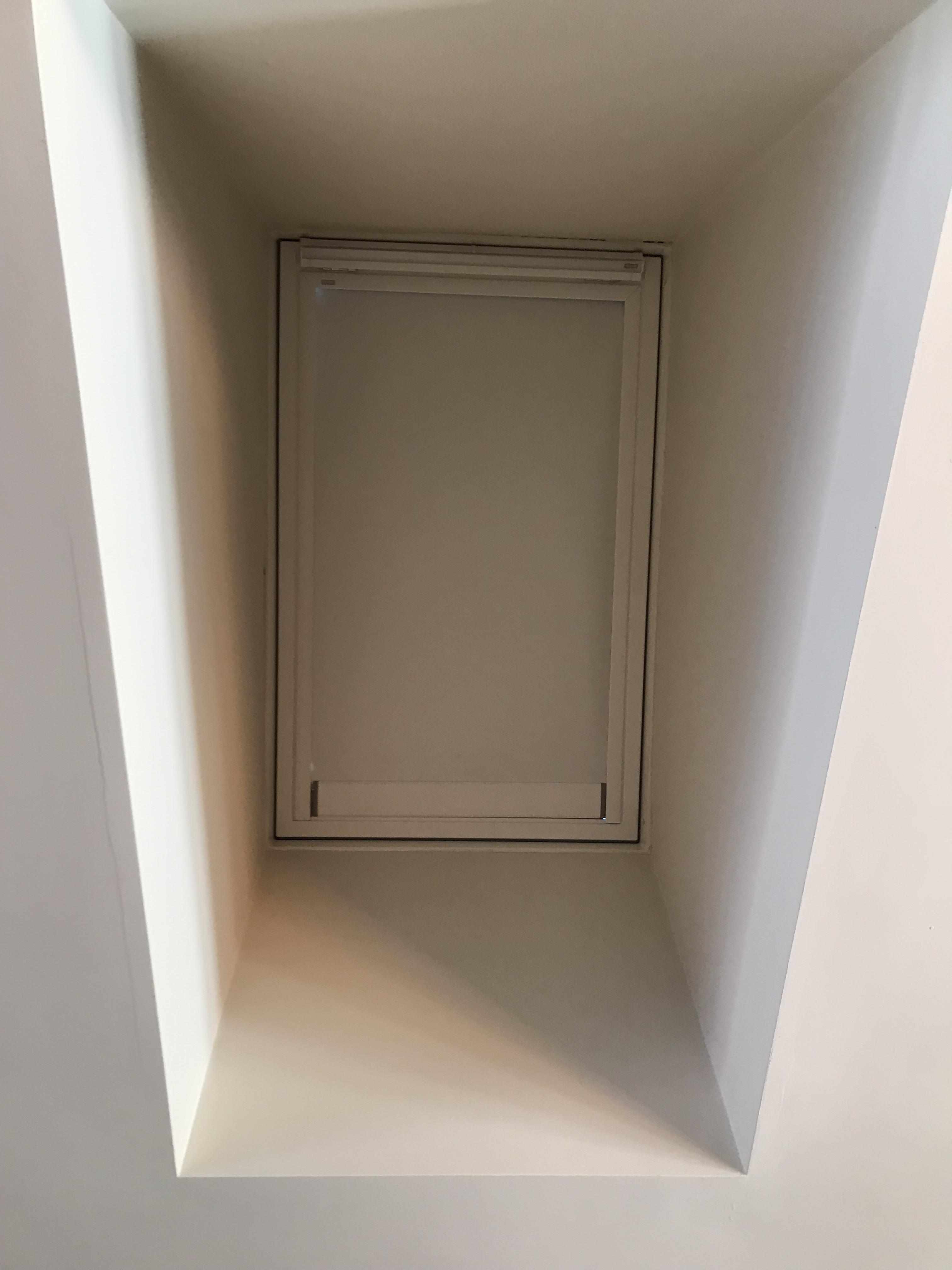

TonyT Posted July 10, 2022 Share Posted July 10, 2022 Velux solar powered blinds are good. easy to install rf remote control kit includes screwdriver for the 8 small screws that are required to be fitted. takes 10 minutes. 1 Link to comment Share on other sites More sharing options...
TonyT Posted July 10, 2022 Share Posted July 10, 2022 Forgot to mention these are internal blinds. Link to comment Share on other sites More sharing options...
Radian Posted July 10, 2022 Share Posted July 10, 2022 4 minutes ago, TonyT said: Forgot to mention these are internal blinds. Good to see an actual photo of those. I might be going down that route myself. My room in roof "fancy workshop" has six velux windows - three face SE and three NW. At the moment, if I don't open them all every day it goes well over 30C and stuff begins to melt. Link to comment Share on other sites More sharing options...
TonyT Posted July 10, 2022 Share Posted July 10, 2022 My windows are triple glazed GGU MK06. these are black out blinds colour 1025 side rail white aluminium product is dsl mk06 1025swl. 3 we’re £407 in total free delivery. roofblinds.co.uk Link to comment Share on other sites More sharing options...
