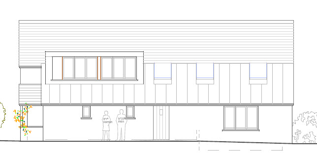

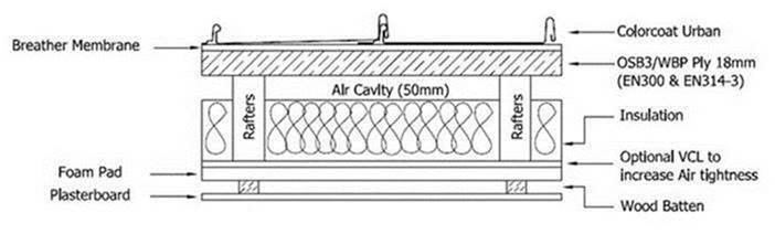

Barney12 Posted May 24, 2017 Posted May 24, 2017 (edited) We have specified the above for the North bottom section of our roof. Its a slightly unusual design (which I'm really regretting) as its a transition from slate to metal seam. I am absolutely pulling my hair out with them. It seems the sales person I was dealing with left the company and no one took on her workload. Her emails were just not answered and her mobile answerphone ignored! Great service!! NOT! Anyway I finally managed to make contact with someone new and despite another three weeks passing I'm still waiting for the answer to what I believe is a very simple question. I have a new promise of an answer by "midweek" but thought I'd ask the collective view of the forum as the MBC guys are going to start putting the bloody frame up next week! I have a recollection that @JSHarris had originally considered this product? My question relates to roof build up. The Tata technical manual shows this: So I have agreed with MBC the following: (From the inside out) 15mm Plasterboard (Client) 22mm Service Cavity Batten (MBC) Airtight Membrane (MBC) 225mm Rafter (MBC) Roofing felt (MBC) 50mm Counter Batten on Rafter (Supplier TBC) 18mm OSB3 Deck (Supplier TBC) Breather Membrane (Supplier TBC) (Note that between 3 and 5 above will be the insulation fill.) To my mind this provides what is required. What I would actually like to do is reduce the counter batten (no.6) to 25mm as the build up creates a kick from the tile to metal seam transition. Do others think this provides sufficient ventilation of the deck? Any thoughts hugely appreciated! I had even researched changing to another metal seam roof supplier but all the quotes I've had in are more than double that of the Tata product. Edited May 24, 2017 by Barney12
Jeremy Harris Posted May 24, 2017 Posted May 24, 2017 I did look at using Colorcoat Urban, but didn't get very far with them because the integrated thin film solar panel company went bust (they made self-adhesive flexible PV that fitted neatly to the roofing sheets. There was a very helpful lady at Tata, who was very good at getting information, as I recall. If she's left and they haven't replaced her then it doesn't surprise me that they're not able to be as helpful. Is the membrane at item 5 above vapour permeable? It needs to be, I think. The membrane at item 3 needs to be the VCL. Other than that it looks OK. I did get as far as confirming with Tata that fixing to OSB with a breather membrane was fine. They also offered a short course on installing the sheets, but having looked at the fixings I think it's a pretty simple system to get to grips with.
Mr Punter Posted May 24, 2017 Posted May 24, 2017 I think the 50mm is sensible and allows for insulation being uneven and the roof nails not penetrating the outer airtight membrane. Why not batten the tile section an extra 25mm?
Barney12 Posted May 24, 2017 Author Posted May 24, 2017 3 hours ago, JSHarris said: I did look at using Colorcoat Urban, but didn't get very far with them because the integrated thin film solar panel company went bust (they made self-adhesive flexible PV that fitted neatly to the roofing sheets. There was a very helpful lady at Tata, who was very good at getting information, as I recall. If she's left and they haven't replaced her then it doesn't surprise me that they're not able to be as helpful. Is the membrane at item 5 above vapour permeable? It needs to be, I think. The membrane at item 3 needs to be the VCL. Other than that it looks OK. I did get as far as confirming with Tata that fixing to OSB with a breather membrane was fine. They also offered a short course on installing the sheets, but having looked at the fixings I think it's a pretty simple system to get to grips with. Thanks Jeremy, to completely honest if I wasn't this far ahead I would ditch them. The girl I had been dealing with was brilliant so I suspect it may be one and the same! Sorry No.5 is a typo by me. Its actually listed as "roofing felt" which I assume would be the normal breathable stuff they use. I'll correct my post.
Barney12 Posted May 24, 2017 Author Posted May 24, 2017 3 hours ago, Mr Punter said: I think the 50mm is sensible and allows for insulation being uneven and the roof nails not penetrating the outer airtight membrane. Why not batten the tile section an extra 25mm? That may be an option. If I did that would I need to do the same on the South or would such a small difference not be noticeable to the eye?
Ian Posted May 24, 2017 Posted May 24, 2017 @Barney12 I'm a bit confused about the dimension of the ventilation gap you will be left with if you counterbatten? Your drawing shows a ventilation gap of 50mm but your text suggests that you want to reduce that to 25mm - is that correct? As long as your counterbatten runs on top and in line with the rafter and you also have eaves and ridge vents then 25mm will be be okay however If your counterbatten is at 90 degrees to the rafters then you've potentially lost your ventilation gap which is no good. Separate issue re corrosion: I've got a fair bit of experience in using this type of colour coated steel roofing sheets. If the location is in a built-up city environment or near the coast then in my experience the sheets are vulnerable to corrosion at the cut ends of the sheets above the gutter line and on any lap joints (its best to avoid lap joints altogether). I've seen the cut ends of this type of metal sheet start rusting within a few years of installation. If your location is in the countryside well away from sources of salt or polloution then you'll be okay. The last time I specified this type of sheet it was for a factory extension where we needed to match the existing roof. I specified that the cut ends were to be painted however all it did was to delay the inevitable and the cut ends started corroding within 5 years of installation.
Barney12 Posted May 24, 2017 Author Posted May 24, 2017 1 minute ago, Ian said: I'm a bit confused about the dimension of the ventilation gap you will be left with if you counterbatten? Your drawing shows a ventilation gap of 50mm but your text suggests that you want to reduce that to 25mm - is that correct? As long as your counterbatten runs on top and in line with the rafter and you also have eaves and ridge vents then 25mm will be be okay however If your counterbatten is at 90 degrees to the rafters then you've potentially lost your ventilation gap which is no good. Yes, I'd like to reduce it to 25mm as that will bring the slate section over the top of the metal seam creating a neater finish (obviously with the flashing underneath at the junction. Sorry, yes MBC have detailed it as counter batten but the plan is to run it on top and in line with the rafter. 3 minutes ago, Ian said: Separate issue re corrosion: I've got a fair bit of experience in using this type of colour coated steel roofing sheets. If the location is in a built-up city environment or near the coast then in my experience the sheets are vulnerable to corrosion at the cut ends of the sheets above the gutter line and on any lap joints (its best to avoid lap joints altogether). I've seen the cut ends of this type of metal sheet start rusting within a few years of installation. If your location is in the countryside well away from sources of salt or polloution then you'll be okay. The last time I specified this type of sheet it was for a factory extension where we needed to match the existing roof. I specified that the cut ends were to be painted however all it did was to delay the inevitable and the cut ends started corroding within 5 years of installation. Thats interesting to hear. We are in a very rural location but we do get some pretty special wind and rain as we're 2000ft above sea level. Thankfully the North elevation is fairly well sheltered from the worst which comes straight off the open moor in front of us. I had actually gone this route because I was told by a couple of local roofers that Zink has a poor life span and tends to rot. I must check what Tata's warranty says on the subject.
Ian Posted May 24, 2017 Posted May 24, 2017 9 minutes ago, Barney12 said: Thats interesting to hear. We are in a very rural location but we do get some pretty special wind and rain as we're 2000ft above sea level. Thankfully the North elevation is fairly well sheltered from the worst which comes straight off the open moor in front of us. Re the high winds - are you specifying the narrower 300mm panels then?
Ian Posted May 24, 2017 Posted May 24, 2017 13 minutes ago, Barney12 said: I must check what Tata's warranty says on the subject. The Tata Confidex warranty is excellent if thats available with your product and it also covers the issue with corrosion at the cut ends of the sheets
