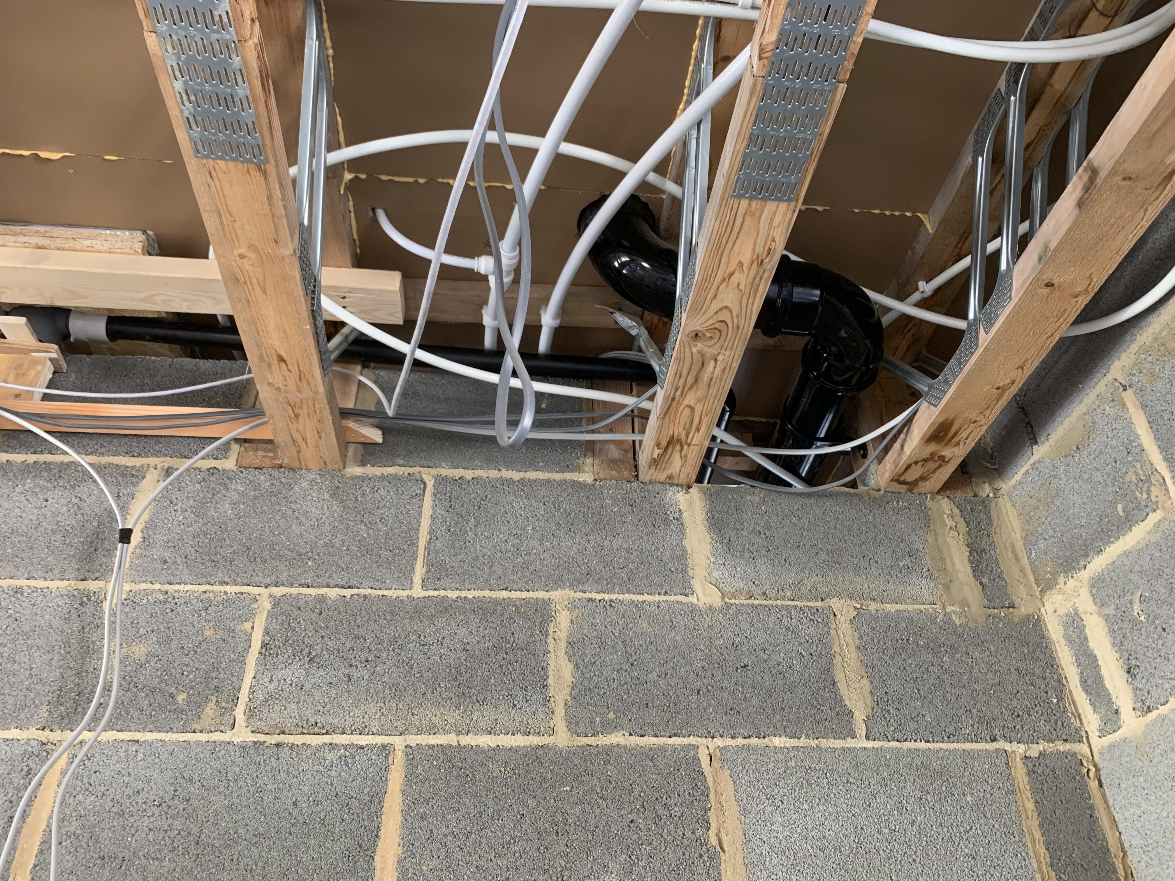

James94 Posted June 12, 2022 Posted June 12, 2022 Hi all, first fix is almost done, just a few things that are bothering me prior to plasterers coming I’m not sure how best to finish off a few things, first of all is there certain regulations on how to finish this section off see pic?
ProDave Posted June 12, 2022 Posted June 12, 2022 Cables are supposed to be supported, not just hanging, using metal cable clips above an exit route to stop cables hanging down in the event of a fire. Plasterer will expect cables and back boxes in the wall if plastering direct to blocks. Some pipe insulation would be good and sound insulation between floors if your BC demands it or you want it.
James94 Posted June 12, 2022 Author Posted June 12, 2022 @ProDave thanks for your reply, I know the plumber has a couple more odd days so I’ll make sure the pipe insulation is done. not sure why we left. Cable’s hanging and not fixed in boxes, I think it might of been at the time I wasn’t exactly sure if kitchen appliances positions and how many. Electrician won’t be back until second fix now so I’ll make sure there in position and fixed prior to plasterers. plasterers have agreed to sound insulate in their price. How can I finish above block wall where it finishes low to first floor, are there regulations to comply with?
PeterW Posted June 12, 2022 Posted June 12, 2022 No issue with the gap where the soil goes through but it needs supporting as does that shower waste, plus there are no ceiling noggins at the edges which will need adding.
James94 Posted June 12, 2022 Author Posted June 12, 2022 @PeterW Thanks for the response, the toilet waste has a bracket fixing to the joist are you suggesting I need to add more of a support? I’ll look at the shower waste I’m sure there are some hidden supports not seen in the pic. regarding ceiling noggins, I’m not sure what you mean, there are some under kaberdeck do I require more and if so could you show what I need to add. the gap a the top of the wall is not just at the soil vent pipe it’s all the way along wall can I leave wall short of flooring?

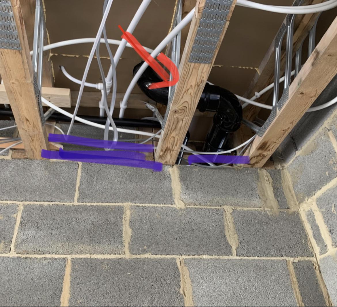

PeterW Posted June 13, 2022 Posted June 13, 2022 Where the red arrow is there should be something supporting the joint / pipe for the soil stack as it comes through the floor as that will twist in time. I’d also want the shower waste clipped every 500mm to stop sagging. noggins should be fitted where the purple line is - either Z clips or screwed to the joists in line with the lower edge of the joists as otherwise there is nothing to tack the ceiling boards to.
James94 Posted June 13, 2022 Author Posted June 13, 2022 @PeterW. @ProDave Spoke to plasterer and he’s Said he has seen noggings on some of his jobs but not to many and as I’m having 15mm plasterboard on ceilings that it won’t need it. if I had known earlier I may of had time but left it a little late now, all other bits I’ll get plumber to look at. Regards. James
Gone West Posted June 13, 2022 Posted June 13, 2022 3 minutes ago, James94 said: Spoke to plasterer and he’s Said he has seen noggings on some of his jobs but not to many and as I’m having 15mm plasterboard on ceilings that it won’t need it. I'm pretty sure you'll get cracks even with 15mm plasterboard.

Carrerahill Posted June 13, 2022 Posted June 13, 2022 On 12/06/2022 at 17:12, James94 said: Hi all, first fix is almost done, just a few things that are bothering me prior to plasterers coming I’m not sure how best to finish off a few things, first of all is there certain regulations on how to finish this section off see pic? Get your plumber and electrician back for starters and get that mess sorted! I'd ask your plasterer to put some access hatches in for when those unsupported and stressed push fit Tee joints are so when they blow off you can get in and fix it quickly.
James94 Posted June 13, 2022 Author Posted June 13, 2022 @Gone West not sure if I’ve got enough time to add noggins all round, if ceiling goes up first won’t the wall push up and take some of the ceiling weight? Or will I still end up with cracks?
James94 Posted June 13, 2022 Author Posted June 13, 2022 18 minutes ago, Carrerahill said: Get your plumber and electrician back for starters and get that mess sorted! I'd ask your plasterer to put some access hatches in for when those unsupported and stressed push fit Tee joints are so when they blow off you can get in and fix it quickly. It is a bit of a mess never really thought about it as it won’t be seen. Do you think these joints will cause issues in the future? I’m sure he won’t do owt about them as it would be nearly all his fittings.
Gone West Posted June 14, 2022 Posted June 14, 2022 13 hours ago, James94 said: @Gone West not sure if I’ve got enough time to add noggins all round, if ceiling goes up first won’t the wall push up and take some of the ceiling weight? Or will I still end up with cracks? Our plasterer wanted noggins around the edge, we used 12mm board. He said it would crack without them. I can't see 15mm board, which is thick for a ceiling, being any different.
joe90 Posted June 14, 2022 Posted June 14, 2022 I prefer noggins all round but ask the plasterer to use scrim around the edges to tie wall to ceiling plaster if you don’t have time!
