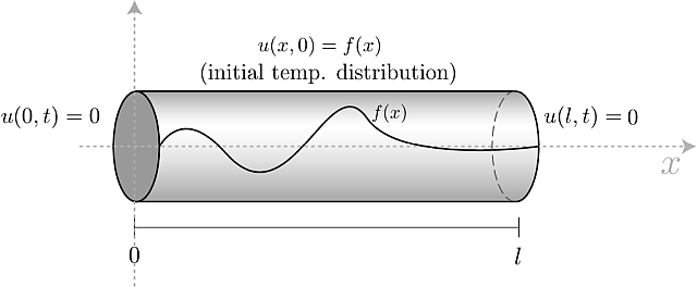

Gus Potter Posted June 12, 2022 Posted June 12, 2022 (edited) Here is a bit of background info / my thoughts. In clay, for example soils, you can design a large heated square warehouse with only insulation under the slab around the edges that preforms quite well. As mentioned by others provided you don't have significant ground water flow then you can often treat the clay as being of infinite depth. Ground water does not tend to flow that well in clay, particularly London clay (was used to make dams) say but usually if you go deep enough you will find ground water and water flow. Now BRE 443 indicates that the thermal conductivity of a clay soil with some hard core over the top is 1.5 W/m.K. In other words if you have a clay layer 1000mm thick then the U value of this layer is 1.5 W/m.K .. Compare this to a window which may have a u value of 1.4 W/m.K. The window is much thinner than a metre of clay but hopefully you get the jist of it. Just because something it is more conductive than say glass wool if you make it thick enough it will perform the same function. Say wattle and daub houses.. made of clay and straw. In a domestic application the foot print of the building is often quite small so the heat leaks out the sides. That is why when you look up floor insulation tables they ask you for the perimeter / floor area ratio. The smaller the ratio = less heat leaking out the sides. A lot of the software we use relies on these principles. For the mathematically minded the analysis / maths are founded on the principles developed by Laplace.. a very clever mathematician. Edited June 12, 2022 by Gus Potter ratio described incorrectly

SteamyTea Posted June 13, 2022 Posted June 13, 2022 6 hours ago, Gus Potter said: For the mathematically minded the analysis / maths are founded on the principles developed by Laplace.. a very clever mathematician. An even cleverer one was Fourier.
