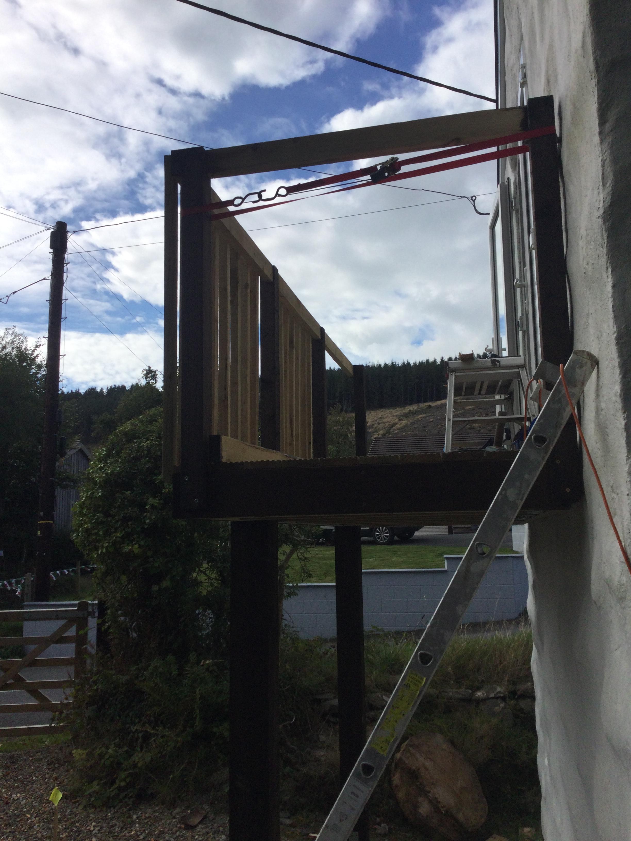

I think its gonna have to be 4x2 ( fix onto 3x3, should be ok) & chamfer the edges.
That's only 1/2" gap overhang either side. With 5" you'd get an inch either side. You could even think about routing a drip groove on the underside.

Im not sure I can get 5x2, but will check. 4x2 would be a lighter load. It might have to be 5x1 or 4x2.
Why they make the spindles only 900mm if B.Regs says a balcony handrail must be 1100mm high, I really can't understand.

The difference with the design I'm going with, I think perhaps means I can't use the "usual" handrail joe90 shows, with spindles fitted into it, the rail timber below that the spindles sit in, & lastly the trim bits put in between.
I think the standard way is to have posts running from ground up, & up onward from the deck to then use these "usual" handrail bits that fit together.. all fitting between such posts.
My handrail structure, I think, surely needs to be creating more solidity than usual, because I have no posts from the ground going up to use- so I'm effectively making a second structure onto the already-built first stage. I need extra cross bracing, & spindles attatched to side of my built frame.

The ideal would have been to carry your 6x6 posts up to handrail height where they would have doubled as corner posts.
You could look to make it as 3 stud walls in your workshop, then hoik them up. Affix your corner posts with galv brackets.
Many ways to skin this cat but you gets what you get when you make it up as you go along!

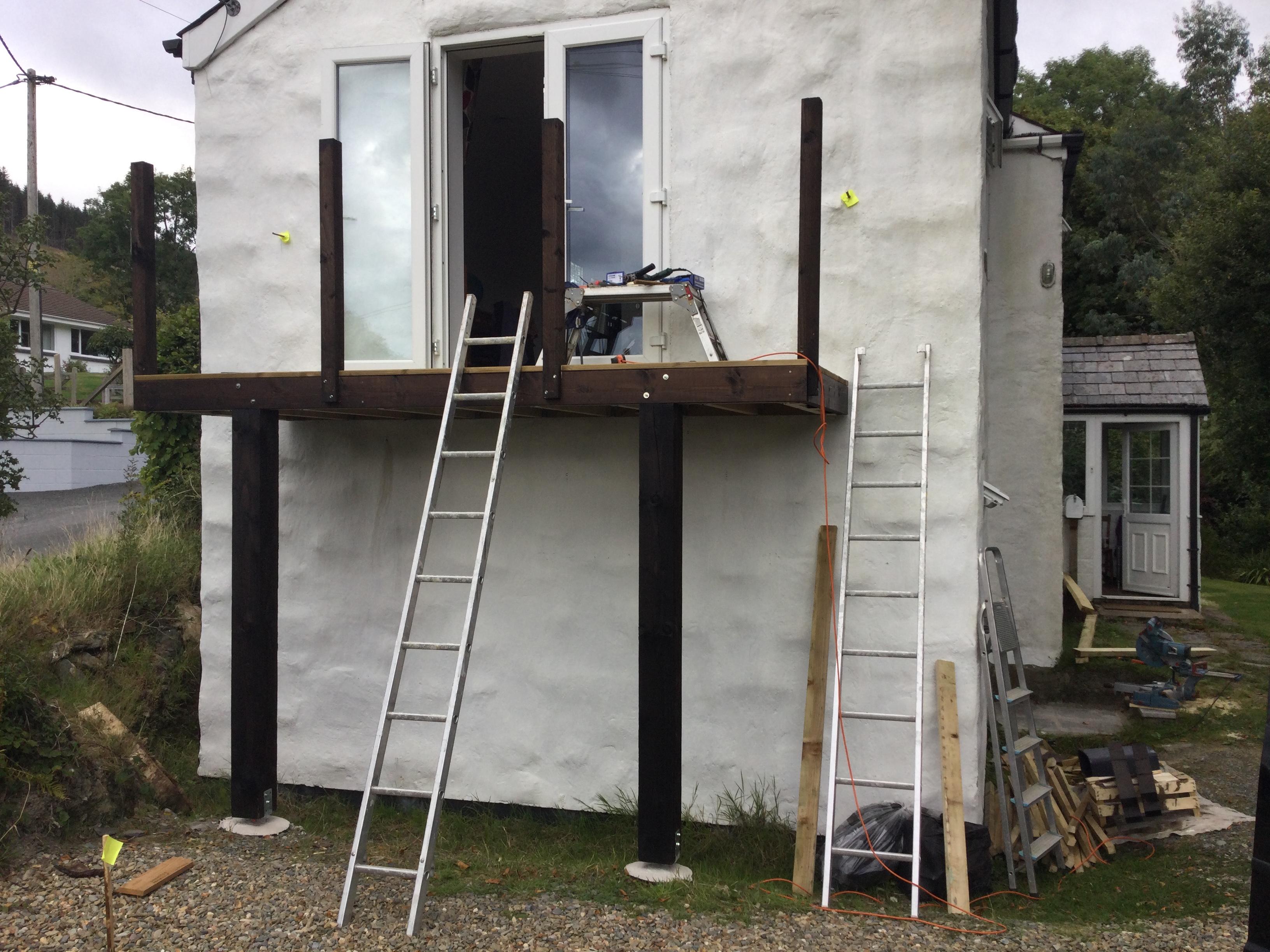

I think I'm ok with plan as was, for the 6 posts fixing ( notched then fixed to existing outside of lower frame, & I had turbo screws ready for here 2x in each notch > frame: could replace with coachbolts if I felt the it all not super solid).
The back two posts adjacent to the wobbly wall.. also needing a resin bolt twds the top. This the only tricky bit really.
I had this ^ idea lined all up, & some bits bought y'day. The top rail: 5x2 checks out at 4-3/4 of course.. so get some/ chamfer edges & I have my top handrail. (You were right again I think). My timber braces across: tannalised 3-1/2 x 1-1/2.. I found in town.
So just looong spindles to source, the 1-1/2" square jobs
i found... looking like will have to do.

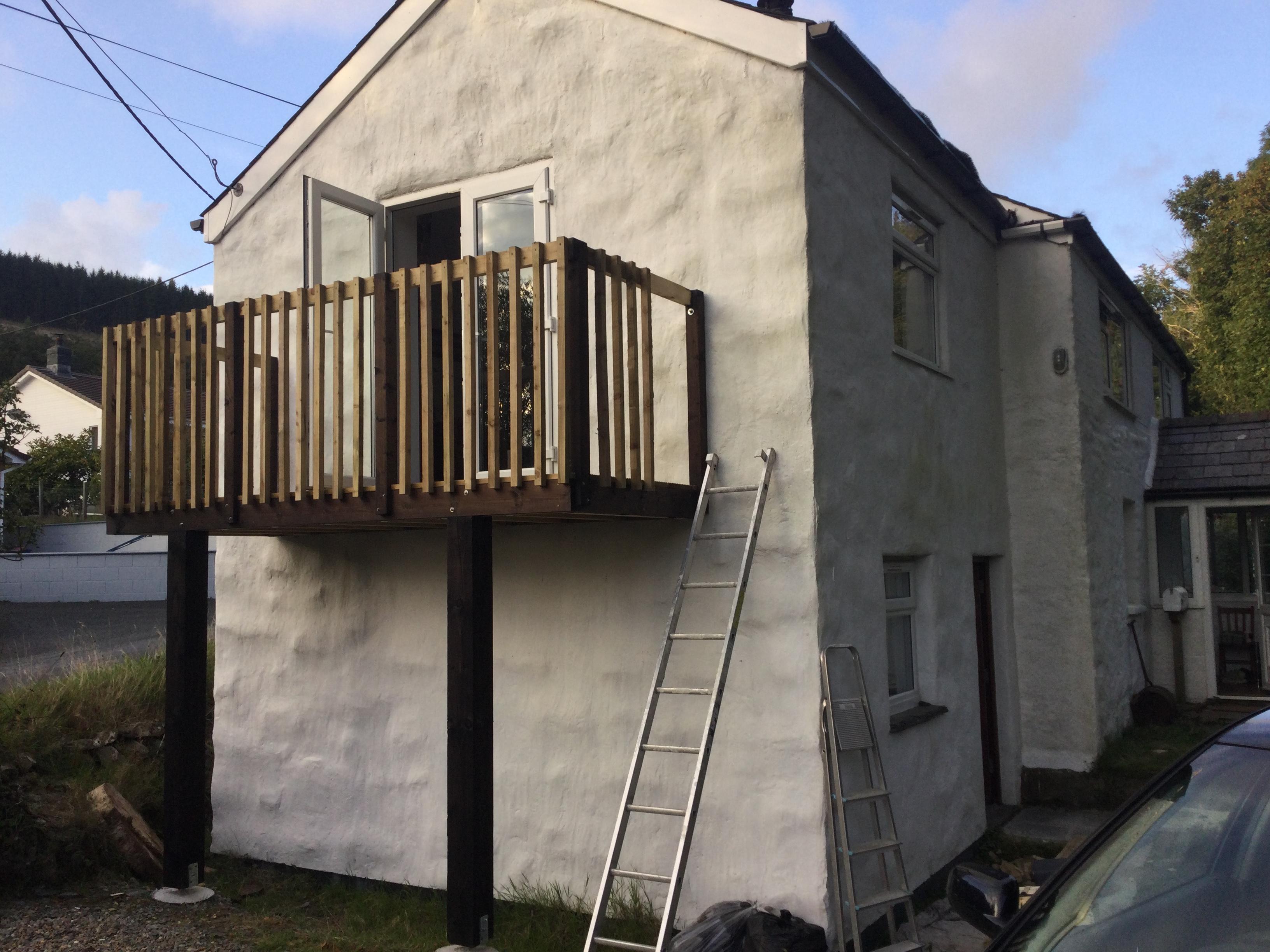

Progress yesterday.. the fischer tube just needed 1cm declogging both sections, then worked again great (with nozzle kindly sent by GW).
So my 2 back posts to do onto resin'd studs.. then spindles & 4x2 handrail today.. these two will let the side down a bit, but can be redone next year with better timber.

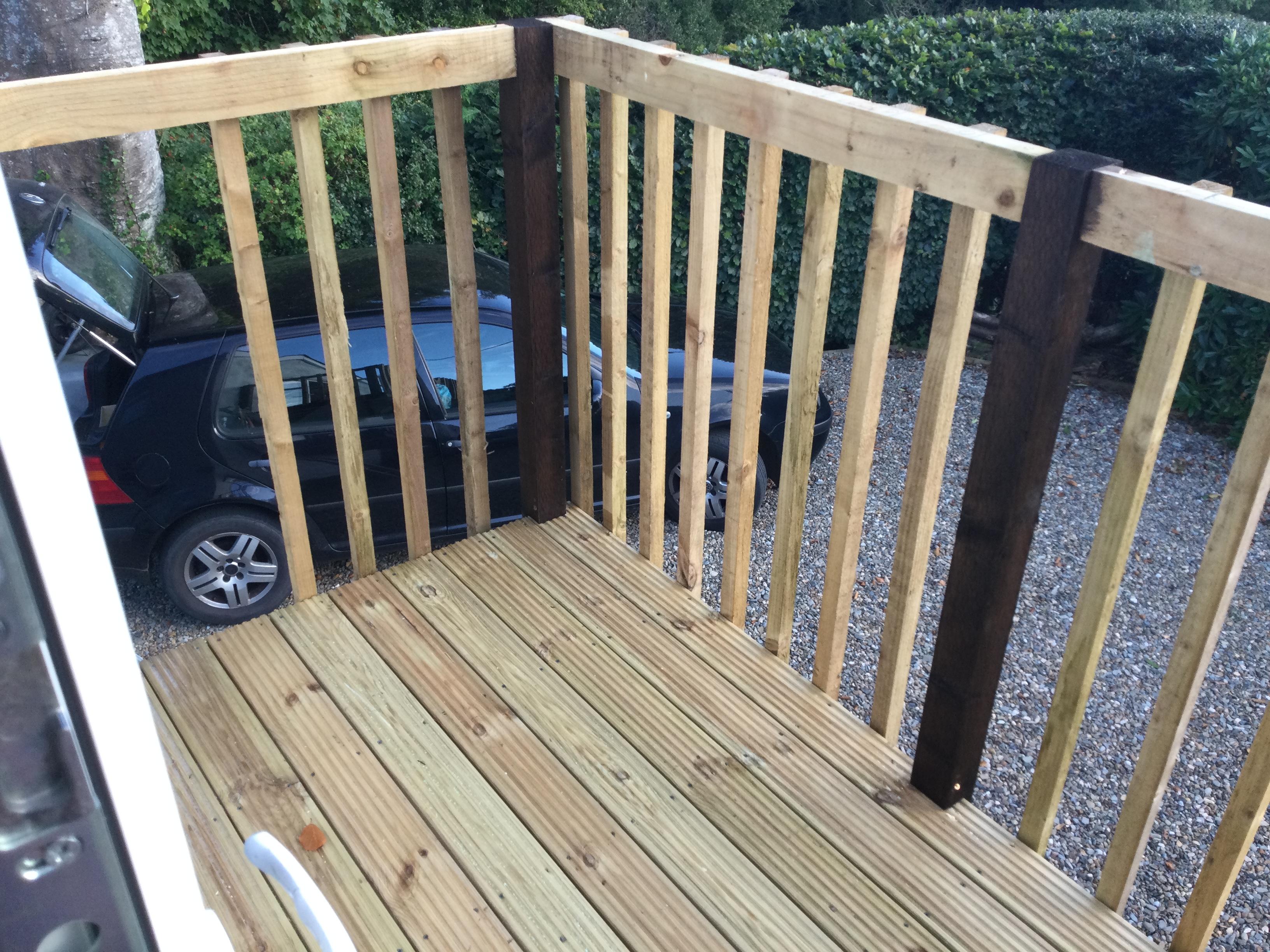

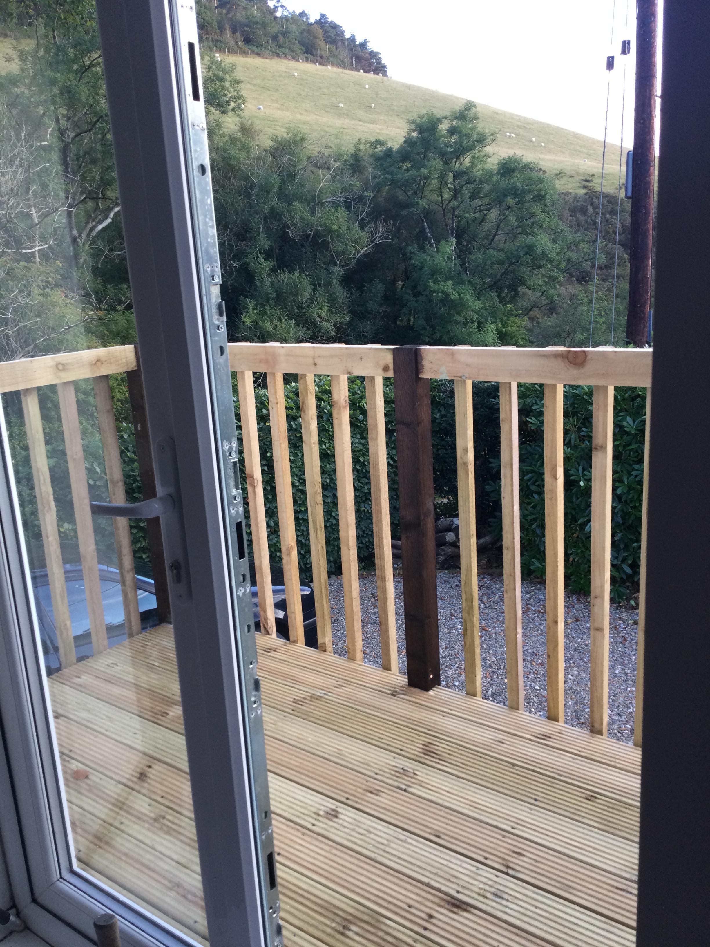

7 hours ago, Onoff said:
Those handrail posts look very high as in over 1100mm. Optical illusion?
No they're 1055mm notch to top. It's stupidly high this handrail as it is without the top on.. really spoils the sitting out & the view from the new room too.
It's due to the pillar so short you think this, another (very last) caveat of the whole 'build a foot too low' debacle.
Anyway resin bolted back posts/ great, & all 4 corner posts joined & solid now. Spindles 'agricultural' ( literally: 37 stake whatnots) but i like em.. far cheaper too. Zh

16 minutes ago, PeterW said:
@zoothorn that’s one bloody good job !! Top rail on, stain the rest and it’s a job very well done !!
Not sure what you’ve used to paint it but slap some on the concrete pads too and it will disappear ..
Hi Peter, thanks.. my top rail 'bit of 4 be 2' is gonna let the side down tho! Spindles oddly seem to blend in ok, rough as heck they are.. prolly go all wibbly wobbly "rustic" (= shite) by next year.
