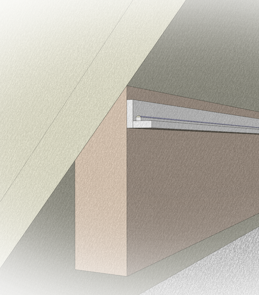

RandAbuild Posted May 22, 2017 Posted May 22, 2017 (edited) What about an LED strip running in an aluminium channel, hidden behind a timber pelmet, like this: (This is what we're doing) Edited May 22, 2017 by RandAbuild Cut and paste didn't work 1

Bitpipe Posted May 22, 2017 Posted May 22, 2017 We have similar beams in a few rooms and have LED strips on a 45o angle that work really well.
